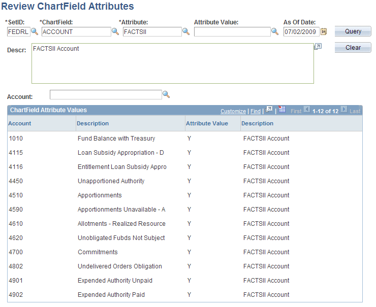

Review ChartField Attributes Page
Use the Review ChartField Attributes page (ATTR_INQ) to review the attributes for FACTS II processing before running the FACTS II Accumulation (GLS8302) process.
Navigation:
Set Up Financials/Supply Chain, and then Common Definitions, and then Design ChartFields, and then Review, and then Review ChartField Attributes
This example illustrates the fields and controls on the Review ChartField Attributes page. You can find definitions for the fields and controls later on this page.
Field or Control Description
SetID, ChartField, Attribute, Attribute Value, and As Of Date
Select the appropriate criteria for a query that enables you to verify that your attributes are set up correctly before you run the Accumulate (GLS8302) process.

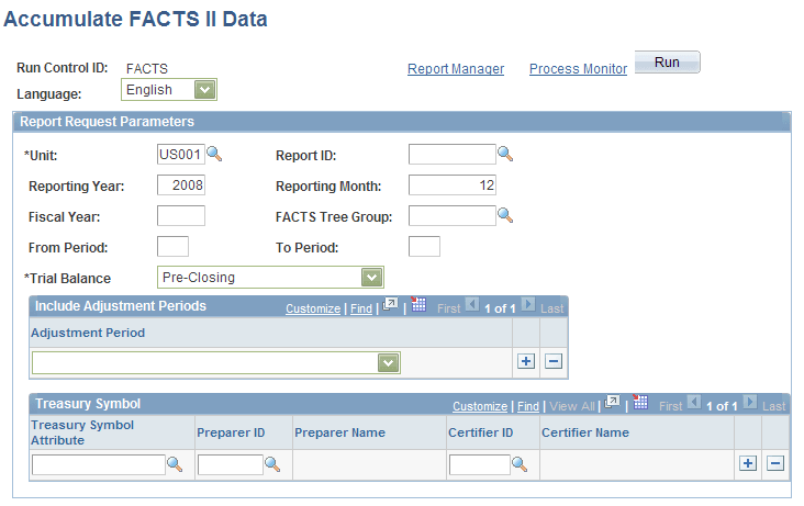

Accumulate FACTS II Data Page
Use the Accumulate FACTS II Data page (F2_RUN_GLS8302) to accumulate FACTS II data and load it into staging tables.
Navigation:
General Ledger, and then Federal Reports, and then FACTS II Creation, and then Accumulate FACTS II Data
This example illustrates the fields and controls on the Accumulate FACTS II Data page. You can find definitions for the fields and controls later on this page.
(phased out for GTAS) Accumulate FACTS II Data page
Unit
Select the business unit for this FACTS II data.
Report ID
Enter the FACTS II report identification for your agency.
Reporting Year and Reporting Month
Enter the reporting year and month for this FACTS II file.
Fiscal Year
Enter the fiscal year for this FACTS II data.
FACTS Tree Group
Select the FACTS tree group for FACTS II processing.
From Period and To Period
Enter the accounting periods for this accumulated data for the previously entered fiscal year.
Trial Balance
Select whether to include closing adjustments and balances in your FACTS II data:
  • Closing - reflects balances after the close of the fiscal year.
  • Pre-Closing - reflects remaining appropriation balances prior to the close of the fiscal year.
  • Pre-Closing, Adjustments Only - reflects remaining appropriation balances prior to the close of the fiscal year, but includes adjusting entries.
Adjustment Period
Select the adjustment periods that you want to include in the accumulation of this FACTS II data. You have one or more rows.
Treasury Symbol Attribute
Select the Treasury Symbol attribute that is associated with the funds that you are using in your FACTS II data.
Preparer ID and Certifier ID
Select the ID of the preparer of the data for this Treasury Symbol attribute and the ID of the person who certified this preparer's FACTS II data.

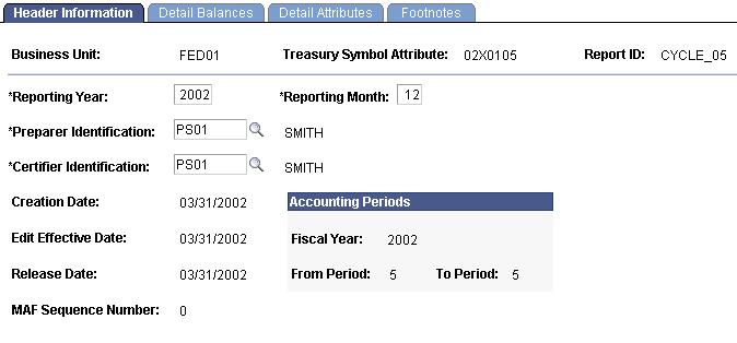

Review FACTS II Data - Header Information Page
Use the Review FACTS II Data -Header Information page (F2_STAGE_HDR) to set up the Staging Header information; enter the net period outlay that is to apply to the FACTS II file.
Navigation:
General Ledger, and then Federal Reports, and then FACTS II Review, and then Review FACTS II Data, and then Header Information
This example illustrates the fields and controls on the Review FACTS II Data - Header Information page . You can find definitions for the fields and controls later on this page.

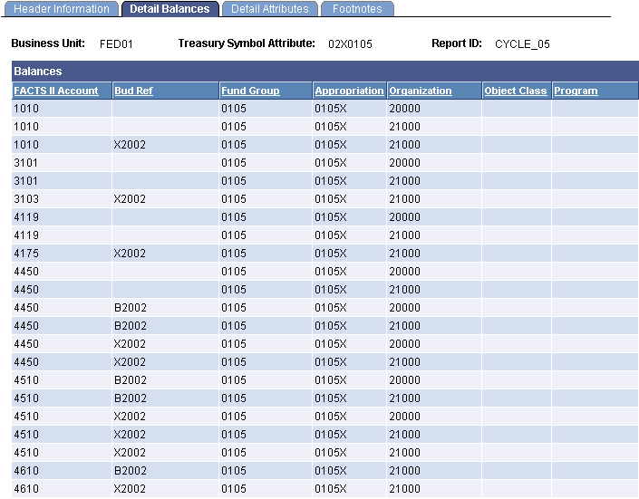

Review FACTS II Data - Detail Balances
Use the Review FACTS II Data - Detail - Balances page (F2_STAGE_DTL1) to review all of your FACTS II ACCOUNT and FUND CODE detail balances, including other ChartField details that apply.
Navigation:
General Ledger, and then Federal Reports, and then FACTS II Review, and then Review FACTS II Data, and then Detail Balances
This example illustrates the fields and controls on the Detail - Balances page. You can find definitions for the fields and controls later on this page.
This page contains all of the detail information for a specific fund code and its associated general ledger and FACTS II accounts.

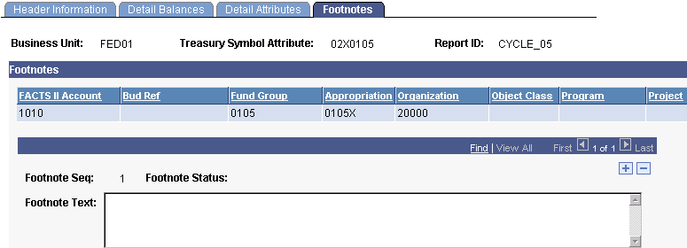

Review FACTS II Data - Footnotes Page
Use the Review FACTS II Data - Footnotes page (F2_STAGE_FTNT) to enter footnotes for each FACTS II account and fund code where applicable.
Navigation:
General Ledger, and then Federal Reports, and then FACTS II Review, and then Review FACTS II Data, and then Footnotes
This example illustrates the fields and controls on the Footnotes page. You can find definitions for the fields and controls later on this page.
Footnotes page
Enter necessary footnotes based on your organization's data.
Review this information thoroughly before continuing with your FACTS II processing.

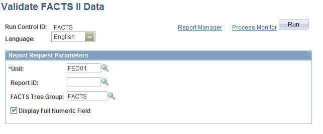

Validate FACTS II Data Page
Use the Validate FACTS II Data page (F2_RUN_GLS8303) to validate the accumulated data and create a report that indicates whether the Accounting Edit processes passed or failed and describes the reason that the edit passed or failed.
Navigation:
General Ledger, and then Federal Reports, and then FACTS II Review, and then Validate FACTS II Data, and then Validate FACTS II Data
This example illustrates the fields and controls on the Validate FACTS II Data page. You can find definitions for the fields and controls later on this page.
Unit
Select the business unit for this FACTS II reporting.
Report ID
Enter the Report ID that you entered to accumulate the FACTS II data.
FACTS Tree Group
Select to validate FACTS II data for a particular FACTS Tree Group.
Display Full Numeric Field
If you report amounts larger than 15 integers and 2 decimal places, select this option to display full numeric fields consisting of 23 integers and 3 decimal places on the Validation report.
The validation process performs edits against the account balances that are generated by the accumulation process. It compares the current period net outlay amount entered with the amount that was extracted in edit 12 and generates a report that indicates a pass or fail for each edit.

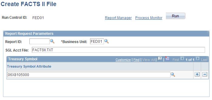

Create FACTS II File Page
Use the Create FACTS II File page (F2_CREATE_FILE) to create the FACTS II flat file to send to the U. S. Treasury to upload to GOALS.
Navigation:
General Ledger, and then Federal Reports, and then FACTS II Creation, and then Create FACTS II File
This example illustrates the fields and controls on the Create FACTS II File page. You can find definitions for the fields and controls later on this page.
Report ID
Enter the accumulated and validated FACTS II report ID.
Business Unit
SGL Acct File (SGL account file)
Enter the name of the FACTS II flat file. You must use a .TXT file extension. Do not enter a path.
Select one or more Treasury Symbol attributes for this FACTS II data.

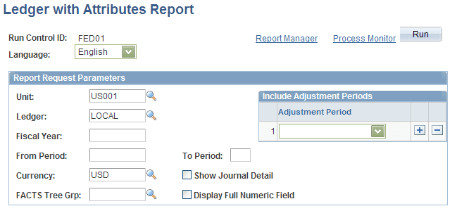

Ledger with Attributes Report Page
Use the Ledger with Attributes Report page (RUN_GLS7017) to generate a FACTS II report for a specific business unit, ledger, fiscal year, period range, adjustment period information, and FACTS II Cohort and Acct Req Fund attributes tree-level data.
You can also indicate that the numeric field can be 23 integers and 3 decimal places.
Navigation:
General Ledger, and then Federal Reports, and then FACTS II Reports, and then Print FACTS II Ledger Attr Rpt
This example illustrates the fields and controls on the Ledger with Attributes Report page. You can find definitions for the fields and controls later on this page.
Run
Click to generate the Ledger Activity report (GLS7017) containing the specified business unit ledger's fund and account attributes for the specified fiscal year and period range. This report can include journal detail and draws its data from the Cohort Year tree and level and the Accts Req Fund attributes tree and level.
Select if you report amounts larger than 15 integers and 2 decimal places. Full numeric fields consisting of 23 integers and 3 decimal places will appear on the report.
