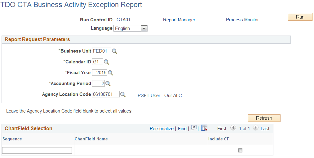

TDO CTA Business Activity Exception Report Page
RUN_GLS8410
Run GLS8410 SQR to print transactions that should not be recorded for a particular ALC, and GLCTAEXP SQR to print transactions that should not be recorded for a TDO ALC for CTA.

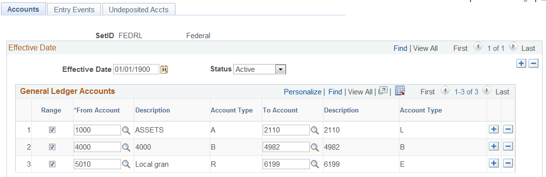

Use the CTA/1220 Report Definition - Accounts page (SF224_SF1220_DEFN1) to add the range of accounts to access and use for this report.
Navigation:
General Ledger, and then Federal Reports, and then CTA/ 1219/ 1220, and then CTA/1220 Report Definition, and then Accounts
This example illustrates the fields and controls on the CTA/1220 Report Definition - Accounts page.
CTA 1220 Report Definition - Accounts page
Field or Control Description
Effective Date
Displays the system date, which you can change.
Status
Select Active.
Range
Click to enter a range of values in the From Account and To Account fields to identify the range of accounts to use for this report. If Range is not selected, you can enter a From Account value as a single instance. The page also displays a description and indicates the type of account. For example, A is an asset and L is a liability account.

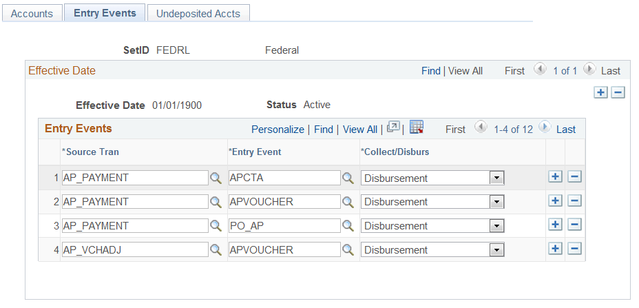

Use the CTA/1220 Report Definition - Entry Events page (SF224_SF1220_DEFN2) to add the source transactions and entry events, and indicate whether this transaction is a collection or disbursement for this report.
Navigation:
General Ledger, and then Federal Reports, and then CTA/ 1219/ 1220, and then CTA/1220 Reports Definition, and then Entry Events
This example illustrates the fields and controls on the CTA/1220 Report Definition - Entry Events page.
CTA 1220 Report Definition - Entry Events page
Source Tran (source transaction), Entry Event, and Collect/Disburs (collection/disbursement)
Select the source transactions, their associated entry event, and whether each transaction is a collection or a disbursement for this report, and save the page.

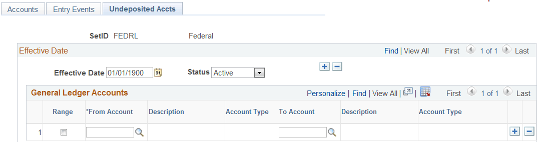

CTA/SF1220 Reports Definition - Undeposited Accts Page
Use the CTA/SF1220 Reports Definition - Undeposited Accts (undeposited accounts) page (SF224_UNDEP_ACC) to identify a range of undeposited accounts to use for reports.
Navigation:
General Ledger, and then Federal Reports, and then CTA/ 1219/ 1220, and then CTA/1220 Reports Definition, and then Undeposited Accounts
This example illustrates the fields and controls on the CTA/SF1220 Reports Definition - Undeposited Accts page.
CTA 1220 Report Definition - Undeposited Accounts page
Enter a range of undeposited accounts to use on the report. Add as many rows as necessary to set up the accounts.
Undeposited collections are amounts received by an agency that have yet to be deposited with the U.S. Treasury. Agencies typically receive small amounts of money that they deposit once a week. The agencies book these amounts to an undeposited collections account until they are officially deposited with the U.S. Treasury.
Because these amounts are typically entered in the general ledger by manual journal entry, the ALC field on the journal header can be used to identify undeposited amounts on the CTA report.

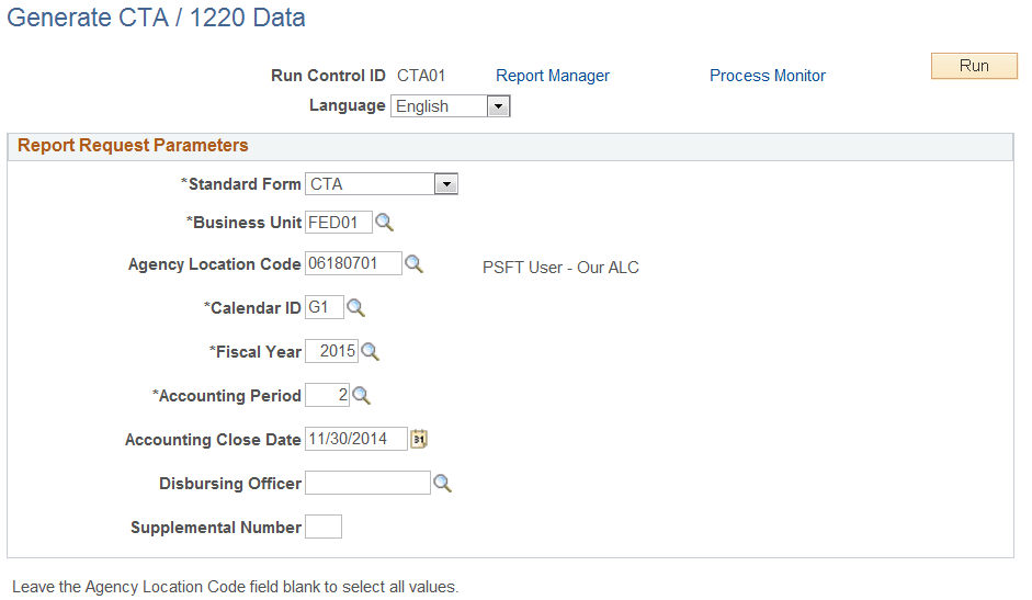

Use the Generate CTA / 1220 Data page (RUN_SF224_SF1220) to run the GLSF224G SQR process to update the staging tables and run the GLCTAGEN SQR process to update the staging tables for CTA.
Navigation:
General Ledger, and then Federal Reports, and then CTA/ 1219/ 1220, and then Generate CTA/1220 Data
This option generates the data and moves it to a table.
This example illustrates the fields and controls on the Generate CTA / 1220 Data page.
Generate CTA 1220 Data page
Standard Form
Select SF224, SF224 Partial, CTA, or SF1220 to generate the data.
Note: The SF224 option only selects an ALC if the GWA Reporter Category is Non-Reporter. In addition, the SF224 Partial option only selects those ALC for which the GWA Reporter Category is other than Non-Reporter.
Business Unit
Select the business unit for the organization that is submitting this report.
Agency Location Code
Select an ALC for the reporting agency or leave the field blank and all ALCs for the setID derived from the business unit are processed. Leaving the ALC field blank is only a valid option for SF224 or SF224 Partial.
Calendar ID
Select the appropriate calendar to apply to this selected report.
Fiscal Year
Select the fiscal year to apply to the selected report.
Accounting Period
Select the accounting period that applies to the selected report.
Accounting Close Date
Enter or select the close date of the accounting period.
Disbursing Officer
For SF1220 reports only, select the ID of the disbursing officer.
Supplemental Number
Use this field to track monthly submission counts. The default value is 0. You must modify this number manually if you submit a subsequent adjustment 224 report during the same accounting month.
Run
Save the page and click this button to run the SF224/SF1220 SQR Report Generate process to update the report staging tables.
You can print the Partial SF224 report and create a flat file for CTA or Partial 224 by selecting the Run CTA/Create file. You can print the SF1220 report by selecting Run SF1220 Report.

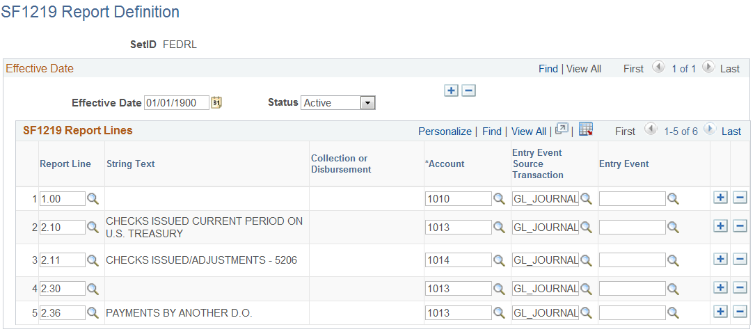

Use the SF1219 Report Definition page (SF1219_DEFN) to set up report lines for each account, its associated entry event source transaction, and associated entry event.
Navigation:
General Ledger, and then Federal Reports, and then CTA/ 1219/ 1220, and then SF1219 Report Definition, and then SF1219 Report Definition
This example illustrates the fields and controls on the SF1219 Report Definition page.
Report Line, Account, Entry Event Source Transaction, and Entry Event
Select the values that you want to apply to this report based on each report line that you add and select.

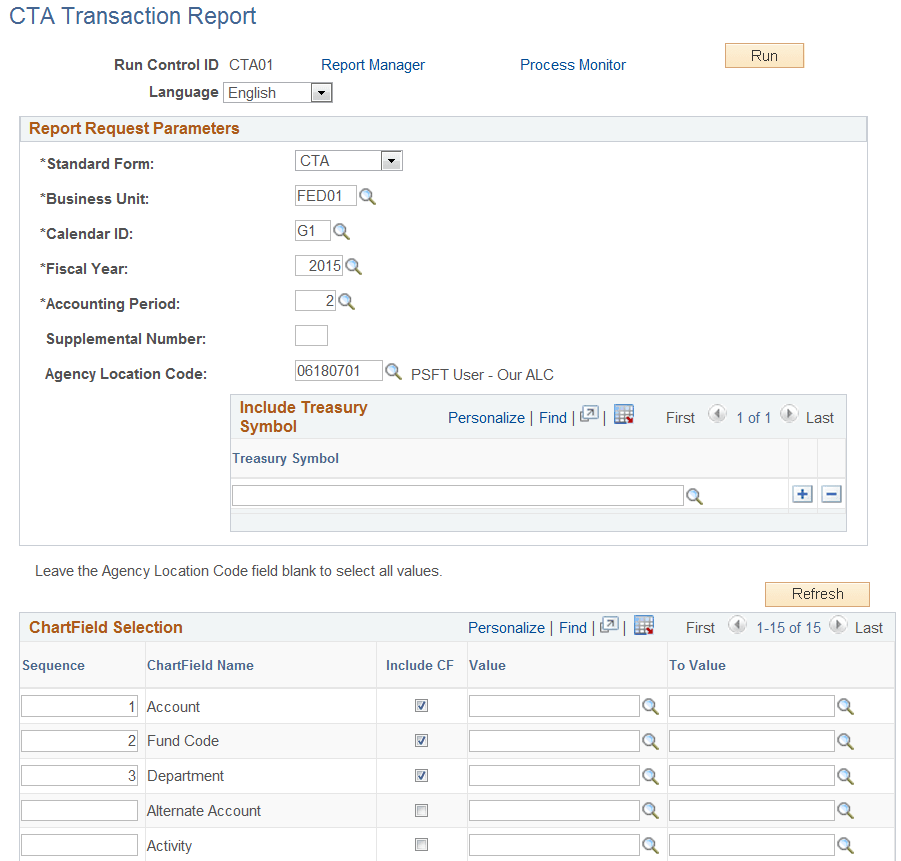

CTA Transaction Report Page
Use the CTA Transaction Report page (RUN_GLS8400) to Run GLS8400 SQR to print detail transactions for SF224 and the Partial SF224, and GLCTATRA SQR to print detail transactions for CTA.
Navigation:
General Ledger, and then Federal Reports, and then CTA/ 1219/ 1220, and then CTA Transaction Report
This example illustrates the fields and controls on the CTA Transaction Report page.
CTA Transactions Report page
This page requires the same information as the CTA/SF1220 Generate page. However, the disbursing officer name is not required and does not appear on the page.
Use the TDO CTA Business Activity Exception Report page (RUN_GLS8410) to Run GLS8410 SQR to print transactions that should not be recorded for a particular ALC, and GLCTAEXP SQR to print transactions that should not be recorded for a TDO ALC for CTA.
Navigation:
General Ledger, and then Federal Reports, and then CTA/ 1219/ 1220 , and then TDO CTA Bus Activity Exception
This example illustrates the fields and controls on the TDO CTA Business Activity Exception Report page.
