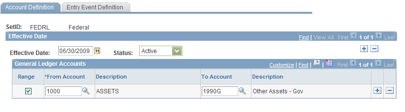

Fund Balance Reconciliation - Account Definition Page
Use the Fund Balance Reconciliation - Account Definition page (FUNDBL_RCN_DEFN1) to enter the General Ledger accounts that you want to reconcile with the U. S. Treasury data.
Navigation:
General Ledger, and then Federal Reports, and then Fund Balance Reconciliation, and then Define Report Definition, and then Account Definition
This example illustrates the fields and controls on the Fund Balance Reconciliation - Account Definition page. You can find definitions for the fields and controls later on this page.
Field or Control Description
From Account and To Account
Enter one account or a range of accounts that you want to reconcile with the U.S. Treasury data. Add rows as needed and save the page.

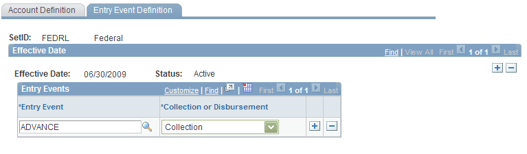

Fund Balance Reconciliation - Entry Event Definition Page
Use the Fund Balance Reconciliation - Entry Event Definition page (FUNDBL_RCN_DEFN2) to enter the Entry Event codes and select whether they are a collection or disbursement to reconcile with the U. S. Treasury data.
Navigation:
General Ledger, and then Federal Reports, and then Fund Balance Reconciliation, and then Define Report Definition, and then Entry Event Definition
This example illustrates the fields and controls on the Fund Balance Reconciliation - Entry Event Definition page. You can find definitions for the fields and controls later on this page.
Entry Event and Collection or Disbursement
Select the entry event code that applies to this reconciliation, and select whether it is a collection or a disbursement. Add entry rows as needed and save the page.

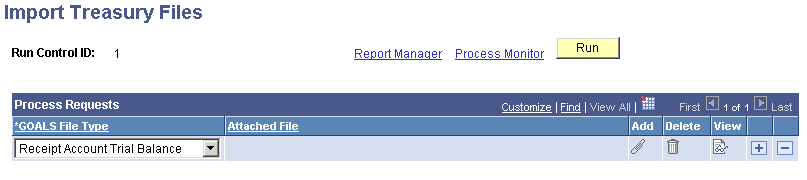

Fund Balance Reconciliation - Import Treasury Files Page
Use the Fund Balance Reconciliation - Import Treasury Files page (LOAD_FUNDBL_REQ) to select the GOALS file type and attach the file containing the U. S. Treasury data.
Navigation:
General Ledger, and then Federal Reports, and then Fund Balance Reconciliation, and then Import Treasury Files
This example illustrates the fields and controls on the Fund Balance Reconciliation - Import Treasury Files page. You can find definitions for the fields and controls later on this page.
GOALS File Type (government online accounting link system file type)
Select the type of file that you are importing from the U.S. Treasury GOALS. Values are:
  • Receipt Account Ledger
  • Receipt Account Trial Balance
  • Und Appropriation Acct Ledger (undisbursed appropriation account ledger)
  • Und Appropriation Acct TB (undisbursed appropriation account trial balance)
    Save the page.
Click the Add icon to attach the file in the field.
Click the Delete icon to detach the file. This action does not delete the file from your server.
Click the View icon to open and display the contents of the file. You must attach the file before you can view it.
Save the page.
Note: Files must be entered in logical pairs. Account Ledger Activity and Account Trial Balance must be selected for the same data type. Data type is either Undisbursed Appropriations or Receipts.
These buttons work the same as the buttons on the Load FACTS I Data page.
See Load FACTS I Data Page.

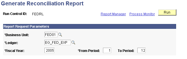

Generate Reconciliation Report Page
Use the Generate Reconciliation Report page (RUN_FBRECON_RPT) to run the reconciliation process and generate the Fund Balance Reconciliation report.
Navigation:
General Ledger, and then Federal Reports, and then Fund Balance Reconciliation, and then Generate Reconciliation Report
This example illustrates the fields and controls on the Generate Reconciliation Report page. You can find definitions for the fields and controls later on this page.
Report Request Parameters
Enter the parameters and click the Run button to run the Fund Balance with Treasury Recn (fund balance with treasury reconciliation) process, GLS9500 SQR Report to compare the data that you defined for this reconciliation with the U.S. Treasury data and produce a report that defines any differences in the data.
