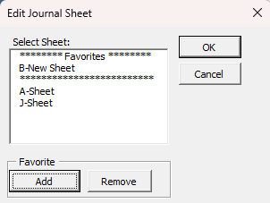

Select Sheet Window
JRNL1_WS
Select an existing sheet and create favorite sheets.

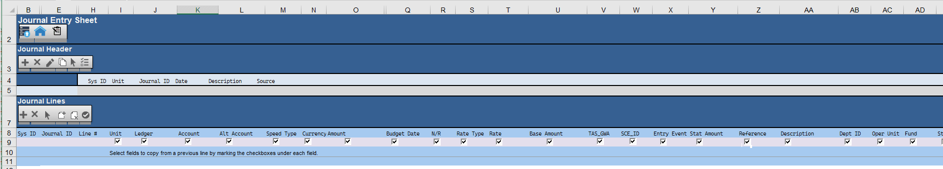

Journal Entry Sheet Page
JRNL1_WS
Create and edit journal data.

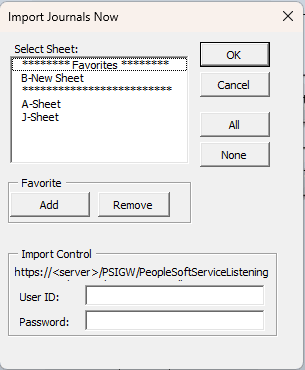

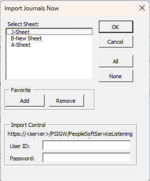

Import Journals Now Page
JRNL1_WS
Import journal sheets in online mode.

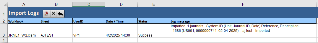

Import Logs Page
JRNL1_WS
Verify the status of the journal import process and clear logs.

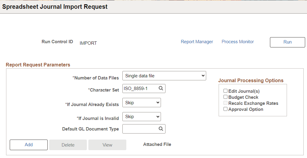

Spreadsheet Journal Import Request Page
GL_EXCL_BATC
Run the batch import process for journal sheet files that you created from the Spreadsheet interface into your PeopleSoft database.
See Import Journals Now Page and Write Journals to File Page

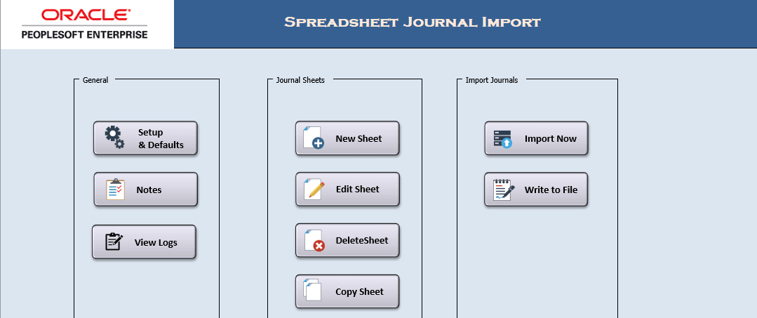

Spreadsheet Journal Import Page
Use the Spreadsheet Journal Import page (JRNL1_WS) to set the defaults and set up your spreadsheets for importing into General Ledger.
Navigation:
Open the JRNL1_WS file delivered with your PeopleSoft products to open the Spreadsheet Journal Import control page.
If prompted, choose to Enable Macros.
This example illustrates the fields and controls on the Spreadsheet Journal Import page.
Spreadsheet Journal Import Homepage
General
The General group box enables you to define options and defaults for this workbook and to enter any notes or calculations concerning this import.
Field or Control Description
Setup & Defaults
Click to set up access to the Define Options and Defaults dialog box. Use to set journal header defaults, message logging options, document sequencing options, online import controls, and so on. You can also access the ChartField Configuration dialog box from here.
Notes
Click to access a scratch pad in the workbook. Use the scratch pad for instructions, calculations, notes, and so on.
View Logs
Select to access the Import Logs Page.
Journal Sheets
The Journal Sheets group box enables you to insert a new journal sheet, or edit, delete, or copy an existing journal sheet.
New Sheet
Click to insert a new journal sheet. A workbook can contain as many journal sheets as needed, and each journal sheet can contain as many journals as desired.
Edit Sheet
Click to edit one journal sheet in the workbook.
Copy Sheet
Click to copy one journal sheet to a new journal sheet saved under a new name.
Delete Sheet
Click to delete one or more journal sheets in the workbook.
Import Journals
The Import Journals group box enables you to import one or more of the journal sheets and save journal sheets to a file.
Import Now
Click to initiate online import of one or more journal sheets. The system imports only journals that are marked as import.
Write to File
Click to save selected journal sheets to a file. After saving one or more files, you must run the batch import process (GL_EXCL_BATC) to complete the file import process.
You can use Shift and Ctrl keys to select multiple journal sheets.

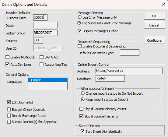

Define Options and Defaults Page
Use the Define Options and Defaults page to specify the options, defaults, and settings for the journal sheets in your workbook.
Navigation:
Click the Setup & Defaults button on the Spreadsheet Journal Import control page.
This example illustrates the fields and controls on the Define Options and Defaults page.
Header Defaults
Enter default values for the Business Unit, Date, Ledger Group, Source fields, and the following fields as necessary.
User ID
Enter a default (operator) user ID for the journal header.
Enable Multibook
Select this field to make the Ledger field in the New Journal Header page unavailable for selection. This ledger field displays when you click the Add button in the Spreadsheet Journal Import - Header section of the worksheet. The Ledger field on the journal header is optional. You only use it when you want to enter journals for ledger groups that are not set to Keep Ledgers in Sync and for which you do want to specify the ledger name on the header.
If you select this check box, the Ledger field is not enabled on the journal header.
AutoGen Lines (automatically generate lines)
This field is related to the Keep Ledgers in Sync (KLS) option for multibook ledgers on the Detail Ledger Group page. The KLS option determines if a transaction is posted to one or to all ledgers in a group.
If you select this option, the system automatically generates journal lines to support transaction detail for all ledgers in a ledger group. For example, if you enter a two-line journal import for a ledger group that contains three ledgers, the journal edit process generates an additional four lines—two lines for each additional ledger.
If you do not select AutoGen Lines, and the ledger group of the journal is defined as KLS, then the Journal Edit process overrides your choice and still generates the corresponding lines for all ledgers in the group.
Recalc Exchange Rates (recalculate exchange rates)
Select this check box to recalculate exchange rates based on the most current exchange rate, if your journals are recorded in multiple currencies. For example based on the current quote, say 1 USD = 1.2 CAD, the conversion is done. See Understanding Multiple Currency Processing in General Ledger.
Message Options
Define the message log options based on the following information:
Message Options
Log Error Messages Only: The system logs import messages to JRNLLOG.xls only when errors occur.
Log Successful and Error Messages: The system logs all import messages to JRNLLOG.xls regardless of the import process being successful.
Display Messages Online
Select to show import error messages online. Otherwise, errors go only to the message log JRNLLOG.xls.
Document Sequencing
Define document sequencing options based on the following information:
Enable Document Sequencing
Select to enable document sequencing for any business units that use it. You can track journals by document sequence number. Enabling this option enables you to specify document sequencing fields on the journal header.
Default Document Type
When document sequencing is enabled, specify a default document type to indicate the business purpose of your transaction. Examples of default document types are domestic customer invoices, customer credit memos, or customer debit memos. You can enter a document type for each journal header at a later time.

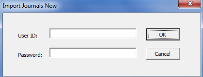

Online Import Control
Define options and behavior of online import mode based on the following information:
Address
Enter the server name and the port number of the Integration Gateway URL.
Database
Enter the domain site name (in lower case letters) of the environment to which journals are imported.
After Successful Import
Change Import Status to Do Not Import: The system changes import status of journals that are imported successfully. This prevents reimport of the journals when you attempt to import them a second time.
Keep Import Status as Import: Select this if you do not want the system to change import status so that you can reimport it later.
You can override journal import status at the journal sheet level anytime.
Skip If Journal Already Exists
Select this option and online load does not update already existing journals. The option is intended to prevent duplicate journals when a user is unaware that a journal has already been processed. This option is the default and is only applicable for online import using the Import Now functionality.
A message is logged providing details of any journals skipped because they already exist in the system.
If the option is not selected, online load updates already existing journals with valid journal data.
Note: When NEXT is used for the journal ID it is not possible to check if a journal already exists.
Skip If Journal Has Errors
Select this option and online load does not load invalid journals. This option is the default and is only applicable for online import using the Import Now functionality.
A message is logged providing details of journals that have invalid data.
If the option is not selected then the online load does not load either valid or invalid journals for that journal sheet. Online load then proceeds to the next journal sheet and loads all journals in the next journal sheet if all the journals in that next journal sheet are valid.
Sheet Options
Select the Sort Sheet Alphabetically check box to display the Select Sheet Window. This window appears after selecting Edit Sheet, Delete Sheet, Copy Sheet, or Import Now from the Spreadsheet Journal Import Page.
All spreadsheets are listed in alphabetical order. You can select any sheet as a favorite, which moves the sheet to the top. You can modify this option at any time, which changes the order accordingly.
General Options
Edit Journal(s)
Select to automatically run the journal edit process during the Import process. The Journal Edit process can be run manually using the online journal entry component, Edit Journals (batch mode).
Note: Journals are not created if an error occurs during the Import process. When you select this option, journals must pass the edit process before they can be imported successfully.
Budget Check Journals
Select to automatically budget check the journals, when they are uploaded.
Select to recalculate exchange rates per existing rates. This option also updates the transaction amount (if not in the base currency) to an amount in the base currency.
Submit Journal(s) for Approval
Select to indicate that after sheets are imported, the journals are to be processed through the Journal Import with Edit process and then approval workflow sends a notification to the approver.
If you select this check box, the system automatically selects the Edit Journal(s) check box. This is because the journal must be valid before it can be approved. Therefore, it is required that the edit process is run first.
If the Mark Journals to Post option is selected on the Application Fundamentals: Installation Options - General Ledger Page and the Application Fundamentals: User Preferences - General Ledger Page, and the Budget Check, Edit, and Approval processes result in an approved journal, then the system automatically changes the journal(s) to ready to post.

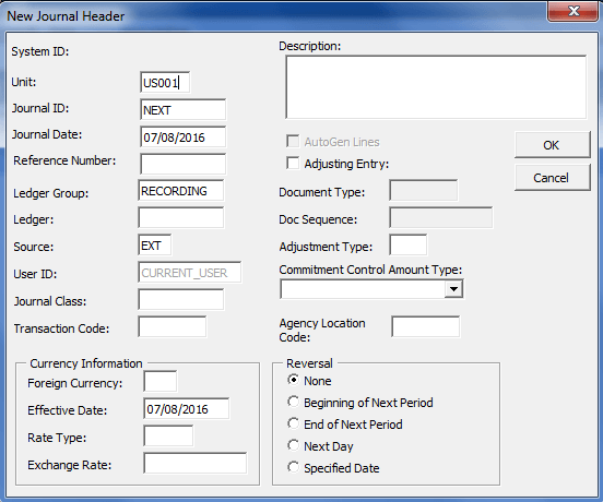

New Journal Header Page
Use the New Journal Header page to access journal header defaults.
Navigation:
Click the New Sheet button on the Spreadsheet Journal Import page or click the “+” (plus) sign next to Journal Header (row 3) on the Journal Entry Sheet page.
This example illustrates the fields and controls on the New Journal Header page.
Unit
Enter a business unit and it is used by the system at import time to populate spread sheet journal lines when no business unit is specified for the line either through direct entry or copy down from the previous line value that you entered.
Journal ID
You can specify a journal ID or use NEXT to derive the journal ID.
See Spreadsheet Journal Import Overview.
Journal Date
Enter a date or use the current date supplied by the system.
Select this check box if the ledger group contains multiple ledgers. If you have selected the Keep Ledgers in Sync (KLS) option for multibook ledgers on the Detail Ledger Group - Definition page, you should always select the AutoGen Lines check box so that the system automatically generates journal lines to support transaction detail for each ledger in the group. For example, if you enter a two-line journal import for a ledger group that contains three ledgers, the journal edit process generates two lines for each ledger.
Adjusting Entry
Select this option and the adjustment period fields become available.
Fields associated with functionality that your organization chooses not to implement are unavailable. For example, if you choose not to implement document sequencing, those fields are unavailable. A field may also be unavailable depending on the settings on the Define Options and Defaults page.
Currency Information
Do not enter values for both the rate type and the exchange rate. If you do, you receive an error message. Enter one or the other, but not both.
Select Sheet Window
Use the Select Sheet window to select an existing sheet and create favorite sheets.
Navigation:
  • Edit Sheet
  • Delete Sheet
  • Copy Sheet
  • Import Now
This example illustrates the fields and controls on the Select Sheet window when Edit Journal is selected
Sort Alphabetically and Favorites
This window only appears when the Sort Sheet Alphabetically check box is selected on the Define Options and Defaults Page.
Initially this window lists all journal entry sheets in alphabetical order, which allows you to quickly find a sheet.
If you want to more a favorite sheet to the top of the list, select the sheet and then select the Add button. To remove a sheet from the Favorites list, select the sheet and then select the Remove button.
Use the Journal Entry Sheet page (JRNL1_WS.XLSM) to create and edit journal data.
Navigation:
Click the New Sheet or Edit Sheet button on the Spreadsheet Journal Import Page to create or edit a journal sheet.
This example illustrates the fields and controls on the Journal Entry Sheet page.
Journal Entry Sheet
Import Journals Now icon (import journals now)
Imports this journal sheet immediately using online import mode.
Home icon (home)
Returns to the Spreadsheet Journal Import control page.
View Logs (View Logs)
Select to view the Import Logs Page.
Spreadsheet Journal Import - Header Buttons
The buttons in the header section of the spreadsheet are:
Create Journal icon (create journal)
Creates a new journal header with its own default values.
Delete Journal icon (delete journal)
Deletes a journal.
Edit Journal Header icon (edit journal header)
Edits the journal header fields.
Copy Journal icon (copy journal)
Copies a journal.
Select Journal icon (select journal)
Selects the journal header on whose lines you want to work.
Change Import Status (change import status)
Changes import status of a journal.
Spreadsheet Journal Import - Lines Buttons
The buttons in the lines section of the spreadsheet are:
Create Journal icon (add a line)
Adds a journal line in the current selected journal header.
Delete Journal icon (delete a line)
Deletes a journal line. Position your cursor on the line and click this button.
Select Journal icon (insert line)
Select to insert a line.
Copy Multiple Lines icon (insert multiple lines)
Inserts a block of lines.
Delete Multiple Lines icon (delete multiple lines)
Deletes a block of lines.
Check Number Decimal Points icon (check number decimal points)
Check the amount fields to verify that you have entered the number with the number of decimal points that you have set up. The default number of decimal points is 2. Click the button to check the number of decimal points before you import the journal.
Adding Journal Lines
Click the Add button in the line section to access and add a journal line.
  1. Populate the journal line data using the Tab key or arrow keys to advance from one cell to another.
  2. Insert additional lines by clicking the Add sign again to insert a line and automatically reposition your cursor in the first active cell of the new line.
    Scrolling left is unnecessary.
  3. Select the check box for a field where you want the value of the field on that journal line repeated in the journal line that is added next.
    Otherwise, the value for that field on the succeeding line is blank.
When running the spreadsheet import journal process, the system verifies that the user and user role has access to the business unit and source. If the user does not have access to the business unit and source, then a message is created indicating such and the specific journal is not created. See Enabling Journal Source Security.
Use as many journals in a spreadsheet as you like. Note that when you insert lines, they carry the header displayed at the top of the sheet.

When the Sort Sheet Alphabetically check box is selected on the Define Options and Defaults Page, the sheets are listed alphabetically, and you can move favorites to the top of the list as shown in the second image.
This example illustrates the fields and controls on the Import Journals Now page when the Sort Sheet Alphabetically check box is not selected on the Define Options and Defaults page.
Import Journal Now (Alpha Sort not selected)
This example illustrates the fields and controls on the Import Journals Now page when the Sort Sheet Alphabetically check box is selected on the Define Options and Defaults page and a favorite is added.
Import Journals Now - Select Sheet (Alphabetically enabled)
Select the sheets that you want to import to the General Ledger database. Enter your PeopleSoft database user ID and password and click OK.
Import Journals Online from the Journal Entry Sheet Page
Use the Import Journals Now page to import the journal you are working on in online mode.
Navigation:
Click the Import Journals Online Now button from the Journal Entry Sheet page.
This example illustrates the fields and controls on the Import Journals Now page.
Import Journals Now page (journal entry sheet page)
The URL to your PeopleSoft database appears automatically. Enter your user ID and password and click OK to import the journals.

Import Logs Page
Use the Import Logs sheet to verify the status of the journal import process and clear logs.
Navigation:
  • From the Spreadsheet Journal Import page, select the View Logs button.
  • From the Journal Entry Sheet page, select the View Logs button.
This example illustrates the fields and controls on the Import Logs page
Import Log
Home (home)
Select to return to the Spreadsheet Journal Import Page.
Clear Logs (clear logs)
Select to clear all the logs that appear on the sheet.
Return to Sheet (return)
Select to return to the Journal Entry Sheet Page. This option is only available when you access the Import Logs page from the Journal Entry Sheet page.
Use the Spreadsheet Journal Import Request page (GL_EXCL_JRNL) to run the Spreadsheet Journal Import process for journal sheet files created from the Spreadsheet interface into your PeopleSoft database.
Navigation:
General Ledger, and then Journals, and then Import Journals, and then Import Spreadsheet Journals
This example illustrates the fields and controls on the Spreadsheet Journal Import Request page.
Number of Data Files
Single data file: The file you attached to this page is the data file containing journal data.
Index file to other data files: The file you attached to this page is an index file containing file path and file names to one or more data files stored elsewhere.
Character Set
Select the character set of the flat file being imported. For example, you can specify ISO_8859-6 for Arabic or JIS_X_0208 for Japanese Kanji.
Select Abort, Skip, or Update.
If Journal is Invalid
Select Abort or Skip.
Default GL Document Type
If you use document sequencing, specify a default document type to indicate the business purpose for the transaction. You can enter a document type for each journal header at a later time.
Check Decimal Position
Select this option to validate decimal position. If selected, the Spreadsheet Journal Batch import process checks the decimal position of Amount values for importing journals and logs a message that provides details of journals with invalid decimal positions.
Invalid decimal positions can occur when the decimal position for a given currency is set at two positions, for example, but the Spreadsheet file that is being imported allows up to three or four decimal positions. This option allows you to correct the discrepancy before importing the journal to PeopleSoft General Ledger.
When the Spreadsheet Journal Import with Edit process runs (GL_EXCL_BATC) is run, the decimal position validation process runs automatically, regardless of whether this option is selected.
Journal Processing Options: Edit Journal(s)
When you access the Process Scheduler Request page, verify that the Journal Import with Edit process (GL_EXCL_BATC) is selected.
Journal Processing Options: Budget Check
Journal Processing Options: Recalc Exchange Rates (recalculate exchange rates
Journal Operations: Approval Option
Add
Click to add an attachment. Browse for the file you have written from the spreadsheet journal workbook, and then click Upload.
Delete
Click to delete an attachment.
View
Click to display the contents of the attached file.
