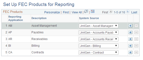

Set Up FEC Products for Reporting Page
Use the Set Up FEC Products for Reporting page (FEC_PRODUCT_TBL) to add or remove products to extract transaction data from and to include in the FEC Audit file.
Navigation:
Statutory Reports, and then FEC Audit Files FRA, and then Set Up FEC Products France
This example illustrates the fields and controls on the Set Up FEC Products for Reporting page. You can find definitions for the fields and controls later on this page.
The system delivers a list of products by default from which you can extract data for the audit file.
Click the Add a Product icon to add products not delivered by PeopleSoft. If you have a non-PeopleSoft product that creates accounting transactions in PeopleSoft General Ledger, through the PeopleSoft Journal Generator process, you can add this product here. However, you must use the same system source value that you have defined for this product in the General Ledger Journal Generator Accounting Entry Definition table. All products entered here will be available for filtering purposes in the Limit to Products grid on the Export FEC Data Request page.

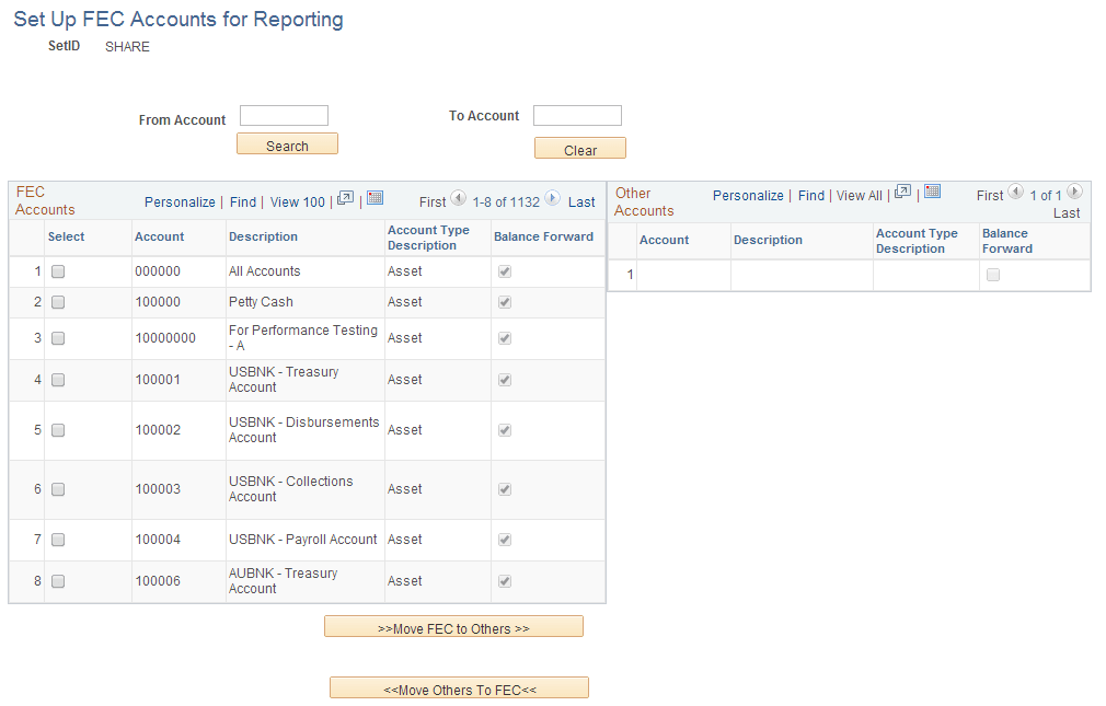

Set Up FEC Accounts for Reporting Page
Use the Set Up FEC Accounts for Reporting page (FEC_SETUP) to add or remove accounts used to select data extracted into the FEC audit file.
Navigation:
Statutory Reports, and then FEC Audit Files FRA, and then Set Up FEC Accounts France
This example illustrates the fields and controls on the Set Up FEC Accounts for Reporting page. You can find definitions for the fields and controls later on this page.
Field or Control Description
SetID
Select the Set ID to set up the group of accounts.
Exclude Type 8 and 9 Accounts
Select this check box to exclude accounts starting with numbers 8 and 9 from the data load process being entered into the FEC Account table.
Populate from Account
Click the Populate from Account button to load associated data into the FEC Account table. Select this option if the accounts you are reporting are stored in the ACCOUNT ChartField.
Note: This button is only displayed when loading data for the first time, for the selected SetID.
Populate from Alternate Account
Click the Populate from Alternate Account button to load associated data into the FEC Account table if a statutory chart of accounts exists. Select this option if the accounts you are reporting are stored in the ALTACCT ChartField.
From Account
Enter the beginning account number to search and display for a range of accounts.
To Account
Select the ending account number to search and display for a range of accounts.
Clear
Click to remove all FEC accounts from the FEC Accounts grid and tables.
Account Type Description
Displays the account type.
Balance Forward
Indicates if the account has carry forward balances.
Move FEC to Others
Select an account from the FEC Accounts grid and click the Move FEC to Others button to move it to the Other Accounts grid. This will exclude the selected accounts from reporting in the FEC File.
Move Others To FEC
Select an account from the Other Accounts grid and click the Move Others To FEC button to move it to the FEC Accounts grid. This will enable the selected accounts for reporting in the FEC File.

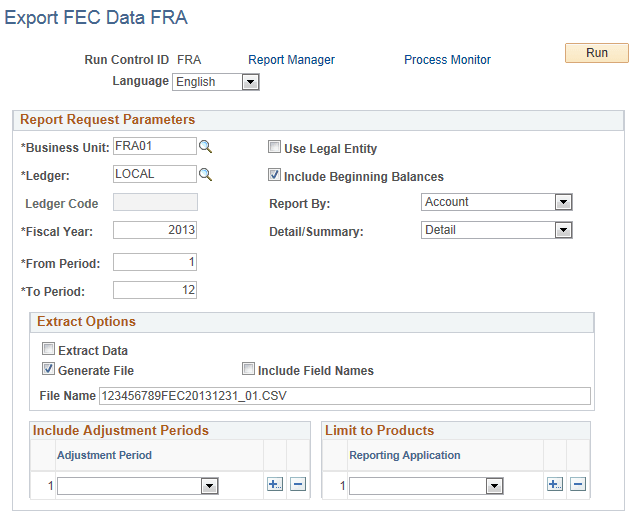

Export FEC Data FRA Page
Use the Export FEC Data FRA (RUN_FEC_EXPORT) page to Run the FEC export process and extract data into the FEC Audit file in the prescribed format.
Navigation:
Statutory Reports, and then FEC Audit Files FRA, and then Export FEC Data France
This example illustrates the fields and controls on the Export FEC Data FRA page. You can find definitions for the fields and controls later on this page.
Language
Select the language used to extract description information.
Business Unit
Select the general ledger Business Unit from which to export data.
Use Legal Entity
Select this check box to allow multiple GL Business Unit to be grouped into a single legal entity and to extract data from all such business units. This selection will also override any applicable row-level security for a particular GL Business Unit and will allow access to all GL Business Units in the legal entity.
In this case, data will be exported for all GL Business Units that belong to the entered GL Business Unit.
For more information about legal entities, please refer toApplication Fundamentals: Organizational and Legal Categorization of Transactions .
Ledger
Select the ledger from which to export data.
Include Beginning Balances
Select this check box to extract beginning balances from the Beginning Balance Journals.
Beginning balances are assumed to have been established through a Beginning Balance Journal. Beginning balances will always refer to the beginning balance of the first period of the entered Fiscal Year. For more information about Beginning Balance Journals, please refer to PeopleSoft General Ledger: Closing Rules - Journal Options Page.
Ledger Code
Enter the ledger code, if applicable.
Note: This field is only available for entry if the Book Code Feature is enabled on the Installation Options - Overall page.
For more information about Book Codes and Ledger Codes, please refer to Application Fundamentals: Understanding PeopleSoft ChartFieldsApplication Fundamentals: Entering and Maintaining ChartField Values
Report By
Select Account or Alternate Account as shown on the FEC Setup Accounts page.
When you report by account, you must have Accounts populated in the FEC Accounts table. Likewise, you must have Alternate Accounts populated in the FEC Accounts table when you report by alternate account.
Fiscal Year
Enter a fiscal year from which to select data.
Detail/Summary
Select Summary only if your company is exempted from reporting transaction details. Otherwise, select Detail.
If you select the Detail option, accounting transactions will be reported from the product accounting transaction tables (and from the Journal tables for transactions entered manually within General Ledger). If the Summary option is chosen, summarized accounting information from the General Ledger Journal tables will be reported for all products.
From Period
Enter a starting accounting period from which to export data.
To Period
Enter an ending accounting period from which to export data.
Extract Data
Select this check box to extract data into staging tables.
You must first extract the data into staging tables, from where it can be exported into the FEC audit file. Selecting this option separately from the Generate File option allows you to distribute the workload over several processes. For example, you can extract the data first for specific products and for specific periods before exporting the data into the FEC audit file, in a different process.
Generate File
Select this check box to extract data from staging tables into an output file.
You must first extract the data into staging tables, from where it can be exported into the FEC audit file. Selecting this option separately from the Extract Data option allows you to distribute the workload over several processes. For example, you can run an individual process that will only export the data from the staging tables after you have previously loaded the data into the staging tables through one or several separate processes.
Include Field Names
Select this check box to include field names in the first line of the final output file.
File Name
Enter a name for the final output file, along with the .CSV suffix, as part of the file name; this action is mandatory. The Process Scheduler determines the path for this file. The file produced by the export process is a delimited file, using the | character as the delimiter. For more information, please refer to “PeopleCode Built-in Functions and Language” in PeopleTools: PeopleCode Language Reference.
You must enter the correct file name in the prescribed format, SirenFECYYYYMMDD_AB, where Siren corresponds to the Legal Company Number of the organization. Following are examples for FEC audit file names (123456789 to be replaced by your SIREN number):
  • 123456789FEC20131231_01 : Accounting entries for the January accounting period of the fiscal year that ended on December 31, 2013.
  • 123456789FEC20131231_02: Accounting entries for the February accounting period of the fiscal year that ended on December 31, 2013.
  • 123456789FEC20131231_Q1: Accounting entries for the first quarter of the fiscal year that ended on December 31, 2013.
French Tax authorities require amount fields in the FEC French Audit File to include a comma as a decimal separator and no thousands separator. You must make this change on the Personalize Regional Settings page.
