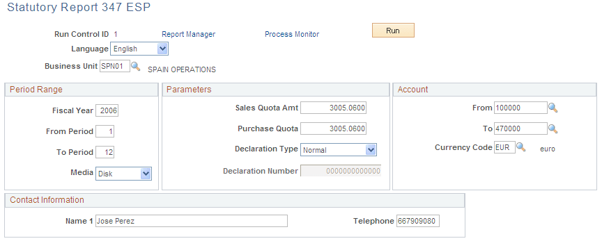

Page Used to Generate the Spanish Statutory Report File
Statutory Report 347 ESP Page
RUN_LC_CNTL
Creates a file consisting of a list of domestic vendors and customers with whom your company conducted transactions greater than a specified value for the Spanish authorities. A company has to declare transactions larger than 3.005,06 Euros.
Use the Statutory Report 347 ESP page (RUN_LC_CNTL) to creates a file consisting of a list of domestic vendors and customers with whom your company conducted transactions greater than a specified value for the Spanish authorities.
Navigation:
Statutory Reports, and then Statutory Report 347 Spain,
This example illustrates the fields and controls on the Statutory Report 347 ESP page. You can find definitions for the fields and controls later on this page.
Field or Control Description
Business Unit
Select the appropriate business unit that contains the transactions required for this report.
Fiscal Year
Select the fiscal year that corresponds to the Declaration Fiscal Year of the report.
From Period and To Period
Select a beginning and ending period to apply to the transactions for this report.
Media
Select the type of media for delivering this report: Disk, Tape, or Electronic Transmission.
Sales Quota Amt (sales quota amount)
Specify a minimum amount. The file includes a list of customers with whom the selected business unit conducts transactions greater than this value.
Purchase Quota
Specify a minimum amount. The file includes a list of vendors with whom the selected business unit conducts transactions greater than this value.
Declaration Type
Select one of the following:
  • Normal: Defines the submission of a regular report.
  • Complementary: Defines additional information to a previously submitted report.
  • Substitute: Replaces a previously submitted report. This selection requires you to enter the declaration number of the previously submitted report.
From and To
Enter account numbers that apply to the report's transactions.
Currency Code
Enter the currency for the submitted amount.
Contact Information
Enter one or more names and telephone numbers for the individuals in your organization responsible for submitting the report.

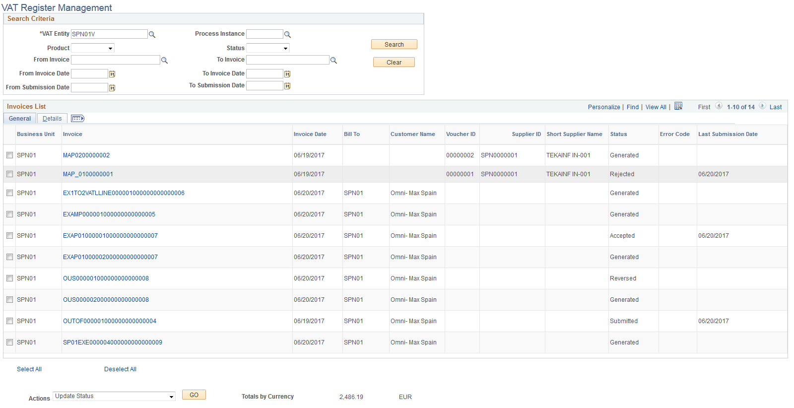

VAT Register Management Page
Use the VAT Register Management page (SII_VAT_REG_MGT) to manage and track VAT Register status.
Navigation:
VAT and Intrastat, and then Value Added Tax, and then VAT Processes, and then Spain Online VAT Register, and then VAT Register Management
This example illustrates the fields and controls on the VAT Register Management Page. You can find definitions for the fields and controls later on this page.
VAT Entity
Enter the VAT entity to manage and track.
Status
View the status displayed.
Error Code
View the error code displayed
Action
Select an invoice to update error code or status.
Update Error Code
Select an error code from the large list available.
Change Status
Select a status. The available options are:
  • Accepted
  • Accepted with Error
  • Error
  • Generated
  • Manual
  • Ready
  • Rejected
  • Reversed
  • Submitted
If you want to regenerate a file, as a modification (A1) change status to Ready or as an addition (A0) change status to Reversed. If you want to submit a rejected or erroneous transaction to the tax agency portal directly, change status to Manual in PeopleSoft.

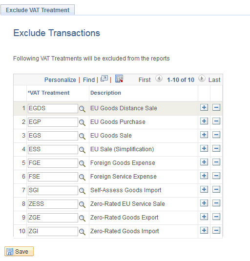

Exclude Transactions Page
Use the Exclude Transactions page (ITA_VAT_TRTMNT_PG) to enter VAT Treatments to be excluded from reports.
Navigation:
Set Up Financials/ Supply Chain, and then Common Definitions, and then VAT and Intrastat, and then Value Added Tax, and then Italian Trading Partner Report, and then Setup, and then Exclude Transactions Italy Rpt
This example illustrates the fields and controls on the Exclude Transactions Page. You can find definitions for the fields and controls later on this page.
VAT Treatment
Select a VAT treatment to exclude.

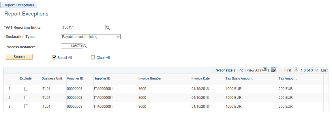

Report Exceptions Page
Use the Report Exceptions page (ITA_RPT_EXCEP_PG) to mark one or more transactions as exceptions and exclude from reporting.
Navigation:
VAT and Intrastat, and then Value Added Tax, and then VAT Processes, and then Italian Trading Partner Report, and then Report Exceptions Italy
This example illustrates the fields and controls on the Report Exceptions Page. You can find definitions for the fields and controls later on this page.
VAT Reporting Entity
Select the Italian VAT reporting entity.
Declaration Type
Select the declaration type. The available options are:
  • Payable Invoice Listing.
  • Receivable Invoice Listing.
Process Instance
Select a process instance for the given reporting entity.
Exclude
Select a transaction to exclude from reporting.

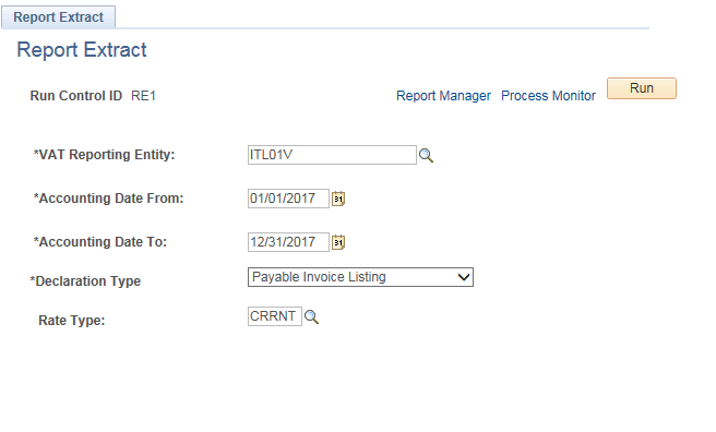

Report Extract Page
Use the Report Extract page (ITA_RPT_EXTRACT) to extract data into Reporting Tables.
Navigation:
VAT and Intrastat, and then Value Added Tax, and then VAT Processes, and then Italian Trading Partner Report, and then Report Extract Italy
This example illustrates the fields and controls on the Report Extract Page. You can find definitions for the fields and controls later on this page.
Report Extract Page
Select the Italian VAT reporting entity for which data should be extracted.
Accounting Date From
Select the accounting start date from which the report needs to be extracted.
Accounting Date To
Select the accounting end date until which the process needs to retrieve the data.
Note: According to Italian Legislative standards, Accounting From and To dates are on quarterly basis, but user can select dates based on the requirement.
Declaration Type
  • Payable Invoice Listing: Retrieves Payables data only.
  • Receivable Invoice Listing: Retrieves Receivables and Billing invoice data only.
Rate Type
Select the appropriate rate type.
