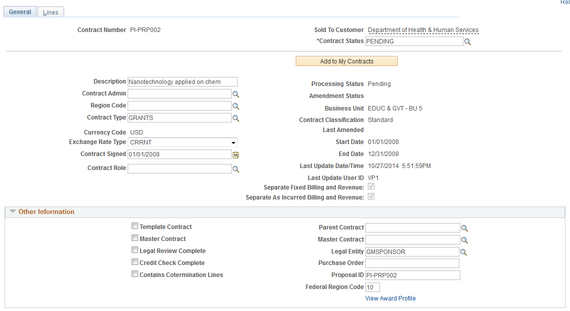

Use the Contract - General page (CA_HDR_PNL) to access contract information and change contract status to Active.
Navigation:
Customer Contracts, and then Create and Amend, and then Define Contract General Info
Contract - General page (1 of 2) This example illustrates the fields and controls on the Contract - General page (1 of 2). You can find definitions for the fields and controls later on this page.
Contract - General Page (1 of 2)

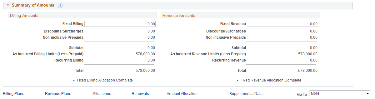

Contract - General page (2 of 2) This example illustrates the fields and controls on the Contract - General page (2 of 2). You can find definitions for the fields and controls later on this page.
Contract - General Page (2 of 2)
Instructions on using this page appear in the PeopleSoft Contracts documentation.
Field or Control Description
Contract Status
Displays the contract status. When the status is changed to Active, the FA activity rate status is changed to Ready on all activities that have the Ready at Activation check box selected and are associated with the contract.
For more information, see Facilities Admin Options Page

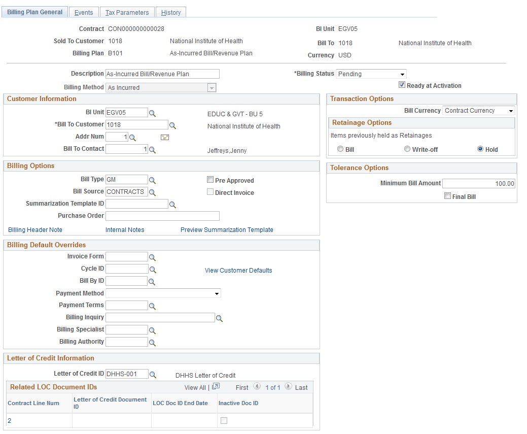

Use the Billing Plan General page (CA_BP_GEN_INFO) to change the billing status to Ready.
Navigation:
Customer Contracts, and then Create and Amend, and then General Information, and then Lines
Select the Detail tab, and then click the link under the Billing Plan column heading.
This example illustrates the fields and controls on the Billing Plan General page. You can find definitions for the fields and controls later on this page.

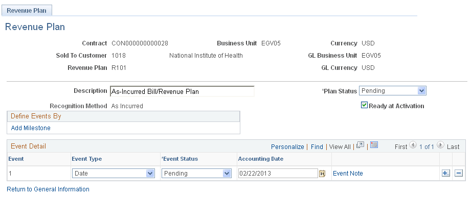

Use the Revenue Plan page (CA_ACCTPLAN) to change the revenue recognition status to Ready.
Navigation:
Select the Detail tab, and then click the link under the Revenue Plan column heading.
This example illustrates the fields and controls on the Revenue Plan page. You can find definitions for the fields and controls later on this page.
Revenue Plan page
Instructions on using the Revenue Plan page appear in the PeopleSoft Contracts documentation.
