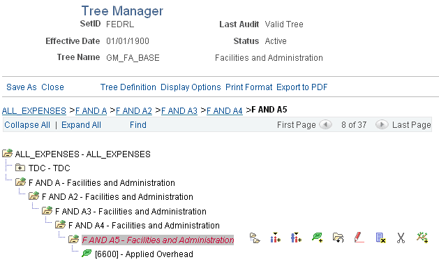

F&A Base Account Tree
The sole function of the F&A base tree is to calculate F&A expenses based on actual expenses that post to the accounts that are identified on the tree. This process happens during the post-award phase. You need to define a tree with node values that represent each base type that you are using, including:
  • TDC (Total Direct Costs).
  • MTDC (Modified Total Direct Costs).
However you set up your tree, the base node values that you assign on the tree must also be the same base node values that you indicate on your F&A setup pages. If the value does not match, the system cannot find the base node to use to calculate F&A, and your F&A process will not function correctly.
PeopleSoft Grants delivers a sample F&A base tree that you can refer to as a model. It is delivered under the FEDRL SetID. The tree name is GM_FA_BASE.
To access this tree, select Tree Manager, and then Tree Manager.
This example illustrates the fields and controls on the Example of the GM_FA_BASE tree. You can find definitions for the fields and controls later on this page.
If the institution has exclusionary accounts or identical accounts in different nodes, you can create a tree with duplicate account values. To establish this type of tree, click Tree Definition on the Tree Manager page. Then, select the Allow Duplicate Detail Values check box on the Tree Definition and Properties page.

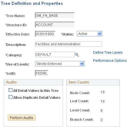

The following example illustrates the Tree Definition and Properties page.
This example illustrates the fields and controls on the Example of the Tree Definition and Properties page. You can find definitions for the fields and controls later on this page.
WARNING:
Typically, you should not have to duplicate detail values within a tree, and you can preclude people from creating them. If duplicate values are allowed, do not assign different rate types within the same project activity to bases that contain the same accounts. If you do, the F&A calculations will be incorrect.
See PeopleTools PeopleBook: PeopleSoft Tree Manager.

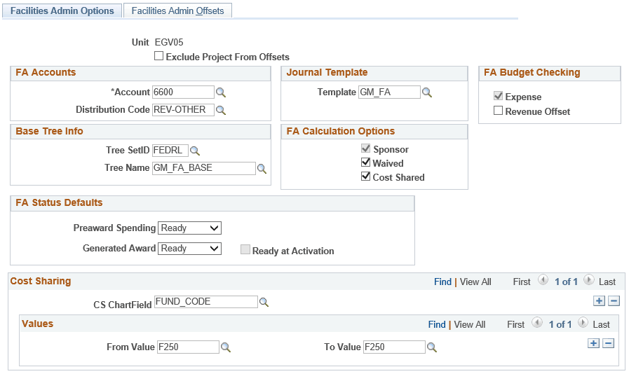

Facilities Admin Options Page
Use the Facilities Admin Options page (GM_FA_OPTIONS) to establish default F&A information that is used by the F&A process.
Navigation:
Set Up Financials/Supply Chain, and then Business Unit Related, and then Grants, and then Setup Grants F&A Options
This example illustrates the fields and controls on the Facilities Admin Options page. You can find definitions for the fields and controls later on this page.
Field or Control Description
Exclude Project From Offsets
Select this option if you want to exclude the project from the F&A offset rows created by the F&A process. If you do not select Exclude Project From Offsets, the F&A rows inherit the project from the original direct cost line being burdened.
FA Accounts
Account
Select the expense account that you want to use when F&A lines are created. All the other ChartField values in the F&A lines are inherited from the original transaction line on which F&A is being burdened.
Distribution Code
Displays the distribution code. This value defines the F&A Offset account that is to be used in F&A processing. This value should be a revenue account.
Journal Template
Template
Select the journal template that you want to use to feed the F&A accounting entries from PeopleSoft Grants to PeopleSoft General Ledger.
FA Budget Checking
Select the type of F&A (Facilities and Administration) transaction lines that will be budget checked.
Base Tree Info
Tree SetID
Select the SetID or business unit that you want the system to use as a base for calculating F&A expenses.
Tree Name
Select the account on the tree that you want the system to use to determine the F&A base amounts when the system calculates F&A.
FA Calculation Options
The options that you select here enable the institution to choose the types of F&A that you want to calculate and maintain in PeopleSoft Grants. Options are:
  • Sponsor: This value is always selected and cannot be deselected. Sponsor F&A costs are stored in both the Project Resource table (PROJ_RESOURCE) and in PeopleSoft General Ledger.
  • Waived and Cost Shared: These are optional computations and are stored only within the Project Resource table.
FA Status Defaults
These fields are used to select default options during the Award Generation process.
Preaward Spending
Select the preaward spending status. The status selected is used as the default option in the Project Activity FA Rates page during the Award Generation process when the Pre-award spending check box is selected.
The available options are:
  • Ready
  • Pending
  • Blank
Generated Award
Select the spending status. The status selected is used as the default option in the Project Activity FA Rates page during the Award Generation process when the Pre-award spending check box on the Generate Award run control page is not selected.
  • Ready
  • Pending
  • Blank
For more information, see Generate Award Page
Ready at Activation
Select the check box to ensure that the Ready at Activation check box is selected as the default option on the Project Activity FA Rates page. This selection allows you to control whether or not the FA Rate status is changed to Ready, when the status for the Contract the activity is assigned to is changed from Pending to Ready.
The Ready at Activation check box is available for editing only when the Generate Award option is Pending.
Cost Sharing
CS ChartField (cost-sharing ChartField)
Indicate the values for the ChartFields that identify transactions as cost sharing when they are used (for example, FUND_CODE).
Values
From Value
Select the ChartField value that you want to designate for cost-shared transactions.
When the line comes into PeopleSoft Project Costing, the cost-shared line is assigned a unique analysis type for reporting, analysis, and billing purposes.
To Value
Select a value that is greater than the one that is entered in the From Value field to code cost-shared transactions to a range of values.
The system does not accept a value that is less than the one in the From Value field.
To code cost-shared transactions to only one department, class, fund, or program, enter the same value that is in the From Value field.
If the institution uses a combination of ChartFields and values to define what combinations constitute cost sharing, enter multiple cost-sharing ChartFields and from and to values.

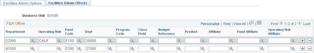

Facilities Admin Offsets Page
Use the Facilities Admin Offsets page (GM_FA_OFFSET) to establish links between departments and operating units, funds, programs, classes, budgets, products, and affiliates.
Navigation:
Set Up Financials/Supply Chain, and then Business Unit Related, and then Grants, and then Setup Grants F&A Options, and then Facilities Admin Offsets
This example illustrates the fields and controls on the Facilities Admin Offsets page. You can find definitions for the fields and controls later on this page.
FA Offset
Department, Operating Unit, Fund Code, Dept, Program Code, Class Field, Budget Reference, Product, Affiliate, Fund Affiliate, and Operating Unit Affiliate
At the project level, you identify the departments and the percentage share associated with each of them. The F&A process then looks to the F&A Options page to identify the offsetting chartfields that you associate with each department.
Within this page, you identify for each department the offsetting chartfields that should be used in creating the Offset F&A Account (OFA, or revenue) lines associated with the F&A transactional processing.
For each field, select a value to which you want the system to offset F&A transactions. The Department field is the F&A department. Enter any department ID from the department chartfield in the Dept field that is located to the right of the Fund Code.
Note: For searches, the system uses the value that you enter for the first department ID.

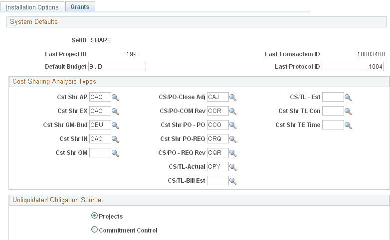

Installation Options - Grants Page
Use the Installation Options - Grants page (INSTALLATION_CSR) to establish cost-sharing analysis types for each feeder system with which you plan to use the PeopleSoft Grants cost-sharing features.
This page is also used to indicate that you can include optional attachments, and to determine the source for calculating unliquidated obligation balances for the Federal Financial Report.
Navigation:
Set Up Financials/Supply Chain, and then Install, and then Installation Options, and then Grants
This example illustrates the fields and controls on the Installation Options - Grants page. You can find definitions for the fields and controls later on this page.
Use the Cost Sharing Analysis Types group box to establish cost-sharing analysis types for each feeder system with which you plan to use the PeopleSoft Grants cost-sharing feature.
This table lists some of the cost-sharing analysis types that are defined for specific feeder systems and delivered with PeopleSoft Grants:
Feeder System Cost-Sharing Analysis Type
Accounts Payable
CAC
General Ledger
CGE
Budget
CBU
Purchasing - Purchase Orders
CCO
Time & Labor
CPY
Purchasing - Close Adjustment
CAJ
Purchasing - Commitment Reversal
CCR
Purchasing - Requisition Reversal
CQR
Based on the feeder systems in which the transactions originated, the system automatically assigns a cost-sharing analysis type to a transaction that includes designated cost-sharing ChartFields.
This table lists feeder systems and the fields to which they correspond on the Installation Options - Grants page:
Feeder System Field
Accounts Payable
Cst Shr AP
Expenses
Cst Sh EX
Grants Budget
Cst Shr GM-Bud
Inventory
Cst Shr IN
Order Management
Cst Shr OM
Purchasing - Close Adjustments
CS/PO-Close Adj
Purchasing - Commitment Reversals
CS/PO-COM Rev
CS/PO - PO
Purchasing - Requisitions
CS/PO-REQ
Purchasing - Requisition Reversals
CS/PO-REQ Rev
Time & Labor Actuals
CS/TL-Actual
Time & Labor Billing Estimate
CS/TL-Bill Est
Time & Labor Estimate
CS/TL - Est
Time & Labor Contractors
Cst Shr TL Con
Time & Expense Time
Cst Shr TE Time
By assigning a distinct analysis type to cost-shared transactions, PeopleSoft Grants enables you to track the feeder systems from which the cost-sharing transactions originated. PeopleSoft Grants also enables to calculate and track F&A expenses on cost-shared amounts.
The system assigns all cost-sharing F&A costs with an analysis type of CFA (Cost-Sharing Facilities and Administration). To activate the cost-shared F&A calculation, navigate to the Facilities Admin Options page (select Setup Financials/Supply Chain, and then Business Unit Related, and then Grants, and then Setup Grants F&A Options) and select the Cost Shared check box. When this is activated, the system calculates F&A on direct cost-shared amounts (assuming that the accounts are in the F&A base) with an analysis type of CFA.
The system uses either the institution's F&A rate or sponsor's F&A rate for calculating the cost-sharing F&A. To determine which rate to use, the system looks at the Waived FA Calc Method group box on the Project Activity - Definition page (select Grants, Awards, Project Activity, Definition). If the Institution Minus Funded check box is selected, the system uses the institution's F&A rate for calculating the cost-sharing F&A. If the Sponsor Minus Funded check box is selected, the system uses the sponsor's F&A rate for calculating the cost-sharing F&A.
