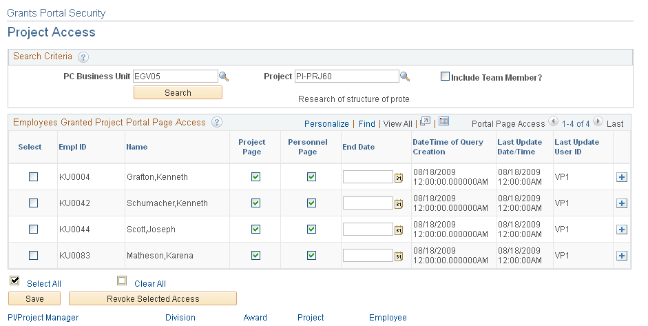

Grants Portal Security - Project Access Page
GM_PT_ACC_LEVEL_2
Set up access to the Grants portal by project.

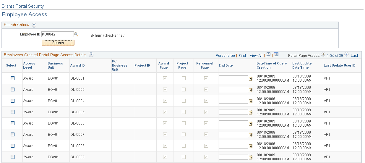

Grants Portal Security - Employee Access Page
GM_PT_ACC_LEVEL_4
Set up access to the Grants portal by employee.

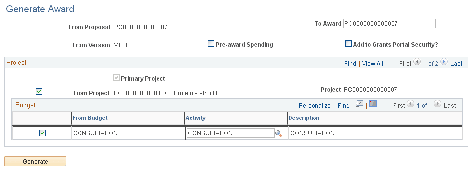

Generate Award Page
GM_AWD_SETUP
Add awards and projects to Grants portal security tables.

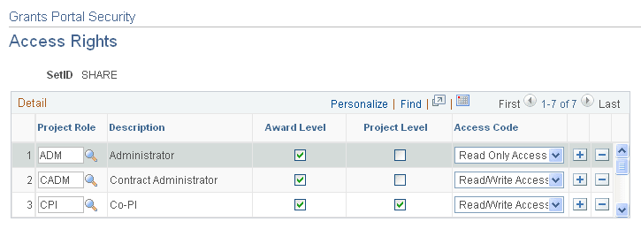

Grants Portal Security - Access Rights Page
Use the Grants Portal Security - Access Rights page (GM_PT_ACCESS) to set up access rights by role.
This setup is required to access the Grants portal.
Navigation:
Set up Financials/Supply Chain, and then Security, and then Setup Grants Portal Security
This example illustrates the fields and controls on the Grants Portal Security - Access Rights page. You can find definitions for the fields and controls later on this page.
To access the Grants portal, this setup page is required.
Use this page to set up access rights by SetID and project role. If a role is granted Read/Write Access on this page, then an employee who has that role can add additional employees on any security assignment page.
For example, if employee 001 has a project role of CPI (co-principal investigator), and the CPI role has a Read/Write Access value in the Access Code field on the Grants Portal Security - Access Rights page, then employee 001 can assign portal access to additional employees on the PI/Project Manager Access page.
Field or Control Description
Project Role
Enter the role of the employee who is associated with the grant or project.
Award Level
Select to enable the role to have access to awards.
Project Level
Select to enable the role to have access to projects.
Access Code
Select one of these values:
  • No Access: Prevent access to an employee who has that role.
  • Read Only Access: Enable an employee who has that role to view security rights.
  • Read/Write Access: Enable an employee who has that role to view, add, and modify employees on the PI/Project Manager Access page.

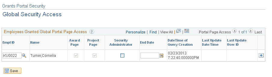

Grants Portal Security - Global Security Access Page
Use the Grants Portal Security - Global Security Access page (GM_PT_ACC_LEVEL_0) to set up global access to the Grants portal.
Use this page to determine the employees who have global access to the portal.
Navigation:
Grants, and then Grants Portal, and then Security Access, and then Grants Portal Global Access
This example illustrates the fields and controls on the Grants Portal Security - Global Security Access page. You can find definitions for the fields and controls later on this page.
Use this page to grant global security authorization to users. This page enables users (Emp ID 1) to have access to all awards and projects in the Grants portal. If you select the Security Administrator check box, the employee can assign distributed security access to other users to view portal pages.

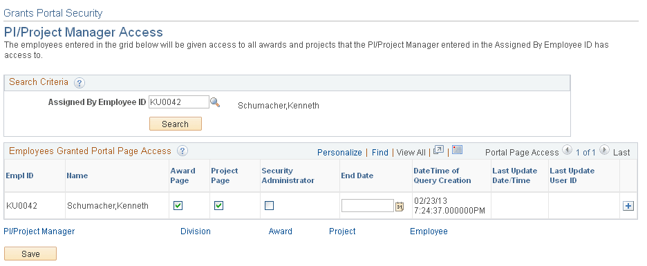

Grants Portal Security - PI/Project Manager Access Page
Use the Grants Portal Security - PI/Project Manager Access page (GM_PT_ACC_LEVEL_1) to set up access to the Grants portal for principal investigators and project managers.
Navigation:
Grants, and then Grants Portal, and then Security Access, and then GM Portal Security Access
This example illustrates the fields and controls on the Grants Portal Security - PI/Project Manager Access page. You can find definitions for the fields and controls later on this page.
Use this page to grant portal access to additional employees. The PI or PM is entered in the Assigned By Employee ID field and is the Assigned By Emp ID in the Level 1 table. The employees who are added to the EmplID field in the grid are the same as the Employee ID in the Level 1 table.
Employees who are entered in the grid are granted access to the same awards and projects that the employee entered in the Assigned By Employee ID field has access to and at the same level. However, you can deselect the Award Page and Project Page check boxes to remove access to the awards and projects.

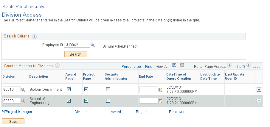

Grants Portal Security - Division Access Page
Use the Grants Portal Security - Division Access page (GM_PT_ACC_LEVEL_1) to set up access to the Grants portal by division.
Navigation:
Select Grants, and then Grants Portal, and then Security Access, and then GM Portal Security Access and click the Division link.
This example illustrates the fields and controls on the Grants Portal Security - Division Access page. You can find definitions for the fields and controls later on this page.
Use this page to grant access to the employee entered in the Search Criteria section. The Division field is the same as the Subdivision field on the Project Department page.

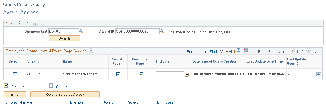

Grants Portal Security - Award Access Page
Use the Grants Portal Security - Award Access page (GM_PT_ACC_LEVEL_2) to set up access to the Grants portal by award.
Navigation:
Select Grants, and then Grants Portal, and then Security Access, and then GM Portal Security Access and click the Award link.
This example illustrates the fields and controls on the Grants Portal Security - Award Access page. You can find definitions for the fields and controls later on this page.
Use this page to grant access to employees by business unit and award ID. This page also grants access to the projects of the award specified in the Award ID field. If you use the Grants Portal Security - Global Access page, the Grants Portal Security - PI/Project Manager Access page, or the Grants Portal Security - Division Access page to add employees, this page is prepopulated with those employee IDs.
Any changes made to the Grants Portal Security - Award Access or the Grants Portal Security - Project Access pages overrides entries made to the Grants Portal Security - PI/Project Manager Access page and the Grants Portal Security - Division Access page.
Business Unit
Select a business unit that represents the award business unit.
Award ID
Select the ID of the award to which you want to grant access.
Note: Only awards that the logged in employee has access to appear in the award prompt.
Search
Click to search for employees after entering a value in the Business Unit and Award ID fields. If the system does not find results, the system populates the grid with:
  • All employees on the project team whose role in security allows access to the award.
    If the project team member has a role setup in the Grants Security page and that role has award access, then that team member appears in the grid.
  • The contract administrator.
  • The Grants contract administrator.
Select
Select a check box to revoke access to the award for the employee.
EmpID
Select employees to grant access to the award.
Award Page
Select to allow the employee ID in the grid to have access to the same Award Summary and Award Detail pages to which the assigned by employee ID has access. A row is created in the Level 2 table. When this page is saved, the system adds all projects that are associated with the award into the Level 3 table.
Deselect to remove access to a specific award. This field is considered an override field to a level 1 setup page. For example, a principal investigator grants access to employee KU44 using the Grants Portal Security - PI/Project Manager Access page (level 1). This grants employee KU44 access to three awards. These awards appear on the Grants Portal Security - Award Access page with the Award Page check box selected. If the PI wants to remove access to one of the awards, the PI can deselect the Award Page check box for that award.
This option should be used instead of the Revoke Selected Access button to provide the employee access to personnel information for the project but remove access to the Award page. For example, if the Award Page check box is deselected on the Grants Portal Security - Award Access page and the Personnel Page check box is selected on the Grants Portal Security - Project Access page, then the employee continues to have access to personnel information for the project.
Personnel Page
Select to indicate that the employee can view personnel information on the Personnel Summary and the Personnel Cost Details pages for the project. If the user selects this check box, the system automatically selects the personnel flag for all projects that are associated with this award on the Grants Portal Security - Project Access page.
End Date
Enter a date that represents the last date that the employee has access to the award through the portal. For example, if the employee can access award data through the portal until the end of the year, then enter December 31, YYYY as the end date.
Note: This value does not affect the end date on the page.
Creation Date/Time
Displays the date and time that the employee was granted access to the award.
Last Update Date/Time
Displays the date and time that the employee's record was last updated.
Last Update User ID
Displays the ID of the user who last updated the employee's record.
Click after selecting multiple rows to revoke the employee's access to the award. After clicking this button, enter the access revoke date, and click OK. The end date is updated for all selected rows.
Note: This option only revokes access to the award, not the project that is attached to the award.
Use the Grants Portal Security - Project Access page (GM_PT_ACC_LEVEL_2) to set up access to the Grants portal by project.
Navigation:
Select Grants, and then Grants Portal, and then Security Access, and then GM Portal Security Access and click the Project link.
This example illustrates the fields and controls on the Grants Portal Security - Project Access page. You can find definitions for the fields and controls later on this page.
Use this page to grant access to employees by business unit and project ID. If you use the Grants Portal Security - Global Access page, the Grants Portal Security - PI/Project Manager Access page, or the Grants Portal Security - Division Access page to add employees, this page is prepopulated with those employee IDs.
Business Unit
Select a business unit that represents the project business unit.
Project ID
Select the ID of the project to which you want to grant access. Only projects that the logged in employee has access to appear in the prompt list.
Include Team Member
Select to populate the grid with all project team members. This option streamlines the process of adding multiple employees to the grid.
Search
Click to search for employees after entering a value in the Business Unit and Project ID fields. If no results are found, the system populates the grid with all project team members whose role in security allows access to the project.
Select
Select to revoke access to the project for the employee.
EmpID
Select employees to grant access to the project.
Project Page
Select to allow the EmpID in the grid to have access to the same Project Summary and Project Detail pages to which the assigned by employee ID has access. A row is created in the Level 3 table.
Deselect to remove access to a specific project. This field is considered an override field to a level 1 setup page. For example, a principal investigator grants access to employee KU44 using the Grants Portal Security - PI/Project Manager Access page (level 1). This field grants employee KU44 access to three projects. These projects appear on the Grants Portal Security - Project Access page with the Project Page check box selected. If the PI wants to remove access to one of the projects, the PI can deselect the Project Page check box for that project.
Personnel Page
If the Personnel Page check box is selected on the Grants Portal Security - Award Access page for the award that is associated with this project, then the Personnel Page check box is automatically selected on the Grants Portal Security - Project Access page.
Deselect this check box to prevent the employee access to the Personnel Summary and the Personnel Cost Details pages.
End Date
Enter a date that represents the last date that the employee has access to the project through the portal. For example, if the employee can access project data through the portal until the end of the year, then enter December 31, YYYY as the end date.
Note: This value does not affect the end date of the award.
Creation Date/Time
Displays the date and time that the employee was granted access to the project.
Last Update User ID
Displays the user ID who last updated the employee's record.
Click after selecting multiple rows. This action revokes the employee's access to the project. After clicking this button, enter the access revoke date, and click OK. The end date is updated for all selected rows.
Note: This option only revokes access to the project, not the awards that are attached to the project.
Use the Grants Portal Security - Employee Access page (GM_PT_ACC_LEVEL_4) to set up access to the Grants portal by employee.
Navigation:
Grants, and then Grants Portal, and then Security Access, and then Grants Portal Access Inquiry
This example illustrates the fields and controls on the Grants Portal Security - Employee Access page. You can find definitions for the fields and controls later on this page.
Use this page to display all awards and projects to which an employee has access. The only update allowed on this page is to revoke access to awards and projects. This option uses the union of the Level 2 and Level 3 tables and displays all awards and projects for an employee ID.
Employee ID
Enter the ID of the employee to view all awards and projects to which the employee has access.
Select
Select to revoke the employee's access to awards and projects.
Access Level
Displays the access level that is associated with the employee.
Business Unit
Displays the business unit associated with the award or project.
Award ID
Displays all awards to which the employee has access.
PC Business Unit
Displays the Project Costing business unit associated with the project
Project ID
Displays all projects to which the employee has access.
Award Page
Displays if the employee has access to award pages. This field is display-only.
Project Page
Displays if the employee has access to project pages. This field is display-only.
Personnel Page
Displays if the employee has access to personnel pages. This field is display-only.
End Date
Creation Date/Time
Displays the date and time that the employee record was last updated.
Click after selecting multiple rows. This revokes the employee's access to the selected award or project. After clicking this button, enter the access revoke date, and click OK. The end date is updated for all selected rows.
Alternatively, you can enter a date in the End Date column for individual awards or projects.
Generate Award Page
Use the Generate Award page (GM_AWD_SETUP) to add awards and projects to Grants portal security tables.
Navigation:
Grants, and then Proposals, and then Generate Award
This example illustrates the fields and controls on the Generate Award page. You can find definitions for the fields and controls later on this page.
Generate Award page
Oracle recommends that you use PeopleSoft security to control access to the Staging Labor Cost Data and the Staging Labor Cost Errors pages, and that the staging tables are not placed in a query access group. You should take precautions to security the labor data files while they exist on the system before loading them to the staging tables because the labor cost data files contain information that may be considered to be confidential.
Add to Grants Portal Security?
Select to grant portal security to employees who have:
  • Access rights to the Award page and the Project page, which is defined on the Grants Portal Security - Access Rights page.
  • Global access, which is defined on the Grants Portal Security - Global Security Access page.
  • Division access, which is defined on the Grants Portal Security - Division Access page.
When selected, rows are added to the Level 2 and Level 3 tables based on Grants portal security. This check box defaults to the value you selected for it on the Award Setup Definition page; if you selected this check box on the Award Setup Definition page, it is automatically selected for you here.
If deselected, all security must be granted manually.
This check box defaults option will be default to be the value which set in Award Setup definition.
Note: When this option is selected, all users that are associated with the department and division are automatically granted access to the awards and projects selected on this page. This selection eliminates the need to assign individual security using the Access Authority pages. In addition, all users who have global access receive access to the awards and projects using this process. For more information about the Add to Grants Portal Security check box on the Award Setup Definition page, see Defining PeopleSoft Grants Rules and Business Units
Pre-award Spending
Select to create the project and the activity. You can later select a proposal that had pre-award spending identified and generate the award and contract.
For more information, see Facilities Admin Options Page
Generate
Click to run the Generate Award process. If the Add to Grants Portal Security? check box is selected and a contract has been generated, then the award and project is added to portal security.
