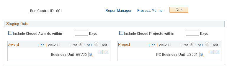

Staging Award/Project Data Run Control Page
Use the Staging Award Project Data page (GM_PT_RUN_CNTL) to load award and project data to the Grants portal.
Navigation:
Grants, and then Grants Portal, and then Staging Data, and then Portal Stage Award & Proj Data
This example illustrates the fields and controls on the Staging Award/Project Data page. You can find definitions for the fields and controls later on this page.
Use the Staging Award/Project Data (GM_PT_STAGE) process to load information such as award, project, budget, expenditure, encumbrance, preencumbrance, invoice, payment, and so on into the portal pages. This data appears on portal pages such as the Award Summary, Award Detail, Project Summary, Project Detail, Expenditure, Encumbrance, Pre-Encumbrance, and Invoices and on Payments inquiry pages. The Staging Award/Project Data (GM_PT_STAGE) process also populates the Grants Portal Award Details and Award Summary pages with the Federal Award Identification Number (FAIN).
See Viewing Award Data
When you run subsequent processes, the process deletes the existing data specified on the run control in all staging tables and then inserts new data.
Field or Control Description
Include Closed Award within Days
Select to indicate that you want to include closed awards that fall within the last x number of days, which is indicated in the Days field. All projects associated with the award are processed.
Note: The larger the number of days entered in the Days field, the larger the volume of data, which could affect performance.
Include Closed Projects within Days
Select to indicate that you want to include closed projects that fall within the last x number of days, which is indicated in the Days field.
Award – Business Unit
Select the business unit from which to select awards. All awards for the business unit and all projects that are associated with the award are processed.
Project – PC Business Unit
Select the business unit from which to select projects. All projects for the business unit are processed. Use this field for pre-award projects.
The GM_PT_RUN_CNTL process loads only those awards and projects with entry types equal to 'IN’ and 'CR.'

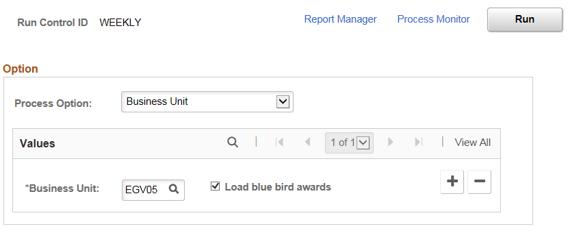

Grants Portal Security Process Run Control Page
Use the Grants Portal Security Process page (GM_PT_RUN_SECTY) to update security tables post award.
Navigation:
Grants, and then Grants Portal, and then Staging Data, and then GM Portal Security Process
This example illustrates the fields and controls on the Grants Portal Security Process page. You can find definitions for the fields and controls later on this page.
Use the PeopleSoft Grants Portal Security Application Engine process (GM_PT_SECURTY) to update portal security tales when security changes are made after the Generate Award process has run.
For example, is a security change is made in the following situations post award:
  • A project is added for an existing contract.
  • A project is deleted for an existing contract.
  • The Add to Grants Portal Security? check box was not selected, but should have been selected, during the Generate Award process.
  • When the Pre-award Spending check box is selected and the Add to Grants Portal Security? check box was not selected, but should have been selected.
If these situations occur you should run the Grants Portal Security process to update the security tables and then run the Staging Data process.
As an alternative, you can schedule the two processes to run on a regular basis, as long as the Grants Portal Security process is scheduled first and the Staging Data processes are scheduled second.
Process Option
Select one of these options:
Business Unit : When selected you must also enter the business unit.
Contract Number : When selected, you must also enter the business unit, and optionally a contract number.
Pre-Spending Project ID : When selected, you must also enter the business unit, and optionally a project ID.
Load blue bird awards
On selecting this check box, the system will add blue bird awards to the award level security table (GM_PT_ACC_LVL2) and the project level security table (GM_PT_ACC_LVL3) for the business unit entered on the page.
This check box is displayed only for Business Unit Process Option.
Process Options
When Business Unit is selected:
  • The system deletes all records from the award level security table (GM_PT_ACC_LVL2) and the project level security table (GM_PT_ACC_LVL3), where all of the associated projects are deleted for the business unit that is entered on the page.
  • The system adds all records to the award level security table (GM_PT_ACC_LVL2) and the project level security table (GM_PT_ACC_LVL3), for all of the associated projects that were added for the business unit that is entered on the page.
When Contract Number is selected:
  • The system deletes all records from the award level security table (GM_PT_ACC_LVL2) and the project level security table (GM_PT_ACC_LVL3), for the business unit and contract number entered on the page.
  • The system adds all records to the award level security table (GM_PT_ACC_LVL2) and the project level security table (GM_PT_ACC_LVL3), for the business unit and contract number entered on the page.
  • If a new contract was previously added in Grants Portal Security, the system adds all records to the award level security table (GM_PT_ACC_LVL2) and the project level security table (GM_PT_ACC_LVL3), for the business unit and contract number entered on the page.
    This option addresses the situation where the Add to Grants Portal Security? check box was not selected, but should have been selected during the Generate Award process.
When Pre-Spending Project ID is selected, and a new contract was previously added in Grants Portal Security, the system adds all records to the project level security table (GM_PT_ACC_LVL3), for the business unit and project entered on the page.
This option addresses the situation where the Pre-award Spending check box was selected and the Add to Grants Portal Security? check box was not selected, but should have been selected during the Generate Award process.
