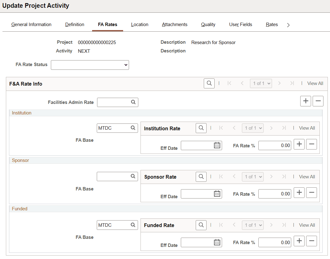

Understanding F&A Rates
Here is how the system uses F&A rates at the post-award activity level:
  • The Project Activity - FA Rates page houses the F&A bases and rates that the F&A process uses.
  • You define during implementation the values that appear in the FA Base fields in the Institution, Sponsor, and Funded group boxes on the Facilities Admin Base page.
  • The F&A base values that you enter on the Project Activity - FA Rates page must be the same as the values that you enter on the FA Base Account tree during implementation.
  • When you receive an award that is based on an existing proposal, the bases, rate type, effective dates, and rates appear by default from pre-award data in the system.
  • The sponsor FA equals the funded FA base times the funded FA rate percentage.
    The system posts to the general ledger only FA funds that the sponsor awards.
  • If you establish an award without performing the usual pre-award proposal procedures, the default effective dates and rates are based on the rate type that you enter manually.
  • You must make other modifications, such as no-cost extensions and continuations, manually.

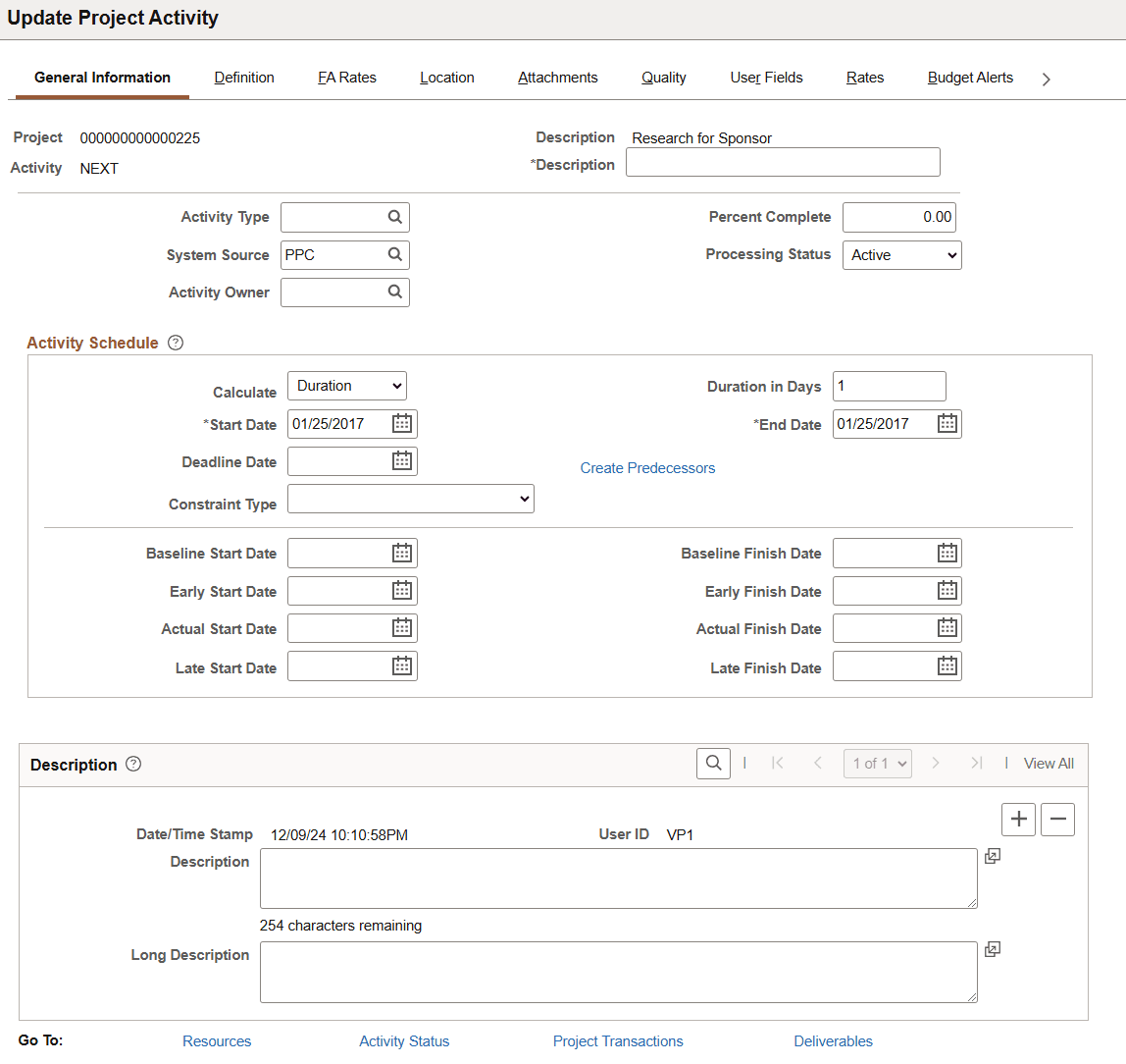

Project Activity - General Information Page
Use the Project Activity - General Information page (PROJ_ACT_DESCR) to set up project activities.
Navigation:
Grants, and then Awards, and then Update Project Activity
This example illustrates the fields and controls on the Project Activity - General Information page. You can find definitions for the fields and controls later on this page.
Instructions on using this page appear in the PeopleSoft Project Costing documentation.

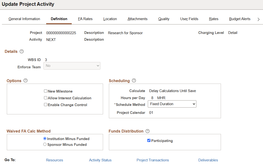

Project Activity - Definition Page
Use the Project Activity - Definition page (PROJECT_ACTIVITY) to define project activities.
Navigation:
Grants, and then Awards, and then Update Project Activity, and then Definition
This example illustrates the fields and controls on the Project Activity - Definition page. You can find definitions for the fields and controls later on this page.
Project Activity - FA Rates Page
Use the Project Activity - FA Rates page (GM_PRJ_ACT_FA) to enter F&A rate types.
Navigation:
Grants, and then Awards, and then Update Project Activity, and then FA Rates
This example illustrates the fields and controls on the Project Activity - FA Rates page. You can find definitions for the fields and controls later on this page.
Field or Control Description
FA Rate Status
Select the FA rate status. The FA rate status controls the eligibility of the activity for F&A processing. The available options are:
  • Ready: The Hold check box is displayed when you select the FA rate status as Ready. If you select the Hold check box and save the FA Rates page, then the user name and a timestamp is displayed next to the Hold check box.
  • Pending: The Ready at Activation check box is displayed when you select the FA rate status as Pending. The check box is display only. The value is populated from the Business Unit Options and you cannot edit the value on this page.
  • Cancelled
  • In Progress
  • Done
  • Blank
The FA rate status is automatically set to In Progress after the activity has been processed by F&A. The user can then change the status to Cancelled or Done.
Note: Only an activity that has a status of Ready or In Progress, and does not have the Hold check box selected, can be processed by the F&A or Retroactive F&A processes.
To set up F&A rates for post-awards:
  1. Select a facilities administration rate.
    Values include Animal Care, On Campus, Off Campus, Institutional Research, and Instruction.
  2. Select an FA base rate for the institution, the sponsor, and the funded amount.
  3. Enter multiple effective dates and F&A rate percentages for each base.
    The bases must have the same names as the tree nodes for which the calculation will be run.
  4. Click Save.
Never select the same base for two different rate types under the same activity. Likewise, if you establish a base tree with duplicate accounts, never define two bases that contain the same account under the same project activity.

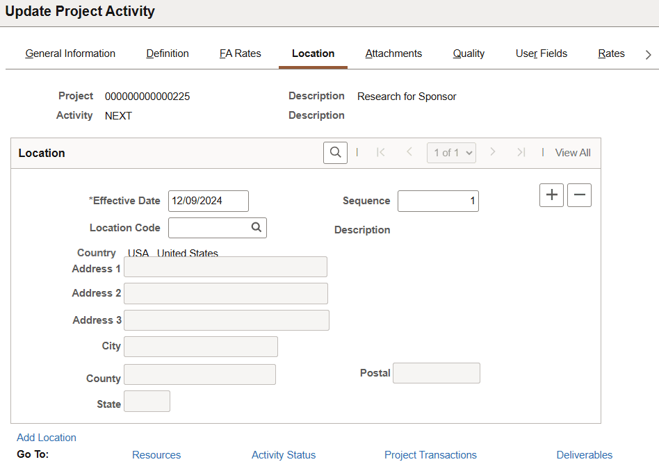

Project Activity - Location Page
Use the Project Activity - Location page (PROJ_ACT_LOCATION) to specify project activity locations.
Navigation:
Grants, and then Awards, and then Update Project Activity, and then Location
This example illustrates the fields and controls on the Project Activity - Location page. You can find definitions for the fields and controls later on this page.

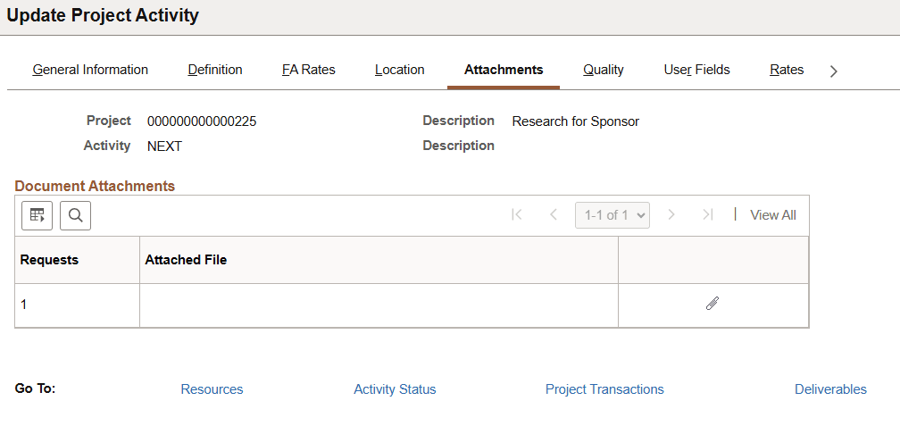

Project Activity - Attachments Page
Use the Project Activity - Attachments page (PROJ_ACT_DOC) to add attachments to the project activity.
Navigation:
Grants, and then Awards, and then Update Project Activity, and then Attachments
This example illustrates the fields and controls on the Project Activity - Attachments page. You can find definitions for the fields and controls later on this page.

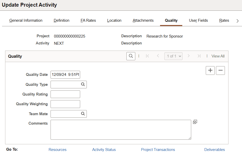

Project Activity - Quality Page
Use the Project Activity - Quality page (PROJECT_QUALITY) to rate and record quality of work for specific activities.
Navigation:
Grants, and then Awards, and then Project Activity, and then Quality
This example illustrates the fields and controls on the Project Activity - Quality page. You can find definitions for the fields and controls later on this page.

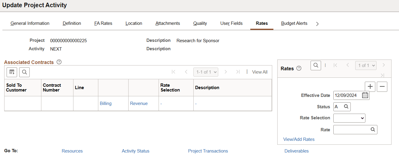

Project Activity - Rates Page
Use the Project Activity - Rates page (ACTIVITY_SERVICES) to inquire on activity contracts, billing, and revenue.
Navigation:
Grants, and then Awards, and then Update Project Activity, and then Rates
This example illustrates the fields and controls on the Project Activity - Rates page. You can find definitions for the fields and controls later on this page.
