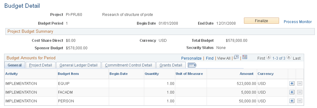

Budget Detail Page
Use the Budget Detail page (PC_BUD_DETAIL2) to enter budget amounts that are associated with a particular budget plan.
Navigation:
Grants, and then Awards, and then Project Budgets
This example illustrates the fields and controls on the Budget Detail page. You can find definitions for the fields and controls later on this page.
Budget Detail page
The Award Generation process creates budget plans. PeopleSoft Grants users should not create budget plans using the PeopleSoft Project Costing menu structure. For Blue Birds awards, the system creates budget plans programmatically when users create budget periods on the Funding page in the Award Profile component.
Field or Control Description
Finalize
Click Finalize after making changes to an active budget period. The system finalizes the plan by picking up the rows only for a budget period and not the entire plan, as in PeopleSoft Project Costing. When you click the Finalize button:
  • If PeopleSoft Commitment Control is enabled, and the general ledger groups are set up for the Commitment Control process, the system sends the transactions to PeopleSoft Commitment Control by the Projects to Commitment Control Application Engine process (PC_WRAPPER).
  • The system sends budget rows to the Project Resource table (PROJ_RESOURCE).
    Rows are sent only once. Finalizing adds rows to the Project Resource interface table and calls the Projects Interface Edit process (PC_INTFEDIT).
  • To prevent PeopleSoft Commitment Control problems and to track the history of changes to the budget, the system prevents changes to finalized budgets and displays them as display-only on the grid. You can, however, add new rows to the grid and refinalize the budget period.
See Integration Process Flows for PeopleSoft Grants and PeopleSoft Commitment Control: Integration of Commitment Control with PeopleSoft Applications
Project Budget Summary
Total Budget
Displays a rolled-up value based on the node that is selected.
General Tab
The system populates the General tab with budget details from the proposal, including amounts for the budget activities belonging to the project.
Project Detail Tab
Specify the values for the project-related fields for the PeopleSoft Grants budget rows that are displayed.
General Ledger Detail Tab
Specify the PeopleSoft General Ledger ChartField values for the PeopleSoft Grants budget rows that are displayed. When the system creates budget journals, it books the budget row amounts to the specified ChartFields.
Budgetary ChartFields can be selected on the General Ledger Detail tab.
Commitment Control Detail Tab
Displays the ledger and ledger group that the system uses to book the budget journals.
If you need to specify the type of budget row that you are posting, use the Budget Line Code field to indicate whether the budget row is Original, Adjustment, Roll Forward, and so on. Original is the default value. If you have funding source control enabled in your commitment control setup, the system displays the appropriate value here.
If any errors occur while posting to commitment control, the system stores the error rows on the Review Commitment Control page. You can find the commitment control posting error, fix the error, and resend the lines to commitment control.
Grants Detail Tab
Facilities and Administrative
Click to designate that the line is an F&A line.
Cost Sharing
Click to designate that the line is a cost-sharing line.
Instructions on defining budgets also appear in the PeopleSoft Project Costing documentation.

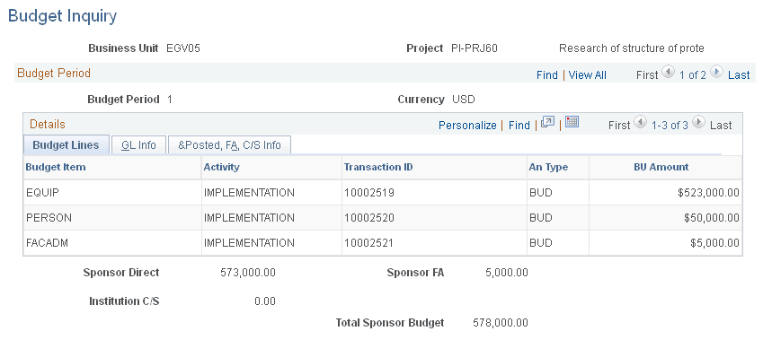

Budget Inquiry Page
Use the Budget Inquiry page (GM_PRJ_BUD_INQ) to view budget information for specific projects.
Navigation:
Grants, and then Awards, and then Project Budget Inquiry
This example illustrates the fields and controls on the Budget Inquiry page. You can find definitions for the fields and controls later on this page.
Budget Inquiry page
After you successfully post the budget journals, you can inquire on the budget. Select the GL Info and Posted, FA, and C/S Info tabs to view the budget journal IDs and the date that you posted the rows, as well as the budget header status, the ledger, and the ledger group to which you posted the journals.
