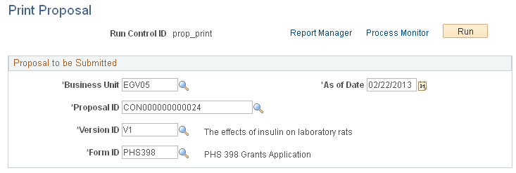

Print Proposal Page
Use the Print Proposal page (GM_PROP_PRINT_REQ) to launches the print proposal process.
Navigation:
Grants, and then Proposals, and then Print Proposal, and then Print Proposal
This example illustrates the fields and controls on the Print Proposal page. You can find definitions for the fields and controls later on this page.
Print Proposal page
To print a proposal:
  1. Enter the business unit, proposal ID, version ID, and form ID for the proposal that you want to print.
  2. Enter or select the as of date for the proposal.
  3. Click Run to initiate the GMPROP process.
  4. Select the server on which you want the job to run.
  5. Click OK to start the job on the server.
