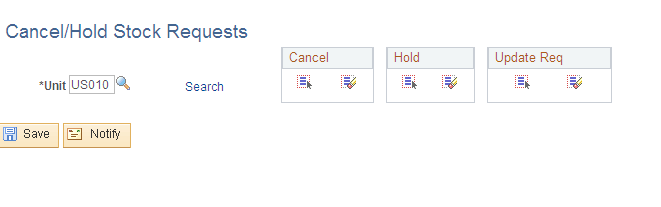

Cancel/Hold Stock Requests Page
Use the Cancel/Hold Stock Requests page (DMND_CNC_HLD_INV) to perform cancellations, apply holds, or release holds for material stock requests.
Also, if needed, you can cancel sales orders that were previously canceled in PeopleSoft Order Management.
Navigation:
Inventory, and then Fulfill Stock Orders, and then Stock Requests, and then Cancel/Hold Stock Requests
This example illustrates the fields and controls on the Cancel/Hold Stock Requests page. You can find definitions for the fields and controls later on this page.
Field or Control Description
Select All and Deselect All
In the Cancel group box, click these buttons to mark all orders (except those on hold) as canceled.
In the Hold group box, click these buttons to mark all orders (except those marked for cancellation) as on hold.
In the Update Req group box, click these buttons to indicate that all quantities from all orders sourced from a purchase requisition in PeopleSoft Purchasing should be used to update the corresponding open requisitions when the lines are canceled.
Details
Click this link to perform cancellations or change the hold status for specific demand lines associated with an order.
Cancel
Marks the order for cancellation. You must save the page to implement the cancellation. After saving, all demand lines associated with the orders marked for cancellation with a fulfillment status of Canceled. Any quantity reserved or allocated to the associated demand lines is released.
Note: If you are canceling an order that includes a kit on one of its order lines, you must cancel each of the components in the kit individually. Use the Stock Requests Inquiry page to view the status of each of the components. You can cancel any components of the kit that have not yet been picked, that have been picked, or that are not yet shipped. If the component has shipped, it cannot be canceled.
Hold
Places the order on hold, preventing unshipped demand lines associated with the order from being picked or shipped. You can also enter a Hold Code. To remove a hold on an order, deselect the check box.
You cannot apply or remove holds for order lines representing return to vendor MSRs or sales orders from PeopleSoft Order Management.
Update Req
Updates quantities on an open requisition when you are canceling orders or demand lines sourced from PeopleSoft Purchasing. This option is available only if PeopleSoft Purchasing is installed.
Hold Code
Enter a code to describe why the line is being held. Hold codes are established on the Hold Codes page
