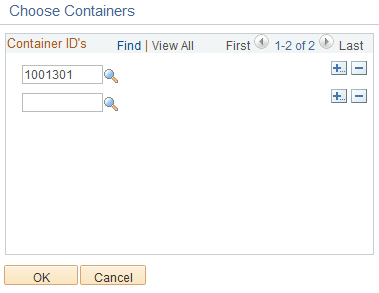

Choose Containers Page
EXPRESS_ISSUE4_INV
Select storage containers to issue.

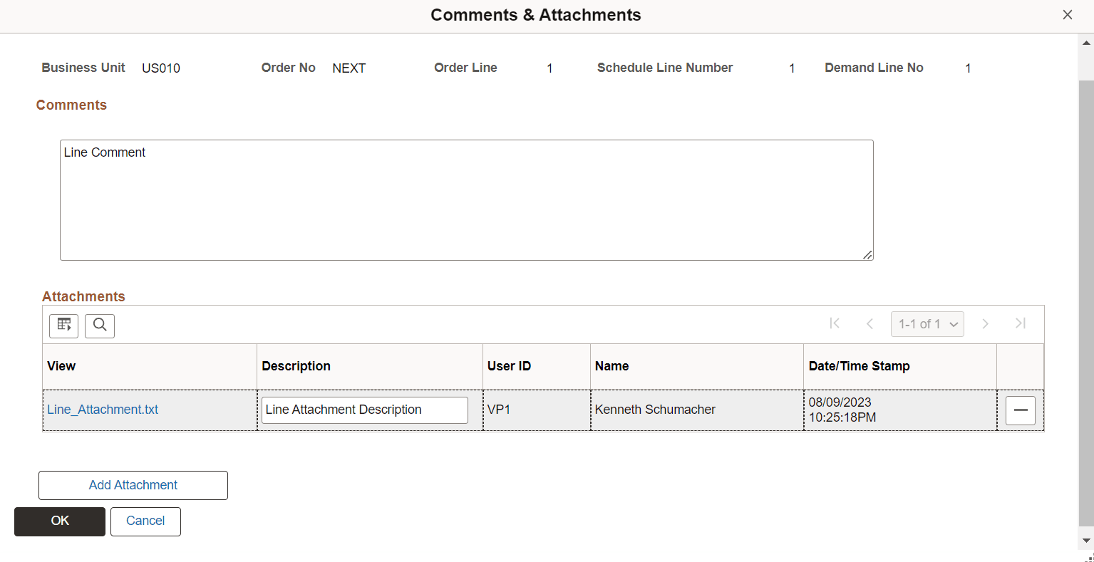

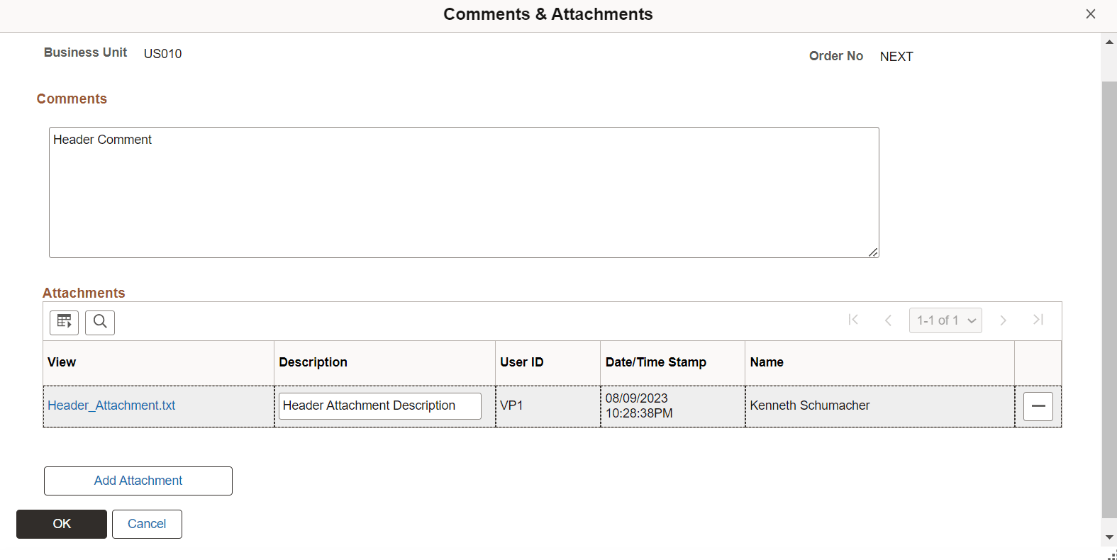

Comments & Attachments Page
Use the Comments and Attachments page (IN_HD_CMNT_ATT_SEC and IN_LN_CMNT_ATT_SEC) to add comments and upload the attachments for Express Issue header and line.
Navigation:
Click the Comments & Attachments link on the Express Issue header and Order Line Information.
This example illustrates the fields and controls on the Express Issue - Header Comments & Attachments Page. You can find definitions for the fields and controls later on this page.
This example illustrates the fields and controls on the Express Issue - Line Comments & Attachments Page. You can find definitions for the fields and controls later on this page.
Field or Control Description
Comments
Enter the comments for Express Issue Header and Line.
Displays the List of added attachments along with upload date and time, user id, and name of the up-loader.
Click the attachment file name link to view or download the attachments. You can also enter description for the added attachments.
Add Attachment
Click Add Attachment button to select and upload the attachments. You can upload multiple files at a time depending on configured attachment upload limit.
To configure attachment upload limit, see Application Fundamentals: Installation Options - Multiple Attachments Page.
Delete Attachment
(Delete)
Click Delete to remove that attachment from the list.
User can add, view, and delete the comments and attachments before Save. After Save, user can only view the comments and attachments.

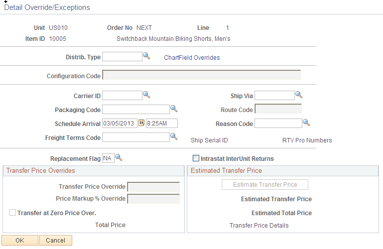

Detail Override/Exceptions Page
Use the Detail Override/Exceptions page (EXPRESS_ISSUE5_INV) to enter specific attributes for an order line or override shipping information and (for non-RTV orders) ChartField accounting information.
You can also enter a configuration code for configured items.
Navigation:
Click the Detail Override/Exceptions link on the Express Issue page.
This example illustrates the fields and controls on the Detail Override/Exceptions page. You can find definitions for the fields and controls later on this page.
Distrib Type (distribution type)
Select if you want the order line to have a different distribution type than that specified for the order.
Packaging Code
Define any specific packaging requirements for the item. Packaging codes are established on the Packing Codes page. This information appears on the Packing Instructions page when packing shipping containers.
Reason Code
Displays a user-defined reason code selected from the values that have a reason type of Shipments.
Export
Indicates that the order is an intercompany transfer requiring export documentation. This field is populated at the order header level for the ship to customer defined for the destination business unit. If you override the setting here, the system transfers the selection to the line level, where you cannot change it.
Schedule Arrival
Displays the date that the order should arrive at its destination. The scheduled arrival is linked to the scheduled shipment date. If the transfer is an interunit transfer and the user adds intransit time for the appropriate source business unit, destination business unit, and ship via, then this extra time is added to the scheduled shipment date to determine the scheduled arrival date. In the Shipping/Issues component, the arrival date is linked to the actual shipment date and time.
Note: For interunit transfers, if you change the scheduled arrival date and time, and if the destination business unit requires closure-calendar validation and processing for receiving operations as defined on the Closure Calendar page, the system validates the new scheduled arrival date and time against the closure calendar. If the arrival date coincides with a receiving closure date at the destination business unit, the system issues a warning and provides the option to keep the date or move the scheduled arrival date to the next valid date.
Ship Serial ID
Click to access the Serial ID page, where you can enter shipping serial numbers.
Defer Depletions
Select an option to override the default value for the Defer Depletions field on the demand line. The Defer Depletions value is applied when the demand line is successfully placed in the Shipped fulfillment state. The options are:
  • Override to No: Select to apply the value of N (no) to the Defer Depletions field of the demand line created on this page.
  • Override to Yes: Select to apply the value of Y (yes) to the Defer Depletions field of the demand line created on this page.
When this field is left blank, the default value is derived from the Carrier page; if there is no default value on the Carrier page then the system uses the default value on the Setup Fulfillment-Shipping page. For a complete discussion of the Defer Depletions feature, go to the "Shipping Inventory" topic, "Delaying the Billing and Costing of Inventory Shipments" section.
See Delaying the Billing and Costing of Inventory Shipments.
If you override the ship via or carrier, PeopleSoft Inventory cancels any existing transportation route assignment for the demand line.
The Intrastat Interunit Returns and Replacement fields are only available for intrastat interunit transfers. If both the source and destination business units are members of the European Union and require intrastat reporting, mark the interunit receipt as a replacement or a return. Your selections populate the Receipt Line page when the destination business unit receives the transfer order.
Replacement
This field works in conjunction with the Intrastat InterUnit Returns field. Values are:
NA: The interunit transfer is a normal transfer order or a return. This is the default value when the Intrastat InterUnit Returns option is selected.
RN (replacement of goods not returned): The transfer replaces an order that had been previously received but was scrapped or otherwise disposed of. The transfer order is reported on the intrastat return with a Nature of Transaction code indicating that it is a replacement of goods that have not been returned.
RR (replacement of returned goods): The transfer replaces an order that was returned to the source business unit. The transfer order is reported on the intrastat return with a Nature of Transaction code indicating that it is a replacement of goods that have been returned.
The interunit or intercompany transfer contains goods that were previously sent to another business unit but are now being returned. The transfer is reported on the intrastat return with a Nature of Transaction code indicating that it is a return. (If you clear this option, the transfer is a normal transfer and is reported on the intrastat return with a Nature of Transaction code indicating that it is a purchase.
If you select this option, the Replacement field value is NA (not applicable). A transfer can be a return or a replacement, but not both.
Transfer Price Overrides group box
The Transfer Price Overrides group box applies to an interunit MSR or an interunit expensed issue. The transfer price defaults to the material stock request using the transfer pricing default hierarchy. If you have selected the Allow Price/Markup Overrides check box on the Setup Fulfillment page of the source business unit, you can change the transfer price here. To display the current estimated transfer price, click the Estimate Transfer Price button on this page.
Enter an override value for the transfer price. This value is stored in the IN_DEMAND table in the TRANSFER_COST field. The override transfer price is not stored in the IN_DEMAND_TRPC table until after the Depletion process has been run.
Price Markup % Override
Enter an override markup percentage to be used instead of the markup percentage defined in the transfer pricing default hierarchy.
Define the percentage increase to the item's transfer price (or cost) in order to create a new transfer price. For example if you enter a value of 25 in this field and the item cost is 100 USD, then the transfer price is 125 USD. Be sure to enter a 25% markup as 25, not .25.
Note: Both a transfer price override and a price markup percentage override can be applied to the same demand line. The markup percentage is applied on top of the transfer price.
When you enter an override value in this field, the system records the markup using the cost element in the Default Markup Cost Element field in the Setup Fulfillment page.
Transfer at Zero Price Over.
Select to ship interunit transfers at zero cost. The source business unit records a loss for the entire cost of the shipped items. This feature enables you to ship promotional or sample items at no cost to the destination business unit. The default value comes from the transfer pricing default hierarchy, but you can override the returned value for each line of the material stock request.
Total Price
Displays the transfer price calculated for the overrides entered in this group box.
See PeopleSoft Cost Management: Applying Transfer Prices to a Material Stock Request.
Estimated Transfer Price group box
The Estimated Transfer Price group box applies to an interunit MSR or an interunit expensed issue. Any value displayed here is an estimate, since the transfer price is calculated during the Deplete On Hand Qty (Depletion) process.
Click this button to calculate the current estimated transfer price based on the transfer pricing default hierarchy.
Displays the estimated transfer price for one unit of the item. This value displays after you have clicked the Estimate Transfer Price button.
Estimated Total Price
Displays the estimated total transfer price for this demand line by multiplying the estimated transfer price by the quantity requested. This value displays after you have clicked the Estimate Transfer Price button.
Transfer Price Details
Click this link to display the Transfer Price Details page where you can view the estimated transfer price broken out by cost elements. This page is populated after you have clicked the Estimate Transfer Price button.
Use the Choose Containers page (EXPRESS_ISSUE4_INV) to select storage containers to issue.
Navigation:
Click the Choose Containers link on the Express Issue page.
This example illustrates the fields and controls on the Choose Containers page. You can find definitions for the fields and controls later on this page.
Select a container ID to associate with the order line selected on the Express Issue page. When you return to the Express Issue page, the system automatically determines the items and quantities in each container and creates an order line for each item. If the item exists in more than one container, this information appears on the main page as an additional row.
You cannot ship partial containers using this method. To ship only one item or a partial quantity within the container, use the normal method of entering order lines on the main page.
If you add a container and then decide not to ship it, return to this page to delete the row.
