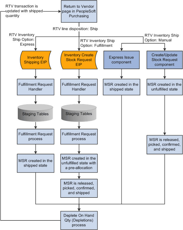

Process Flow of RTV Inventory Shipping Options
The following diagram illustrates the process flow for shipping inventory back to the supplier. The RTV transaction is entered on the Return to Vendor page in PeopleSoft Purchasing. If the RTV line disposition is Ship, then an MSR is created in PeopleSoft Inventory using the Request Type of supplier Returns. The RTV Inventory Ship Option field, also on the RTV transaction in PeopleSoft Purchasing, determines how the MSR is created in PeopleSoft Inventory. This MSR can be created by an EIP or entered manually by a user. The MSR can be created in the shipped state or created in the unfulfilled state to be released, picked, confirmed, and shipped. Once the Deplete On Hand Qty (Depletion) process is run, the RTV transaction in PeopleSoft Purchasing is updated with the shipping quantity.
Process Flow for RTV Inventory Shipping
The process flow for RTV inventory shipping includes:
  • The RTV Inventory Ship Option field is Express. This option enables a user to complete the shipment of RTV stock by simply entering and saving the RTV using the Return to Vendor page in PeopleSoft Purchasing.
    When the RTV is saved on the Return to Vendor page, the Fulfillment Request Handler generates an XML message using the INVENTORY_SHIPPING EIP and populates the inbound staging tables. This message transaction contains the data to build an MSR based on the information in the RTV. The Fulfillment Requests process retrieves the data from the staging tables and applies it to the PeopleSoft Inventory demand tables creating the MSR in the shipped state.
    Based on your fulfillment engine setup, the Fulfillment Requests process and the Deplete On Hand Quantity process can be launched automatically so that the user saves the RTV using the Return to Vendor page (one step) and then sees the shipped quantities display on the page.
  • The RTV Inventory Ship Option field is Fulfillment. This option enables a user to use one step to record the RTV and create the MSR in the unfulfilled fulfillment state. Once the MSR has been created, your warehouse personnel follow your organization's standard routine for warehouse shipments, such as, generating a pick plan, confirming picking, generating shipping documents, and so on.
    When the RTV transaction is saved on the Return to Vendor page in PeopleSoft Purchasing, the Fulfillment Request Handler generates an XML message using the INVENTORY_CREATE_STOCK_REQUEST EIP and populates the inbound staging tables. This message transaction contains the data to build an MSR based on the information in the RTV. The Fulfillment Requests process retrieves the data from the staging tables and applies it to the PeopleSoft Inventory demand tables creating the MSR in the unfulfilled state. To insure that the correct stock is returned to the supplier, you can have the system pre-allocate this MSR to identify the exact material storage location, lot, and serial ID of the rejected stock. The pre-allocate process can select stock from materials storage locations that are non-nettable, WIP, inspection, and on hold. The MSR then follows your normal shipping process to release, pick, confirm and ship the stock.
    Similar to the express option, your fulfillment engine setup enables you to streamline your fulfillment steps so that user input is only required where your organization desires it. For example, you can use auto-processing to take the order to the released state so that, from the end-user's perspective, the picking plan prints when a user enters the RTV transaction.
  • The RTV Inventory Ship Option field is Manual. The manual option splits the RTV creation and the MSR creation into separate steps. In this method, a user must create the RTV transaction in PeopleSoft Purchasing and then a user must create the MSR to ship the rejected stock back to the supplier using either the Express Issue component or the Create/Update Stock Request component.
    • The Express Issue component copies the information from the RTV and then creates the MSR in the shipped state. This component also updates the RTV Line Shipped (RTV_LN_SHIP) table in PeopleSoft Purchasing with the updated pro number information.
    • The Create/Update Stock Request component copies the information from the RTV and then creates the MSR in the unfulfilled state. The MSR can then follow your organization's standard routine for warehouse shipments by generating a pick plan, confirming picking, generating shipping documents, and so on. To insure that the correct stock is returned to the vendor, you can pre-allocate this MSR to identify the exact material storage location, lot, and serial ID of the rejected stock. The pre-allocate process can select stock from materials storage locations that are non-nettable, WIP, inspection, and on hold.
      Similar to the express and fulfillment options, your fulfillment engine setup enables you to streamline your fulfillment steps so that user input is only required where your organization desires it.
  • The MSR is released, picked, confirmed, and shipped. As the MSR flows through the fulfillment steps that you have enabled in your environment, RTV MSRs can be kept separate from non-RTV orders. Processes, pages, and inquiry pages within the fulfillment process contain options to select just RTV order or just non-RTV orders.
  • The Depletion process is run. The Deplete On Hand Quantity process moves the MSR to the depleted state and reduces the inventory business unit quantity balances for the shipment. For RTV transactions, the Deplete On Hand Quantity process updates the RTV Line (RTV_LN) and RTV Line Distribution (RTV_LN_DISTRIB) tables in PeopleSoft Purchasing with the shipment quantities and dates. The process also changes the RTV line shipment status to Shipped if the shipped quantity is greater than or equal to the return quantity.

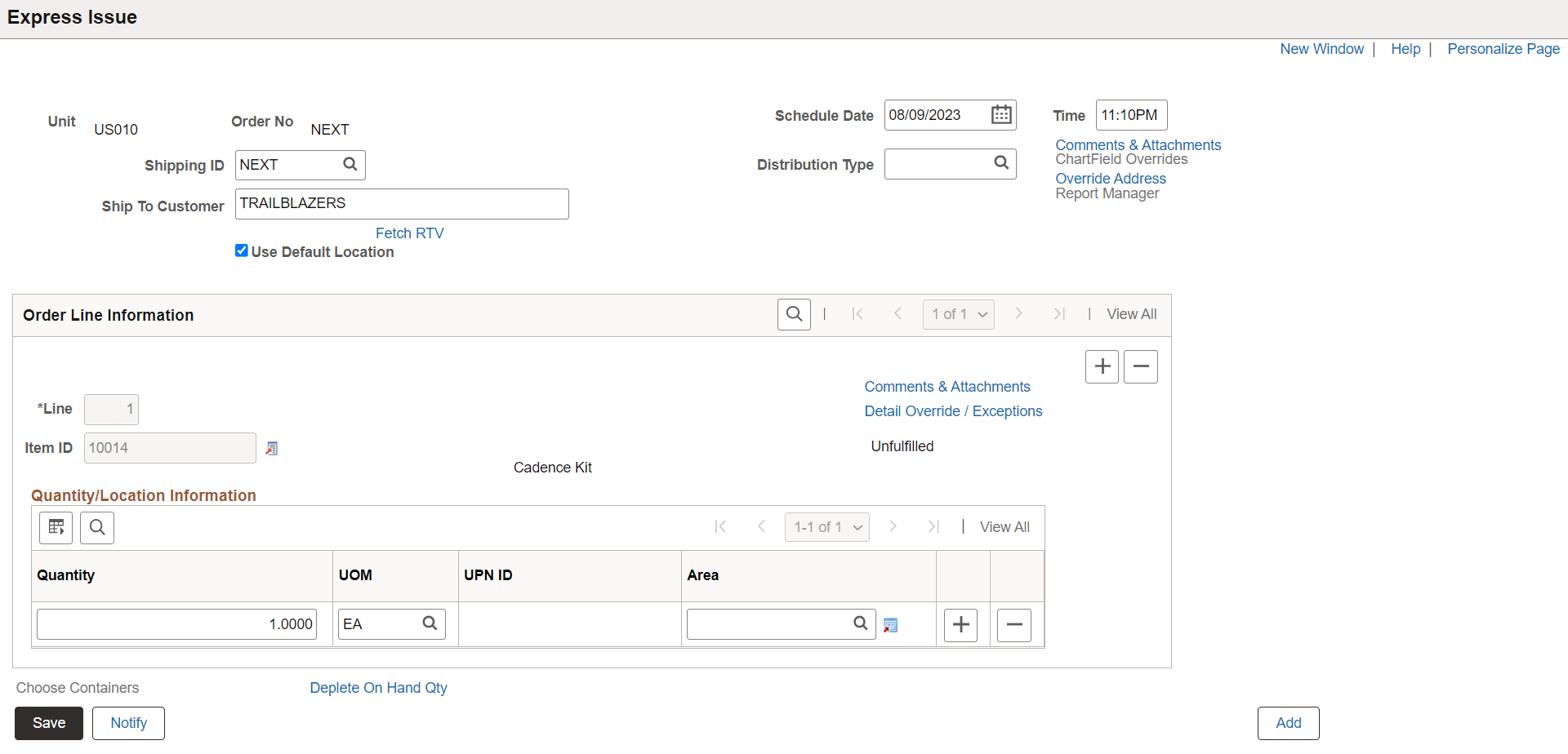

Express Issue Page
EXPRESS_ISSUE1_INV
Select the Request Type of supplier Returns to create a return-to-vendor MSR in the shipped fulfillment state.

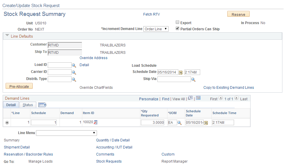

Stock Request Summary Page
EZ_ISSUE_INV
Select the Request Type of supplier Returns to create a return-to-vendor MSR in the unfulfilled fulfillment state.

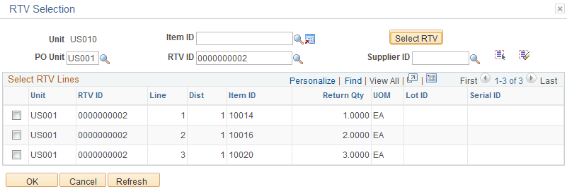

RTV Selection (return-to-vendor selection) Page
EXPRESS_ISSUE_RTV
Enter search criteria and select an RTV transaction from PeopleSoft Purchasing. The data is copied to the material stock request to ship stock back to the supplier.
This page is available only for supplier return requests.

Express Issue Page
Use the Express Issue page (EXPRESS_ISSUE1_INV) to select the Request Type of Supplier Returns to create a return-to-vendor MSR in the shipped fulfillment state.
Navigation:
Inventory, and then Fulfill Stock Orders, and then Stock Requests, and then Express Issue
This example illustrates the fields and controls on the Express Issue page displaying the RTV fields. You can find definitions for the fields and controls later on this page.
Use the Stock Request Summary page (EZ_ISSUE_INV) to select the Request Type of supplier Returns to create a return-to-vendor MSR in the unfulfilled fulfillment state.
Navigation:
Inventory, and then Fulfill Stock Orders, and then Stock Requests, and then Create/Update Stock Request
This example illustrates the fields and controls on the Stock Request Summary page displaying the RTV fields. You can find definitions for the fields and controls later on this page.
Use the RTV Selection (return-to-vendor selection) page (EXPRESS_ISSUE_RTV) to enter search criteria and select an RTV transaction from PeopleSoft Purchasing.
Navigation:
  • Click the Fetch RTV link on the Express Issue page.
  • Click the Fetch RTV link on the Stock Request Summary page.
This example illustrates the fields and controls on the RTV Selection page. You can find definitions for the fields and controls later on this page.
RTV Selection page
Enter the appropriate parameters, and click the Search button. Items matching the criteria appear in the lower portion of the page. Select the check box next to a line, or click the Select All RTV (select all return to vendor) button to select all lines from an RTV ID. Click the Unselect All RTV (unselect all return to vendor) button to clear all lines.
A RTV line is unavailable if it has already been used to create another MSR line using an Express Issue page, Create/Update Stock Request component, the Inventory Shipping EIP, or the Inventory Create Stock Request EIP.

Shipping/Issues component
On the Shipping/Issues component:
  • Use the Demand Source of Material Return to select just RTV MSRs.
  • You cannot delete the shipping address override.
  • You cannot change the ship to customer ID.
