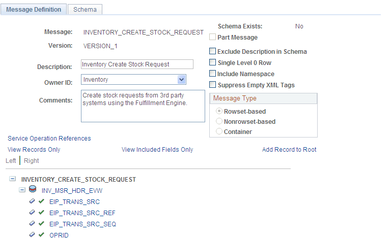

Using the Inventory Create Stock Request Message in PeopleSoft Integration Broker
Use the Message Definition page (IB_MESSAGE_BUILDER) to view the fields to be used by the service operation within PeopleSoft Integration Broker.
In order to correctly populate the incoming data, review the message definition. This is a setup step that is not repeated for each transaction request.
Navigation:
PeopleTools, and then Integration Broker, and then Integration Setup, and then Messages, and then Message Builder
This example illustrates the fields and controls on the View the fields included in the message used by the INVENTORY_CREATE_STOCK_REQUEST service operation (1 or 2). You can find definitions for the fields and controls later on this page.
This example illustrates the fields and controls on the View the fields included in the message used by the INVENTORY_CREATE_STOCK_REQUEST service operation (2 of 2, partial page). You can find definitions for the fields and controls later on this page.
In order to correctly populate the incoming data, review the message definition. Message definitions provide the physical description of the data that is being sent, including; fields, field types, and field lengths. Messages do not contain any processing logic. All processing logic is defined in service operations, using service operation handlers. In this section, consider some important fields in the INVENTORY_CREATE_STOCK_REQUEST message.

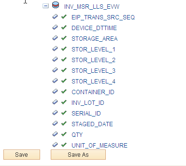

  • INV_MSR_LLS_EVW: The LLS level containing the location/lot/serial of a demand line. You can pre-allocate a demand line by using the LLS level of the transaction request to specify the picking location or lot ID.

Creating MSRs Using the Inventory Shipping Messages in PeopleSoft Integration Broker
Navigation:

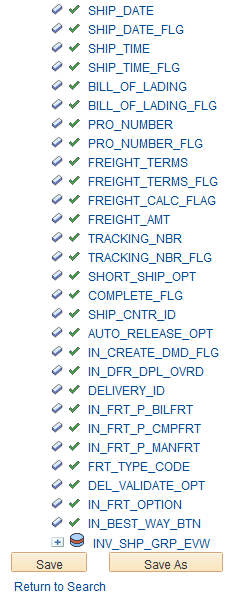

This example illustrates the fields and controls on the View the fields included in the message used by the INVENTORY_SHIPPING service operation (1 or 2). You can find definitions for the fields and controls later on this page.
This example illustrates the fields and controls on the View the fields included in the message used by the INVENTORY_SHIPPING service operation (2 of 2, partial page). You can find definitions for the fields and controls later on this page.
In order to correctly populate the incoming data, review the message definition. Message definitions provide the physical description of the data that is being sent, including; fields, field types, and field lengths. Messages do not contain any processing logic. All processing logic is defined in service operations, using service operation handlers. In this section, consider some important fields in version 2 of the INVENTORY_SHIPPING message. These same fields are also on version 2 of the INVENTORY_FRONT_END_SHIPPING message.
Field or Control Description
IN_CREATE_DMD_FLG
To create an MSR, you must enter Y (yes) in the Create Demand field of your transaction.
AUTO_RELEASE_OPT
To advance the demand line to the Depleted state, enter 70 (advance to depleted) in the Auto Release Option field of your transaction.
