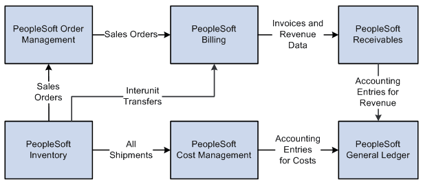

The following diagram illustrates the flow of data from shipments in PeopleSoft Inventory to record revenue and costs in PeopleSoft General Ledger:
Flow of revenue and cost data from PeopleSoft Inventory to PeopleSoft General Ledger
Recognizing Revenue for Shipping Transactions
For sales orders from PeopleSoft Order Management or interunit transfers, the Depletion process marks the orders as available for processing in PeopleSoft Billing. Data from PeopleSoft Inventory and PeopleSoft Order Management is passed to PeopleSoft Billing for invoice creation and revenue recognition. The revenue information is then passed downstream to PeopleSoft Receivables and PeopleSoft General Ledger.
See PeopleSoft Billing: PeopleSoft Billing Integrations.
Recording the Costs for Shipping Transactions
In PeopleSoft Cost Management, the Cost Accounting Creation process picks up depleted shipments from the TRANSACTION_INV record in PeopleSoft Inventory. These demand lines are moved into the CM_TRANSACTION table in PeopleSoft Cost Management. The Cost Accounting Creation process calculates and records the cost of the shipped goods. The accounting entries are then passed to the PeopleSoft General Ledger to be summarized into journal entries.
See PeopleSoft Cost Management: Cost Accounting Creation Page.

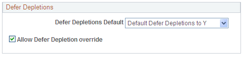

Setup Fulfillment-Shipping Page
Use the Setup Fulfillment-Shipping page (OF_SETUP6_INV) to determine if the Defer Depletions feature will be used within the Inventory business unit and set a default value for the Defer Depletions field that is applied to all demand lines within this Inventory business unit.
Navigation:
Inventory, and then Fulfill Stock Orders, and then Fulfillment Rules, and then Setup Fulfillment, and then Shipping
This example illustrates the fields and controls on the Defer Depletions group box on the Setup Fulfillment-Shipping page (partial). You can find definitions for the fields and controls later on this page.
The Defer Depletions group box on the Setup Fulfillment-Shipping page (partial)
Use the Setup Fulfillment-Shipping page to:
  • Determine if the Defer Depletions feature will be used within the Inventory business unit using the Defer Depletions Default field. Set this field to the value of Do not use this feature to turn off the Defer Depletions feature within this Inventory business unit.
  • Set a default value (Y or N) for the Defer Depletions field at the Inventory business unit level using the Defer Depletions Default field. This default value is applied to the demand line level of each sales order or stock request within the business unit. Select a value of Default Defer Depletions to Y if you want all or most lines to use the Defer Depletions feature. Select a value of Default Defer Depletions to N if you want to use the Defer Depletions feature for a few orders on an exception basis.
  • Select the Allow Defer Depletion Override check box to enable users to override of the Defer Depletions field on any demand lines within the business unit. You would use this option when some orders would use the Defer Depletion feature but other orders would not use it. Selecting this check box enables you to view and change the Defer Depletions field on several pages within the demand fulfillment process flow, including the; Material Picking Feedback page, Picking Confirmation process page, Shipping/Issues - Order Summary, Shipping Requests process page, Front-end Shipping Requests process page, Express Issue-Detail Override/Exceptions page, and on the header, group, and detail sections of the Fulfillment Workbench. The Defer Depletion field would also be available on the messages used by PeopleSoft Integration Broker for shipping.
See Setup Fulfillment-Shipping Page.

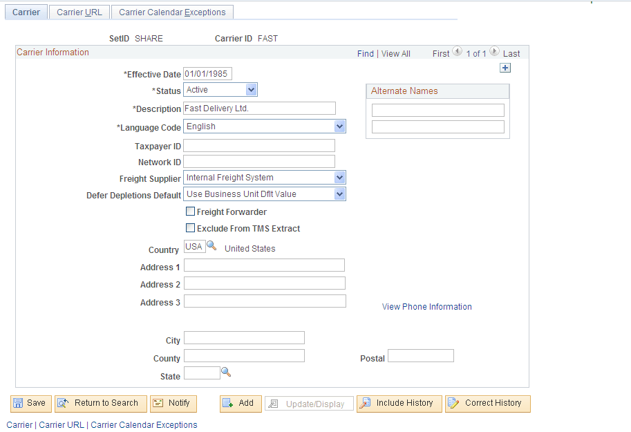

Carrier Page
Use the Carrier page (CARRIER_TBL) to define the carriers that your organization uses to move freight and set the default value for the Defer Depletions field on each demand line that uses this carrier ID.
Navigation:
Set Up Financials/Supply Chain, Common Definitions, Shipping and Receiving, Carrier Table
This example illustrates the fields and controls on the Defer Depletions Default field on the Carrier page within the Carrier Table component. You can find definitions for the fields and controls later on this page.
The Defer Depletions Default field on the Carrier page within the Carrier Table component.
On the Carrier Table component, you define the carriers, at the SetID level, that your organization uses to move freight. Using the Defer Depletions Default field on the Carrier page, you can tell the system to retrieve the default value from the Inventory business unit level (Setup Fulfillment-Shipping page) or define the default value by individual carrier ID. You can select the default value of N or Y to be applied to the Defer Depletions field on each demand line that uses this carrier ID. This default of Y or N is applied during the shipping processes and overrides a Y or N value set on the Setup Fulfillment-Shipping page (business unit level). However, the setting at the Carrier page cannot override the Do not use this feature value on the Setup Fulfillment-Shipping page.
See Application Fundamentals: Establishing Carriers.

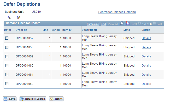

Releasing Defer Depletion Demand Lines for Downstream Processing
Use the Defer Depletions field in the Override group box to change the Defer Depletions field on the selected demand lines as they are moved to the Shipped state.
Navigation:
Inventory, and then Fulfill Stock Orders, and then Shipping, and then Process Shipping Requests
This example illustrates the fields and controls on the Defer Depletions page. You can find definitions for the fields and controls later on this page.

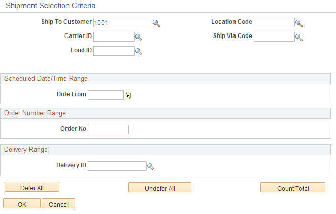

Use the Defer Depletions-Shipment Selection Criteria page (DEFER_DEPL_SP) to use this page to enter search criteria to display demand lines on the Defer Depletions page or, for a large volume of demand lines, use this page to enter the search criteria and select the Undefer All button or Defer All button to change the selected lines without loading the lines into the component.
Navigation:
Select the Search for Shipped Demand link on the Defer Depletions page
This example illustrates the fields and controls on the Defer Depletions-Shipment Selection Criteria page. You can find definitions for the fields and controls later on this page.

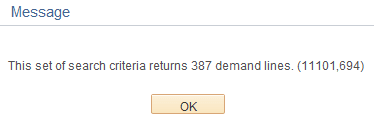

Click the Count Total button on the Defer Depletions-Shipment Selection Criteria page to display the number of demand lines that will be impacted by your change:
This example illustrates the fields and controls on the Results box displayed when users click the Count Total button. You can find definitions for the fields and controls later on this page.
The Defer Depletions component is used to change the value of the Defer Depletions field for the selected demand lines. This component enables you to release sales orders and stock requests to the billing and costing processes by changing the value of the Defer Depletions field from Y to N, so that the Deplete On Hand Quantity (Depletions) process to pick up the demand lines for processing. In addition, you can use this component to delay the costing and billing processes by changing the Defer Depletions value from N to Y. You can use this component in two ways:
  1. Online Method: View the individual demand lines on the Defer Depletions page and change the Defer Depletions field per line. This method is useful when you are working with a few demand lines and need closer supervision of the changes. When using the online method:
    1. Use the Defer Depletions-Shipment Selection Criteria page to enter your selection criteria. Click the OK button to place the selected demand lines on the Defer Depletions page.
    2. Select the Defer Depletions check box for any demand line that you want to change the Defer Depletions field to Y.
    3. Deselect the Defer Depletions check box for any demand line that you want to change the Defer Depletions field to N.
    4. Click the Save button to execute your changes on the demand line.
  2. Batch Method: Use the Defer Depletions-Shipment Selection Criteria page to enter search criteria and change the Defer Depletions value without viewing the individual demand lines. This method is especially useful when you are handling a large number of demand lines. Using the online method for a large number of demand lines could result in a performance delay. When using the batch method:
    1. Use the Defer Depletions-Shipment Selection Criteria page and enter your selection criteria.
    2. Click the Count Total button to view the total number of demand lines your current selection criteria will impact. Use this button to verify that you will be impacting the number of lines you expect prior to using the Defer All or Undefer All buttons.
    3. Click the Defer All button or the Undefer All button. Click the Defer All button to set the value of the Defer Depletions field on each selected demand line to Y (yes). Yes prevents the lines from being processed by the Deplete On Hand Quantity (Depletions) process. These demand lines stay in the Shipped fulfillment state and are not moved to the Depleted fulfillment state.
      Click the Undefer All button to set the value of the Defer Depletions field on each selected demand line to N (no) so that the Deplete On Hand Quantity (Depletions) process can pick up the demand lines for processing and move the lines to the Depleted fulfillment state.
Demand lines belonging to one product kit ID must be updated together to have the same value in the Defer Depletions field.

Defer Depletions
Clear this check box to release the demand line to the Depletions process by changing the value in the Defer Depletions field from Y to N.
Select this check box to withhold the demand line from the Depletions process by changing the Defer Depletions field of this demand line to Y.
Details
Select this link to access the Stock Request inquiry page where you can view the current value in the Defer Depletions field on this demand line.
Save
Click this button to execute your changes on the demand lines.
Field or Control Description
Ship To Customer
For sales orders, enter the Ship To Customer ID to select demand lines.
Location Code
For material stock requests, enter the location code to select demand lines.
Carrier ID
Enter to select demand lines with one carrier.
Ship Via Code
Enter to select demand lines using one shipping method.
Load ID
Enter to select demand lines assigned to a single load ID.
Schedule Date/Time Range
Enter dates to select demand lines based on a the scheduled shipment date defined on the demand line. You can enter a date and time range in the Date From and Date To fields. For just one specific date, use the Date From field only.
Order Number Range
Enter the order number or range of order numbers to be selected. The order can be a sales order from PeopleSoft Order Management or a material stock request. If you enter a range of orders using the Order No and To Order No fields, then the system processes all orders, sorted in alphanumerical order, that fall between the starting and ending order numbers. For just one specific order, use the Order No field only.
Defer All
Click this button to set the value of the Defer Depletions field to Y (yes) on all of the demand lines that meet the above search criteria.
Undefer All
Click this button to set the value of the Defer Depletions field to N (no) on all of the demand lines that meet the above search criteria.
Count Total
Click this button to display a count of all the demand lines found that match the above search criteria.
OK
Click this button to retrieve the demand lines matching the above selection criteria and place them in the Defer Depletions page.
Cancel
Click this button to return to the Defer Depletions page without performing a search.
