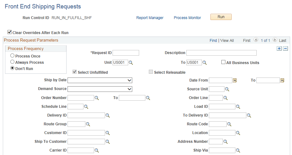

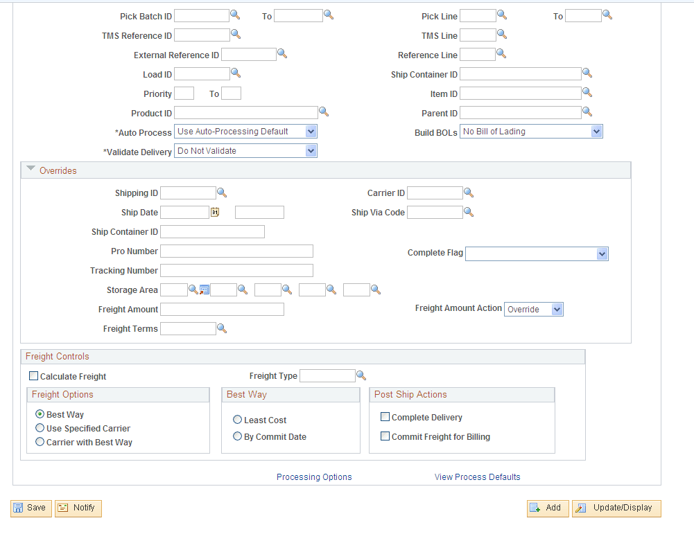

Front End Shipping Requests Page
Use the Front End Shipping Requests page (RUN_IN_FULFILL_SHF) to submit requests to the fulfillment engine to move the demand lines of a material stock request or sales order from an unfulfilled or releasable state to a shipped state.
Navigation:
Inventory, and then Fulfill Stock Orders, and then Shipping, and then Front-end Shipping Requests
This example illustrates the fields and controls on the Front End Shipping Requests process page (1 of 2). You can find definitions for the fields and controls later on this page.
This example illustrates the fields and controls on the Front End Shipping Requests process page (2 of 2). You can find definitions for the fields and controls later on this page.
Use this process page to submit requests to the fulfillment engine to move the demand lines of a material stock request or sales order from an unfulfilled or releasable state to a shipped state. If auto-processing is enabled, this process could move the demand lines further downstream to the depleted state.
Field or Control Description
Clear Overrides After Each Run
(At the top of the process page) Select to remove all override entries from the run control process page after each run. Use this check box when the overrides should only apply to this process run. Do not select this check box if you want the same overrides used each time this run control is processed.
Select Unfulfilled and Select Releasable
Select the starting fulfillment status of the demand lines to be shipped. Selecting or clearing check boxes here override the default states defined for the process on the From States tab of the Setup Fulfillment-Fulfillment Task Options page (business unit level). If no value is entered, then the default comes from the Fulfillment Engine Options page (SetID level).
For the field descriptions on these search criteria See Common Elements Used in Understanding Shipping Rules.
For the field descriptions on the Override group box and the Freight Controls group box, see the Using Fulfillment Engine Shipping Requests section below.

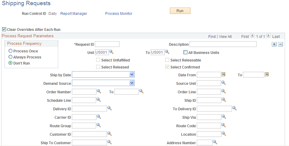

Use the Shipping Requests page (RUN_IN_FULFILL_SHP) to submit requests to the fulfillment engine to move the demand lines of a material stock request or sales order from an unfulfilled, releasable, released, or confirmed state to a shipped state.
Navigation:
Inventory, and then Fulfill Stock Orders, and then Shipping, and then Process Shipping Requests
This example illustrates the fields and controls on the Shipping Requests page (1 of 2). You can find definitions for the fields and controls later on this page.
This example illustrates the fields and controls on the Shipping Requests page (2 of 2). You can find definitions for the fields and controls later on this page.
Use this process page to submit requests to the fulfillment engine to move the demand lines of a material stock request or sales order from an unfulfilled, releasable, released, or confirmed state to a shipped state. If auto-processing is enabled, this process could move the demand lines further downstream to the depleted state.
Select Unfulfilled, Select Releasable, Select Released, and Select Confirmed
For the field descriptions on these search criteria, See Common Elements Used in Understanding Shipping Rules.

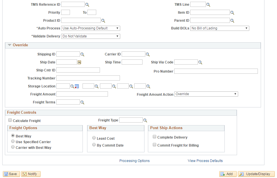

Overrides group box
The Front End Shipping Requests process and the Shipping Requests process move demand lines from an earlier state to the shipped state; therefore, it may be necessary to enter shipping overrides for demand lines selected by the process. The overrides are applied to all demand lines in the request. The following overrides and related options are available for these process pages:
Shipping ID
Enter a shipping ID. If this field is left blank, the system assigns the next sequential shipping ID based on the Inventory Definition -Business Unit Counters page.
Carrier ID
Enter the carrier ID to be used on all demand lines selected by this process. This entry overrides any previously entered value on an individual demand line. If you have enable the delivery management feature, use caution with this override entry since a delivery ID can have a specific carrier defined for it. These fields must be synchronized or the selected lines are removed from the delivery ID. In addition, applying a carrier ID to the selected lines (or delivery ID) can prevent best way freight calculations with the external third party freight feature.
Ship Date and Ship Time
Enter the ship date and ship time to be used on the demand line. If these fields are left blank, the system uses the current date and time.
Ship Via Code
Enter a ship via code to be applied to the selected lines. If you have enable the delivery management feature, use caution with this override entry since a delivery ID can have a specific ship via code defined for it. These fields must be synchronized or the selected lines are removed from the delivery ID.
Ship Cntr ID
Enter a shipping container ID to be applied to the request. Everything in the request is packed in the container. If some of the lines were already in a different container, the process instance will error.
Pro Number
Enter a pro number to be applied to the entire request. This entry overrides any previously entered value on an individual demand line.
Complete Flag
Choose a Complete Flag option to automatically perform picking feedback functionality on demand lines that have not been marked for confirmations. The Complete Flag options are:
  • Complete Pick - Dft Sh Loc: Uses the default shipping location as the pick location for demand lines that do not already have the Confirm Flag set.
    The default shipping location is stored at both the business unit and business unit/item levels.
  • Complete Pick - Leave Alone: With this option any lines within the selection criteria that do not have the Confirm Flag set are left alone.
    The Confirm Flag is not set on these demand lines.
  • Complete Pick - Zero Quantity: Sets the zero picked flag for every line within the selection criteria if they do not already have the Confirm Flag set.
    Also removes and deallocates any current allocations.
  • Pick Batch Complete: Removes every line within the selection criteria from the pick batch ID if they do not already have the Confirm Flag set.
  • Pick Batch as Planned: Sets the Confirm Flag on any line that has had picking activity.
    In this situation picking activity is assumed to be satisfied if there are any allocations as well as if the demand line is a zero picked demand line. An error is generated for any lines that have not had any picking activity when using this option.
  • Use Defaults: Select to have the system use the Complete Flag option defined for the Setup Fulfillment-Fulfillment Task Options page (business unit level).
    If no value is entered, then use the value in the Fulfillment Engine Options page (SetID level).
Tracking Number
Enter a tracking number. This entry overrides any previously entered value on the container. A tracking number cannot be entered unless a shipping container ID is specified either as an override or in the selection criteria.
Defer Depletions
Select the value of Override to Y or Override to N to change the value of the Defer Depletions field on each demand line selected by this page. For more information in the Defer Depletions feature, go to the "Shipping Inventory" topic, "Delaying the Billing and Costing of Inventory Shipments" section.
See Delaying the Billing and Costing of Inventory Shipments.
Storage Location or Storage Area
Enter the material storage location to be used for picking.
Freight Amount
Enter an amount to be added to the existing freight charge or manually override the freight charge. The Freight Amount Action field on this page determines how this value is applied.
Select the option to apply the value in the Freight Amount field. The options are:
  • Override: The value in the Freight Amount field should override the existing freight charge for this order line. When a override value is entered in this field, the freight charge override flag is set on for the delivery ID. This flag prevents the system from calculating another freight amount.
  • Increment: The value in the Freight Amount field should be added to the existing freight charge for this order line.
Freight Terms
Enter a freight terms code to override the default freight terms code. This override value is applied to the entire request.
The freight terms code determines whether the buyer or the seller pays the freight. If the buyer pays the freight, then freight charges are passed to PeopleSoft Billing. If the seller pays the freight, then charges do not pass to PeopleSoft Billing. For sales orders, keep in mind that the Freight Bill Type field determines when the freight charges are passed to PeopleSoft Billing; at order entry or when the order is depleted from PeopleSoft Inventory.
Calculate Freight
(For sales order from PeopleSoft Order Management only) Select this check box to have PeopleSoft calculate the freight, at the request-level, using either the external third party freight provider or the PeopleSoft internal freight calculator. The calculated freight costs are then applied to all sales orders in the request. The costs are prorated across multiple sales orders within the same request by the item weight for each order line. If the selection criteria of this request includes a Ship Container ID, then the calculated freight amount is applied to the container and the order.
Freight Type
Enter the freight type code to be used by the external third-party freight system. Freight types are defined at the SetID level and used to derive the correct freight service definition to send with the outbound message to the third-party provider.
Freight Options
Select one of the following freight options to request freight from an external third-party freight system:
  • Best Way: The PeopleSoft system sends a best way request to the third-party provider system and the third-party provider returns only best way freight choices. Use the Best Way group box to choose the best way option. The best way options are least cost or by commit date.
  • Use Specific Carrier: The PeopleSoft system sends a request with a specific carrier ID to the third-party provider system and the third-party provider returns only freight choices from the specified carrier.
  • Carrier with Best Way: Select this option to enable the third-party freight system to return freight results when the carrier ID field is blank on a delivery that uses the Use Specified Carrier freight option. If the PeopleSoft system sends a delivery using the Use Specified Carrier freight option and the delivery does not have a carrier ID assigned to it, then the Best Way freight option should be used.
Best Way
If you have selected Best Way or Carrier with Best Way in the Freight Options group box, then use this group box to choose your best way option:
  • Least Cost: The third-party freight system selects and returns the freight service with the least cost.
  • By Commit Date: The third-party freight system selects and returns the freight service that best matches the scheduled ship date.
Complete Delivery
Select this check box to set the status of the delivery to Complete Delivery which indicates that all fulfillment steps for the delivery are complete and all demand lines in the delivery are ready to be depleted using the Deplete On Hand Qtys process. If the PeopleSoft Inventory business unit is using deliveries, the Deplete On Hand Qtys process only pick ups demand lines that are on a delivery with the Complete Delivery status.
Commit Freight for Billing
Select this check box to indicate that the freight on this delivery is ready to be processed by PeopleSoft Billing and by PeopleSoft Cost Management.
