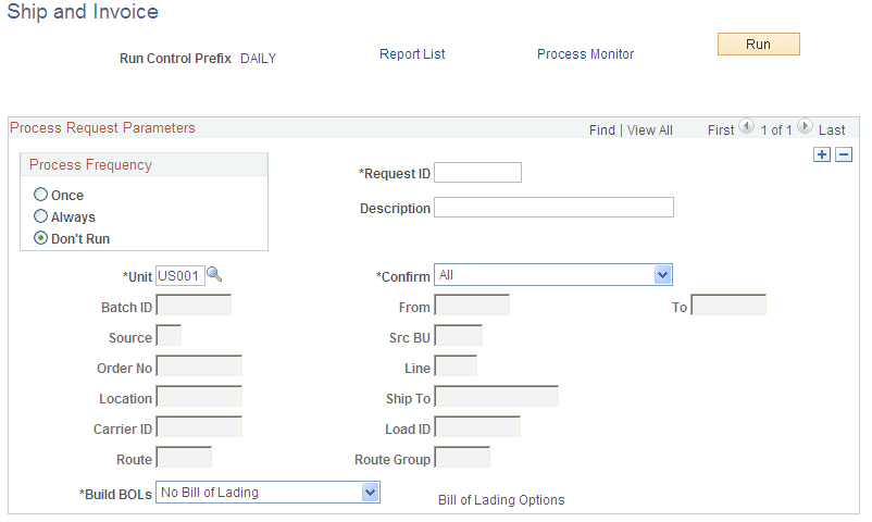

Ship and Invoice Page
Use the Ship and Invoice page (RUN_INV_DIRAUTO) to run the direct invoicing with the AutoShip multiprocess job.
Navigation:
Inventory, and then Fulfill Stock Orders, and then Shipping, and then Ship and Invoice
This example illustrates the fields and controls on the Ship and Invoice page. You can find definitions for the fields and controls later on this page.
Indicate which items you want to confirm:
Field or Control Description
Business Unit
Enter the Inventory business unit.
Confirm
Select the lines to be processed. The options are:
  • All: Confirm all demand lines in the business unit that have been picked and identified for confirmation.
    If you select this option, all subsequent fields are unavailable for entry.
  • Build Selection: Confirm demand lines meeting the criteria that you specify in the subsequent fields.
  • Range of Pick Batches: Confirm demand lines contained within the specified range of pick batches.
    Use the From and To fields to select a range of pick batch IDs.
Build Bills of Lading
Select to create and print bill of lading reports for the selected demand lines. The options are:
  • Build Bill of Lading: Select to add the Build Bill of Lading Request process (IN_FUL_BOL ) to the AutoShip multiprocess job. This process builds multiple BOLs automatically by grouping the selected demand lines onto BOLs by load, route, carrier, ship via, ship to, and address. This process adds the commodity code, quantity shipped, shipping UOM, shipping weight, and shipping volume into the BOL definition.
  • Build and Print Bill of Lading: Select to create and print the bill of lading reports using the Build Bill of Lading Request process.
  • No Bill of Lading: Select to not create or print bill of lading reports for the selected demand lines.
Bill of Lading Options
Select this link to access the Bill of Lading Options page where you can define bill of lading parameters, including; choosing domestic or foreign bill of lading reports, generating bar codes, and identifying the output type, format, and destination of the printed bill of lading reports.
