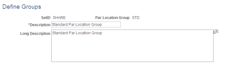

Define Par Location Groups Page
Use the Define Par Location Groups page (CART_GROUP_INV) to define codes for par location groups.
Navigation:
Inventory, and then Replenish Par Locations, and then Define Par Replen Groups
This example illustrates the fields and controls on the Define Groups page. You can find definitions for the fields and controls later on this page.
Define Groups page
Enter a description for each physical or logical grouping of par locations. When you define par location attributes on the Define Par Location - Header page, you assign individual par locations to these groups.

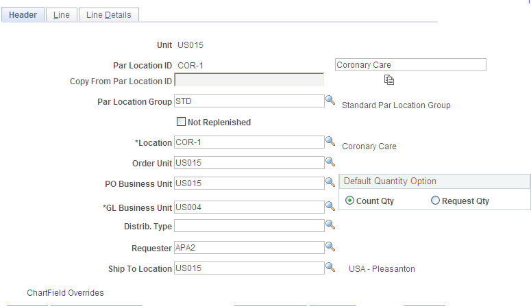

Define Par Location - Header Page
To define par locations, use the Par Location Definition (CART_TEMPLATE_INV) component.
Use the Define Par Location - Header page (CART_HEADER_INV) to define par location header information.
Navigation:
  • Inventory, and then Replenish Par Locations, and then Define Par Location, and then Header
  • Inventory, and then Replenish Par Locations, and then Remove Par Location, and then Header
This example illustrates the fields and controls on the Define Par Location — Header page. You can find definitions for the fields and controls later on this page.
Field or Control Description
Delete
Click to remove the par location from the system. This button appears only when you access the page through the Remove Par Location page. In addition, all fields are display-only when you access the page in this manner. You delete only the par location itself; the location that is associated with the par location remains in the system. You cannot delete a par location that has outstanding par location counts.
Copy From Par Location ID
To copy an existing par location's definition, select an ID, then click the Copy Par Location button.
Par Location Group
Assign the location to one of the par location groups that you defined on the Define Par Location Groups page.
Not Replenished
Select to define all of the items in the par location as not-replenished items. This selection overrides the item- or line-level setting.
Location
The par location to which received items are delivered. When you save the page, the system automatically adds this location to the business unit's location address table.
Order Unit
The PeopleSoft Inventory business unit that fulfills demand for items in the par location.
PO Business Unit (PeopleSoft Purchasing business unit)
The PeopleSoft Purchasing business unit that fulfills replenishment requests for stockless and nonstock items. This field is required for stockless and nonstock replenishment.
GL Business Unit
The PeopleSoft General Ledger business unit for this par location. The default value comes from the general ledger unit that you defined on the Inventory Definition - Business Unit Definition page. If you change the default, stock is issued to this par location from a PeopleSoft Inventory unit that reports to a different general ledger unit, and the system records an interunit expensed issue.
Requester
PeopleSoft Purchasing uses this field to build the requisition and purchase order. This field is required for stockless and nonstock replenishment.
Ship To Location
Required for stockless and nonstock replenishment. PeopleSoft Purchasing uses this value to identify the loading dock for receiving shipments.

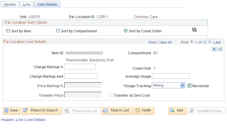

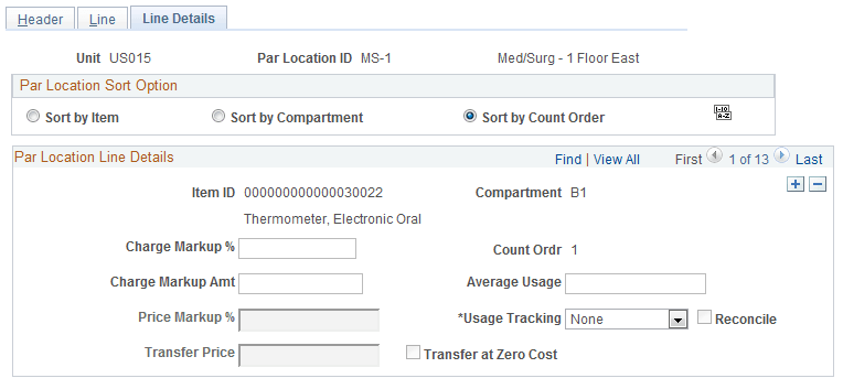

Define Par Location - Line Details Page
To establish line level replenishment controls, use the Par Location Definition (CART_TEMPLATE_INV) component.
Use the Define Par Location - Line Details page (CART_TEMPLATE_INV) to establish line-level replenishment controls for items in a par location.
Navigation:
  • Inventory, and then Replenish Par Locations, and then Define Par Location, and then Line Details
  • Inventory, and then Replenish Par Locations, and then Remove Par Location, and then Line Details
This example illustrates the fields and controls on the Define Par Location - Line Details page. You can find definitions for the fields and controls later on this page.
Par Location Sort Option
Select a radio button in this group box to display par location lines in the desired order. The system renumbers the count order to reflect the sort option.
Charge Markup % (charge markup percentage) and Charge Markup Amt (charge markup amount)
If you use charge markups, you can enter a markup percentage, a flat markup amount, or both.
If you integrate with a third-party billing or costing system, the outbound material usage data includes this information.
Price Markup % (price markup percentage)
Enter a value if you use percentage markups.
When generating material stock requests for stock-replenished items, PeopleSoft Inventory uses this value as the default to determine the transfer price of an inventory issue and applies the markup price to items upon shipment. The system counts the price markup percentage amount as a gain on the transfer.
Transfer Price
Enter a value for stock-replenished items if you use transfer pricing.
Transfer at Zero Cost
Select to ship interunit transfers at zero cost. The source business unit records a loss for the entire cost of the shipped items. This feature enables you to ship promotional or sample items at no cost to the destination par location.
Average Usage
Enter a value or have the Calculate Average Usage process (IN_PAR_USAGE) calculate the average use for stockless, non-stock, and stock-replenished items.
Usage Tracking
Indicate whether items are tracked using a third-party billing or costing system. Select one of the following values:
Billing: Track item usage for patient billing. This method compiles patient and procedure usage information to bill patients directly for items used.
Costing: Track item usage for cost accounting. This method compiles patient and procedure usage information to set procedure costs.
None: Do not track item usage for billing or costing purposes.
Note: Items that are tracked for billing or costing purposes must be assigned charge codes. Items that are also replenished to the par location require counts.
Reconcile
Select to include items in the material usage reconciliation of their par locations. You can only reconcile items that are tracked for billing or costing. In addition, items that are replenished to their par locations must use either the Par or Min/Max replenishment control options.
