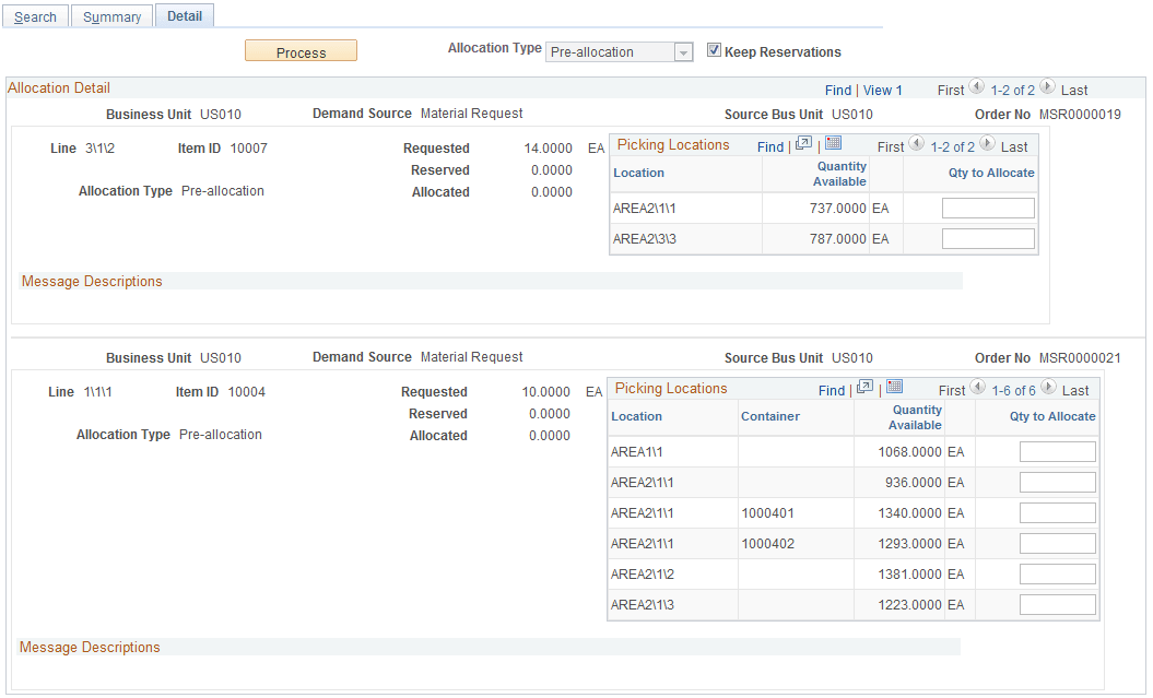

Allocation Workbench - Detail Page
IN_ALLOC_WB_DETAIL
Manually select the specific material storage location or lot ID for allocation to the demand line. In addition, you can use this page to view, change, or remove the current allocations.

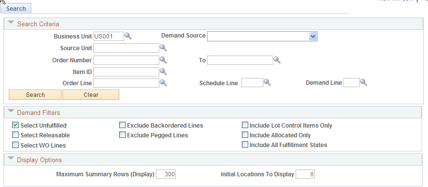

Allocation Workbench - Search Page
Use the Allocation Workbench - Search page (IN_ALLOC_WB_SRCH) to enter search criteria to display demand lines in the Allocation Workbench.
Navigation:
  • Inventory, and then Fulfill Stock Orders, and then Stock Requests, and then Allocation Workbench
  • Order Management, and then Quotes and Orders, and then Allocation Workbench
This example illustrates the fields and controls on the Allocation Workbench - Search page (1 of 2). You can find definitions for the fields and controls later on this page.
This example illustrates the fields and controls on the Allocation Workbench - Search page (2 of 2). You can find definitions for the fields and controls later on this page.
The Allocation Workbench - Search criteria page is the entry point into the Allocation Workbench component. Enter the demand selection criteria, and then click the Search button to view the search results on the Allocation Workbench-Summary page.
Search Criteria
Enter the selection criteria to find demand lines for the Allocation Workbench.
Field or Control Description
Business Unit
Enter the PeopleSoft Inventory business unit containing the demand lines that you want to change.
Demand Source
Restrict the orders displayed on the Allocation Workbench-Summary page to one of the following sources:
  • Material Request: Material stock requests created in PeopleSoft Inventory.
  • Material Return: Material stock requests originating from a return-to-vendor transaction in PeopleSoft Purchasing.
  • Planning Requisition: Material stock requests originating from planning requisitions from PeopleSoft Supply Planning.
  • Purchasing Requisition: Material stock requests originating from requisitions from PeopleSoft Purchasing.
  • Sales Order: Sales orders created in PeopleSoft Order Management.
  • Work Order Demand: Work orders created in PeopleSoft Maintenance Management that have been committed to the PeopleSoft Inventory demand tables.
Source Unit
Enter the business unit where the orders originated.
Order Number and To
Enter the order number or range of order numbers to display. If you enter a range of orders using the Order Number and To fields, then the system displays all eligible orders, sorted in alphanumerical order, that fall between the starting and ending order numbers.
Item ID
Enter an item ID to select only demand lines using this item.
Order Line, Schedule Line, and Demand Line
Enter the line number, schedule line number, and demand line number to display a specific line of the order number entered previously.
Search
Click to initiate a search for demand lines that match all the criteria entered on this page.
Clear
Click to erase all of your field entries on this page.
Demand Filters
Use the Demand Filters group box to select or exclude demand lines based on fulfillment status, allocation type, and other criteria.
Select Unfulfilled
Select to include demand lines in the Unfulfilled fulfillment state. Lines in this state can be pre-allocated or lot allocated (if the item is defined for lot allocation).
Select Releasable
Select to include demand lines in the Releasable fulfillment state. Lines in this state can be pre-allocated or lot allocated (if the item is defined for lot allocation).
Select WO Lines
Select to include work order demand lines from PeopleSoft Maintenance Management. These demand lines are in the Pending fulfillment state. To appear on the Allocation Workbench, the work order demand line must have been committed to Inventory Demand Fulfillment table (IN_DEMAND).
Note: Select at least one of the following check boxes or no search results will be retrieved: Select Unfulfilled, Select Releasable, or Select WO Lines. You can select all of the check boxes.
Exclude Backorder Lines
Select to exclude any backordered demand lines.
Exclude Pegged Lines
Select to exclude any demand lines that are:
  • Currently pegged to incoming supply.
  • Pre-allocated due to a completed peg chain; that is, the pegged items have been received and allocated to the demand line.
Include Lot Control Items Only
Select to display only demand lines with lot-controlled items.
Include Allocated Only
Select to display only demand lines that have an existing allocation.
Include All Fulfillment States
Select to display demand lines in all the fulfillment states.

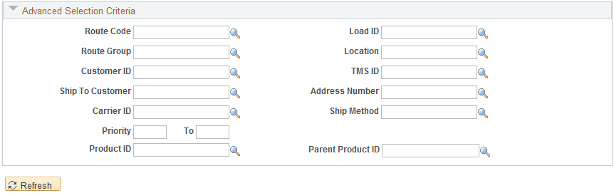

Advanced Search Criteria
Enter additional search criteria to find demand lines for the Allocation Workbench.
Route Code and Route Group
Enter a value to select orders grouped together for a particular transportation grouping and transportation route for delivery of the order.
Load ID
Enter a value to select orders assigned to a single load ID.
Customer ID and Location
Enter a value to select orders that were entered for a particular customer and customer location.
TMS ID
Enter to select orders by the TMS (transportation management system) reference ID assigned during the interface to the transportation management system.
Ship To Customer and Address Number
For sales orders, enter the Ship To Customer ID and address to select orders.
Carrier ID
Enter a value to select orders with one carrier.
Ship Method
Enter a value to select orders using one Ship Via code.
Priority and To
Enter a shipping priority code or range of codes that are assigned to sales orders in PeopleSoft Order Management or to interunit transfers coming from PeopleSoft Supply Planning.
Product ID
Enter the product ID from PeopleSoft Order Management.
Parent Product ID
Enter the parent of a product kit from PeopleSoft Order Management.
Shop, Service Group, Work Type, Asset Location, and Project
(Work order demand lines only) Enter values to narrow the selection of work order demand lines. The available values are based on the Maintenance Management business units that are tied to the Inventory business unit.

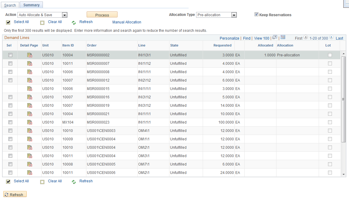

Allocation Workbench - Summary Page
Use the Allocation Workbench - Summary page (IN_ALLOC_WB_SUMMRY) to create, update, or remove a pre-allocation or lot allocation and create a standard allocation using the Allocation Workbench.
Use the Allocation Workbench-Summary page to have the system automatically select the material storage location or lot ID for allocation or to access the Allocation Workbench-Detail page.
Navigation:
  • Click the Search button on the Allocation Workbench-Search page after entering selection criteria.
  • Inventory, and then Fulfill Stock Orders, and then Stock Requests, and then Create/Update Stock Request. On the Stock Request Summary page, select a line and select Allocations in the Line Menu field.
  • Order Management, and then Quotes and Orders, and then Create or Update Sales Order On the Order Entry Form, select Allocations or Lot Allocations in the Header Menu field or the Line Menu field.
This example illustrates the fields and controls on the Allocation Workbench - Summary page. You can find definitions for the fields and controls later on this page.
The Allocation Workbench enables you to create, update, or remove a pre-allocation or lot allocation and to create a standard allocation. Use the Summary page to have the system automatically select the material storage location or lot ID to allocate or access the Detail page to manually select the specific material storage location or lot ID for allocation.
Action
Select an action to allocate or deallocate the selected demand lines. The action is performed when you click the Process button. Actions include:
  • Auto Allocate & Save: Select this action to have the system attempt to allocate the selected demand lines when you click the Process button. The system determines the material storage location to use for stock allocation. If the system is successful in allocating the demand line, then the Allocated column displays the quantity allocated and the Allocation column displays the type of allocation (pre-allocation, lot allocation, or standard).
  • Un-Allocate & Save: Select to remove the allocation (pre-allocation, lot allocation, or standard) from selected demand lines when you click the Process button.
  • Apply Manual Changes: This action is automatically selected when you have made changes on the Allocation Workbench - Detail page that have not yet been processed. Manual changes enable you to select the specific material storage locations for stock allocation or deallocation. Click the Process button to perform your manual changes.
Process
Click to initiate the action on the selected demand lines and then perform a save.
Allocation Type
When creating a new allocation, select the type of allocation. Options are:
  • Pre-allocation: Select to create a pre-allocation to an existing demand line.
  • Lot Allocation: Select to create a lot allocation to an existing demand line. This is available only for lot-controlled items in a PeopleSoft Inventory business unit for which the lot allocation feature has been selected (the Allow Lot Allocation option on the Inventory Definition - Business Unit Options page). In addition, you cannot lot allocate a return to vendor MSR or a work order from PeopleSoft Maintenance Management.
  • Allocate & Release: Select to move the demand line to the Released state and create a standard allocation. In addition, you cannot lot allocate a return to vendor MSR or a work order from PeopleSoft Maintenance Management.
Keep Reservations
Select to keep the soft-reservation on a demand line when you remove an allocation (un-allocate).
Select All and Clear All
Click to select or clear all the demand lines displayed in the Demand Lines group box.
Manual Allocation
Select to access the Allocation Workbench - Detail page for all demand lines selected in the Demand Lines group box. This link is useful when you want to view or manually change multiple demand lines using the Detail page.
Manual Allocation icon(Manual Allocation icon)
Select the Manual Allocation icon located on a demand line row to display the one demand line on the Allocation Workbench - Detail page where you can apply manual changes to the allocation.
Requested
Displays the total requested quantity for this demand line.
Allocated
Displays the quantity for this demand line that is currently allocated. Remember that a pegged demand line is not allocated until the incoming supply has been received and put away into PeopleSoft Inventory.
Allocation
Displays the type of allocation for this demand line, including pre-allocation, lot allocation, and standard allocation.
Lot
(Display only) This check box is selected if the item on the demand line is lot-controlled. Only lot-controlled items can be lot allocated.
Use the Allocation Workbench - Detail page (IN_ALLOC_WB_DETAIL) to manually select the specific material storage location or lot ID for allocation to the demand line.
Navigation:
  • Click the Manual Allocation icon on the Allocation Workbench-Summary page.
  • Click the Manual Allocation link on the Allocation Workbench-Summary page after selecting one or more demand lines.
This example illustrates the fields and controls on the Allocation Workbench - Detail page. You can find definitions for the fields and controls later on this page.
Use the Allocation Workbench - Detail page to select the specific material storage location or lot ID for allocation to the demand line. In addition, you can use this page to view, change, or remove the current allocations.
Process
Click the Process button to save the changes that you have made on this page.
Allocation Type
Displays the value selected on the Allocation Type field on the Allocation Workbench - Summary page. Options are:
  • Pre-Allocations: Allocate an Unfulfilled or Releasable demand line to the stock in a specific material storage location. Remember that you can use this option with a lot-controlled item; therefore, use caution when choosing the allocation type for a lot-controlled item.
  • Lot allocations: Allocate an Unfulfilled or Releasable demand line to the stock in a specific lot ID. You can use this option only with a lot-controlled item and in an inventory business unit that has enabled the lot allocation feature.
Business Unit, Demand Source, Source Bus Unit, and Order No
Displays the inventory business unit, demand source, source business unit, and order number of the demand lines displayed subsequently. This information is repeated for each order displayed.
Line
Displays the order line number, schedule line number, and demand line number.
Quantity Requested
Displays the item quantity requested on the demand line.
Quantity Reserved
Displays the item quantity currently reserved at the business unit level. This is a soft-reserve which reserves stock at the inventory business unit level but not at the material storage location or lot ID levels. If a demand line does not have a soft-reserve when you allocate stock on this page, a soft-reserve is automatically applied along with the hard-allocation.
Quantity Allocated
Displays the item quantity currently allocated at the material storage location level or lot ID level.
Allocation Type
Displays the type of allocation that currently exists or that will be applied using this page. The options are:
  • Pre-allocation: Allocation of stock at a material storage location to a demand line in the Unfulfilled or Releasable states.
  • Lot Allocation: Allocation of stock in specific lot IDs to a demand line in the Unfulfilled or Releasable states.
  • Standard Allocation: Allocation when the demand line is in the Released state (in the picking stage). This type of allocation can be viewed but not changed on this page.
Pegged
Displays the current pegged quantity on this demand line. This is an open peg; the incoming supply has not yet been received into the inventory business unit. When incoming supply is received, the peg status is changed to completed and quantity in this field is set to zero. A reservation or pre-allocation can be created during the putaway of the incoming supply and those quantities are displayed on this page.
Lot\Location\Serial
Displays the current material storage locations or lot IDs that exist for this item ID.
Quantity Available
Displays the stock currently available in the business unit's material storage location or lot ID that can be allocated to the demand line.
Qty to Allocate
Enter or view the stock quantity allocated to the demand line.
The total quantity that you can allocate to a demand line is Quantity Requested minus Quantity Backordered minus Quantity Shipped (work orders only) minus Quantity Pegged.
To remove an existing pre-allocation or lot allocation, change this quantity to zero.
