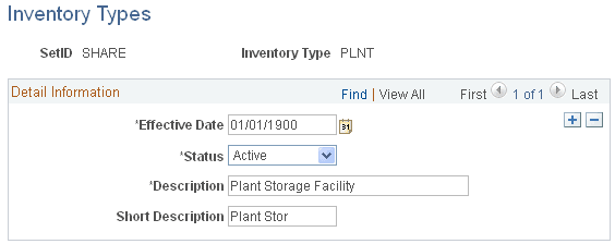

Inventory Types Page
To create inventory business unit types, use the Business Unit Inventory Types (BUS_UNIT_TYPES) component.
Use the Inventory Types page (BUS_UNIT_TYPE_INV) to define PeopleSoft Inventory business unit types.
Navigation:
Set Up Financials/Supply Chain, and then Business Unit Related, and then Inventory, and then Inventory Types
This example illustrates the fields and controls on the Inventory Types page. You can find definitions for the fields and controls later on this page.
Enter a description for each type of business unit that your organization uses. For example, you might have bulk storage locations, distribution centers, project sites, drilling sites, and field warehouses. When you create PeopleSoft Inventory business units on the Inventory Definition - Business Unit Definition page, you assign each business unit to an inventory type.

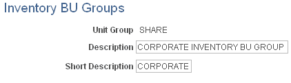

Inventory BU Groups Page
To define business unit groups, use the Inventory Business Unit Groups (IBU_GROUP_INV) component.
Use the Inventory BU Groups page (IBU_TYPE_INV) to define PeopleSoft Inventory business unit groups.
Navigation:
Set Up Financials/Supply Chain, and then Business Unit Related, and then Inventory, and then Create IN BU Groups
This example illustrates the fields and controls on the Inventory BU Groups page. You can find definitions for the fields and controls later on this page.
Enter a description for each group of business units. You can then use the Inventory Definition - Business Unit Definition page to assign the PeopleSoft Inventory business units to these groups.

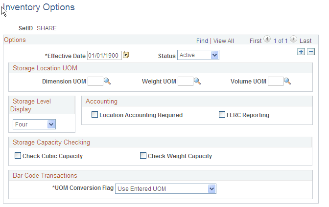

Inventory Options Page
Use the Inventory Options (FACILITY_ATTRIB) component to define default storage location structures and attributes.
Use the Inventory Options page (BUS_UNIT_OPT_IN) to define default storage location structures and attributes.
Navigation:
Set Up Financials/Supply Chain, and then Business Unit Related, and then Inventory, and then Inventory Options
This example illustrates the fields and controls on the Inventory Options page. You can find definitions for the fields and controls later on this page.
Storage Location UOM
Select default units of measure (UOM) for the storage locations. You must establish UOMs on the Units of Measure page before you can select them here.
Field or Control Description
Dimension UOM
Records a storage location's height, width, and depth.
Weight UOM
Records a storage location's weight capacity.
Volume UOM
Records a storage location's cubic capacity.
WARNING:
The capacity-checking feature only works as designed if you select storage location UOMs from the same measurement system. For example, if you use feet for the storage location dimensions, use cubic feet for the volume measurements.
Storage-Level Display
Indicate how many storage-location levels should appear on pages and reports. The value that you specify here is for default purposes only; you can modify it for individual storage areas on the Storage Areas page. PeopleSoft Inventory pages and reports use the values determined on the Storage Areas page.
Accounting
Location Accounting Required
Select to use storage location accounting. If you activate this option, you must also establish ChartFields for each storage area, on the Storage Area Accounting page.
FERC Reporting (Federal Energy Regulatory Commission reporting)
If you link transactions to the FERC's Uniform System of Accounts for the utility industry, select to display the FERC code on relevant PeopleSoft Inventory pages.
Storage Capacity Checking
Check Cubic Capacity
Select to track the volume capacity of storage locations. You must first define dimension and volume UOMs.
Check Weight Capacity
Select to track the weight capacity of storage locations. You must first define a weight UOM.
Bar Code Transactions
If you have an electronic data collection system, you can set the UOM Conversion Flag to process transactions in one of three ways:
Convert to Default Stock UOM
The system converts the UOM on incoming transactions to the default stocking UOM.
Convert to Standard UOM
The system converts the UOM on incoming transactions to the item's standard UOM. This option enables you to stock all the inventory in the standard UOM and perform material movement transactions using any valid UOM for the item.
Use Entered UOM
The system processes transactions using whatever UOM the user enters.
