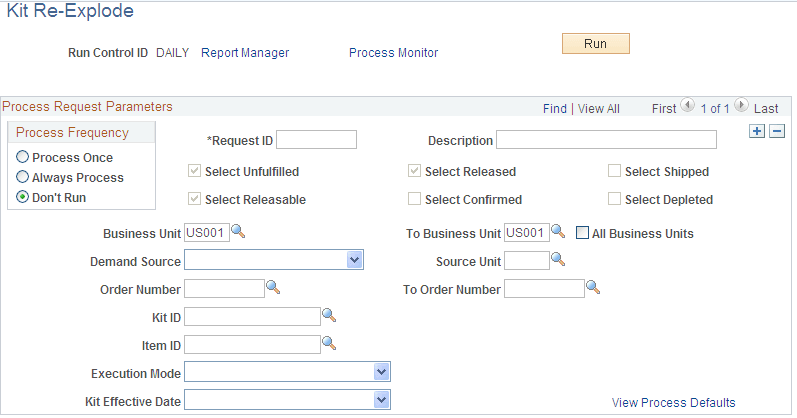

Kit Re-Explode Page
Use the Kit Re-Explode page (RUN_IN_FULFILL_XPL) to run the Kit Re-Explode process (IN_KIT_EXPL) to review and change any differences between the product kit on an order and the product kit definition.
This process enables you to change the order to match the current definition of the product kit.
Navigation:
Inventory, and then Fulfill Stock Orders, and then Stock Requests, and then Kit Re-Explode Process
This example illustrates the fields and controls on the Kit Re-Explode process page. You can find definitions for the fields and controls later on this page.
Field or Control Description
Select Unfulfilled, Select Releasable, Select Released, Select Confirmed, Select Shipped, and Select Depleted
Select one or more fulfillment states of the kit component demand lines.
When selecting fulfillment states, keep in mind that this process works with the complete product kit. For example, if the user only checks the Select Unfulfilled check box, then the Kit Re-Explode process performs a second pass and brings in all kit component demand lines that are siblings of those demand lines matching the selection criteria, even if the demand lines are not in the unfulfilled state. The process re-explodes the product kit only if all the kit component demand lines have the selected fulfillment states. For example, if a product kit includes demand lines within the unfulfilled and releasable states, yet you have only selected the Select Unfulfilled check box here, then the system does not re-explode the product kit.
The default selections in these check boxes are defined on the From States tab on the Setup Fulfillment-Fulfillment Task Options page (inventory business unit level) or the Fulfillment Engine Options component (SetID level).
The selection is further limited by restrictions placed on the Demand Change Configuration component for the Batch Kit Re-Explode row.
Business Unit and To Business Unit
Enter the Inventory business unit or range of units for the demand lines to be processed.
Demand Source and Source Unit
Enter the source of the order and the business unit of the originating PeopleSoft application in order to limit the demand lines selected to one source. For example, entering OM and US001 limits the selection to sales order demand lines created in the PeopleSoft Order Management business unit US001.
Order Number and To Order Number
Enter the order number or a range of order numbers to limit the selection to specific orders. These fields can only be used if you have also populated the Business Unit, Demand Source, and Source Unit fields. When the run control record is saved, the Order Number and To Order Number fields are checked to make sure that they are valid for the entered Business Unit, To Business Unit, Demand Source, and Source Unit fields. The order number fields are not checked against the fulfillment state check boxes; Select Unfulfilled, Select Releasable, and so on.
Kit ID
Enter a product kit ID to limit the selection to demand lines containing components of this Kit ID.
Item ID
Enter the inventory item ID of one component of the product kit and the system selects all demand lines containing this component and any other components to the same product kit. If the item ID belongs to multiple kits, then all product kits are considered.
Execution Mode
Choose the action to be performed by the Kit Re-Explode process. The option are:
  • Report Only: Generates an online inquiry page listing the differences between the kit components on the order to the current product kit definition.
  • Report and Re-Explode: This option:
    • Generates an online inquiry page listing the differences between the kit components on the order to the current product kit definition.
    • Changes the order to match the current product kit definition by adding or deleting demand lines containing kit components.
Kit Effective Date
Select the date of the component kit demand lines to be compared to the date range (effective date and obsolete date) on the Product Kit Summary page. The demand line dates are:
  • Order Date
  • Schedule Date
  • Ship Early Date
  • Today's Date
View Process Defaults
Select this link to view the defaults established for the Kit Re-Explode process. The Execution Mode and Kit Effective Date fields on this process page can only be changed if the Allow Kit Re-Explode Overrides check box has been selected on the Setup Fulfillment-Fulfillment Task Options page (inventory business unit level) or the Fulfillment Engine Options component (SetID level).
See Setting Up the Fulfillment Engine Processing Options.

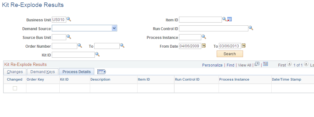

Kit Re-Explode Results Page
Use the Kit Re-Explode Results page (IN_KIT_EXPL_INQ) to view the results of the Kit Re-Explode process.
Navigation:
Inventory, and then Fulfill Stock Orders, and then Fulfillment Information Review, and then Kit Re-Explode Results
This example illustrates the fields and controls on the Kit Re-Explode Results page. You can find definitions for the fields and controls later on this page.
This example illustrates the fields and controls on the Demand Keys tab of the Kit Re-Explode Results page. You can find definitions for the fields and controls later on this page.

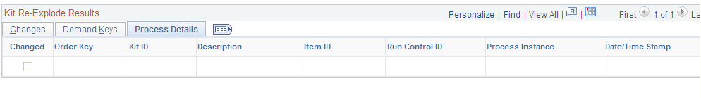

This example illustrates the fields and controls on the Process Details tab of the Kit Re-Explode Results page. You can find definitions for the fields and controls later on this page.
The Kit Re-Explode Results page enables you to view the changes needed to the demand lines to reflect the current product kit definition. This page can display:
  • Potential changes to the demand lines if you selected Report Only Execution Mode on the Kit Re-Explode process page.
  • Actual changes to the demand lines if you selected Report and Re-Explode Execution Mode on the Kit Re-Explode process page.
    When the orders are changed to match the current product kit definition, demand lines can be added or deleted. The quantities on the changed demand lines could be unreserved, unallocated, and unpegged.
Use the three tabs in the Kit Re-Explode Results group box to view the demand lines that do not match the current product kit.
  • The Changes tab is a summary page, with the order key of the demand line, product kit ID, item ID, the action taken, and the number of messages for this line.
    The message field is a link to the Kit Re-Explode Messages page where you can view the reasons for the demand line changes.
  • The Demand Keys tab identifies the exact demand lines to be changed.
    The inventory unit, demand source, source business unit, order number, line number, schedule number, demand line number, and the item ID are displayed.
  • The Process Details tab displays the run control and process instance of the Kit Re-Explode process that has produced these results, as well as the date and time that the process was run.

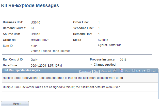

Kit Re-Explode Messages Page
Use the Kit Re-Explode Messages page (IN_KIT_EXPL_MSG) to view the messages that detail the actions of the Kit Re-Explode process by demand line.
Navigation:
Select the Messages link on the Kit Re-Explode Results page.
This example illustrates the fields and controls on the Kit Re-Explode Messages page. You can find definitions for the fields and controls later on this page.
The Kit Re-Explode Messages page enables you to see, for each demand line, the reasons for the Kit Re-Explode action performed or just reported by the process. This page enables you to evaluate the detailed changes on each demand line.
Run Control ID, Process Instance, and Date/Time
Displays the run control ID, process instance, and the date and time of the Kit Re-Explode process that produced these results.
Change Applied
Displays if the change was applied to the demand line. If this check box is selected, then the Kit Re-Explode process has changed the demand line based on the reasons detailed on this page. If this check box is clear, then the Kit Re-Explode process has not changed the demand line and is just reporting. The demand line might not be changed because:
  • The Kit Re-Explode process was run in the report only execution mode.
  • The demand line could not be changed by the Kit Re-Explode process.
Kit Re-Explode Messages group box
This group box displays the reasons for the Kit Re-Explode action on this demand line. Messages include:
  • Changes or potential changes (if run in the report only execution mode) to the OK to Ship Without check box on the demand line. The Kit Re-Explode process can change the check box on the demand line to match the current product kit definition.
  • Changes or potential changes (if run in the report only execution mode) to the Quantity Per field on the demand line.
    The Kit Re-Explode process can change the Qty per Kit, UOM, and Per fields on the demand line to match the current product kit definition. These fields are displayed on the Quantity/Date Detail page of the Create/Update Stock Request component.
  • Reasons that the demand line cannot be changed by the Kit Re-Explode process, including:
    • Kit contains a backorder.
    • Kit contains a demand line with the Kit Protected check box selected.
    • Kit contains a demand line on an active TMS instance.
    • One of the demand lines of the kit is past the fulfillment state designated on the Allow INV Change Thru column and the Batch Kit Re-Explode row (IN_KIT_REEXPLODE) in the Demand Change Configuration component. This restriction works in conjunction with fulfillment state check boxes on the Kit Re-Explode process page.
    • (For sales orders only) None of the demand lines of the kit are past the fulfillment state designated on the Allow OM Changes Thru column and the Batch Kit Re-Explode row (IN_KIT_REEXPLODE) in the Demand Change Configuration component.
    • Kit contains a demand line with a quantity precision violation.
    • Kit contains an inconsistent value across the demand lines for fields that should the same for all lines in the kit.
    • Kit contains a demand line with an item ID that is not defined for the current inventory business unit.
  • Notifications of actions you should take. For demand lines that have been added to the Kit Re-Explode process, some fields values will need to be verified or added.
    These field may be populated with a default value or may be blank because there was no default value. Where possible, the system derives the field value from other demand lines in the same product kit, however, in some cases multiple values exist among the sibling demand lines.
    The field values that need to be added or verified include:
    • Scheduled Date/Time (the system uses the current date and time as a default).
    • Load ID.
    • Carrier ID.
    • Ship Via.
    • Ship Early Date/Time (the system uses the current date and time as a default).
    • Ship Late Date/Time (the system uses the current date and time as a default).
    • Freight Terms.
    • Route Code.
    • Route Stop Number.
    • Ship ID.
    • Order Reservation Rule (the system uses the default on the business unit level, Setup Fulfillment-Reservation page).
    • Line Reservation Rule (the system uses the default on the Setup Item Fulfillment-Reservation/Backorder Rules page or the Setup Fulfillment-Reservation page).
    • Line Backorder Rule (the system uses the default on the Setup Item Fulfillment-Reservation/Backorder Rules page or the Setup Fulfillment-Reservation page).
    • Line Backorder Reservation Rule (the system uses the default on the Setup Item Fulfillment-Reservation/Backorder Rules page or the Setup Fulfillment-Reservation page).
    • Reason Code.
    • Pro Number.
    • Address Overrides.
    • Distribution Type.
    • FERC Code.
    • Packaging Code.

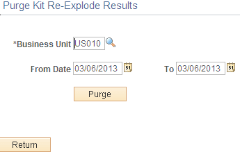

Purge Kit Re-Explode Results Page
Use the Purge Kit Re-Explode Results page (IN_KIT_EXPL_PUR) to select to purge report data generated by the Kit Re-Explode process.
Navigation:
Select the Purge Kit Re-Explode Results link on the Kit Re-Explode Results page.
This example illustrates the fields and controls on the Purge Kit Re-Explode Results page. You can find definitions for the fields and controls later on this page.
Based on inventory business unit and process date range, erase Kit Re-Explode report data that is no longer needed.
Business Unit
Enter the Inventory business unit. This is a required entry.
From Date and To
Enter the data range to select the reports to purge. This date is the system date of the process instance that generated the report data.
Purge
Click to erase the report data based on the business unit and date range entered. When you click the Purge button, a secondary page asked you to confirm or cancel the purge.
