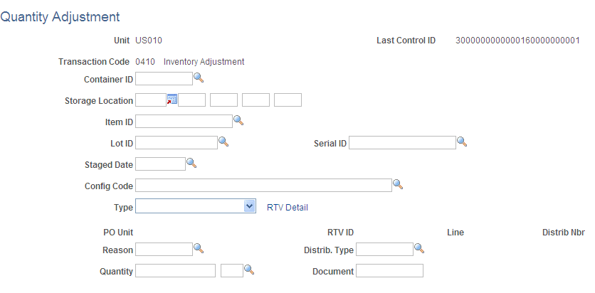

Quantity Adjustment Page
Use the Quantity Adjustment page (BCT_INV_ADJUSTMENT) to conduct inventory stock adjustments using an electronic data collection system.

This example illustrates the fields and controls on the Inventory Adjustment page. You can find definitions for the fields and controls later on this page.
Field or Control Description
Transaction Code
The default transaction code is 0410: Inventory Adjustment.
Type
The type of adjustment being made.
RTV Detail
Click to access the Adjustments - RTV Selection page, where you can select one RTV line for the item and location being adjusted. The selected PO Unit (purchase order business unit), RTV ID, Line, and Dist Nbr (distribution number) fields from the RTV Selection page appear on the Inventory Adjustments page.
Quantity
Enter the amount by which you want to adjust the item. If the UOM conversion option for the business unit is set to convert to the standard UOM or convert to the default stocking UOM, you can enter adjustments in any valid UOM and PeopleSoft Inventory converts them to the item's standard UOM or the material storage location's stocking UOM. If the UOM conversion option for the business unit indicates that no conversion occurs, you can enter adjustments in any valid stocking UOM. If negative inventory balances are permitted in the business unit, you can enter an adjustment that drives the quantity negative. You can also adjust the quantity in the material storage location to 0.
The business unit's default display options determine how many material storage location levels appear upon entry to this page. If you are entering a material storage location that requires additional levels, enter the storage area, then refresh the page to display the remaining levels for that area.
The business unit defaults that you established on the Inventory Display Options page govern whether lot, serial, staged date, and configuration fields appear upon entry to this page. Any fields for which the default is Yes always appear. Any fields for which the default is No appear when you save or refresh the page, and only if they apply to the item in question.
If you selected the Scrap RTV adjustment type, the quantity entered for the adjustment must be less than or equal to the return quantity entered on the Add/Update RTV - RTV page in PeopleSoft Purchasing.
