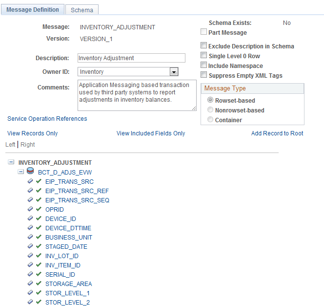

Message Definition Page
Use the Message Definition page (IB_MESSAGE_BUILDER) to view the fields to be used by the service operation within PeopleSoft Integration Broker.
In order to correctly populate the incoming data, review the message definition. This is a setup step that is not repeated for each transaction request.
Navigation:
PeopleTools, and then Integration Broker, and then Integration Setup, and then Messages
This example illustrates the fields and controls on the View the fields included in the message used by the INVENTORY_ADJUSTMENT service operation. You can find definitions for the fields and controls later on this page.
In order to correctly populate the incoming data, review the message definition. Message definitions provide the physical description of the data that is being sent, including; fields, field types, and field lengths. Messages do not contain any processing logic. All processing logic is defined in service operations, using service operation handlers. In this section, consider some important fields in the INVENTORY_ADJUSTMENT message.
For more information about messages, see the "Managing Messages" topic of the PeopleTools : PeopleSoft Integration Broker.
See the product documentation for PeopleTools: Integration Broker

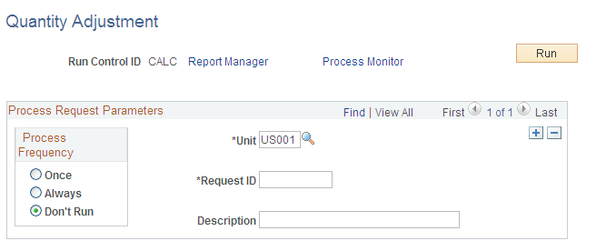

Quantity Adjustment Page
Use the Quantity Adjustment page (BCT_INV_REQIADJ) to establish run control parameters for the Quantity Adjustment process and load quantity balance adjustment data staged by third-party applications using the Inventory Adjustment EIP.
These third-party applications include electronic data collection systems and warehouse management systems.
Navigation:
SCM Integrations, and then Process Transactions, and then Inventory, and then Create Batch Inventory Adjust
This example illustrates the fields and controls on the Quantity Adjustment process page. You can find definitions for the fields and controls later on this page.
