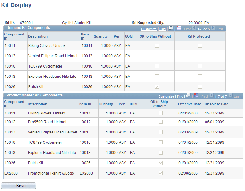

This example illustrates the fields and controls on the Kit Display page. You can find definitions for the fields and controls later on this page.
Kit Display page
Product kits included on a sales order or material stock request are visible throughout the demand fulfillment process in PeopleSoft Inventory. The Kit Display page enables you to view the product kit details for the order.
  • The Demand Kit Components group box displays the product kit components as they are defined within the inventory demand fulfillment table (IN_DEMAND).
    This group box will display any changes that have been made to the individual components on the demand lines. The demand lines within PeopleSoft Inventory will not include any item IDs that have not been defined as inventory items on the Define Items-General: Common page.
  • The Product Master Kit Components group box displays the components as defined in the product kit definition (the PRODKIT_COMPS table).
