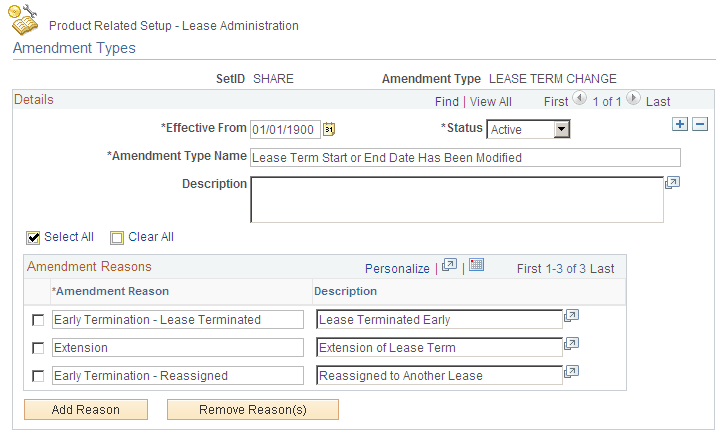

Amendment Types Page
Use the Amendment Types page (RE_AMND_TYPE) to define an amendment type and amendment reason.
Use amendment reasons that are defined for this amendment type only to further categorize this amendment type.
Navigation:
Set Up Financials/Supply Chain, and then Product Related, and then Lease Administration, and then General Definitions, and then LA Amendment Types
This example illustrates the fields and controls on the Amendment Types page. You can find definitions for the fields and controls later on this page.
Field or Control Description
Amendment Type Name
Enter an amendment type name to categorize the amendment activity.
Amendment Reasons
Amendment Reasons
Further identify the reason that you are creating an amendment.
Add Reason
Click to insert a new row to capture additional amendment reasons.
Remove Reason(s)
Select the amendment reason that you want to remove and click the button to delete that row.
