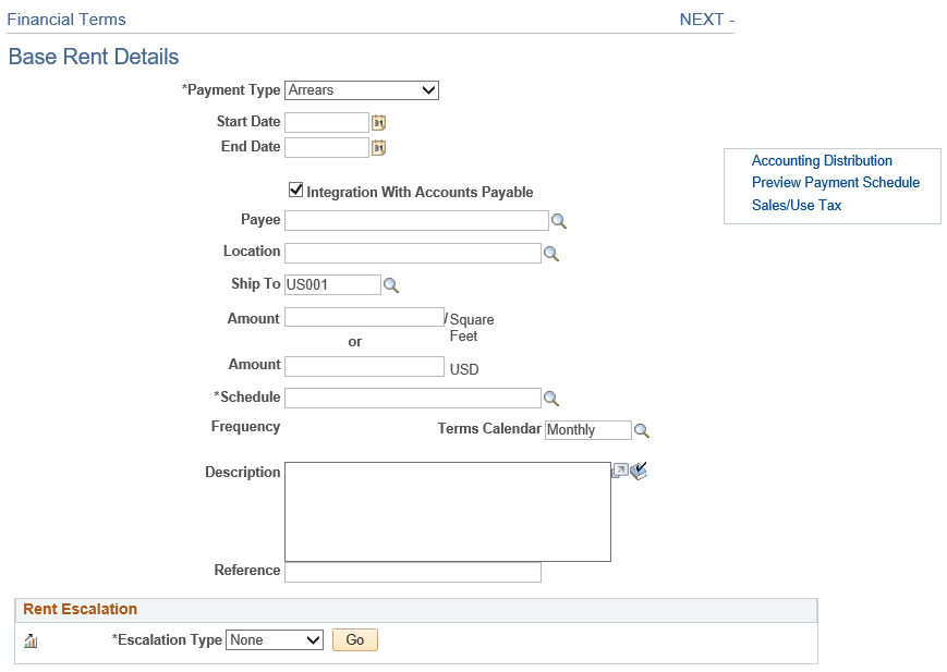

Financial Terms - Base Rent Details Page
RE_LS_TRM_SEC
Enter base rent details, rent escalation, and escalation schedules for the lease.

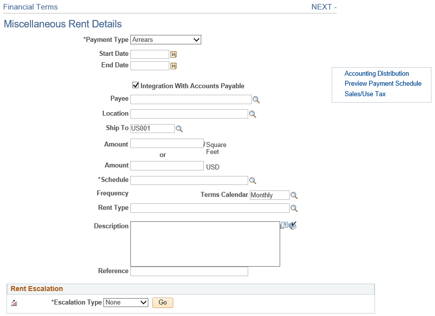

Financial Terms - Miscellaneous Rent Details Page
RE_LS_TRM_SEC
Enter miscellaneous rent details, rent escalations, and escalation schedules for the lease.

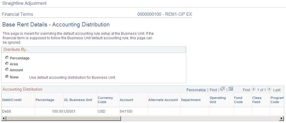

Accounting Distribution Page
RE_LS_TRM_DST_SEC
Override business unit accounting distribution values for the specific financial terms. If the financial term follows the business unit default accounting rule, this page can be ignored.

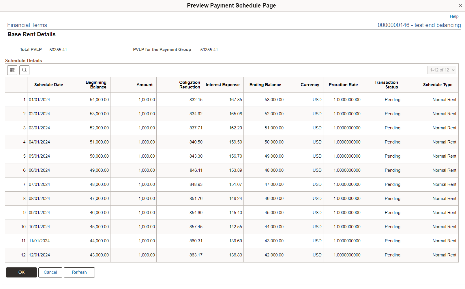

Preview Payment Schedule Page
RE_PRVW_PYMNT_SEC
View the schedule date, amount, currency, proration rate and the transaction status of the payments to be done for the selected lease.

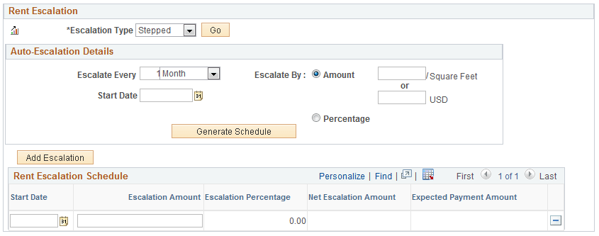

You can establish rent escalations that increase at specific date intervals throughout the life cycle of the lease. When adding base rent, you can set up a recurring invoice or payment. You can create rent escalations using a predefined index or standard stepped increase. The index escalation method typically can use the Consumer Price Index (CPI) or any other index to help determine the rent increase. Escalations usually occur on an annual basis with an optional defined maximum limit capacity.
Use the Financial Terms - Base Rent Details page (RE_LS_TRM_SEC) to enter base rent details, rent escalation, and escalation schedules for the lease.
Navigation:
Click the Add Base Rent action on the Financial Terms page.
This example illustrates the fields and controls on the Financial Terms - Base Rent Details page. You can find definitions for the fields and controls later on this page.
Financial Terms Base Rent Details
Field or Control Description
Payment Type
Select the lease payment type. The available options are: Arrears and Advance.
Start Date
Enter the date on which the base rent becomes effective. You must enter a date that occurs after the lease commencement date and before the end date. The default date is the lease commencement date.
End Date
Enter the date on which the base rent expires. You must enter a date that occurs after the start date and before the lease termination date. The default date is the lease termination date.
Note: Financial terms are validated for gaps within the financial terms and with the lease dates. A warning message is displayed if gaps exist between the financial terms while saving the component.
Integration with Accounts Payable
Select to send the payment to Accounts Payable. The check box is selected as the default option.
Payee
Enter the entity who receives the rent payments. The default value is the landlord from the lease. This field appears for only payables leases.
Location
Enter the location. You can override the default location from the lease header for a financial term.
Ship To
Enter the supplier ship to location. This location will be used for VAT and SUT calculations by PeopleSoft Payables Voucher Build application. Applicable only for payables leases. If this is left blank, Voucher Build will populate the default ship to location for the supplier.
Payor
Enter the entity who makes the rent payments. The default value is the tenant from the lease. This field appears for only receivables leases.
Accounting Distributions
Click this link to access the Accounting Distributions page and override the business unit accounting rules distributions.
Click this link to display the Preview Payment Schedule page. This page displays the schedule date, amount, currency, proration rate and the transaction status of the payments to be done for the selected lease.
Sales/Use Tax
Click this link to access the Sales/Use Tax Information page.
VAT
Click this link to access the VAT Information page. This field appears only for VAT enabled business units.
Straightline Accounting
Select to specify straightline accounting for rent.
Amount
Enter the base rent amount that is charged periodically.
You can enter the rent amount either by area or a specific amount. The system calculates the specific amount if rent by area is specified or vice versa.
You can enter a zero amount to indicate free rent. The system calculates interest expense for the free rent periods. You can view interest expense for the zero rent periods using the Preview Payment Schedule link.
Note: Enter the actual rent amount excluding the VAT or Sales/Use Tax (SUT) amount. The final rent amount, after including the VAT or SUT amount, will appear on the VAT Information page and Sales/Use Tax Information page respectively.
Schedule
Select a value to specify how frequently rent transactions are generated. If the start and end date of the selected frequency differ from the start and end date of the base rent transaction, the system can optionally calculate a prorated transaction for the beginning and end of the term. The values that you have to select from, such as Monthly and Weekly, come from the Schedule component.
See Understanding General Lease Information.
Terms Calendar
Enter the terms calendar, which determines the start date and end date of billing periods for the base rent. The calendar ID from the business unit definition appears by default. You can override this value, but the frequency of the schedule and terms calendar must be the same. This is a required field.
Rent Escalation
PeopleSoft Lease Administration enables you to establish a lease with a base rent and rent escalations using two different calculation methods: stepped or index. The stepped method refers to the auto-generation of escalations based on a fixed escalation percentage/amount and a predefined calendar frequency. You can also manually enter the escalation. The index method is based on the CPI or any other indexes that you define. By selecting these fields, you can establish the maximum amount or percentage that the base rent can escalate. Usually on a monthly basis, you can update the actual index values when the index reporting authorities change the values, thus affecting the variable index escalation.
The system calculates the escalation starting with the base rent amount that is valid for the date the calculation is being run. Then searches for any escalations on this base rent row. Then the system takes the most recent non-future row based on the escalation date, which provides which index to use. The escalation amount is calculated as ((Current Index - Initial Index)/Initial Index ) x Base Rent. If the escalation exceeds the minimum and maximum specified for that row, then substitute those values (use Minimum if it has not been reached, use Maximum if it has been exceeded).

When you select Stepped in the Escalation Type field, define the following fields:
This example illustrates the fields and controls on the Financial Terms - Base Rent Details - Rent Escalation: Stepped page. You can find definitions for the fields and controls later on this page.
Escalate Every
Select suitable frequency for the escalation to be generated.
Escalate By
Enter the amount or percentage for escalation to be generated. You can enter the amount either by area or a specific amount. The system calculates the specific amount if rent by area is specified or vice versa.
If amount is entered then corresponding percentage will be calculated and displayed in the Rent Escalation Schedule grid. This escalation amount is applicable all through the lease term. If percentage is entered then the equivalent amount is calculated.
Start Date
Enter the start date to indicate from when the escalation will be effective.
Escalation Amount
Enter the fixed escalation amount for base rent.
After providing the escalation amount/percentage, click on Generate Schedule button to generate the Rent Escalation Schedule. Start Date in the Rent Escalation Schedule grid corresponds to the escalation frequency. All the dates between the escalation start date and lease end date are fetched from the Calendar table. These dates serve as the escalation start date in the Rent Escalation Schedule section. Schedules can be generated throughout the lease period.
If the schedule is re-generated for a lease, two scenarios can be considered for the escalation start date as follows:
  • The escalation start date being lesser than the escalation schedule start dates: A warning message is displayed indicating whether you want to continue with the modification. If you choose to continue then all the escalation schedules that were generated after the new escalation start date will be deleted and a new schedule created.
  • The escalation start date being greater than the last escalation schedule start date and the escalation start date being lesser than the term end date: No warning message is displayed. New schedule is generated for the period between the last start date of the existing schedule and the new term end date. This scenario is applicable where there is an extension in the term end date.
Escalation amount in the schedule is added to the base rent as and when the Schedule date is reached. Escalation Percentage is display only in the Rent Escalation Schedule grid. For manual entry of escalation you should provide the escalation amount in the schedule and based on this the corresponding escalation percentage is calculated.
Use the Financial Terms - Miscellaneous Rent Details page (RE_LS_TRM_SEC) to enter miscellaneous rent details, rent escalations, and escalation schedules for the lease.
Navigation:
Click the Add Miscellaneous Rent action on the Financial Terms page.
This example illustrates the fields and controls on the Financial Terms - Miscellaneous Rent Details page. You can find definitions for the fields and controls later on this page.
Financial Terms Miscellaneous Rent Details Page
Many of the fields on the Miscellaneous Rent Details page are the same as the fields on the Base Rent Details page This section contains the additional field.
Rent Type
Enter the type of miscellaneous rent. You can select from only active miscellaneous rent types.
See Defining Miscellaneous Rent Types.
Sales/Use Tax
VAT
Use the Accounting Distribution page (RE_LS_TRM_DST_SEC) to override business unit accounting distribution values for the specific financial terms.
Navigation:
  • Click the Accounting Distribution link on the Base Rent Details page.
  • Click the Accounting Distribution link on the Operating Expense Details page.
  • Click the Accounting Distribution link on the Miscellaneous Rent Details page.
  • Click the Accounting Distribution link on the Percent Rent Details page.
  • Click the Accounting Distribution link on the Security Deposit Details page.
This example illustrates the fields and controls on the Base Rent Details – Accounting Distribution page. You can find definitions for the fields and controls later on this page.
Base Rent Details - Accounting Distribution page
The Accounting Distribution pages for each of the financial terms are identical.
The fields on this page differ depending upon the distribution selected. When you select a value other than None, the ChartField values become available for edit.
Distribute By
Select either:
  • Percentage: Select this value to change the accounting distribution by percentage for each financial term.
  • Area: Select this value to change the accounting distribution by area for each financial term.
  • Amount: Select this value to change the accounting distribution by amount for each financial term.
  • None: Select this option to use the accounting distribution set up at the business unit level.
Add Distribution
This button appears if you select Percentage, Area or Amount for the distribute by value.
Click this button to insert a new distribution row.
Delete Distribution
Select a row and click this button to delete it from this page.
Select
This check box appears if you select Percentage, Area or Amount for the distribute by value.
This check box is used to delete the distribution rows. Users can select all the distribution rows that they want to delete and click the Delete Distribution button to delete them.
Percentage
This field appears if you select Percentagefor the distribute by value.
Enter a percentage amount for this distribution line.
Area
This field appears if you select Areafor the distribute by value.
Enter the area for this distribution line.
Amount
This field appears if you select Amountfor the distribute by value.
Enter the amount for this distribution line.
Valid
Select this check box to validate this row.
Use the Preview Payment Schedule page (RE_PRVW_PYMNT_SEC) to view the schedule date, amount, currency, proration rate and the transaction status of the payments to be done for the selected lease.
This example illustrates the fields and controls on the Preview Payment Schedule page. You can find definitions for the fields and controls later on this page.
PreviewPreview Payment Schedule Page
Schedule date
Displays the due dates to make payments for this distribution line.
Beginning Balance
Shows the total outstanding balance as per the respective schedule date.
Amount
Shows the amount paid as of the schedule date.
Obligation Reduction
Displays the obligation reduction amount for the schedule date.
Interest Expense
Shows the interest amount for the respective schedule date.
Ending Balance
Show the balance outstanding amount after the scheduled payment.
Currency
Displays the currency of transaction.
Proration Rate
Shows the rent rate calculated proportionately.
Transaction Status
Shows the status of the transaction.
Schedule Type
Displays the type of schedule for the distribution line.
