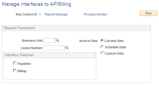

Manage Interfaces to AP/Billing Page
Use the Manage Interfaces to AP/Billing page (RUN_TXN_INTFC ) to enter the run control parameters to generate transactions into PeopleSoft Payables to create vouchers and payments.
Navigation:
Lease Administration, and then Integrations, and then Manage Interface to AP/BI
As part of the shared product functionality, the Manage Interface to AP/Billing page can also be accessed through the Asset Management navigation as follows: Asset Management > Asset Transactions > Leased Assets > Manage Interface to AP/Billing.
This example illustrates the fields and controls on the Manage Interfaces to AP/Billing page. You can find definitions for the fields and controls later on this page.
Field or Control Description
Business Unit
Enter a business unit to generate transactions that are specific to that business unit.
Lease Number
Enter a lease number to generate transactions for that lease. You must enter a business unit before you can enter a lease number.
Interface Selection
Payables
Select to send all payables transactions for the business unit and lease number parameters to the staging table. If you leave both fields blank, the system sends all approved transactions for payables leases to the payables staging table.
Billing
Select to send all billing transactions for the business unit and lease number parameters to the staging table. If you leave both fields blank, the system sends all approved transactions for receivables to the Billing staging table.
See Understanding the Interface to AP/Billing Process.
