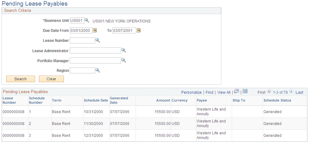

This example illustrates the fields and controls on the Pending Lease Payables page. You can find definitions for the fields and controls later on this page.
Enter the business unit and click Search to view all of the leases with pending payments and their schedules within that business unit. To view a filtered list, enter search criteria in the fields and click Search. Click Clear to clear all of the search criteria and results.
Field or Control Description
Due Date From and To
Select the date range for pending transactions that are scheduled within that range.
Lease Administrator
Select to view pending transaction schedules that are associated with that lease administrator.
Portfolio Manager
Select to view pending transaction schedules that are associated with that portfolio manager.
Term
Displays the type of transaction that is scheduled. The term can be for base rent, operating expense, miscellaneous rent, and so on.
Schedule Date
Displays the date that the transaction is expected for payment.
Generated Date
Displays the date that the transaction generator processed the transaction and placed it into the transaction queue.
Payee
Displays the entity to whom the payment is made.
Schedule Status
Displays transaction schedule status, whether the transaction is pending, or was generated to the transaction queue.
