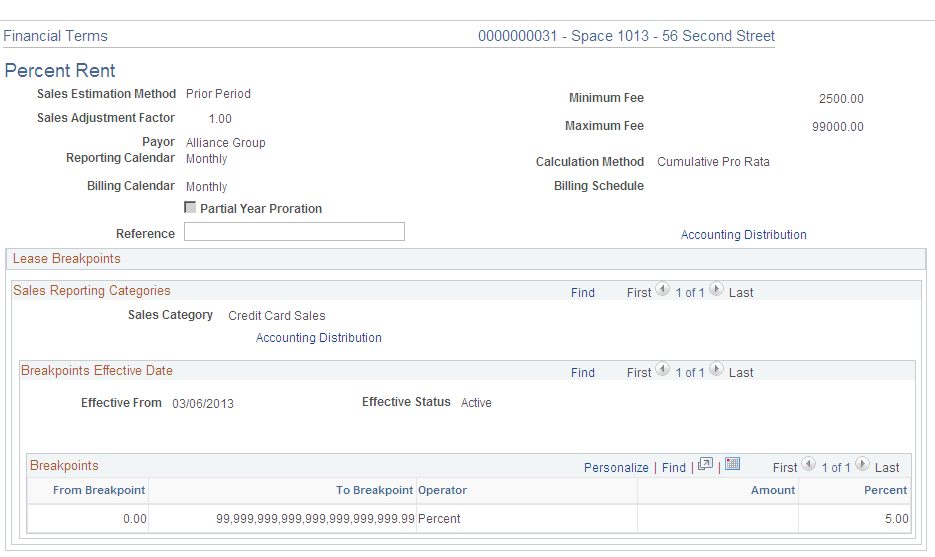

Use the Financial Terms - Percent Rent page (RE_LS_PCT RENT_SEC) to enter the sales estimation method, sales categories, and breakpoints.
Navigation:
Click the Percent Rent Details link on the Financial Terms page.
This example illustrates the fields and controls on the Financial Terms – Percent Rent page. You can find definitions for the fields and controls later on this page.
Fields and buttons available in the group boxes vary depending upon the calculation method selected.
