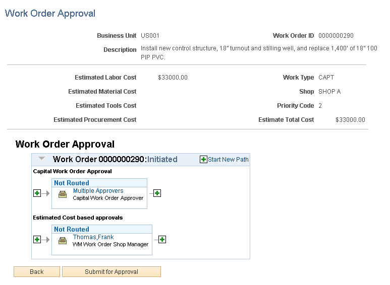

Click this button to access the Work Order Approval page, which displays the work order's estimated labor, material, and tools costs, if they exist, and the approval map. Select users can add or remove approvers at this time. Users can click the Submit for Approval button directly from this page to submit the work order for approval, or they can return to the Work Order page to submit the work order for approval from there.

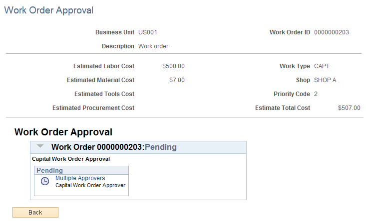

  • Click the Approval Preview button on the Work Order page.
  • Click the Approval History link once a work order has been submitted for approval to view the status of the approval process.
  • Click a work order approval item from your worklist.
This example illustrates the fields and controls on the Work Order Approval page. You can find definitions for the fields and controls later on this page.
Work Order Approval
Use this section of the Work Order Approval page to preview the approval flow.
Field or Control Description
Add
Click to add an ad hoc approval path with additional approvers or reviewers for this work order. Another page appears for you to select the user ID, and whether the person is an ad hoc approver or reviewer.
Multiple Approvers
If multiple approvers are required for a given path, click this link to review information about each approver.
<user ID>
If a single approver is required for a given path, click the user ID to review information about that approver.
Add
Click to add an ad hoc approver or reviewer to an existing path. Another page appears for you to select the user ID and whether the person is an ad hoc approver or reviewer.
Remove
Click to remove an ad hoc approver or reviewer for this work order.
Submit for Approval
Click to submit the work order for approval.
Submitting Work Orders for Approval
You can use either of the following methods to submit a work order for approval:
  • Click the Submit for Approval button on the Work Order page.
  • Click the Approval Preview button on the Work Order page to access the Work Order Approval page, review and revise the approvals if needed, then click the Submit for Approval button.

This example illustrates the fields and controls on the Review Approval History – Work Order Approval page. You can find definitions for the fields and controls later on this page.
Review Approval History - Work Order Approval page
Approval Action
If you are viewing a work order for which you are designated as an approver, enter comments, and then click Approve or Deny to update the approval status of this work order.
Approval Map
Multiple Approvers
<user ID>

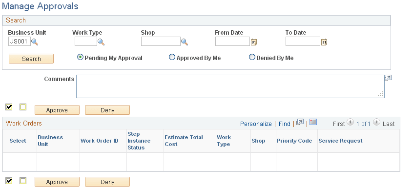

Manage Approvals Page
Use the Manage Approvals page (WM_MANAGE_APPROVAL) to search for and manage work orders that require approvals.
Navigation:
Maintenance Management, and then Work Order Management, and then Approve Work Order
This example illustrates the fields and controls on the Manage Approvals page. You can find definitions for the fields and controls later on this page.
Search
Select data in this group box to narrow your search for work orders at various stages in the approval process.
Business Unit, Work Type, and Shop
Select any of these options to narrow your search for work orders requiring approval.
From Date and To Date
Enter dates to restrict your search for work orders requiring approval within a specified date range.
Pending My Approval
Select this option to narrow the search to work orders with an approval status of Pending for this logged-in user.
Approved By Me
Select this option to narrow the search to work orders that were approved by this logged-in user.
Denied By Me
Select this option to narrow the search to work orders that were denied approval by this logged-in user.
Search
Click this button to perform a search for the work orders that fall within your specified search criteria. A list of work orders displays in the Work Orders group box.
Work Orders
Select the work orders for which to modify the approval status.
Approve
Click this button to approve the selected work orders.
Deny
Click this button to deny the selected work orders.
