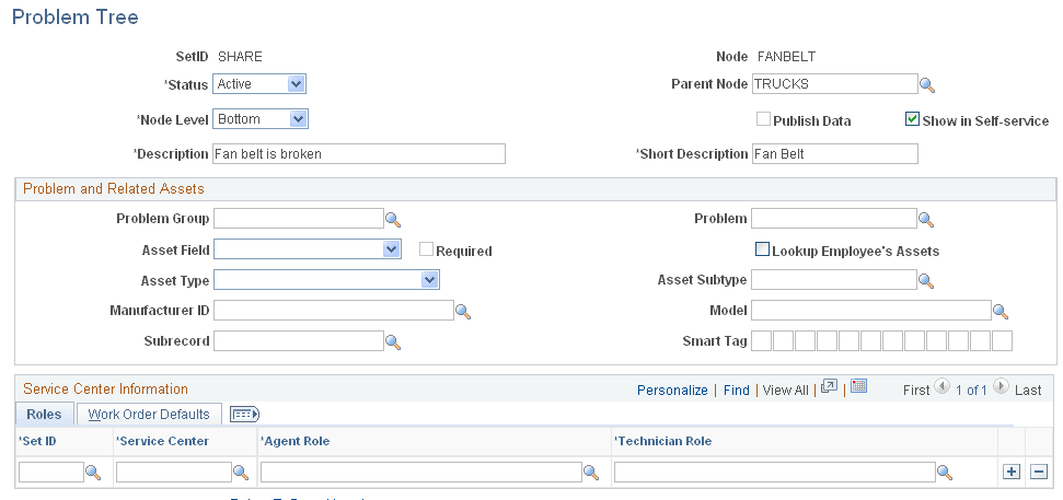

This example illustrates the fields and controls on the Problem Tree page. You can find definitions for the fields and controls later on this page.
Problem Tree page
Field or Control Description
Status
Select a status of either Active or Inactive for this node and node level.
Parent Node
Displays the name of the parent node, if applicable.
Note: Normally you add child categories by selecting the Add Child Node button, which is only available from a parent node. Selecting the Add Child Node button copies the node value into the parent node of the new child record. This creates the link for you. However, you can change the parent node value of an existing record which effectively moves the child and all of the child's children to the new parent.
Node Level
Defines the level in the tree in which the problem category resides.
  • Top
  • Middle
  • Bottom
Top level categories display in the first Request Type page of the Service Request Wizard component and in the first Request Type field in the Request Detail group box of the single page Service Request page. Middle-level categories display in the subsequent Request Type pages of the wizard and in the subsequent Request Type field of the single page Service Request page. Bottom-level categories display in the last Request Type page of the wizard and in the last Request Type field of the single page Service Request page. You cannot change the node level for a middle node unless you delete all of its children first. You cannot change the node level for a top node level.
Note: You can have as many levels as you want in a problem tree; however, Oracle recommends 3 to 5 levels.
Show in Self-Service Component
Select this check box to display the problem category in the Service Request Wizard and the single Service Request page.
Publish Data
Select this check box when you want to publish this problem tree branch as a message using Integration Broker to third-party help desk products.
Note: This check box should only be available for selection for a top-level node.
See documentation PeopleTools: Integration Broker
Problem and Related Assets
Use this group box to identify a problem group and problem which are associated with the selected node and passed on to work orders created from service requests. You select the asset classification parameters which determine which fields appear in the Request Detail group box of a service request. You can also create Smart Tags by entering a tag number, which is used to identify assets and is subdivided into groups of characters where each group represents a particular attribute of an asset. The asset classification fields specified here help to refine the asset search on the service request so that users can quickly find the assets related to the specific problem selected.
Problem Group
Select a problem group to associate with this node. If you select a problem group that is associated with specific asset classification parameters, then the asset classification parameters available for selection here are restricted only to those asset classification parameters that fall within the parameters specified for the problem group. If you do not select a problem group, then you can select any asset classification parameters that you want here. Problem group is also passed on to work orders created from service requests.
Problem
Optionally select a problem, if you selected a problem group to pass on to work orders created from service requests.
Asset Lookup Field
Select the type of field that you want to appear in the Service Request Wizard or single page Service Request from this drop-down list:
  • Asset ID
  • Do not display asset fields
  • Serial Number
  • Tag Number
  • Vehicle ID Number
Required
Select this check box to define the asset as a required entry when creating or updating a service request.
Lookup Employee's Assets
Select this check box to display only the requester's assets when selecting assets in the Service Request wizard and Create Service Request pages.
Subrecord
You must enter the value WM_MOVE_SBR for any problem categories that handle a facilities move request. Otherwise, leave this field blank.
Smart Tag
Enter the characters that represent a particular attribute of an asset at each node level for the tag value. This field is optional. A Smart Tag is a tag number, which is used to identify assets and is subdivided into groups of characters where each group represents a particular attribute of an asset. For example: For Smart Tag C4BFGMTR0002 where C4 represents "combustion turbine 4" and is entered in the Smart Tag field at the top node level, BFG represents "boiler flue gas system" and is entered at the middle node level, and MTR represents "motor" and is entered at the bottom node level, and 0002 represents a sequential equipment number. When you create a service request, you can search for an asset by selecting a Smart Tag.
See Example: Setting Up Smart Tags in a Problem Tree.
