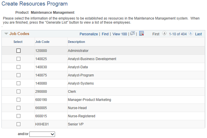

Job Codes
Select the job codes from which you want to generate employees as resources.
Field or Control Description
and/or
Select:
  • and
    If you want to narrow the list. The system includes only employees and non-employees that meet these criteria and the criteria that is in the next grid.
  • or
    If you want to include employees and non-employees that meet any of the criteria that is selected in the grids.
If you leave this field blank, the system includes employees and non-employees that meet any of the criteria that is selected in the grids.

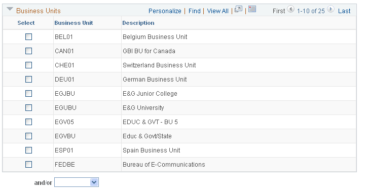

Business Units
Select the business units from which you want to generate employees as resources.
and/or
Select:
  • and
    If you want the program to generate resources based on the individuals belonging to the selected business units and selected locations identified in the next grid.
  • or
    If you want the program to generate resources based on the individuals belonging to the selected business units or selected locations identified in the next grid.

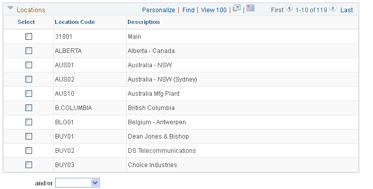

Locations
Select the locations from which you want to generate employees as resources.
and/or
Select:
  • and
    If you want the program to generate resources based on the individuals belonging to the selected locations and selected departments identified in the next grid.
  • or
    If you want the program to generate resources based on the individuals belonging to the selected locations or selected departments identified in the next grid.

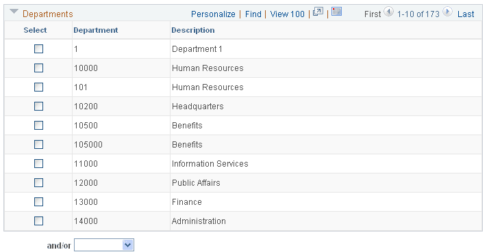

Departments
Select the departments from which you want to generate employees as resources.
and/or
Select:
  • and
    If you want the program to generate resources based on the individuals belonging to the selected departments and selected employees identified in the next grid.
  • or
    If you want the program to generate resources based on the individuals belonging to the selected departments or selected employees identified in the next grid.

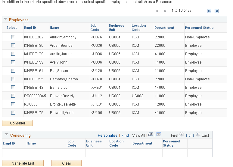

Employees
Select the employees who you want to generate as resources.
Consider
Select the employees from the list that you want to consider as resources, and then click the Consider button. The selected employees appear in the Considering grid.
Generate List
Click this button to create a draft of the proposed list of employees that the system will create as resources based on your selections in each of the grids. You can review the list and decide whether to proceed, or click the Clear button to cancel your selections in order to regenerate the list.

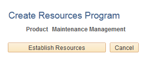

Establish Resources
Click this button to run the program to establish the list of selected employees and non-employees as resources.
The Submit Confirmation page displays when you select the Establish Resources button, which displays a message confirming that the employees that you submitted were successfully submitted as resources.
This process does not affect HRMS employee records. It establishes a new row of data in the Worker table (RS_WORKER_TBL) and Worker Effective Date table (RS_WKKR_EFFDT) for each resource.
Note: If any of the resources that you establish have more than one job in PeopleSoft HRMS (more than one active row in the JOB table), they are listed here. When you execute the process, the system selects the job with the lowest field value in the Employee Record Number field (EMPL_RCD) to enter into the Worker table and Worker Effective Date table. The lowest employee record number represents the job entry that is created first. To change an employee's job, access the Create Resources component and click the Change Job button in the Create Resources page and then click the Select button in the Establish Employee as Resource page to access the Select Job page where you can select a different job in which to assign to the employee.
Note: If the program cannot generate employees based on your selections, the Establish Resources button is not available for selection. You must return to the Create Resources Program page, change your selection criteria, and submit these new selections.
