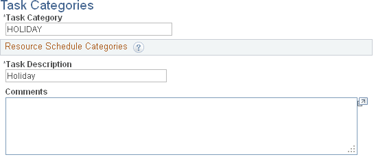

Task Categories Page
Use the Task Categories page (RS_TASK_TYPE) to distinguish between different types of tasks on a resource's schedule, for both informational purposes and in the Resource Matching Availability factor fit score calculation.
Navigation:
Set Up Financials/Supply Chain, and then Product Related, and then Maintenance Management, and then Setup, and then Setup MM Task Categories
This example illustrates the fields and controls on the Task Categories page. You can find definitions for the fields and controls later on this page.
Field or Control Description
Task Category
Enter a category to apply to a resource's schedule such as Paid Time Off (PTO), Company Holiday, Corporate Event, Meeting, Training, and Appointment. You can add these to a resource's monthly calendar.
Note: You do not set up work order tasks here. They are set up and assigned when you create a work order.
Task Description and Comments
Enter a description of this category and comments relevant to this task.
See PeopleSoft Resource Management: Understanding Resource Schedules.

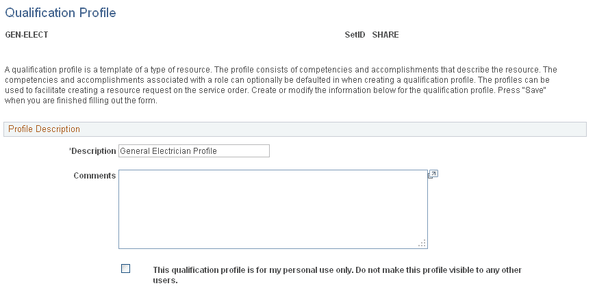

Qualification Profile Page
Use the Qualification Profile page (RS_RESRC_TEMPLT) to define generic competencies and qualifications in a template that may be accessed at the work order task level or may be associated with a craft which is identified at the work order task level.
Navigation:
Maintenance Management, and then Labor Administration, and then Labor Qualification Profiles
This example illustrates the fields and controls on the Qualification Profile (1 of 3) page. You can find definitions for the fields and controls later on this page.
This example illustrates the fields and controls on the Qualification Profile (2 of 3) page. You can find definitions for the fields and controls later on this page.
This example illustrates the fields and controls on the Qualification Profile (3 of 3) page. You can find definitions for the fields and controls later on this page.
Enter a name for the qualification profile, such as a craft name like MECHANIC, ELECTRICIAN, or PLUMBER. Enter a description and any other comments relevant to the profile you are creating.
This qualification profile is for my personal use only. Do not make this profile visible to any other users.
Select the check box if you want to use this profile for personal use and not allow anyone else to see it.

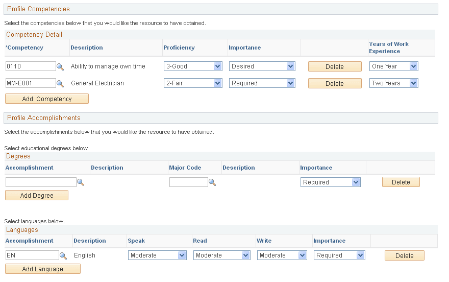

Profile Competencies
This grid enables you to select and add competencies to the profile. You can change the number of years of work experience required for each competency.
Degrees
Click the Add button to add a row to the Degrees grid. You can select and modify values for the Accomplishment, Major Code, and Importance fields.
Languages
Click the Add button to add a row to the Languages grid. You can select and modify values for the Accomplishment, Speak, Read, Write, and Importance fields.

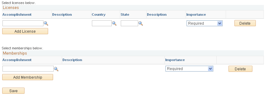

Licenses
Click the Add button to add a row to the Licenses grid. You can select and modify values for the Accomplishment, Country, State, Country, and Importance fields.
Memberships
Click the Add button to add a row to the Memberships grid. You can select and modify values for the Accomplishment and Importance fields.

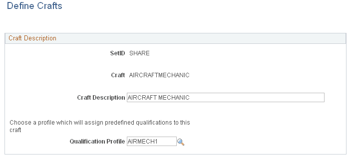

Define Crafts Page
Use the Define Crafts page (RS_CFTSETUP_PG) to describe each type of craft and any qualifications associated with the craft to enable users to associate it with resources identified in the shop and in the work order.
Navigation:
Set Up Financials/Supply Chain, and then Product Related, and then Maintenance Management, and then Resources, and then Setup MM Resource Crafts
This example illustrates the fields and controls on the Define Crafts page. You can find definitions for the fields and controls later on this page.
Define Crafts page
Craft
Enter type of craft to use to complete work orders such as electricians, mechanics, plumbers.
Select the qualification profile that describes qualifications that an employee needs to perform this craft.
Note: When a craft is added to a work order task, then the competencies, accomplishments, and qualifications associated with the qualification profile selected here for the craft are copied to the work order task labor qualification requirements for that task.

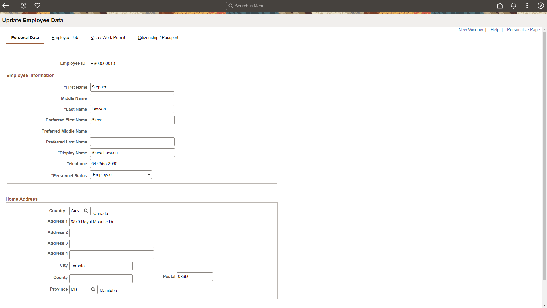

Update Employee Data - Personal Data Page
Use the Update Employee Data - Personal Data page (RS_CM_PERSONL_DATA) to add and update an employee's personal data such as address and phone number.
Navigation:
Maintenance Management, and then Labor Administration, and then Manage Employee Data
This example illustrates the fields and controls on the Updated Employee Data - Personal Data page. You can find definitions for the fields and controls later on this page.
Update Employee Data - Personal Data Page (RS_CM_PERSONL_DATA)
Enter the employee's name, telephone number, and address information.
If the page is display-only, then the information is sourced from the PeopleSoft Resource Management: Update Employee Data: Personal Data Page in Resource Management.

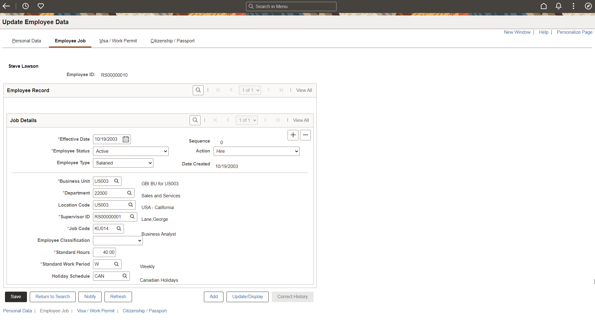

Employee Job Page
Use the Employee Job page (RS_CM_EMPL_JOB) to add and update an employee's job-related data such as supervisor and work phone.
Navigation:
Maintenance Management, and then Labor Administration, and then Manage Employee Data, and then Employee Job
This example illustrates the fields and controls on the Employee Job page. You can find definitions for the fields and controls later on this page.
Update Employee Data - Employee Job
Effective Date
Select the date that this data becomes effective in the system. You can add more than one job data record consisting of different data selected as job details for this employee. Effective Date, Employee Status, Business Unit, Department, Supervisor ID, Job Code, Standard Hours, and Standard Work Period are required fields.
The asterisk (*) by a field means that it is required and that you must select or enter a value in the field.
Important:
You must refresh the Eligible Resource Cache table (RS_ELGBL_WRKR) when routine changes are made to a resource's job-related information.

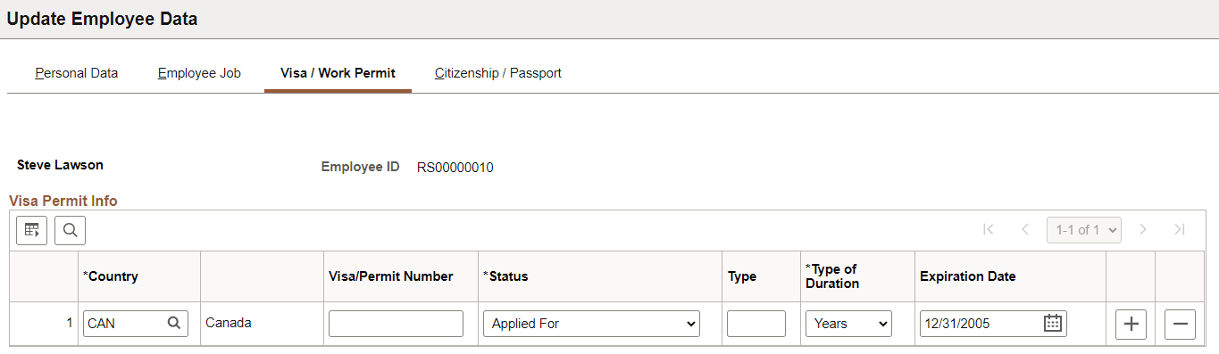

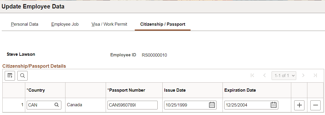

Visa/Work Permit Page
Use the Visa/Work Permit page (RM_CM_VISA_PRMT) to add and update any work permit and visa information for an employee.
Navigation:
Maintenance Management, and then Labor Administration, and then Manage Employee Data, and then Visa/Work Permit
This example illustrates the fields and controls on the Visa/Work Permit page. You can find definitions for the fields and controls later on this page.
Update Employee Data - Visa Work Permit
Add as many rows as necessary of visa and work permit information for this employee.
Citizenship/Passport Page
Use the Citizenship/Passport page (RS_CM_CITI_PASS) to add and update the citizenship and passport information for the employee.
Navigation:
Maintenance Management, and then Labor Administration, and then Manage Employee Data, and then Citizenship/Passport
This example illustrates the fields and controls on the Citizenship/Passport page. You can find definitions for the fields and controls later on this page.
Update Employee Data - Citizen Passport
Add as many rows as necessary of citizenship and passport information for this employee.
