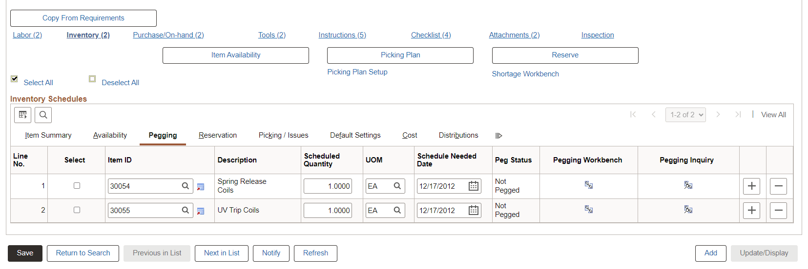

Pegging Workbench
IN_PEG_DETAIL_SP
Peg quantity for Inventory item in the work order task.
Pegging Inquiry
IN_PEG_DETAIL_SP
Review the pegging status of an item.

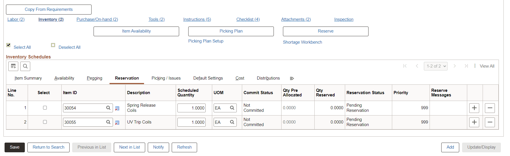

Reservation Errors
WM_WO_RESERVE_SEC
Review errors generated from Inventory when attempting to reserve an item.
Shortage Workbench
IN_SW_SELECTION
Reserve and unreserve inventory items selected for work order tasks.

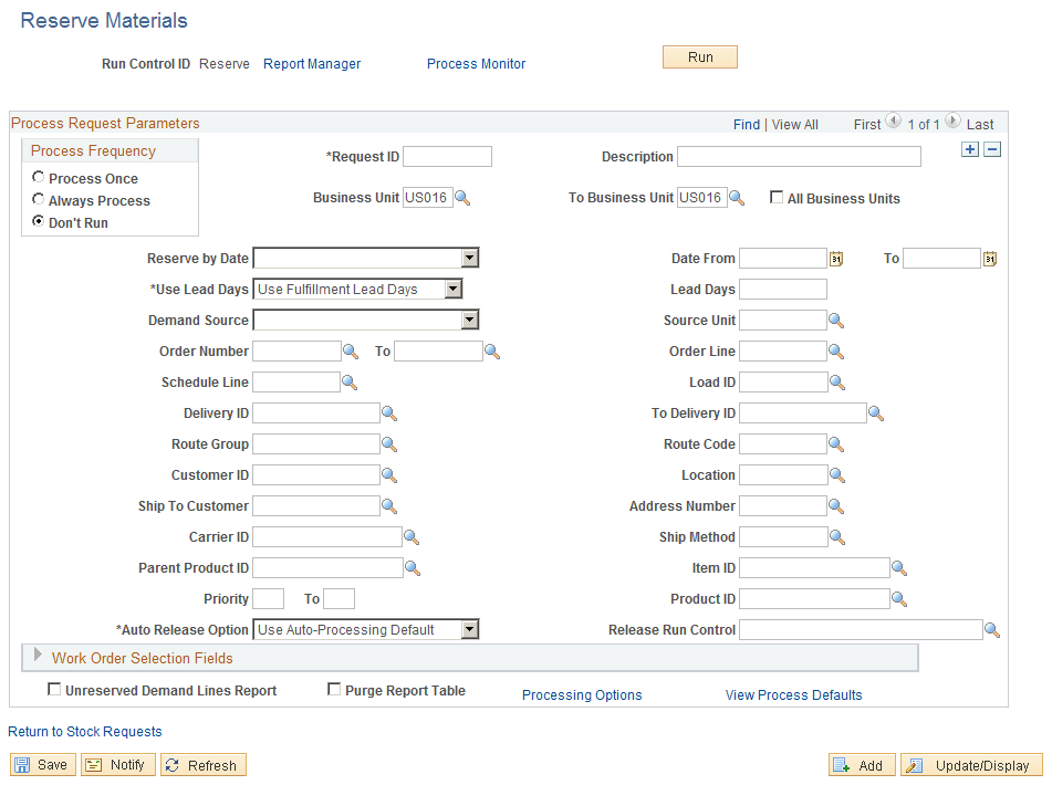

Reserve Materials
RUN_IN_FULFILL_RSV
Perform batch reservation processing of inventory items selected for a work order task.
Item Availability
WM_WO_ITMAVAIL_SEC
Review the reason why an item was identified as unavailable.
Reservation Errors
WM_WO_RESERVE_SEC
Review reservation message errors.

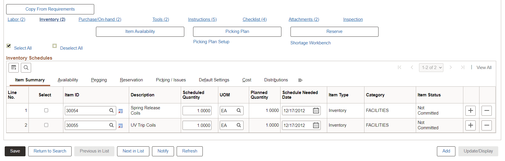

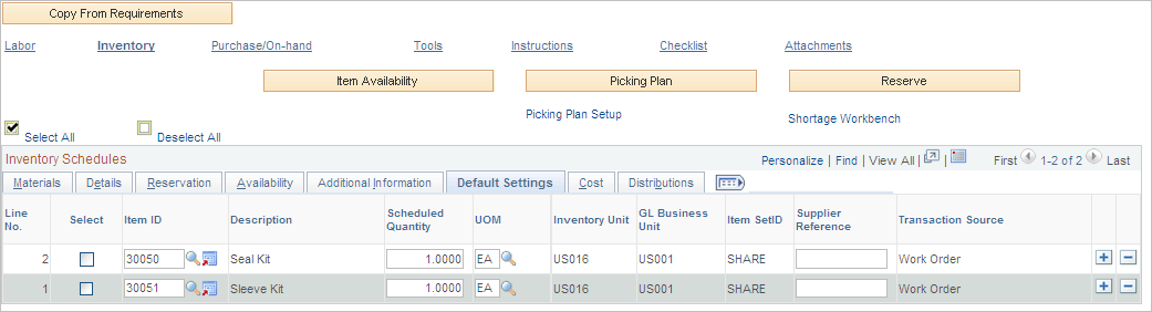

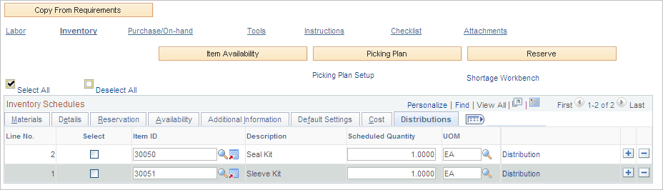

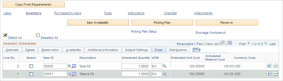

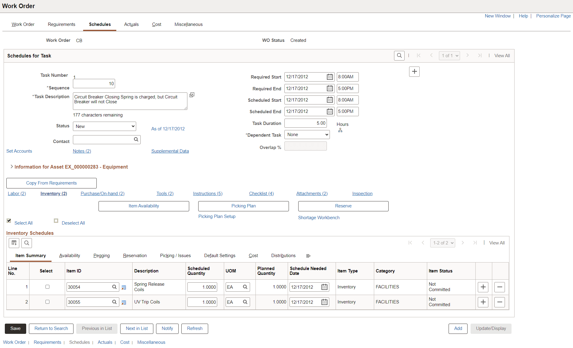

Schedules Page - Inventory Schedules
Select the Inventory Schedules tab on the Schedules page.
This example illustrates the fields and controls on the Schedules page - Inventory Schedules. You can find definitions for the fields and controls later on this page.
Field or Control Description

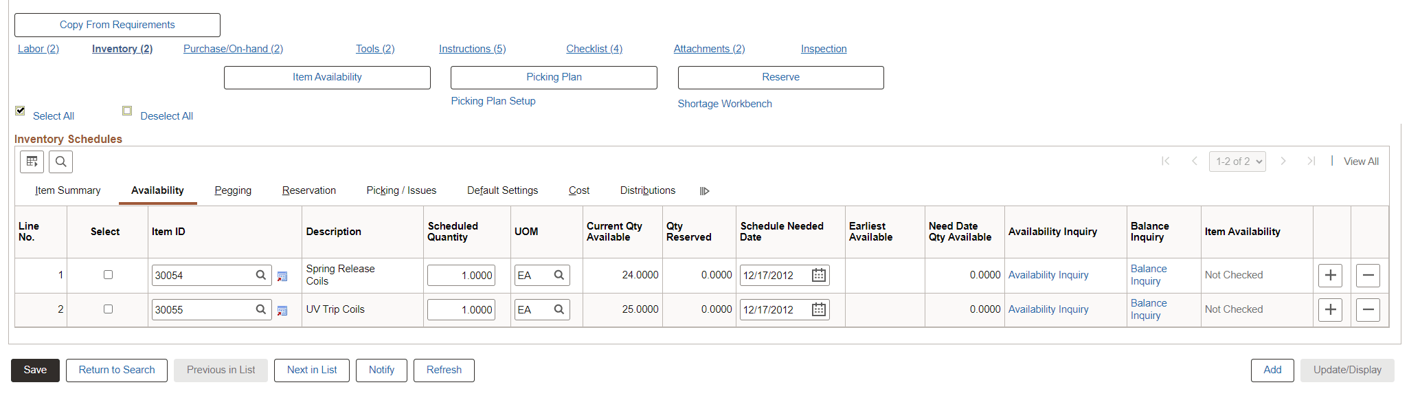

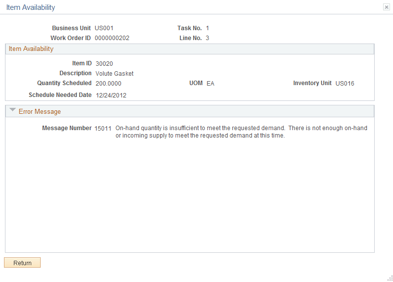

Item Availability
Click this button to determine the availability of a selected item as of the Schedule Needed Date. Selecting this button updates the Availability tab and indicates whether the quantity is available or not, the earliest available date, and the quantity available on the Schedule Needed Date.
See Inventory Schedules - Availability tab — Schedules Page.
Picking Plan
Click this button to generate a picking plan for any of the listed items that have not already been selected for a picking plan. You do not have to select each row to generate a picking plan. A message displays indicating that you submitted a picking plan and provides the process instance and pick batch ID for tracking purposes.
Note: If you indicated that items are committed based on the generation of a Picking Plan in the work order business unit's Integration page or the shop definition, then the Inventory Schedules - Reservations tab indicates that the items are committed. You must indicate in the User Preferences - Maintenance Management page that a user is authorized to run a picking plan.
Picking Plan Setup
Click this button to display the Process/Output Options page to define the allocations and run parameters for the work order picking plan report.
Shortage Workbench
Click this link to access the Inventory Shortage Workbench to reserve or unreserve the work order demand.
Note: With proper authorization in PeopleSoft Inventory, you can access the Allocations Workbench from the Shortage Workbench.
See PeopleSoft Inventory: Understanding Work Order Item Fulfillment from PeopleSoft Inventory.
Copy from EPL (copy from equipment parts list)
Click this button to access the Copy from Equipment Parts List page, where you can select among multiple EPL templates, if available, listed in descending order of applicability that match the target asset's classification criteria (asset type, subtype, manufacturer ID and model). The default template is listed at the top and is preselected. However, you can select a different template from which to copy the inventory parts. Selecting the template copies all of the inventory parts associated with the asset to the lower portion of the page. You then select the inventory parts that you want to copy to the work order task.
Add to EPL (add to equipment parts list)
Click this button to access the Add to Equipment Parts List page and add one or more selected inventory items to one or more EPL templates that appear on the page. You must select the items for each row on the Inventory Scheduling grid, enter a planned quantity, and select each item row to display the Add to Equipment Parts List page.
Reserve
Click this button to override the reservation rules hierarchy set up in the work order business unit and shop and immediately reserve the items for that task. The results of this selection displays information on the Inventory Schedules-Reservation tab.
Note: This button only appears on the page if the user is authorized to perform this activity on the User Preferences-Maintenance Management page.
Note: The user has the option to select (one or more) Inventory Schedule grid rows to be submitted for either the Picking Plan or Reserve options. If no rows are selected before clicking either the Picking Plan or Reserve button, then all the rows will be submitted for the requested function.

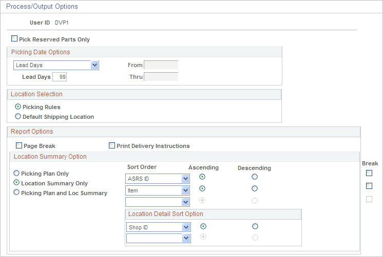

Process/Output Options Page
Use the Process/Output Options page (IN_WO_RNCTL_OPT_SP) to define the run parameters for the work order pick plan process.
Navigation:
Click the Picking Plan Setup button on the Inventory Schedules - Schedules page.
This example illustrates the fields and controls on the Pick Plan Setup - Process/Output Options page (1 of 2). You can find definitions for the fields and controls later on this page.
This example illustrates the fields and controls on the Pick Plan Setup - Process/Output Options page (2 of 2). You can find definitions for the fields and controls later on this page.
Pick Reserved Parts Only
Select this check box and run the Picking Plan to pick only the reserved inventory items (parts) associated with the work order task.
Note: If the reserve rule is pick plan, all the parts for the task will be picked regardless if they have already been reserved and Pick Reserved Parts only is selected.
Picking Plan Date Options
Select one of these values to represent the number of days needed to reserve, pick, pack, and ship the majority of the items in the Inventory business unit. The requested quantities for soft-reserve items can be reserved when the scheduled shipment date falls within one of the following reservation lead days windows:
  • Date Range
    These fields become available:
    • From:
    • Thru:
      Enter or select the beginning and end dates of the date range, which indicates the period of time that the selected items must be reserved, picked, packed and shipped in PeopleSoft Inventory.
  • Lead Days
    This field becomes available:
    • Lead Days
      Enter the number of lead days in which the requested quantities can be reserved, picked, packed and shipped in PeopleSoft Inventory.
    • Today
      Select this value to indicate that the selected items must be reserved, picked, packed, and shipped in PeopleSoft Inventory as of the current date.
Note: If you do not select or enter one of the previous values, the system will use the lead days indicated for the Inventory business unit in Inventory, Fulfill Stock Orders, Fulfillment Rules, Setup Fulfillment, Setup Fulfillment or at the item level in Inventory, Fulfill Stock Orders, Setup Item Fulfillment.
Picking Rules
These rules are assigned at either the Inventory business unit level (Inventory, and then Fulfill Stock Orders, and then Fulfillment Rules, and then Setup Fulfillment) or at the item level (Inventory, and then Fulfill Stock Orders, and then Fulfillment Rules, and then Setup Item Fulfillment) and have these options:
  • Container Option
  • Default Putaway Option
  • Default Shipment Location
  • Fixed Pick Location
  • Pick by Date
  • Random Pick Locations
Default Shipping Location
These rules are assigned at either the business unit level (Inventory, and then Fulfill Stock Orders, and then Fulfillment Rules, and then Setup Fulfillment) or at the item level (Inventory, and then Fulfill Stock Orders, and then Fulfillment Rules, and then Setup Item Fulfillment) and have these options:
  • Default Ship Staging Location
  • Default Cross Docking Location
  • Default Putaway Location
  • Default Fixed Picking Bin
  • Default Pegging Location
Page Break
Select this check box to break the pages in the report for each work order.
Print Delivery Instructions
Select this check box to print the delivery instructions provided that you entered delivery instructions in the Inventory Schedules line.
Location Summary Option
If you are using a push picking plan (the Action of Create Allocations on the Work Order Pick Plan page), you can print a Location Summary report either in addition to or instead of a full Picking Plan report. The Location Summary report sorts the demand lines according to where the items are physically stocked within the warehouse (Inventory business unit). The layout of the printed report reflects the actual positions of stock to be picked, enabling your personnel to fulfill all orders on the picking plan without revisiting locations.
It is possible to complete all of the picking using only the Location Summary report; however, you can only view details such as picking errors or picking line and schedule orders and notes if you print out a full Picking Plan report.
Picking Plan Only, Location Summary Only, and Picking Plan and Loc Summary (picking plan and location summary)
Indicate which version of the picking plan you are printing. Location summary options are only available when you select Create Allocations in the Action field on the Work Order Pick Plan page.
Sort Order
Select up to three sorting levels to sort demand lines on the Picking Plan Location Summary report. These sort orders are based on the locations within the inventory business unit (physical location table). For each level, indicate whether the sort is in ascending or descending order and whether a page break should occur.
Values for the highest-level Sort Order field are:
  • ASRS ID: (automated storage and retrieval system identification): Sorts numerically by the ASRS ID number assigned to each material storage location. The ASRS ID is assigned to a material storage location using the Material Storage Locations page.
  • Area: Sorts by storage area within the inventory business unit.
  • Area/Zone: Sorts by storage area and then sorts each storage area by picking zone.
  • Area/Zone/ASRS: Sorts by storage area, then by picking zone, and then by the material storage location's ASRS ID.
  • Area/Zone/Stor Loc: Sorts by storage area, then by picking zone, and then by material storage location.
  • Storage Location: Sorts by material storage location.
  • Zone: Sorts by picking zone.
  • Zone/ASRS: Sorts by picking zone and then sorts each picking zone by the material storage location's ASRS ID.
  • Zone/Stor Loc: Sorts by picking zone and then sorts each picking zone by the material storage location.
Once a value has been used at a higher-level sort order, the same value cannot be repeated in a lower-level sort. The values for the two lower-level Sort Order fields are:
  • ASRS ID: (automated storage and retrieval system ID): Sorts numerically by the ASRS ID number assigned to each material storage location. The ASRS ID is assigned to a material storage location using the Material Storage Locations page.
  • Container: Sorts by the storage containers with stock to be picked.
  • Item: Sorts by the item ID of the stock to be picked.
  • Lot: Sorts by the lot ID of the lot-controlled stock to be picked.
  • Serial ID: Sorts by the serial ID of the serial-controlled stock to be picked.
  • Staged Date: Sorts by the staged date of the stock to be picked.
  • Unit of Measure: Sorts by stocking unit of measure for the stock to be picked.
Location Detail Sort Option
Select up to two location detail sort options. The detail sort options are based on values located on the work order demand line, not the physical locations within the warehouse. For each level, indicate whether the sort is in ascending or descending order. Once a value has been used at the higher-level sort order, the same value cannot be repeated in the lower-level sort.
Values for the location detail sort option fields are:
  • Shop ID: Sorts by the shop ID on the work order demand line.
  • Work Order ID: Sorts by work order ID on the demand line.
  • Work Order Task: Sorts by the work order task used on the demand line.

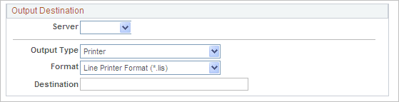

Output Destination
Select the Server, the Format of the output, and the Destination for the output, such as the name of an employee or a job location.
Output Type
Identify the type of output for your picking plan. Options are Email, File, Printer, Web, Default, Any, or Window.
Format
Identify the type of format for your picking plan. Options vary depending on the Output Type chosen.
Destination
Enter the directory into which you want to save the picking plan.

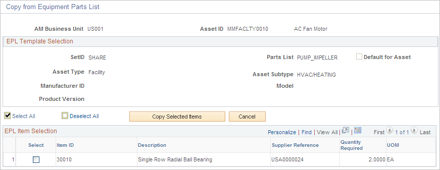

Copy from Equipment Parts List Page
Use the Copy from Equipment Parts List page (WM_EPL_SELECT_SEC) to select an inventory item associated with the selected asset for the task.
Navigation:
Maintenance Management, Work Order Management, Work Order, Schedules tab, click Inventory link, click the Copy from EPL button
This example illustrates the fields and controls on the Equipment Parts List Selection page. You can find definitions for the fields and controls later on this page.
This sample page displays for a target asset that has multiple EPL templates available. If only a single template is available, then that template displays as preselected in the top part of the page.
EPL Template Selection(equipment parts list template selection)
Displays one or multiple EPL templates. These templates are set up in PeopleSoft Asset Management. The preselected template is the default template for the selected asset, which is set up when you define the asset in PeopleSoft Asset Management.
If the system lists multiple templates, select the template from which you want to copy items to the work order. The templates are listed in order of their applicability to the target asset specified on the work order task.
The designated default template for the asset is always listed first and is preselected as the default. However, you can select the check box for any other template and the EPL Item Selection grid display will automatically refresh to display the Inventory items corresponding to the template that you selected.
EPL Item Selection (equipment parts list item selection)
Select the one or more of the items that you want to copy to the Inventory Schedules grid of the work order task to maintain or repair the selected asset.
Copy Selected Items
Click this button to copy the selected items to the Inventory Schedules grid.

Inventory Schedules - Item Summary tab — Schedules Page
Use the Inventory Schedules - Item Summary tab on the Schedules page to view details of the Inventory schedules.
This example illustrates the fields and controls on the Inventory Schedules Item Summary tab on Schedules page. You can find definitions for the fields and controls later on this page.
Item ID
Select an item ID from the Item ID Lookup page.
Note: This field can also be populated by clicking the Copy from Requirements button or by selecting items from the EPL.
Access
Click this icon to access the Item Search Criteria page, where you can enter information to perform an expanded search for an item ID, select the item, and copy it to the line in the Inventory Schedules grid.
Scheduled Quantity
Enter the quantity of items that you need for this work order task.
UOM (unit of measure)
Displays the default standard unit of measure for the item. There is a standard unit of measure and an ordering unit of measure associated with an item. All items are setup with a standard unit of measures such as EA (each). However, you can override the default standard UOM with an ordering UOM. For example, an item may be defined with a standard unit of measure of EA. You override this default value with the ordering UOM Boxsince a box may contain 4 EA.
Planned Quantity
Displays value copied from the work order task's requirements. If there are no requirements copied over, this field is not populated.
Note: You must enter an amount in this field to add an inventory item to an EPL template when you click the Add to EPL button.
Select the date that these inventory items are needed to perform the work. The default date is derived from the schedules start date for the work order task.
Item Type
Displays an Inventory item ID attribute value of either:
  • Inventory
    This type is costed.
  • Floor Stock
    This type is not costed and is not issued to the work order. Examples of floor stock items can include: common nuts and bolts, disposable gloves, belts, and tubing.
Category
Displays the category to which the listed inventory item belongs.
Item Status
Displays the current inventory item status. It helps to quickly identify where a particular scheduled inventory item is in its overall lifecycle.
Select the Inventory Schedules - Availability tab on the Schedules page.
This example illustrates the fields and controls on the Inventory Schedules Availability tab on Schedules page. You can find definitions for the fields and controls later on this page.
Current Qty Available (current quantity available)
Displays the quantity available for the item in the Inventory business unit associated with the work order business unit.
Displays the default Schedule Date for the work order task. You can override this value and enter the date that the item is needed for the work order task. When you click the Item Availability button, the system updates the Need Date Qty Available field with the quantity available as of that date.
Earliest Available
Displays a date based on selecting one or more rows then clicking the Item Availability button on the Inventory Schedules page. This date determines, based on your scheduled quantity and schedule need date, when the selected Item is available.
See Inventory Item Availability.
Need Date Qty Available (need date quantity available)
Displays the quantity available on the date that you indicated you needed it for the work order task. This displays when you click the Item Availability button.
Availability Inquiry
Click this button to access the Item/Product Availability page in PeopleSoft Inventory for the selected item based on a specific date. This page shows the cumulative ATP (Available to Promise) quantity, the available quantity, and the time phased supply and demand quantities for the item.
Balance Inquiry
Click this button to access the Item Balance by Unit page in PeopleSoft Inventory for the selected item. This page shows the quantity on hand, the quantity owned, the quantity available, and the quantity reserved for the item. It also shows the last adjustment, the last putaway date, the last order date and the last order. You can click links to access the Item Balance by All Units, the Item Balance by Location, and the Fulfillment Status components for the item.
See PeopleSoft Inventory: Understanding On-Hand Inventory Reporting.
Item Availability
Displays:
  • Not Checked, if you have not selected the Item Availability button for this row.
    If you previously checked a row for Item Availability and you modify the Item, Schedule Qty, Schedule Needed Date, or UOM values, the Earliest Available Date, Item Availability, and Need Date Qty Available field values will be initialized to Not Checked.
  • Yes, if the item is available.
  • No, if the item is not available.
    This value displays as a link, which you can select and display the Item Availability page, which contains description(s) of why the item is not available.
Item Availability Page
Use the Item/Product Availability page (ATP_SUMMARY_INV) to review the availability status of a selected item in the work order task line.
Navigation:
  • Click the Availability Inquiry link in the Inventory Schedules - Availability tab on the Schedules page.
  • Inventory, and then Manage Inventory, and then Review Inventory Balance Info, and then Item or Product Availability
This example illustrates the fields and controls on the Item Availability page. You can find definitions for the fields and controls later on this page.
When schedule an item that is unavailable and select the Item Availability button, it displays a No in the Item Availability field of an Inventory/Schedules row. When you click the No link, the Item Availability page appears with a message describing the error.
Inventory Schedules - Pegging tab — Schedules Page
Navigation:
Click the Inventory Schedules - Pegging tab on the Schedules page
This example illustrates the fields and controls on the Inventory Schedules Pegging tab on Schedules page. You can find definitions for the fields and controls later on this page.
Peg Status
Displays the peg status of the selected inventory item:
Note: The peg status that displays in this field only pertains to the purchase of Inventory items and is derived from the PeopleSoft Inventory system. You cannot purchase inventory items from PeopleSoft Maintenance Management.
  • Open
    Quantity is pegged to supply (Requisition, PO, Interunit MSR).
  • Not Pegged
    The quantity needed of the selected item is not pegged to supply (Requisition, PO, Interunit MSR).
  • Completed
    For Inventory Schedules rows, this status requires receiving into PeopleSoft Inventory so Inventory's putaway process, can set the peg status to Complete once the entire pegged quantity is putaway.
    Add/Update a PO can also update the peg status to complete if the user reduces the PO quantity to be equal to the putaway quantity. This situation will occur if the user does a partial receipt and decides not to receive any more.
  • Canceled
    This indicates that the requisition, the PO, or the Interunit Material Stock Request (MSR) to which the work order is pegged to has been canceled or the WO scheduled quantity has been decreased such that the quantity pegged has been decreased to zero, and the work order row is not pegged to any other supply.
Pegging Workbench
Click the icon to access the Pegging Workbench in PeopleSoft Inventory, where you can add the quantity needed for the item to an incoming requisition or purchase order. This essentially reserves the specified quantity for the work order task against the incoming supply. When the material is received, a notification can be generated to notify WO personnel the material has arrived.
Note: If you access the Pegging Workbench from the Inventory Schedules - Pegging tab, the system will autonumber the work order when it is saved (as long as it has not been previously saved).
Pegging Inquiry
Click this link to access the Inventory Pegging Inquiry and review the pegging details of an item.
Inventory Schedules - Reservation tab — Schedules Page
Select the Inventory Schedules - Reservation tab on the Schedules page.
This example illustrates the fields and controls on the Inventory Schedules Reservation tab on Schedules page. You can find definitions for the fields and controls later on this page.
Commit Status
Displays whether the item has been committed in PeopleSoft Inventory. The status changes to committed depending on the commit rule that you selected on the work order business unit's Integration page or the shop definition. The commit rules include:
  • Generating a picking plan.
  • Adding an item to the parts list.
  • A change in the work order task status to a specified status.
Qty Pre Allocated (Quantity Pre Allocated)
Displays the current quantity pre-allocated (if any) for the Scheduled Inventory item. The quantity pre-allocated is displayed as a hyperlink. Click the hyperlink to open the Inventory Allocation Workbench.
The Allocation Workbench displayed by clicking the Qty Pre Allocated hyperlink will have only the Detail tab visible and the Allocation Type will be set to Pre-allocation.
Note: The Qty Pre Allocated hyperlink will be enabled only if Inventory demand exists for the item. If the item has been picked or fulfilled, the quantity displayed will be zero and the corresponding link to the Allocation Workbench will be disabled.
Qty Reserved (quantity reserved)
Displays the actual quantity reserved in PeopleSoft Inventory.
Work Order demand can be reserved in the following ways:
  • You save the work order and the system processes commit and reservation rules and triggers the reservation process in PeopleSoft Inventory.
  • You click the Reserve button.
  • You run the Reserve Materials process in PeopleSoft Inventory.
  • PeopleSoft Inventory receives a pegged work order row.
  • The items are reserved on the Shortage Workbench in PeopleSoft Inventory.
Reservation Status
Displays the status of the selected item's reservation. Statuses that display include:
  • Pending Reservation.
    Reservation has not been attempted.
  • Reserve Attempted.
    Reservation has been attempted and no quantity has been reserved. This can indicate that an error has occurred preventing the item from being partially or fully reserved.
  • Partially Reserved.
    The scheduled quantity is only partially reserved, typically due to a shortage in PeopleSoft Inventory.
  • Fully Reserved.
    The total scheduled and committed quantity of items (parts) have been reserved at the business unit/item level in PeopleSoft Inventory, which increases the Qty Reserved and decreases the Qty Available amounts.
Priority
Displays default value, which is derived from the setup of the reservation rules either at the work order business unit level, shop level, or work order type level, which is set up in the shop. PeopleSoft Inventory uses this number to sort demand and prioritize it accordingly, with 1 being the highest or most important priority and 999 being the lowest or least important priority.
Reserve Messages
Displays link to Reservation Messages page, which describes the reason(s) why an item could not be fully reserved. This link appears when you attempt to reserve materials for a work order task.

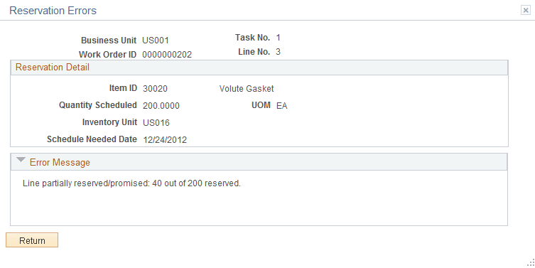

Reservation Errors
Use the Reservation Errors page (WM_WO_RESERVE_SEC) to review reservation message errors.
Navigation:
Click the Reserve Messages link on the Inventory Schedules - Reservation tab.
This example illustrates the fields and controls on the Reservation Errors page. You can find definitions for the fields and controls later on this page.
When you attempt to reserve an item on the Inventory Schedules grid and the system cannot reserve the item or can only partially reserve an item, you can click the Reserve Messages link to access the Reservation Errors page. This page describes reason that you could not reserve the item.

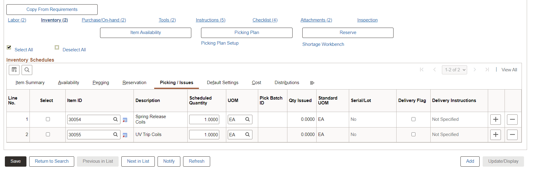

Inventory Schedules - Picking / Issues tab — Schedules Page
Select the Inventory Schedules - Picking / Issues tab on the Schedules page.
This example illustrates the fields and controls on the Inventory Schedules Picking / Issues tab on Schedules page. You can find definitions for the fields and controls later on this page.
Pick Batch ID
Displays the batch in which the pick plan was generated.
Qty Issued (quantity issued)
Displays after item is issued from PeopleSoft Inventory.
Standard UOM (standard unit of measure)
Serial/Lot
Displays a serial or lot numbers if the selected item is serial or lot controlled and quantities are issued to the inventory row. You can click a link to review the serial or lot numbers associated with the item.
Delivery Flag
Select this check box to enable you to add delivery instructions.
Enter instructions describing how you want the selected inventory item delivered.
Inventory Schedules - Default Settings tab — Schedules Page
Select the Inventory Schedules - Default Settings tab on the Schedules page.
This example illustrates the fields and controls on the Inventory Schedules Default Settings tab on Schedules page. You can find definitions for the fields and controls later on this page.
Transaction Source
Displays the source of the transaction. These values determine whether the transaction costs are Scheduled or Actuals. There are two integration points that can insert a row into the Inventory Schedules grid of a work order: From the pegging workbench you can peg a purchase order containing an inventory item back to a work order, or you can enter a direct issue from PeopleSoft Inventory to the work order. If a transaction cost is:
  • Scheduled, the system updates the Scheduled Totals on the Cost page.
  • Actuals, the scheduled costs will not be added back to the work order. The Actual Totals are updated on Cost page of the work order based when you run the Cost Summarization process.
Transaction Source values can be:
  • Work Order
    This value appears when the row is inserted directly in the work order. These are scheduled costs.
  • Inventory Direct Issue
    This value appears when a row is inserted back to a work order as a result of a direct issue from PeopleSoft Inventory. These costs are actual costs and are not rolled into the scheduled costs for the work order task.
  • Inventory Peg Workbench
    This value appears when a row is inserted back to a work order from the pegging workbench. These are scheduled costs.
Note: For Inventory Schedules rows that are created by a direct issue from PeopleSoft Inventory, the Scheduled Quantity field will be 0 and the entire row will be disabled. The disabling of these rows prevents any changes and keeps the work order in sync with the feeder applications that created them.
See Inventory Requirements.
Inventory Schedules - Cost tab — Schedules Page
Select the Inventory Schedules - Cost tab on the Schedules page.
This example illustrates the fields and controls on the Inventory Schedules Cost tab on Schedules page. You can find definitions for the fields and controls later on this page.
Estimated Unit Cost
Displays the unit cost of the item. PeopleSoft Inventory determines the cost method of the item based on the primary book for the Inventory business unit and the cost profile of the business unit/item. For example, if the primary book for the Inventory business unit is FIN01 and the cost profile of the business unit/item is PERPAVG, the unit cost for the item will be the perpetual average cost for the item.
Scheduled Material Costs
Displays unit cost of each item scheduled, which is derived from PeopleSoft Inventory, multiplied by the scheduled quantity.
Currency Code
Converts Inventory currency to currency identified in the work order business unit.
Inventory Schedules - Distributions tab — Schedules Page
Select the Inventory Schedules - Distributions tab on the Schedules page.
This example illustrates the fields and controls on the Inventory Schedules Distributions tab on Schedules page. You can find definitions for the fields and controls later on this page.
Distributions
Click this link to access the distribution data specified for the row after an assignment has been made. You can override the values if necessary.
Note: This link only displays if the View and Update Accounting check box on the User Preferences - Maintenance Management page is selected for this user.
Reserve Materials Page
This example illustrates the fields and controls on the Reserve Materials page. You can find definitions for the fields and controls later on this page.
The handling of this page for work orders is described in the PeopleSoft Inventory documentation set of topics, Fulfilling Work Orders from PeopleSoft Maintenance Management.
See PeopleSoft Inventory: Committing, Pre-Allocating, and Reserving Work Orders.
