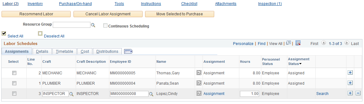

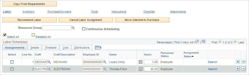

Assignments tab — Schedules Page
Select the Labor Schedules - Assignments tab on the Schedules page.
This example illustrates the fields and controls on the Labor Schedules - Assignments tab. You can find definitions for the fields and controls later on this page.
Field or Control Description
Warning (warning) and Error (error) and Information (information)
Displays either a warning icon or an error icon and displays the Messages tab explaining the icon when the page is saved.
Note: The information icon does not appear in the sample page.
Craft and Craft Description
Select the craft required for the work order task. You can also click the Copy From Requirements button to copy the labor resource requirements specified on the Requirements page to the Labor Schedules grid.
Employee ID
Select the employee ID of the technician that you want to assign to the work order task. Selecting an employee enables you to access the selected employee's monthly, weekly, and daily calendar. This option is known as direct assignment and does not use the Resource Match to help find a qualified resource. If you assigned resources on the Labor Assignments Workbench, those resource assignments also display in the appropriate rows on this page.
Note: Resources who are assigned to a shop other than the shop associated with the work order usually require approval by the resource's shop manager. You set up workflow approval ahead of time, by setting up the work order business unit Options page, which is used to issue emails to the resource's supervisor and to the resource, if desired. Once assignment approval is set up, when you select an employee ID in this field, enter the hours and other details and save the work order, a message appears indicating that this employee requires approval and that you must access the Worklist link in the page.
See documentation PeopleTools: Workflow Technology.
Calender
Click this icon to display the selected employee's monthly calendar. This calendar is updated with any assignments entered for the resource.
See Monthly Schedule Page.
Hours
Enter the total number of hours that you need the selected employee to work on this task.
If you entered this assignment on the Labor Assignment Workbench, the assigned hours display from the workbench.
Note: You can change these hours as long as they have not been assigned and depending on the work order task status.
See Understanding Service Request and Work Order Statuses.
Personnel Status
Displays the status of the employee, such as employee, contractor, supervisor. This information is derived from the employee's profile.
Assignment Status
Displays the assignment approval status as:
  • Assigned
  • Canceled
  • Complete
  • Pending Approval
    This status only applies to employees that you assign who work for a shop other than the shop associated with this work order. You must also set up labor resource assignment approval workflow.
  • Rejected
Search
Click this link to access the Search Labor Resources page, where you can enter search criteria to search for labor resources to assign to a work order task. This is one of the three methods used to identify resources for a task. You must select a craft and enter the hours in the Labor Schedules - Assignments tab before you click this link.

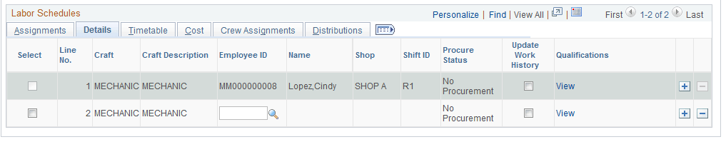

Labor Schedules - Details tab — Schedules Page
Select the Labor Schedules - Details tab on the Schedules page.
This example illustrates the fields and controls on the Labor Schedules - Details tab. You can find definitions for the fields and controls later on this page.
Shop ID and Shift ID
When you select an employee ID, the system displays the shop associated with the selected resource based on if:
  • The crew assignment is enabled in the shop and the resource belongs to the shop's crew, then the shop associated with the crew and the resource's weekly shift identified in the shop display as default values in the fields.
  • The crew assignment is not enabled for the shop and the resource belongs to the shop identified in the work order header shop, the shop in the work order header and the resource's weekly shift display as default values in the fields.
  • The resource does not belong to either the crew's shop or the shop identified in the work order header, the system displays a shop to which the resource belongs and the resource's weekly shift for that shop. If the resource belongs to multiple shops, the system selects one shop as the default value. Currently, users cannot specify a primary shop as the default shop in the work order task.
Overbook Flag
Select this check box to allow the overbooking of a resource. Leave this check box blank if you do not want to allow overbooking for this resource.
Note: This option displays only if you clicked the Require Manual Override button in the shop associated with this work order.
Procure Status
Indicates whether this resource is being procured and the status of that procurement.
Update Work History
Select this check box to update the work history based on the work order task for the resource.
Qualifications
Click this link to view the resource's qualifications profile.
Note: You can view, but not modify the labor qualifications entered on the Labor Requirements - Details tab.
See Qualification Profile Page.

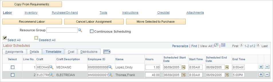

Labor Schedules -Timetable tab — Schedules Page
Select the Labor Schedules -Timetable tab on the Schedules page.
This example illustrates the fields and controls on the Labor Schedules - Timetable tab. You can find definitions for the fields and controls later on this page.
Scheduled Start Date, Scheduled Time, Scheduled End Date, and Scheduled Time
Adjust these dates and times to schedule this resource's work in the work order task if the fields are enabled. These dates and times cannot exceed the scheduled start and end dates and times for the work order task. If you entered this assignment on the Labor Assignment Workbench, the values from the workbench display in these fields. However, the changes are validated against the crew schedule requirements and the work order task schedules:
If the Labor Schedules rows originate from the Labor Requirements rows, then:
  • If the schedule has crew assignments, the scheduled start and end dates and times must fall within the requirement crew scheduled start and end dates and times.
  • If the schedule has no crew assignment, the scheduled start and end dates and times must fall within the work order task scheduled start and end dates and times.
For example if Labor Schedules rows 1 and 2 originated from Labor Requirements row 1, and Labor Requirement row 1 is crew assigned, then the scheduled dates and times for Labor Schedules rows 1 and 2 must fall within the crew schedule dates and times for Labor Requirements row 1.
If the Labor Schedules rows did not originate from the Labor Requirements rows, then the scheduled dates in the rows are validated against the task schedules dates and times.

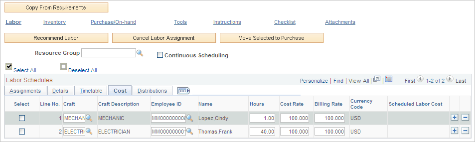

Labor Schedules - Cost tab — Schedules Page
Select the Labor Schedules - Cost tab on the Schedules page.
This example illustrates the fields and controls on the Labor Schedules - Cost tab. You can find definitions for the fields and controls later on this page.
Cost Rate and Billing Rate
These default rate values come from rates entered in either the work order business unit's Integration page, the rates specified for a shop, or the rates specified in the shop for the resource's craft depending on the setup. These scheduled costs are summarized in the work order and compared to the actual costs that come from PeopleSoft Project Costing after the work order task is completed and display in the work order's Cost page. The default Currency Code is derived from the work order business unit.

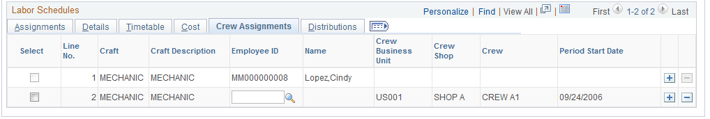

Labor Schedules - Crew Assignments tab
Select the Labor Schedules - Crew Assignments tab.
This example illustrates the fields and controls on the Labor Schedules - Crew Assignments tab. You can find definitions for the fields and controls later on this page.
This tab only appears if you have scheduled a crew on the Crew Scheduling Workbench for this work order.
Crew Business Unit
Displays value derived from the Crew Scheduling Workbench.
Crew Shop
Crew
Displays crew selected on the Crew Scheduling Workbench for each task row.
Period Start
Displays period start date derived from the Crew Scheduling Workbench.
See Understanding Crew Scheduling.

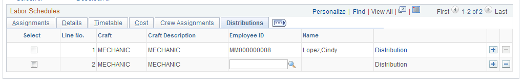

Labor Schedules - Distributions tab — Schedules Page
Select the Labor Schedules - Distributions tab on the Schedules page.
This example illustrates the fields and controls on the Labor Schedules - Distributions tab. You can find definitions for the fields and controls later on this page.
Distributions
Click this link to access the distribution data specified for the row after an assignment has been made.
Note: This tab only displays if the View and Update Accounting check box is selected in User Preferences for the user performing the scheduling.

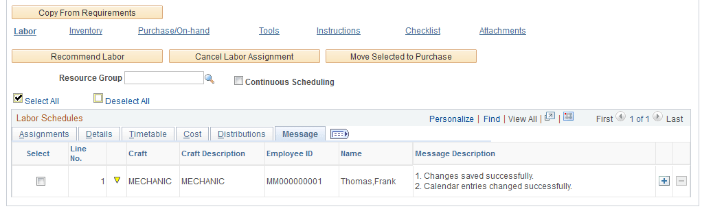

Labor Schedules - Messages tab — Schedules Page
Select the Labor Schedules - Messages tab on the Schedules page.
This example illustrates the fields and controls on the Labor Schedules - Message tab. You can find definitions for the fields and controls later on this page.
This tab only displays if a warning, or error message is issued when you save the page.
Warning
Indicates that there is a warning associated with this selection.
Message Description
Displays a description of the warning in the Message Description field for the row.
Error
Indicates that there is an error associated with this selection. A description of the error displays in the Message Description field for the row.
