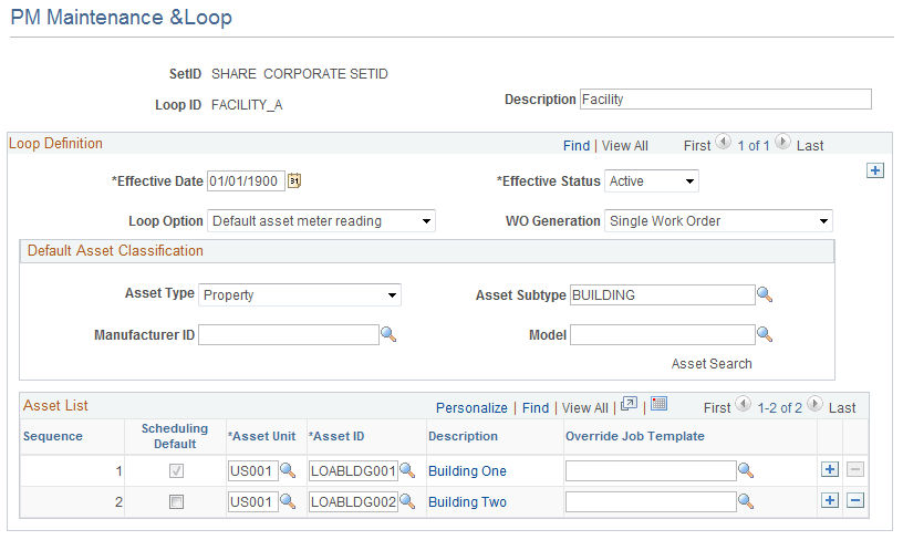

PM Loop Page
Use the PM Loop page (WM_PM_MAINT_LOOP) to create a preventive maintenance loop to perform routine maintenance tasks on groups of homogeneous assets or groups of heterogeneous assets.
Navigation:
Maintenance Management, and then Preventive Maintenance, and then PM Schedule Management Setup, and then Maintenance Loop
PM Loop page
PM Maintenance & Loop Page
Loop Definition
Field or Control Description
Effective Date
Enter the date to create a preventive maintenance loop.
Effective Status
Select the status for the loop definition. It can be either Active or Inactive.
Loop Option
Select one of the two given options:
  • Default asset meter reading – PM and Projection processes use the meter readings related to the scheduling default asset only to determine when the maintenance is due. In case, the maintenance is due, all assets in the loop list will be added in the scheduled maintenance work order(s).
  • Individual asset meter reading - PM and Projection processes use the meter readings related to each asset in the loop list to determine when the maintenance is due. Only the assets based on the meter reading that have the maintenance due will be added in the scheduled maintenance work order(s).
WO Generation
  • Single Work Order – generate a single work order for all the assets.
  • Multiple Work Orders – generate work order for every asset defined in the loop. If maintenance is not due then the work order will not be created.
Default Asset Classification
Asset Type, Asset Subtype, Manufacturer ID, and Model
Specify the asset classification values that are common to the homogeneous (similar) assets within the loop, such as Fleet and Auto. You must also select asset IDs for each asset that is listed in the Asset List grid for both homogeneous and heterogeneous (dissimilar) assets. The asset IDs that you select must either fall within these selected default asset characteristics, or be associated with an override template. If you select only heterogeneous asset IDs in the Asset List grid, and you select an override template for each asset ID, then you do not have to select any asset characteristics (asset type, asset subtype).
Note: For homogeneous assets, you must, at a minimum, specify both asset type and asset subtype. If you also choose to identify a model, you must also identify the manufacturer ID. You cannot skip over a member in the asset category hierarchy.
Asset Search
Click to access the Asset Search page.
Note: You must specify an asset type and asset subtype at a minimum to perform the search.
See Asset Search Page (WM_ASSET_SRCH_SEC).
Asset List
The Asset List grid lists the homogeneous (similar) assets that you copied from the Asset Search page. You can also select individual (heterogeneous) assets and their associated business units directly in the grid.
Scheduling Default
Select to indicate which asset's actual meter reading controls the scheduling of all of the assets in the Asset List. For example, if you have three different odometer readings for three cars, you must select one for the Preventive Maintenance Process to use to perform the calculations that are necessary to determine whether to create a work order.
Note: The first asset in the list is selected by default. However, you can override this default and select the check box for another asset. You can identify only one asset as the scheduling default.
Description
Click to access the Asset Information page that contains details about the selected asset in the row.
Override Job Template
Select a work order job template to associate with each heterogeneous asset in the grid. This association with a work order job template is required for all heterogeneous assets in the Asset List grid. You must specify a job template in this field for any asset that has classification parameters that are different from the classification parameters that are specified on the loop header for homogeneous assets.
You may optionally select a work order job template to associate with each homogeneous asset that is listed in this Asset List grid. If you specify a template here for a homogeneous asset, it overrides any template that is set up in the Loop Schedule. If this field is left blank for homogeneous assets, then the template that is specified in the Loop Schedule for this loop ID is used when the work order is created.
