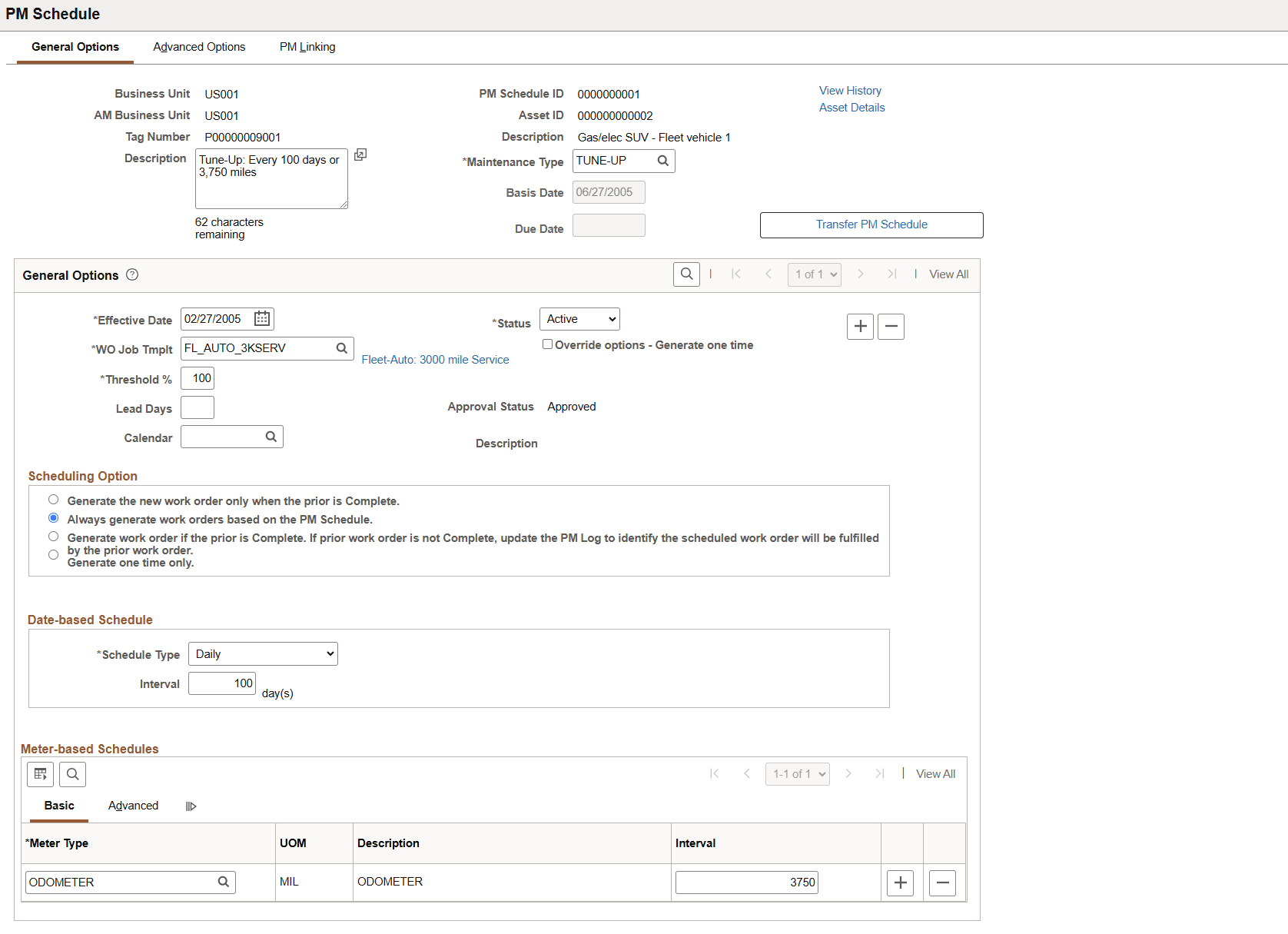

PM Schedule - General Options Page
WM_PM_SCHD_PG1
Define the date-based and meter-based rules for the Preventive Maintenance Process to use in determining the next due date upon which to generate a preventive maintenance work order.

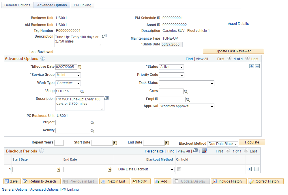

PM Schedule - Advanced Options Page
WM_PM_SCHD_PG2
Define work order header specifications, which are optional, that the Preventive Maintenance Process uses when it creates a work order and also define blackout periods to apply to the scheduling rules that are set up on the General Options page.

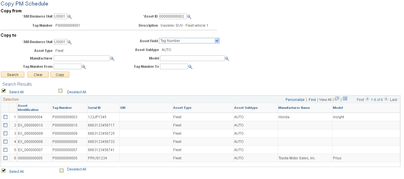

Copy PM Schedule Page
WM_PM_SCHD_CPY
Copy data from an existing PM Schedule to a new PM Schedule.

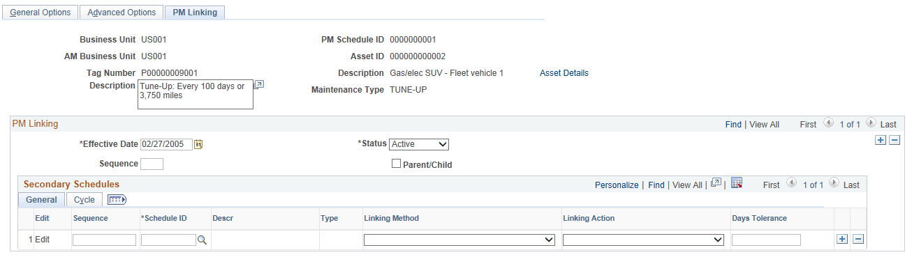

PM Linking Page
WM_PM_SCHD_LINK
Link secondary schedules to a primary schedule.

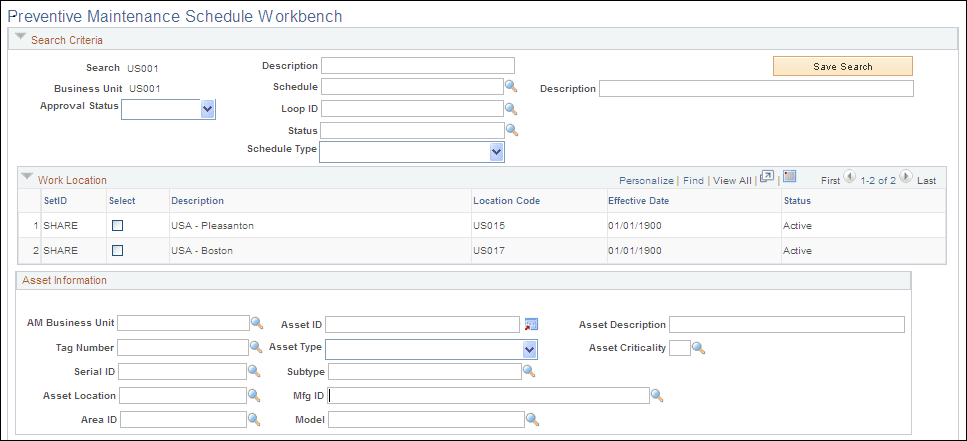

Preventive Maintenance Schedule Workbench Page
WM_PM_SCHD_WKBC
Maintain an asset's preventive maintenance schedules.

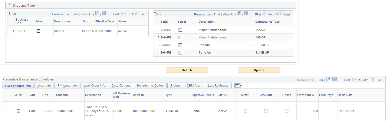

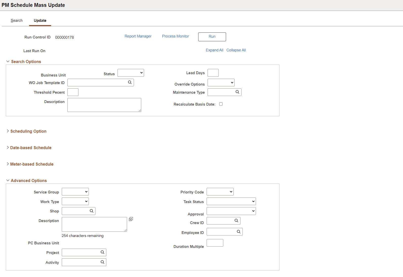

PM Schedule Mass Update – Search Page
WM_PM_SCH_UPD_RUN1
Enter search criteria to search for PM schedules on which to run the Mass Update process.
PM Schedule Mass Update – Update Page
WM_PM_SCH_UPD_RUN1
Select the information on the schedules that you want to update and run the PM Mass Schedule Update (WM_PMSCH_UPD) process, which updates each of the selected schedules.

Secondary Schedules Linkage to Primary Schedules
You can link related secondary schedules to a primary schedule for a single asset, asset loop, or a location on the PM Linking page of the primary schedule. Primary and secondary schedules are determined by the maintenance type that you assign to the schedule, as well as the schedule's description. When the PM process runs, it schedules and generates preventive maintenance work orders for the maintenance of the asset, asset loop, or location identified in the primary schedule, as well as the maintenance of one or more secondary schedules that are linked to this primary schedule and have the same due date. This synchronization reduces equipment downtime and lessens the possibility of performing unnecessary maintenance.

You can assign a schedule ID to a PM Schedule, or you can set up a PM Schedule without a schedule ID and when you save the schedule the system automatically generates a schedule ID for you. You associate each schedule with a maintenance type that you set up in PeopleSoft Asset Management. Maintenance types are user-defined and are used to divide service maintenance procedures into specific categories. You can set up as many maintenance types as you need. However, you must also set up maintenance types, which you defined in PeopleSoft Asset Management, in PeopleSoft Maintenance Management to associate each maintenance type with an asset type and asset subtype. Each preventive maintenance schedule is categorized by the type of maintenance that is being performed. For example, you can set up maintenance types as major, minor, rebuild, tune-up, 3000 mile service, 6000 mile service, and more. You also must specify either the asset, preventive maintenance loop, or location that you want to schedule for this type of maintenance.
If your organization plans on linking primary and secondary PM regular, loop, and location schedules, you will want to set up maintenance types in PeopleSoft Asset Management to categorize your schedules according to the level of maintenance to be performed. For example:

Based on this setup, you can link the secondary schedules (002, 003, and 004) to the primary PM Schedule (001) by selecting them on the PM Linking page of the primary PM Schedule. You can click an Edit link to view and edit each secondary schedule.

Basis Date
The Basis Date for PM Schedule is established on the Schedule- General Options page. The PM projection and PM processes use this date to determine the base date for generating the first preventive maintenance work order cycle. The only instance the basis date is not used for a schedule is when you enter a specific date for the maintenance to occur. Once the first preventive maintenance work order is created, the basis date becomes unavailable for selection, but can be viewed for informational purposes. The next scheduled due date for all subsequent preventive maintenance work orders is determined using the required start date, or, depending on the schedule options selected, the completion date associated with the previously generated preventive maintenance work order.

Override Options – Generate One Time
You can select or unselect this check box on the schedule. If you select this check box, the Preventive Maintenance Process creates a work order and disregards any date-based or meter-based rules that are set up in the schedule only once. The process also removes the check mark from this option (changes it to off) so that the process generates a work order and considers the date and meter rules the next time you run it. If you want the process to generate another work order that disregards the date and meter rules, then you must access the Schedule page and select this option again.
A condition-based alert is issued because a meter reading for an asset exceeds the meter reading range set up in the PM Schedule. This causes the automatic selection of the Override Options — Generate One Time check box on the schedule, which causes the Preventive Maintenance Process to generate a work order.
See Understanding Meter Ranges and Condition-Based Preventive Maintenance Work Orders.
Threshold Percentage
The threshold percentage is used for calculating the next maintenance due date for date-based, fixed meter, and meter-based rules. It is not used for calculating the next maintenance due date for specific date and projected meter rules. When a schedule has both fixed meter rules and date-based rules and the threshold percentage is used to calculate the preventive maintenance start date, then the Preventive Maintenance Process applies the threshold percentage to rules that have a target date closest to the current date.
For example, a date-based schedule for a vehicle's maintenance is monthly and the meter (odometer) interval is every 1000 miles. The system keeps track of the percent due date-based and meter-based figures for reporting purposes. If you enter a threshold percentage in the schedule's General Options page, the Preventive Maintenance Process creates a work order if the calculated percent due for either the date-based or meter-based readings is more than or equal to the threshold percentage. In this example, if you entered a threshold percentage of 70, and the percentage of the next maintenance due for the date-based reading is 65 and the percentage of the next maintenance due for the meter-based reading is 70, then the Preventive Maintenance Process creates a work order based on the meter-based reading.
Lead Days
Users can generate a preventive maintenance work order with a future due date by entering a specific number of lead days in the Lead Days field on the PM Schedule. This information also displays on the Preventive Maintenance Schedule Workbench. The Preventive Maintenance process ensures that the current date plus the number of lead days is equal to or greater than the calculated due date for the preventive maintenance work order and then creates the work order. If the lead days entered do not trigger the creation of a work order, the threshold percentage, if applicable, will generate the work order.
Lead days are based on a 7 day per week calendar instead of a business calendar.
See Understanding Preventive Maintenance Schedules.
Scheduling Options
Different options are available for generating work orders based on both date-based and fixed-meter preventive maintenance schedules, which include:
  • Generate the new work order only when the prior is complete.
    The Preventive Maintenance Process generates the next preventive maintenance work order for the selected asset, loop, or location only after the previously generated work order's status is marked complete.
    The process generates only one work order at a time for the PM Schedule. You must mark the PM work order complete before the process can generate another work order.
  • Always generate work orders based on the PM Schedule.
    The Preventive Maintenance Process generates the next scheduled preventive maintenance work order even if the status of the most recently generated preventive maintenance work order is a status other than complete. The Preventive Maintenance Process continues to generate a work order for the next scheduled maintenance. A good example is when users set up a schedule to perform maintenance on a fleet of cars monthly and they are unable to complete the work before the next due date. This means that the first work order has a status of open. When the next due date comes up, the Preventive Maintenance Process creates a new work order with a status of open. Even if you change the status of the generated work order to complete, canceled, or open, the selected status does not affect the generation of the next preventive maintenance work order. This is important for organizations that need a method to keep track of every scheduled maintenance, even if the maintenance was not able to be performed.
  • Generate a work order if the prior work order's status is complete. If the prior work order's status is not complete, update the PM Log to identify that the scheduled work order will be fulfilled by the prior work order.
    In this case, if you do not change the status of the current open work order to complete, then on the next maintenance due date, the Preventive Maintenance Process generates the next preventive maintenance audit record, which points to the open work order. The process continues creating audit records when the next due date or meter reading is due. Each audit record provides a method of tracking preventive maintenance work which was included as part of an existing work order.
  • Generate one time.
    In this case, the Preventive Maintenance Process generates a preventive or scheduled maintenance work order only once. This option is often used for equipment that is under warranty to generate a final inspection of the asset before its warranty expires. The schedule type that you can select for this scheduling option is either None, which is used when a schedule applies only meter-based rules, or Specific Date.
Scheduling options do not apply to projected meter rules.

The scheduling option that you select affects the fields that appear for the selected schedule type. This table describes the fields that appear in the Date-based Schedule group box when you select a specific schedule type after selecting a specific scheduling option:
Scheduling Option / Schedule Type Daily Monthly by Date Monthly by Day Weekly by Day Specific Date
Field:
Interval (days)
Check box:
From Last PM Completion
Fields:
Interval (days)
Date of Month
Fields:
Interval (month(s))
Week of the Month
Day of the Week
Fields:
Interval (week(s))
Day of the Week
NA
Fields:
Interval (days)
Same as above.
Same as above.
Same as above.
NA
Generate work order if the prior is complete. If prior work order is not complete, update the PM Log to identify that the scheduled work order will be fulfilled by the prior work order.
Same as above.
Same as above.
Same as above.
Same as above.
NA
Generate one time only.
NA
NA
NA
NA
Field: Schedule Date

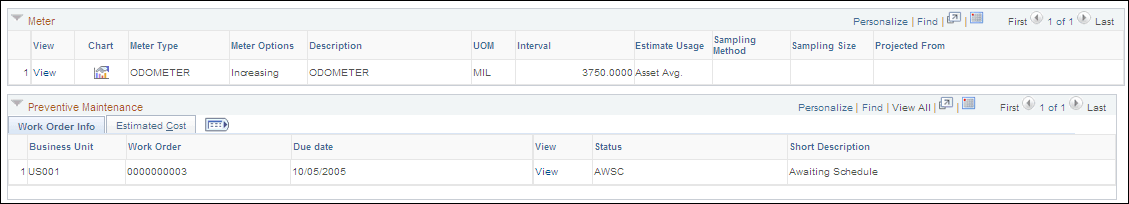

Next Maintenance Due Calculations - Meter-based Schedules: Basic (Fixed) Meter Readings
The Preventive Maintenance Process calculates the next maintenance due date and generates a work order based on the meter rules that are defined in the General Options page of the preventive maintenance schedule. You define the fixed meter rules on the Basic tab of the grid by selecting a meter type and entering the intervals for the meter readings. The Preventive Maintenance Process uses increasing and decreasing meter types. The start date in the work order header is considered the current date. The system determines when the next maintenance is due and when to create a work order by comparing the current equipment meter reading to the next maintenance due reading, which is the last meter reading plus the interval that is defined in the preventive maintenance schedule. If the asset has multiple meters associated with it, all meter intervals that are reached first cause the Preventive Maintenance Process to trigger the automatic creation of a work order.
For example, if the last maintenance for a car was performed when its odometer reading was 7000 miles, and the meter interval specified to indicate that the next maintenance due in the preventive maintenance schedule is 1000 miles, then the Preventive Maintenance Process creates the next preventive maintenance work order when the odometer of the car reaches 8000 miles. An odometer is an example of an increasing meter type.
If you enter a threshold percentage amount, the Preventive Maintenance Process takes that number into account, as well as any specified blackout periods, when it creates a work order. For blackout periods, this means that if a meter reading interval is every 1000 miles, and the interval is reached during a blackout period, then the process does not create a work order. In addition, the Preventive Maintenance Process will not create a work order if the threshold percentage is equal to or less than the calculated percentage during a blackout period.
Once meter readings are entered in PeopleSoft Asset Management for the asset, the Preventive Maintenance Process uses the accumulated reading in the asset's Meter Reading History to determine the next maintenance due date.
The formula that the Preventive Maintenance Process uses to determine the next maintenance due date for preventive maintenance is based on an increasing meter type. The formula is
Next Meter Reading = Last PM Work Order Meter Reading + Meter Interval
Important:
The Last PM Work Order Meter Reading value is used only for a PM Schedule in which you selected either the Generate the new work order only when the prior is Complete, Always generate work orders based on the PM Schedule, or Generate work order if the prior is Complete scheduling option.
If the prior work order is not complete, the process updates the Preventive Maintenance Process log to indicate that the scheduled work order will be fulfilled by the prior work order. In this case, the Preventive Maintenance Process uses the previously calculated meter reading. Thus, you do not have to enter the last work order reading.
If this is the first preventive maintenance cycle, which means that no last preventive maintenance meter reading exists, the Preventive Maintenance Process uses zero as the lower limit reading in the formula:

Advanced Options
This page enables you to define default values for the work order header. Values that you enter in this page override values that are set up elsewhere, such as the work order business unit. The default shop that you specify determines whether the preventive maintenance work orders that are generated require crew scheduling.
PeopleSoft Project Costing Data
You can set up PeopleSoft Project Costing data for a preventive maintenance work order here, or else the system will create the work order with the default project ID and generate an activity ID. When you save a PM Schedule, the system verifies that a default project exists.
If this preventive maintenance work order is associated with a Project Costing-managed project, then you can select both the project ID and the activity ID. Only one project activity is associated with all the work order tasks that are performed for a preventive maintenance work order.
If the preventive maintenance work order is associated with a work order-managed project, then you can select the project ID and the activity is generated automatically when the Preventive Maintenance Process creates the work order. If you leave both of these fields blank in the schedule for a work order-managed project, the Preventive Maintenance Process assigns the project ID and the activity ID based on the work order business unit, work order type, and service group values that you entered in the schedule.
When you access the Preventive Maintenance Schedule Workbench, the Project tab has a field that indicates whether the project that is associated with a preventive maintenance work order is associated with a Project Costing-managed project or a work order-managed project.
Duration Multiple for Loop Schedules
This field appears only in the Advanced Option page of the Loop Schedule component. You can use this field to increase the preventive maintenance work order duration by multiplying the value of this field by the value of the duration field in the work order job template.
For example, if a loop has three similar assets, and the associated job template has one or more sequential tasks (100 percent dependent) that total 8 hours, then if:
  • You want the system to perform a parallel operation on the assets, you do not enter any multiple and the duration in the work order header is 8 hours.
  • You want the system to perform a sequential operation on the assets, then you enter a multiple of 3, which is multiplied times 8 hours, which means the duration in the header is 24 hours.
Blackout Periods
You can specify blackout periods on the PM Schedule Advanced Options page. Blackout periods are periods when the selected asset is unavailable for maintenance. For example, seasonal assets, such as snow-plowing equipment, may not be available for routine maintenance until the snow season ends. These periods are used in the calculation of the next maintenance due dates for all date-based and meter-based schedules, except for schedules using a specific date. If the next maintenance due date falls within a specified range of blackout dates, the Preventive Maintenance Process will not, under any circumstances, generate a work order.
PM Schedule Linking
After setting up maintenance types and associating them with primary and secondary schedules, you access a primary preventive maintenance schedule for a single asset, loop schedule, or location schedule, select the PM Linking tab, and associate this primary schedule with one or more secondary schedules. Assign an effective date and status to the list of secondary schedules that you associate with the primary schedule so that you can track any changes you make to this setup. You can link multiple secondary PM schedules with a single primary schedule, as well as link a single secondary schedule to multiple primary schedules. However, you cannot select a primary PM schedule as a secondary schedule and link it to another primary PM schedule.
You add the secondary schedules to a Secondary Schedules grid. Select either the Days Tolerance or the Linking by Cycle linking method for each secondary schedule, as well as a linking action, which determines whether the Preventive Maintenance process will generate one or more work orders for the linked schedules.
Linking Actions
Whether you select the linking method Days Tolerance or Linking by Cycle, you must select a linking action on the Secondary Schedules - General tab to determine whether the Preventive Maintenance process will generate a single work order or multiple work orders based on the linked schedules. The linking actions are:
  • Merge
    The Preventive Maintenance process will merge secondary schedule tasks with the primary schedule tasks in a single work order.
  • Separate
    The Preventive Maintenance process will create separate work order for the primary and secondary schedules with the same due date. The system will not reserve duplicate parts assigned to tasks on the primary and the secondary schedules.
  • Suppress
    The Preventive Maintenance process lists only the primary schedule tasks in the work order and suppresses the secondary tasks. No work order will be created for the secondary schedule tasks. However, the system creates a PM record transaction for the secondary schedule, which points to the work order created for the primary schedule.
Days Tolerance Linking Method
You select the days tolerance linking method to indicate when the system can link the primary and selected secondary preventive maintenance schedules based on a specified difference in the dates. Selecting the Days Tolerance method also displays a Days Tolerance field, where you enter the number of days tolerated (allowed) between the date on the primary PM schedule and the date on the secondary PM schedule.
The Preventive Maintenance process looks at the schedule dates and tolerance, and schedules the maintenance for the primary PM schedule and the secondary PM schedule at the same time. For example, you indicate that the Days Tolerance for the secondary PM schedule is 5, the maintenance for the primary PM schedule is currently due, and the maintenance for the selected secondary PM schedule is due in 5 days. When the Preventive Maintenance process runs, it will link the primary PM schedule to this secondary PM schedule and generate one work order or individual work orders at the same time based on the maintenance date for the primary PM schedule and the linking action selected.
When a black out period is in place and the linking method is days tolerance, the system will not link a secondary schedule with a primary schedule if the primary schedule's due date or the secondary schedule's due date falls within the black out period. The system validates the secondary schedule's due date against the defined secondary schedule's black out dates, and the primary schedule's due date against the defined primary schedule's black out dates.
Linking by Cycle Method
You select linking by cycle as the linking method and the Preventive Maintenance process will link the selected secondary schedules to the primary schedule based on cycles, which are determined by meter reading intervals or date intervals. The linking of a secondary schedule to a primary schedule depends on the number of times the secondary schedule's cycle occurs within the primary schedule's cycle. When you select the linking by cycle method on the Secondary Schedules - General tab, a Cycle tab appears, which enables you to select an interval type of meter or day.
When you select meter as the interval type, a Meter Type field appears, where you can select the type of meter to apply to the schedule. Only meter types that are common to the meters identified on the linked primary and secondary schedules are available for selection. In addition, the meter interval for the primary PM schedule appears along with the meter interval for the secondary PM schedule, as well as the current occurrence number, the total number of occurrences, and the current cycle number. The meter interval for the primary PM schedule should always be larger than the meter interval for the secondary PM schedule. For example, the meter interval on the primary PM schedule is every 30,000 miles and the meter interval on the secondary PM schedule is every 500 miles.
If you select Day as the interval type on the Cycle tab, the primary interval, the primary schedule type (which determines whether the due date occurs daily, weekly, or monthly), the secondary interval, the secondary schedule type, the current occurrence number, the total number of occurrences, and the current cycle number appear on the grid. For the interval type value, the primary interval should always be greater than the secondary interval. For example, the primary schedule's interval is every 12 months and the secondary schedule's interval is every three months.
Every time the Preventive Maintenance process schedules the next maintenance for a linked secondary PM schedule, it adds one to the Current Occurrence field on the Cycle tab. This field value changes to zero when the current occurrence field reaches the total number of occurrences per cycle. The system calculates the total number of occurrences per cycle by dividing the interval of the primary PM schedule by the interval of the linked secondary PM schedule. For example, if the interval for a primary PM schedule is 30,000 miles and the interval for a linked secondary PM schedule is 7500 miles, then the occurrences per cycle is equal to 4. The system also resets the current cycle, which is updated by the Preventive Maintenance process each time a cycle is completed and the primary and secondary PM schedule's maintenances are linked.
When the black out period is in place and the linking method is cycle, the system will not link the primary and secondary schedules if either the secondary schedule's due date or the primary schedule's due date is within the black out period. When the secondary schedule's due date is within the blackout period, the system will add one to the Current Occurrence field. If the current occurrences reach the total occurrences within a cycle, the Preventive Maintenance process creates a work order for the primary schedule and not the secondary schedule.
Preventive Maintenance and Projection Processing of Linked PM Schedules
You can run the Preventive Maintenance process to generate work orders for linked primary and secondary schedules. You can also run the Preventive Maintenance Projection process to generate work orders and projected due dates for linked primary and secondary schedules.
Linking and the Preventive Maintenance Process
When you run the Preventive Maintenance process, the process links primary and secondary maintenances as long as the linking criteria is met based on the days tolerance or cycle occurrences. The process:
  • Generates maintenance schedules with the same due date in a single work order, which combines both the primary and secondary tasks.
  • Generates maintenance schedules with the same due date in a single work order, which contains only primary work order tasks and suppresses secondary tasks.
  • Generates maintenance schedules with the same due date into multiple work orders, one containing primary schedule tasks, and one or more work orders containing secondary schedule tasks.
  • Records linking information along with the PM log to enable the tracking of linked maintenances.
  • Updates the occurrences field for the PM linking cycle in the PM schedule component.
Once preventive maintenance primary and secondary schedules are set up and saved, they are listed on the Preventive Maintenance Schedule Workbench. Users can click a link to edit each schedule. Once the Preventive Maintenance process runs and generates work orders with linked schedules and the PM log is generated, the PM Inquiry component indicates that the schedules have been linked.
If you create two separate primary schedules with the same asset and linked them to the same secondary schedule with the same asset and both schedules have the same calculated due date, when the Preventive Maintenance process runs, it will check for duplicate linkage and only link the secondary schedule to the first primary schedule being processed.
Linking and the Preventive Maintenance Projection Process
The Preventive Maintenance Projection Process links all primary and secondary schedules as they occur. For example, based on the setup of a primary PM schedule and secondary PM schedule, one major service is performed for every three minor services performed. When the PM Projection process runs, it generates nine projections for the minor services and links the major service with the 3rd, 6th, and 9th minor services.
When maintenance is scheduled using Preventive Maintenance or the PM Projection process and there are secondary schedules defined with the days tolerance method, the system compares the calculated due date for the primary schedule to the due date for the secondary schedule. If the due dates are the same, or if the difference between the due dates is a number of days less than or equal to the days tolerance defined in the setup, the process will link the maintenances. The primary due date can be a number of days earlier or later than the secondary due date as long as the number of days is within the days tolerance. If these criteria are not met, the process does not link the maintenances.
The Preventive Maintenance Projection process updates the Preventive Maintenance Projection Summary component, which lists primary PM schedules and indicates if they are linked. The Preventive Maintenance Projection Detail component displays a list of secondary PM schedules that are linked to a primary PM schedule. The Preventive Maintenance Projection process also creates a PM log, which is used for tracking linked maintenances.
Linking Exceptions
When the Preventive Maintenance and Projection processes encounter linking exceptions, users can access an Exceptions page to review the linked transactions. The system sends a email to the scheduler indicating that an exception has occurred and sends the exception to a worklist. You can also view the exceptions based on the process instance using the PM Exception component (Maintenance Management, Preventive Maintenance, PM Exception.)
For example, If the Preventive Maintenance process already scheduled the preventive maintenance for the secondary schedule's maintenance prior to the due date for the primary schedule's maintenance, and the work order status is not complete, closed or canceled, the process will generate an exception and notify the scheduler through an e-mail, which contains a link to the Exceptions page. The user reviews the exception transactions and decides upon an appropriate action. If cancelling the work order is the best solution, the user can click a link on the Exceptions page to access the Work Order Workbench and perform a mass cancellation for all of the listed work orders.
Important:
The Scenarios for PeopleSoft Maintenance Management Troubleshooting contains several examples in the Processing PM Linked Schedules section.
See Examples: Processing Linked PM Schedules.
Copy Schedules
Use this feature to copy the PM Schedule for similar individual assets to expedite the schedule that is set up for newly acquired assets. You define one PM Schedule and copy or clone this PM Schedule for multiple assets. When you select the asset ID that is associated with the schedule that you want to copy in the Copy From section, the date in the AM Business Unit, Asset Field, and Asset Type fields appears in the Copy To search criteria. Values may appear in additional fields depending on the asset ID that you select in the Copy From section. The system searches for and lists all of the assets that fall within the search criteria. You select the target asset to which you want to copy the Copy From asset's schedule.
When you copy schedules from one asset to another asset, the system will copy all PM linking definitions. The system will also copy any specified lead days. Copy Schedule automatically copies any linking and lead days information for all applicable schedules.
You can perform a mass update to PM (preventive maintenance) schedules that fall under a specified business unit and any additional search criteria that you select. A list of PM schedules appear based on your search criteria. You select the schedules that you want to update, and select the values that you want to update for these selected schedules on the Update page. The PM Schedule Mass Update process can update the:
  • PM Schedule.
  • PM Blackout Period Schedule.
  • PM Meter Schedule
  • PM Linking.
To perform a mass update, you must select a business unit on the Search page. You can also narrow your search by selecting criteria from these group boxes:
  • Scheduling Option.
  • Date-based Schedule.
  • Meter-based Schedule.
  • Advanced Options.
  • Blackout Period.
  • PM Linking.
When you click the Search button, a list of PM schedules matching your search criteria appears. You select the PM schedules that you want to update and click the Save button to save the search and update the selected PM schedules on the Update page.
You can select these options on the Update page:
  • Search options.
  • Scheduling options
  • Date-based Schedule options
  • Meter-based Schedule options.
  • Advanced options.
  • Blackout Period options.
  • PM Linking options.
The values that you select will be updated on each of the selected schedules when you run the PM Schedule Mass Update (WM_PMSCH_UPD) process. This process uses the current date as the effective date. The system automatically creates a new effective revision if it does not already exist. If a revision exists, the system updates the revision. When a new revision is created, the system copies the current version, and then applies the requested update.
PM Schedule Workbench
The PM Workbench enables you to review all of the active preventive maintenance schedules that you created for a specific asset. Three different methods are available to search existing PM Schedules, which include:
  • Searching for the asset identified in a PM Schedule.
    You must enter the Asset Management business unit under which the asset was set up and select the asset ID.
  • Searching for the asset location that is identified in a PM Schedule.
    You must enter the Asset Management business unit, the location of the asset that is associated with the PM Schedule.
  • Searching for the work location, which is where the preventive maintenance work will be performed.
    This search option is useful for searching for location schedules that are not associated with an asset. You must enter the work order business unit that is associated with each schedule and the location where the work will be performed.
Once you perform the search, a list of PM Schedules appears on the workbench. You can click the Edit link to access any of the listed schedules. The workbench tabs include:
  • PM Schedule Info
    This tab enables users to click a link and edit a specific PM Schedule. Users can review on the workbench a description, the maintenance type that is associated with each schedule, whether a meter is used, whether any blackout periods exist, whether this schedule is linked to another schedule, a threshold percentage, and the basis date of each schedule listed.
  • PM Loop Info
    This tab enables users to access and edit any PM loop schedules that are listed. Users can also review the PM loop definition that was used to create the PM Loop Schedule.
  • Work Order Info
    This tab enables users to review the work order business unit, job template, shop, work type, service group, priority code, service group, approval status, internal status, and work order description that is associated with each schedule.
  • Date Options
    This tab enables users to review each schedule type, any intervals, the week (if applicable), the date of the month (if applicable), the day (if applicable), and whether the next maintenance due date is calculated from the completion date of the last preventive maintenance work order.
  • Scheduling Option
    This tab enables users to review the scheduling option that is selected for each preventive maintenance schedule.
  • Project
    This tab enables users to review the PC business unit, project, and activity that are associated with each of the PM Schedules in the list. A WO managed column is also available, which indicates whether the project that is associated with the schedule is a work order-managed project.
  • CBM Alert
    This tab enables users to review the override options, which indicate whether the system should override selected scheduling options and generate a work order, and the CBM source, which is the monitoring system that initiated the alert, for conditional-based maintenance work orders.
  • Last Reviewed
    This tab enables users to review when and who last reviewed each PM Schedule that is listed.
You can also review any meters that were used to determine the next maintenance due date for the selected asset. This grid displays whether the meter is an increasing or decreasing meter, the unit of measure that is used for the readings, the calculation method that is used, and whether the next due date will be projected from the completion date of the last preventive maintenance work order, the system date, or neither. You can click a link to access the Meter Readings History for the meter and asset. You can click another link to access a Meter Readings Trend Chart for a listed meter, which displays the meter readings over a series of meter reading dates and times.
Use the PM Schedule - General Options page (WM_PM_SCHD_PG1) to define the date-based and meter-based rules for the Preventive Maintenance Process to use in determining the next due date upon which to generate a preventive maintenance work order.

This example illustrates the fields and controls on the PM Schedule - General Options page. You can find definitions for the fields and controls later on this page.
Field or Control Description
Maintenance Loop link
Click the link to view and edit the details of PM Loop.
Description
Define the purpose of the preventive maintenance work order and describe, briefly, the scheduling rules and intervals being defined in this schedule.
Maintenance Type
Change the PM schedule maintenance type if needed. Save it.
Basis Date
Enter a PM schedule basis date, which is used to calculate the Due Date.
Enter the basis date that you want the Preventive Maintenance Process to use as the base date for the first cycle of generating a preventive maintenance work order. For example, this date is often the installed or in-service date of the asset. The only time that this date is not used for a schedule is when you enter a specific date for the maintenance to occur.
If you do not enter a Basis Date, the date is calculated automatically using the Due Date. The calculation occurs once you save the page.
Note: If you do not enter a due date, you must enter a basis date. This field is unavailable for selection in the PM Schedule after the first work order is generated.
Due Date
Enter a due date to calculate the preventive maintenance schedule basis date, when a basis date is not provided.
If you do not enter a Due Date, the date is calculated automatically using the Basis Date. The calculation occurs once you save the page.
View History
Click the View History link to access the PM Schedule History details. Any changes made to the PM Schedule is automatically recorded when you save the PM schedule. The details include a description of the PM Schedule update, date and time the PM schedule component was last updated, and the name of the person who updated the schedule. The PM Schedule, PM Loop Schedule, and PM Location Schedule components display the View History link.
When you create a PM or update a field, the Description changes accordingly. Based on the field changes, the PM Schedule History displays any of the following descriptions:
  • PM Schedule Creation
  • Review Complete
  • Description
  • Template ID
  • Empl ID
  • Crew ID
  • Basis Date
  • Schedule/ Type Interval
  • Meter Type/Meter Reading Interval
If you update a field or multiple fields, other than those listed above, the history description is displayed as PM Schedule Component Updated.
Asset Details
Click this link to view the Asset Information Page, which provides additional details about the asset, such as asset type, asset subtype, asset status, and retire date.
Transfer PM Schedule
Select to reassign an existing PM schedule to a different Maintenance Management business unit. For more information, see the Transfer PM Schedule Page.
Status
Displays the status of the PM schedule. The PM schedule status will be Inactive till the schedule is approved. The status will be Active after the schedule approval.
WO Job Template (work order job template)
Select a work order job template to define the job steps, requirements, and associated data to apply to the work order that is generated by the Preventive Maintenance Process. This template is used unless an overriding template is specified in the preventive maintenance loop definition.
Job Template link
Click the link to view and edit the details of the Work Order Job Template
Override options - Generate one time
Select to enable the Preventive Maintenance Process to bypass any scheduling rules and force the creation of a work order in the next run of the PM Process. The system deselects this check box after the work order is created.
This check box is automatically selected when PeopleSoft Asset Management issues a CBM alert based on a meter reading exceeding its range tolerance for the schedule's asset. The Preventive Maintenance Process looks at this check box and generates a condition-based maintenance work order.
Scheduling Option
Select the method that you want to use to schedule this preventive maintenance work order:
  • Generate the new work order only when the prior is Complete.
  • Generate work order if the prior is Complete. If prior work order is not Complete, update the PM Log to identify the scheduled work order will be fulfilled by the prior work order.
  • Generate one time only.
    Note: The only Schedule Type values that appear when you select Generate one time only are None and Specific Date.
Threshold % (threshold percent)
Enter a value to instruct the system to force the due date for the preventive maintenance work to occur earlier than the scheduled date based on the percentage that is entered here.
Note: You should set the threshold below 100 percent, especially when a long lead time is required to acquire materials, services, and tools that are required to perform the scheduled maintenance that is associated with the PM Schedule.
Lead Days
Enter the number of days from the current system date that you want the Preventive Maintenance process to generate a preventive maintenance work order with a future due date. The Preventive Maintenance process ensures that the current date plus the number of lead days is equal to or greater than the calculated due date for the preventive maintenance work order and then creates the work order.
Approval Status
Displays the approval status of the schedule. The status will be Initial when a new PM schedule is created.
Approval History
Click the Approval History link to view the Approval Preview page.
Calendar
Select a calendar for the PM schedule. The PM process will use the calendar setup defined in the Maintenance Management BU definition if the calendar option in the PM schedule is left blank.
Approval Preview
Click the Approval Preview button to display the page which holds the PM schedule identifying information, as well as the Approval Map and the Submit for Approval button.
The Approval Preview button is displayed when a new or updated PM schedule is saved.
Submit for Approval
Click the Submit for Approval button to route the PM schedule to the Compliance Manager. The user will be shown the Approval Preview page, with the Approval map updated to show where the request is within the system.
The Submit for Approval button is displayed when a new or updated PM schedule is saved.
Cancel Approval
Click the Cancel Approval button to cancel the approval process and display the Approval Preview page. The Cancel Approval button is displayed only when the Approval Status is Pending Approval.
A preventative maintenance schedule would require approval only in the case of a hazardous asset. The approval process will be enabled only on for hazardous assets.

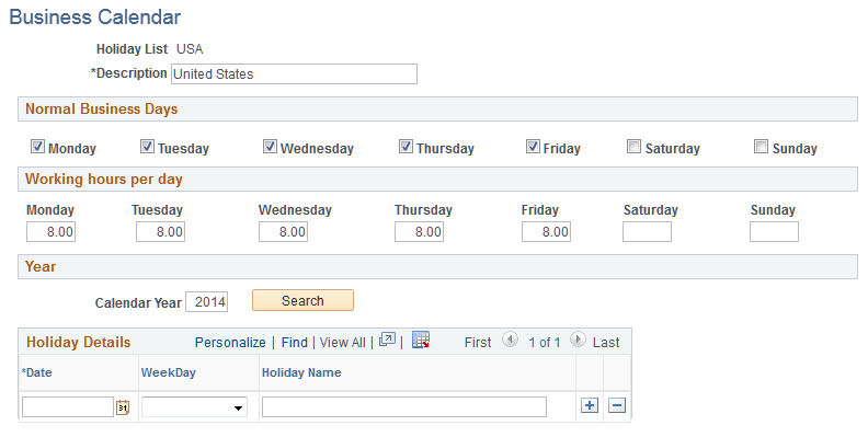

Navigation:
  • Set Up Financials /Supply Chain, and then Common Definitions, and then Calendars /Schedules, and then Business Calendar
  • Set Up Financials /Supply Chain, and then Business Unit Related, and then Maintenance Management, and then Work Order Definition
Example 12-1 Scenario I
If the PM schedule has an interval of 15 days, you can run the preventive maintenance and projection processes to calculate the due date.
This example illustrates the fields and controls on the Business Calendar page. You can set up non-business days here.
For more information about business calendars, see Application Fundamentals: Defining Business Calendars

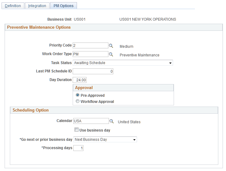

Example 12-2 Scenario II
If the PM schedule has an interval of 15 days plus 4 non-business days, when the Use Business Day option is selected, you can run the preventive maintenance and projection processes for the daily schedule to calculate the due date.
This example illustrates the fields and controls on the PM Options page. You can schedule the next business day here in the event of a non-business day in the system.
PM Options page
For more information about Preventive Maintenance, see PM Options Page

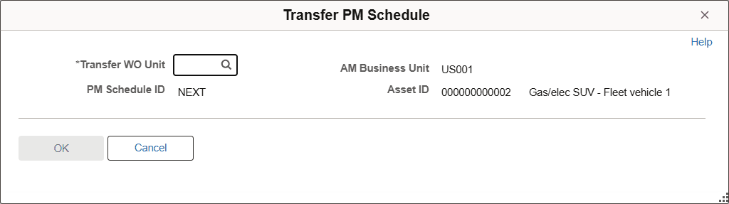

Use the Transfer PM Schedule page to reassign an existing asset or loop-type PM schedule to a different Maintenance Management business unit by deactivating the original PM Schedule.
This example illustrates the fields and controls on the Transfer PM Schedule page. You can find definitions for the fields and controls later on this page.
Select the MM business unit to which the schedule is transferred using Transfer WO Unit field. The Transfer PM Schedule page is expanded and the ‘OK’ pushbutton is enabled upon selecting a valid Transfer WO Unit.
The MM business unit entered must be different from the source business unit. A self-transfer within the same BU is not allowed by the field.

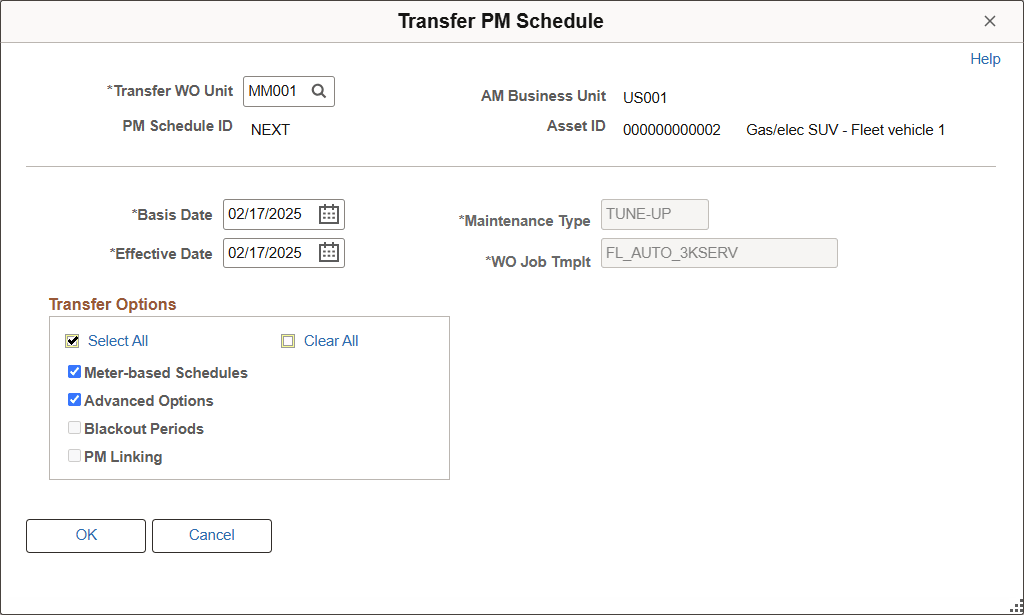

This example illustrates the fields and controls on the expanded Transfer PM Schedule page. You can find definitions for the fields and controls later on this page.
Basis Date
Enter a basis date for the new schedule instance which is used to calculate the Due Date. The Current date is displayed by default.
Effective Date
Enter the date from which the new schedule is effective. The Current date is displayed by default.
Maintenance Type
Displays the code to identify the type of maintenance from the source schedule if the value is valid for the new Transfer WO Unit.
Select the appropriate maintenance type from the prompt list if the field is blank.
Note: The field is blank and active if the source schedule maintenance type is not valid for the new MM schedule.
WO Job Tmplt(work order job template)
Displays the job template from the source schedule if the value is valid.
Select a work order job template if the field is blank, to define the job steps, requirements, and associated data to apply to the work order that is generated under the new schedule.
Transfer Options
Select the child data from the source schedule to be transferred (copied) to the new MM schedule. Choices are:
  • Meter-based Schedules
  • Advanced Options
  • Blackout Periods
  • PM Linking
Select OK to generate a new maintenance management schedule. The new schedule appears in same the window and allows you to modify before saving.
The original PM schedule status is changed to inactive when the new MM schedule is created. The original PM schedule displays a "Transferred to" hyperlink to access the new MM schedule.
Use the PM Schedule - Advanced Options page (WM_PM_SCHD_PG2) to define work order header specifications, which are optional, that the Preventive Maintenance Process uses when it creates a work order and also define blackout periods to apply to the scheduling rules that are set up on the General Options page.
Navigation:
Select the Advanced Options tab.
This example illustrates the fields and controls on the PM Schedule Advanced Options page. You can find definitions for the fields and controls later on this page.
Update Last Reviewed
Click to update the date and time in the preventive maintenance schedule and indicate that the preventive maintenance schedule has been reviewed. The value that is shown in the field can then be used to determine when the schedule was last reviewed and who reviewed it. The date, time, and user ID appear in the Last Reviewed field.
Service Group, Work Type, Shop, and Priority Code
Specify the default values for the preventive maintenance work order header. The work order Business Unit field acts as the set control field for the Service Group, Work Type, Priority Code, and Task Status fields.
Note: The Preventive Maintenance Process uses the work order business unit, job template, and preventive maintenance schedule as the hierarchy for retrieving default values for the preventive maintenance work order.
Task Status
Select a task status to apply to the work order. This status must be the same at every level of the work order. Specifying a status at this level overrides the status that is set up in the work order business unit.
Crew and Empl ID
The Crew and Employee ID fields for a PM schedule can override the Shop Scheduler and Crew Leader criteria that you defined on the Auto Assignment & Dispatch page. If you enter the Employee ID, the Crew field become blank and disabled. Similarly, if you enter the Crew ID, the Employee ID field become blank and disabled.
When you run a PM process, it will consider the PM Schedule employee ID instead of the employee ID that you specified on the Auto Assignment & Dispatch page. The concept is applicable for the Crew field as well.
Approval
Select whether this work order is Pre-Approved or requires Workflow Approval. When you select a value in this field, it overrides whatever value is set up in the work order business unit, the shop, or the work type.
Description
Enter the description of this preventive maintenance that you want to appear in the work order. This is a required field in the work order.
PC Business Unit (Project Costing business unit)
Displays a default value based on the specification in the work order business unit.
Project ID and Activity ID
Enter values for both of these fields if the preventive maintenance work orders that are generated by the Preventive Maintenance Process based on this schedule are associated with a Project Costing-managed project.
If the preventive maintenance work orders that are generated by the Preventive Maintenance Process based on this schedule are associated with a work order-managed project, perform one of the following activities:
  • Leave both fields blank. The system finds and uses default project information based on the values in the work order Business Unit, Work Type, and Service Group fields. When you save the PM Schedule, the system verifies that a default project exists. The Preventive Maintenance Process generates the activity for the work order.
  • Specify the project and leave the Activity field blank. The system verifies that this is a work order-managed project, and the Preventive Maintenance Process generates the activity when it creates the work order.
Work Order Duration Multiplier
The system displays this field only in the Loop Schedule - Advanced Options page. The default value is 1. The Preventive Maintenance Process calculates the duration for a preventive maintenance work order based on the value residing in the Duration field that is defined for an asset in the associated work order job template.
Repeat Years
Specify the number of years for which you want to create blackout periods and specify the start date and end date for the blackout period that you want to repeat.
Populate
Click to add the successive blackout period rows to the Blackout Period grid based on the number of repeat years and start and end dates that you entered.
Blackout Periods
Blackout periods are often used for seasonal assets, such as snow-plowing equipment. The Preventive Maintenance Process does not generate preventive maintenance work orders during the blackout periods that are specified in this schedule.
These periods are taken into consideration for date-based schedules (except for specified dates) and all types of meter-based schedules.
Start Date
Specify the start date for each blackout period that you add.
End Date
Specify the end date for each blackout period that you add.
Blackout Method
Select a blackout method. The available options are:
  • Due Date Blackout: If the calculated due date falls within the blackout period, then the PM process will not generate the work order.
  • Interval Blackout: The number of days within the blackout period is added to the interval to calculate the due date.
    Note: Overlap of interval blackout periods are not allowed.
On hold
Select this check box for blackouts with uncertain end dates.
When this check box is selected and the calculated due date is greater than or equal to the blackout start date, the PM process will not generate the work order. You can deselect this check box and generate the work order once you know the end date for the blackout.
PM Linking Page
Use the PM Linking page (WM_PM_SCHD_LINK) to link secondary schedules to a primary schedule.
Navigation:
Maintenance Management, Preventive Maintenance, PM Schedule Management Setup, click the PM Linking tab.
This example illustrates the fields and controls on the PM Linking page. You can find definitions for the fields and controls later on this page.
PM Linking page
Asset Details

PM Linking
Effective Date
Enter the date from which the setup of these secondary schedules with this primary schedule is effective. You can change this effective date when you change the secondary schedule setup by clicking the plus icon. This enables you to track changes to this page.
Note: In case a major maintenance is due but minor is not due yet (This can happen when you enter a WO meter reading for the minor WO greater than the meter interval), the system generates the major WO and not link them. The next time the PM process is run with the minor due, and the occurrences per cycle is reached, then the system links maintenances with WO creation. If the previous major WO is still in process the system creates a PM Exception so you can take proper action.
Status
Select active or inactive to identify the status of this PM Linking secondary schedule setup.
Sequence
Enter a sequence number for the primary schedule if you selected Merge as the linking action. The numbers entered in this field will define the order of the primary and secondary job template for the Preventive Maintenance process to use when it creates work orders and merges primary tasks and secondary tasks.
If you selected either Separate or Suppress as the linking action, you can leave the sequence value blank.
For example: The selected linking action is Merge and the:
  • Primary schedule MAJOR has a sequence number of 10.
  • Secondary schedule MINORA is linked to MAJOR and has a sequence number of 30.
  • Secondary schedule MINORB is linked to MAJOR and has a sequence number of 20.
When the Preventive Maintenance process creates the tasks in the work order, the MAJOR tasks are first, followed by MINORB tasks, and then MINORA tasks.
  1. MAJOR tasks.
  2. MINORB tasks.
  3. MINORA tasks.
Note: The work order header fields are always populated with the primary schedule information regardless of the sequence number value entered for the primary schedule. Any duplicate tasks between schedules are deleted. If MAJOR has one of its tasks in common with MINORA, the Preventive Maintenance process will keep only one of the tasks.
Parent/Child
Select this check box to create PM work orders with a parent/child relationship for multiple levels.
The parent PM schedule due date will determine when the work orders are created for the child PM. You can also create child PM schedules with its own scheduling options and intervals independent of the parent PM schedule.
Secondary Schedules
You select the secondary schedules that you want to add to this primary schedule using the General and Cycle tabs.
Select the General tab.
Edit
Click this link to access the selected secondary schedule. If you have not selected a secondary schedule, you can click this link to access the PM Schedule Search Results page and select a secondary schedule from the list of schedules in the Search Results.
Sequence
Enter a sequence number for each secondary schedule if you selected Merge as the linking action. The numbers entered in this field will define the order of the primary and secondary job template for the Preventive Maintenance process to use when it creates work orders and merges primary tasks and secondary tasks.
Note: If you selected either Separate or Suppress as the linking action, you can leave these values blank.
See Example in PM Linking subtopic.
Schedule ID
Enter a Schedule ID or click the search icon and select a secondary schedule to associate with this primary schedule.
Description
Displays the description of the selected secondary schedule.
Linking Method
Select one of these linking methods:
  • Days Tolerance
    Select this value and the Days Tolerance field appears. Selecting this method enables the Preventive Maintenance process to use the number of days entered in the Days Tolerance field to calculate when the system can link the primary and selected secondary preventive maintenance schedules based on the specified difference in the dates.
  • Linking by Cycle
    Select this value and the Cycle tab appears. Selecting this option enables the system to link a secondary schedule with a primary schedule based on a cyclical period determined by the selection of an interval type.
    See Linking by Cycle
Linking Action
Select one of these values:
  • Merge
    The Preventive Maintenance process merges the secondary schedule tasks to the primary schedule tasks for the same work order.
  • Separate
    The Preventive Maintenance process creates separate work orders for primary and secondary schedules with the same due date. In this case, the system will not reserve duplicate parts identified on the primary schedule and the secondary schedule. Only one part is reserved to use for one or more tasks on each work order.
  • SuppressThe Preventive Maintenance process lists only the primary schedule tasks in the work order.
    No work order will be created for the secondary schedule tasks. However, a PM record transaction will be created for the secondary schedule, which points to the work order created for the primary schedule.
Days Tolerance
Enter the number days between the calculated due date of the primary schedule and the calculated due date of the selected secondary schedule.
For example:
  • Days Tolerance = 5
  • The maintenance for the primary PM schedule is currently due, and the maintenance for the selected secondary PM schedule is due in 5 days.
  • When the Preventive Maintenance process runs, it will link the primary PM schedule to this secondary PM schedule and generate one work order or individual work orders at the same time based on the maintenance date for the primary PM schedule and the linking action selected.
Linking by Cycle
When you select the Linking by Cycle as the Linking Method on the General tab, only the Linking Action field appears on the tab and a Cycle tab appears next to the General tab.
You select the linking action that defines whether the Preventive Maintenance process creates one or multiple work orders as described previously. This field works the same for both the Days Tolerance and Linking by Cycle methods.
Once you select the Linking by Cycle method and the linking action, select the Cycle tab.
Use the Copy PM Schedule page (WM_PM_SCHD_CPY) to copy data from an existing PM Schedule to a new PM Schedule.
Navigation:
Maintenance Management, and then Preventive Maintenance, and then PM Schedule Management Setup, and then Copy PM Schedule
This example illustrates the fields and controls on the Copy PM Schedule page. You can find definitions for the fields and controls later on this page.
Search
Click to display a list of assets in the Search Results grid based on the criteria that you set up in the Copy To group box.
Copy
Select the target assets from the Search Results group box to which you want to copy the selected copy from asset's schedule. Once the schedule is copied to the selected assets, then you can review and modify the new schedules of the assets by selecting Preventive Maintenance Schedule Setup, and then Schedule.
Copy From
Select the Asset Management business unit that is associated with the asset PM Schedule from which you want to copy. When you select the asset ID that is associated with the schedule from which you want to copy, the AM business unit and the asset type values appear in the fields in the Copy To group box of the page. Additional field values may also appear depending on the asset ID that you select in the Copy From group box on the page. The system automatically copies any linking and lead days information for all applicable schedules.
The only assets that appear in the list are assets that are associated with a PM Schedule.
Copy To
AM Business Unit (Asset Management business unit)
Select a business unit to narrow the search for the target assets to which you want to copy the preventive maintenance schedule. When you select an asset ID in the Copy From group box, the AM Business Unit and Asset Type values appear in this Copy To group box.
Note: You can override or delete the values from all of the asset characteristic fields except for Asset Type.
From (asset identifier) and To (asset identifier)
Enter a range of asset IDs, serial IDs, tag numbers, or vehicle identification numbers (VIN). The field names that appear are based on the value that you select for the Asset Field. If you select Don't Show for the Asset Field value, then these fields do not appear at all. Once you set up the Copy To and Copy From criteria, when you click the Search button, schedules that match the criteria appear on the page and the Copy button is enabled. If no schedules appear, then there are not schedules available to match the criteria you selected. You should modify your criteria or select another asset. Once schedules appear on the page, you can select the schedules you want to copy and click the Copy button. A message appears indicating that PM schedules for the number of schedules that you selected were created. When search for PM schedules on the PM Schedule search page, these new schedules should be listed.
Note: Since a maintenance type is associated with an asset subtype during setup and should not be changed, the Asset Subtype field on this page is inaccessible to avoid selecting an incorrect value for the maintenance type.

PM Schedule Mass Update - Update Page
Use the PM Schedule Mass Update – Update page (WM_PM_SCH_UPD_RUN1) to select the information on the schedules that you want to update and run the PM Mass Schedule Update (WM_PMSCH_UPD) process, which updates each of the selected schedules.
Navigation:
Maintenance Management, and then Preventive Maintenance, and then PM Schedule Management Setup, and then PM Schedule Mass Update, and then Update
This example illustrates the fields and controls on the PM Schedule Mass Update - Update page. You can find definitions for the fields and controls later on this page.
Important:
You cannot access the Update tab until you search for PM schedules to update and save the Search page.
The values that you selected on the Search page appear on the Update page. You can override or select different values before you click the Run button.
Last Run On
Displays the date that the PM Schedule Mass Update process was last run.
Run
Select to run the PM Schedule Mass Update (WM_PMSCH_UPD) process. When you run this process, the system uses the current date as the effective date. The system automatically creates a new effective revision if it does not already exist. If a revision exists, the system updates the revision. When a new revision is created, the system copies the current version, and then applies the requested update.
Recalculate Basis Date
Select to recalculate the Basis Date of all selected PM schedules while running a mass PM schedule update.
To define the default choice for this field, use the Recalculate PM Basis Date on Mass Change option under PM Options tab on the Work Order Definition page. For more information, see PM Options Page.
Use the Preventive Maintenance Schedule Workbench page (WM_PM_SCHD_WKBC) to maintain an asset's preventive maintenance schedules.
Navigation:
Maintenance Management, and then Workbenches, and then PM Schedule Workbench
This example illustrates the fields and controls on the Preventive Maintenance Schedule Workbench Page. You can find definitions for the fields and controls later on this page.
Preventive Maintenance Schedule Workbench page (1 of 3)
This example illustrates the fields and controls on the Preventive Maintenance Schedule Workbench Page (2 of 3). You can find definitions for the fields and controls later on this page.
Preventive Maintenance Schedule Workbench page (2 of 3)
This example illustrates the fields and controls on the Preventive Maintenance Schedule Workbench Page (3 of 3). You can find definitions for the fields and controls later on this page.
Preventive Maintenance Schedule Workbench page (3 of 3)
Approval Status
Select the desired approval status from the following options:
  • Approved
  • Cancelled
  • Denied
  • Initial
  • Pending
Description
Enter the description for the search.
Schedule
Select the desired PM schedule for the search.
Loop ID
Select the desired maintenance loop ID for the search
Status
Select from the various statuses available
Schedule Type
Select the type of schedule from the options:
  • Daily
  • Monthly by date
  • Monthly by day
  • None
  • On demand
  • Specific date
  • Weekly by day
Work Location
Select one or more work locations from the list, to view the associated PM schedules.
Asset Information
AM Business Unit
Select the desired Asset Management business unit for the PM schedules.
Tag Number
Select the desired tag number for the AM business unit.
Serial ID
Select the serial ID for the AM business unit.
Asset Location
Select from the various asset locations based on the location ID.
Area ID
Select the required area ID from the list.
Asset ID
Select the required asset identification from the list.
Asset Type
Select the type of asset from the available options:
  • Asset Retirement Obligations
  • Equipment
  • Facility
  • Fleet
  • Furniture
  • IT Hardware
  • IT Software
  • Intangible
  • Machinery
  • Other
  • Property
Subtype
Select the asset sub type based on the types of asset selected.
Mfg ID
Select the manufacturing ID for the AM business unit.
Model
Select the model of AM business unit.
Asset Description
Enter any relevant description for the asset.
Asset Criticality
Select the criticality of the asset from the following options:
  • High
  • Medium
  • Low
Shop and Type
Select one or more shops, and type of shop from the list, to view the associated PM schedules.
PM Schedule Info
Click the Edit link to access and update the associated PM Schedule. This tab contains a check box, which indicates whether the schedule has linking setup information.
PM Loop Info
Click the View link to access the PM Loop Find an Existing Value page and select a maintenance loop to review.
CBM Alert
If this asset is associated with a meter that has a range tolerance, and the meter reading for the asset exceeds the tolerance limit, then a condition-based maintenance alert is sent from PeopleSoft Asset Management to PeopleSoft Maintenance Management. PeopleSoft Asset Management automatically selects the override option in the schedule to enable the Preventive Maintenance Process to generate a condition-based maintenance work order.
Meter and Meter Readings History
This grid appears if one or more meters are associated with an asset. Click the View link to view the Meter Reading History information in PeopleSoft Asset Management.
Blackout Periods
If you set up blackout periods for a schedule, they appear as part of the PM Schedule Workbench if you select the check boxes for the schedules in the list that have the Blackout check box selected.
