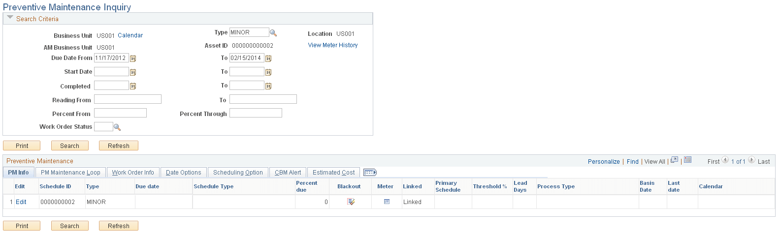

Understanding Preventive Maintenance Inquiry
After the Preventive Maintenance Process is complete, you can access the Preventive Maintenance Inquiry page to view the results of processing a specific asset ID based on its associated work order business unit, asset business unit and maintenance type. The transactions that are listed in this inquiry are the Preventive Maintenance (PM) audit records. This inquiry uses basically the same format as the Preventive Maintenance Workbench and contains the same tabs.
  • PM Info (information)
    This tab lists all of the PM schedules that were processed, the schedule ID, due date, schedule type, percentage due, if a blackout period existed, if a meter was used, whether the schedule was linked, the threshold percentage, the process type, basis date, and the last date that the schedule was processed. You click an edit link to access and edit the PM schedule as well as review the blackout periods and the Meter Readings Trend chart.
    When the maintenance percentage is 50 percent, for example, then the preventive maintenance work is half way from being due and the Percent Due displays as 50 percent. When the Percent Due value is 100 percent, then the process creates a work order unless the maintenance due date falls in a blackout period.
  • PM Loop
    This tab lists the loop schedule information, if a loop schedule was processed. You can access and edit each loop schedule.
  • Work Order Info (information)
    This tab identifies the last work order that was created for this asset, the work order business unit, and the work order's status. You can click a link to view the work order.
  • Date Options
    This tab identifies the schedule type for each asset, the interval processed, the date of the month, day of the month, week of the month the asset was processed, and whether the due dates were based upon the last PM completion.
  • Scheduling Option
    This tab identifies which scheduling option was selected on the asset's schedule.
  • CBM (Condition Based Maintenance) Alert
    This tab identifies whether the CBM Alert was turned off or on. If it was turned on, it identifies the source of the alert.
  • Estimated Cost
    This tab describes the estimated resource costs of the work order based on the requirements defined in the job template associated with the asset's schedule.
You can also click a link to access the business calendar that is associated with PeopleSoft Maintenance Management, and the Meter Readings History for a meter that is associated with the asset being maintained.

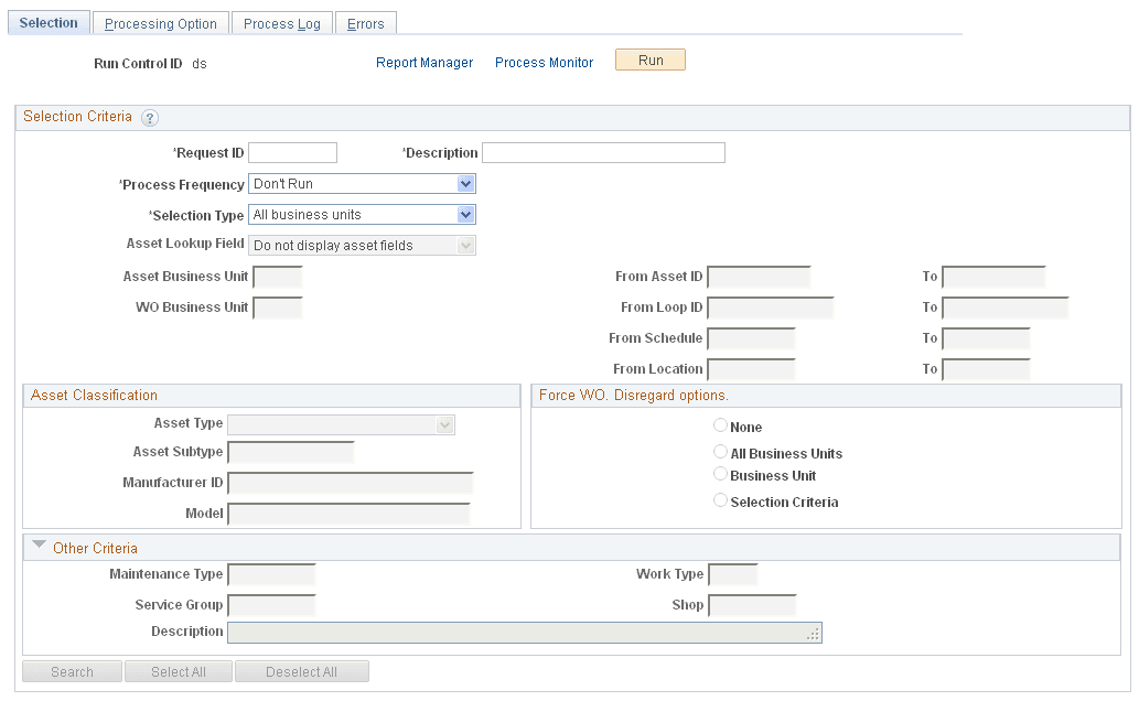

Run Preventive Maintenance - Selection Page
Use the Run Preventive Maintenance - Selection page (WM_PM_RUN_SEL) to run the Preventive Maintenance Process.
Navigation:
Maintenance Management, and then Preventive Maintenance, and then Run Preventive Maintenance
This example illustrates the fields and controls on the Run Preventive Maintenance - Selection page. You can find definitions for the fields and controls later on this page.
Field or Control Description
Selection Type
Select the type of data to use to run the Preventive Maintenance Process. Selecting this option displays a list of selection data types, which includes:
  • AM business unit list
  • All business units
  • Asset classification
  • Location list
  • Maintenance type list
  • PM Schedule selection
  • Shop List
  • WO business unit list
AM Business Unit List
Selecting AM business unit list in the Selection Type field makes all subsequent fields inaccessible to the user except for the Selection grid, where you can create a list of Asset Management business units to serve as criteria for which to run the Preventive Maintenance Process.
All Business Units
Selecting All business units in the Selection Type field makes all subsequent fields inaccessible to the user and does not display the Selection grid because the Preventive Maintenance Process is run for both PeopleSoft Asset Management and work order business units.
Asset Classification
Selecting Asset classification in the Selection Type field makes all subsequent fields inaccessible except for the Search grid, where you create a list of asset characteristics, which include asset type, subtype, manufacturer, and model # to serve as criteria for running the Preventive Maintenance Process.
Location List
Selecting Location list in the Selection Type field makes all subsequent fields inaccessible except for the Search grid, where you create a list of work order business units and their associated locations to serve as criteria for running the Preventive Maintenance Process. This list consists of the locations that you can specify in the Location Schedule component.
Maintenance Type List
Selecting Maintenance type list in the Selection Type field makes all subsequent fields inaccessible except for the Search grid, where you create a list of maintenance types to serve as criteria for running the Preventive Maintenance Process.
PM Schedule Selection
Select PM Schedule selection in the Selection Type field.
Selecting this option and then selecting one of the values in the Asset Lookup field enables you to enter active fields as search criteria to search for PM Schedules.
Asset Lookup Field
Select:
  • Asset ID.
  • Don't Show (do not show).
  • Serial ID
  • Tag # (tag number).
  • VIN (vehicle identification number).
Asset ID
Select Asset ID for the Asset Lookup Field value.
Important:
If you select one of the other lookup fields that are listed previously, such as Serial ID, the following field descriptions apply except the field names and values will pertain to the Asset Lookup Field value that you selected.
Don't Show
Select Don't Show in the Asset Lookup Field. This selection makes the Asset Business Unit, Asset, and To fields inaccessible to the user. However, you can complete the Maintenance Business Unit, Loop, and To fields as search criteria and click the Search button to list the preventive maintenance schedules based on the selected criteria. You can then select the preventive maintenance schedules that you want the Preventive Maintenance Process to use.
You can also select the Show Override Options Only check box, which makes all of the other fields inaccessible.
Serial ID
Select Serial ID in the Asset Lookup Field. All of the subsequent fields and buttons appear and work the same way as your selection of the asset ID, except that you can enter one serial ID or a number or a range of serial IDs instead of one or more asset IDs.
Tag # (tag number)
Select Tag # in the Asset Lookup Field. All of the subsequent fields and buttons appear and work the same way as your selection of the asset ID, except that you can enter one tag number or a range of tag numbers instead of one or more asset IDs.
Select VIN in the Asset Lookup Field. All of the subsequent fields and buttons appear and work the same way as your selection of the asset ID, except that you can enter one VIN or a range of VINs instead of one or more asset IDs.
Asset Business Unit
Select an Asset Management business unit to associate with one or more selected asset IDs.
WO Business Unit (work order business unit)
Select the work order business unit to associate with one or more selected preventive maintenance loops.
From Assets and to
Select a single asset ID or select a second asset ID to create a range of assets to use as search criteria to narrow your search for PM Schedules.
From Loop ID and to
Select a single loop ID or select a second loop ID to create a range of loops to use as search criteria to narrow your search for PM Loop Schedules to process.
From Schedule and to
Select a single schedule ID or select a second schedule ID to create a range of schedule IDs to use as search criteria to narrow your search for PM Schedules to process. If you select a primary schedule with linked secondary schedules, the Preventive Maintenance process will automatically process any secondary schedules associated with this primary schedule and check the linkage of the maintenances.
From Location and to
Select a single location or select a second location to create a range of location schedules to use as search criteria to narrow your search for Location Schedules to process.
Force WO. Disregard Options
Select to identify the preventive maintenance schedules that have the Override Options - Generate One Timecheck box selected in a schedule's General Options page. The available options are:
  • None: Select this checkbox and click the Search button to display a list of preventive maintenance schedules without accounting for the override option.
  • All business units: Select this check box and click the Search button to display schedules that have the override option enabled for all business units.
  • Business Unit: You can select a business unit. The result for the search shows override options only for the selected Business unit.
  • Selection Criteria: You can add a selection criteria. The result shows only the override options that met the predefined selection criteria.
If you select this field, the Asset Lookup, Asset Business Unit, Asset, To, Maintenance Business Unit, Loop, and To fields become inaccessible.
Asset Type
Select the desired type of asset.
Asset Subtype
Enter the desired sub type of asset.
Manufacturer ID
Enter the ID of the desired Manufacturer.
Model
Enter the desired model
Other Criteria
Maintenance Type
Enter the desired type of maintenance.
Work Type
Enter the desired type of work.
Service Group
Enter the service group.
Shop
Enter the desired shop.
Search
Click to search for preventive maintenance schedules that match the search criteria. A list of preventive maintenance schedules appears in a grid based on the criteria that you selected. You can then select the schedules that you want to include in the Preventive Maintenance Process.
Preventive Maintenance Inquiry Page
Use the Preventive Maintenance Inquiry page (WM_PM) to display the status of preventive maintenance work orders.
Navigation:
Maintenance Management, and then Preventive Maintenance, and then View Preventive Maintenance
This example illustrates the fields and controls on the Preventive Maintenance Inquiry page. You can find definitions for the fields and controls later on this page.
Search Criteria
You can search for all work orders that were created by the Preventive Maintenance Process by leaving the Business Unit, AM Business Unit, Asset Identification, Maintenance Type, Location Code, and Loop ID fields blank and clicking the Search button on the Preventive Maintenance search page.
Calendar
Click to review the business calendar.
View Meter History
Click to view the Meter Reading History for the meter that is associated with this asset.
Due Date From and To
Enter a range of preventive maintenance due dates to display the associated preventive maintenance work orders that were generated by the Preventive Maintenance Process.
Note: In case a major maintenance is due but minor is not due yet (This can happen when you enter a WO meter reading for the minor WO greater than the meter interval), the system generates the major WO and not link them. The next time the PM process is run with the minor due, and the occurrences per cycle is reached, then the system links maintenances with WO creation. If the previous major WO is still in process the system creates a PM Exception so you can take proper action.
Reading From and To
Enter a range of meter reading values to display a list of work orders that were generated for the selected asset based on meter readings.
Percent From and Percent Through
Enter a range of percentage due values to display a list of work orders with percentage due values that fall within this range for the selected asset.
Work Order Status
Select the work order status from the following options:
  • Awaiting Schedule
  • Closed
  • Complete
  • Cancelled
  • On Hold
  • Open NOW
  • Scheduled
  • Work in Progress
PM Info
After specifying the search criteria, click Search to display work orders in the grid. Select the PM Info tab.
Edit
Click to access and edit the schedule that is associated with the row.
Due Date
The PM Inquiry screen displays the due date of the PM process. The due date is calculated by the PM process (WM_PM) based on the following criteria:
  • The due date is blank if the calculation of the next due date is dependent on WO completion date.
  • The due date is blank if the calculation of the next due date is dependent on the meter readings recorded on the last completed WO.
  • If the WO is due today, the next due date that displays is the current date.
  • If a PM schedule is brand new, the scheduled due date will be calculated using the PM schedule's basis date.
Schedule Type
Identifies the calculation method that was used to trigger the creation of the work order.
The listed schedule type can be:
  • Day interval.
  • Week interval.
  • Month interval.
  • Specific date.
  • Meter reading.
  • CBM alert.
  • Sampling days.
  • Sampling reading.
  • Cycles.
  • Average from asset.
Percent Due
Displays the maintenance percentage due amount based on the calculation of the maintenance due date. This calculation is performed by the Preventive Maintenance Process to generate a work order. The formula for calculating this percentage is Percent Due = 100 × Current Reading − Previous Work Order Reading ÷ Meter Interval
This field may have a value:
  • Of zero if you created a work order from a projection.
  • Greater than 100 percent if the Preventive Maintenance is overdue.
See Understanding Preventive Maintenance Schedules.
Blackout
Click to display the blackout periods that are associated with the selected schedule.
Meter Trend Chart
Click to access the Preventive Maintenance Meter page. You can click an icon on this page to access and view the Meter Readings Trend Chart, which charts the meter reading date and time against the meter reading over a period of time. You can also view project meter readings based on a specific projection method and view the meter sample, if used.
Linked
Identifies whether the PM schedule is linked. You can click the Linked link and review any linked secondary schedules on the Preventive Maintenance Linking page.
Primary Schedule
Displays the primary schedule ID to which this secondary schedule is linked. This field only appears for secondary schedules that are linked to primary schedules.
PM Loop
Select the PM Loop tab to display the SetID that is associated with a maintenance loop ID if this is a preventive maintenance Loop Schedule.
Work Order Info
Select the Work Order Info tab to display the work order business unit, the work order number, and the current work order status. You can also click a View link to view the actual work order. You cannot modify the work order using this link.
Date Options
Select the Date Options tab to view the date option (if applicable) that was selected for each of the listed schedules.
Scheduling Options
Select the Scheduling Options tab to view the scheduling option (if applicable) that was selected for each of the listed schedules.
CBM Alert
Select the CBM Alert (condition-based maintenance alert) tab to view the CBM alert, the source of the CBM alert, the alert ID, and the CBM alert date and time. This appears only for preventive maintenance schedules that are associated with condition-based maintenance work orders and indicates whether the CBM was used (On) or not used (Off.)
Estimated Costs
This tab lists the estimated labor, tools, inventory, and procurement costs. These estimated costs are calculated first in the Preventive Maintenance Process. They can be recalculated later based on changes made to the work order.
