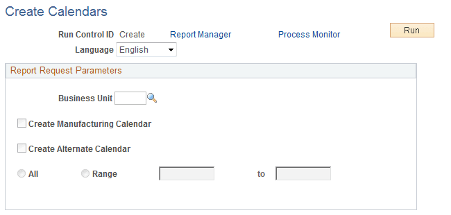

Create Calendars Page
Use the Create Calendars page (RUN_MGS3000) to update the system with new calendar codes or calendar information.
Navigation:
Set Up Financials/Supply Chain, and then Business Unit Related, and then Manufacturing, and then Define Production Calendars, and then Create Calendars
This example illustrates the fields and controls on the Create Calendars page. You can find definitions for the fields and controls later on this page.
Report Request Parameters
Field or Control Description
Create Manufacturing Calendar
Select to create a new version of the default production calendar.
Create Alternate Calendar
Select to create a new version of one or more alternate calendars.
If you are creating the manufacturing calendar, the Create Alternate Calendar check box is automatically selected.
All and Range
Specify the alternate calendars that you want to create.
Run
Click to run this request. PeopleSoft Process Scheduler runs the Create Calendars process at user-defined intervals.
