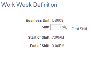

Work Week Definition Page
Use the Work Week Definition page (MG_WORK_WK_DEFN) to define a five-day, one-shift work week.

This example illustrates the fields and controls on the Work Week Definition page. You can find definitions for the fields and controls later on this page.
If you don't define at least one calendar code with its associated calendar, or if the production calendar associated with the business unit becomes obsolete, the planning and scheduling functions assume that you are working a five-day work week. The system defines a five-day work week as Monday through Friday, with one shift. Define the specific hours of operation for the shift; the shift must start and end on the same day.
Field or Control Description
Shift Code
Select only a single shift code. However, if you work more than one shift, the shift code should include all hours of operation for all shifts, as long as the start and end times don't span multiple days. Alternatively, if more than one shift is applicable, or you have a shift that spans multiple days, you may want to define a production calendar.
When using a five-day work week for scheduling, define the hours of operation for the five days. Do this by selecting a shift code to associate with the work week.
Start of Shift and End of Shift
These fields appear by default from the Shift Codes page.

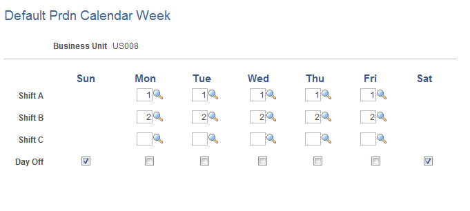

Default Prdn Calendar Week Page
Use the Default Prdn Calendar Week page (MG_CAL_DEF_WEEK) to use to facilitate data entry if you are defining a calendar for a calendar code.

This example illustrates the fields and controls on the Default Prdn Calendar Week page. You can find definitions for the fields and controls later on this page.
When defining a calendar, use this default week to fill each week of a month. This default week should represent a typical production week, including or excluding weekends. Because the system automatically creates the production month using this default week, this page is the preparatory step to defining production months within calendar codes. You can then make changes for individual days within the month on each month's calendar.
For each day in the week, you can assign up to three shifts (Shifts A, B, and C) from among the shifts defined using the Shift Code Definition page. You cannot enter duplicate shifts for the same day, and the shifts that you select for any given day cannot overlap. The shift times must be chronological beginning with the earliest shift listed first and the latest shift listed last. The system does allow shift schedule gaps as long as the shift times remain chronological. The shift times must also be chronological across all days of the week.
If you select the Day Off check box, you are defining the day as a day off; therefore, you cannot define any shift for that day on this page.
However, you can still change each shift or days off for any day of the week when actually defining a monthly calendar.

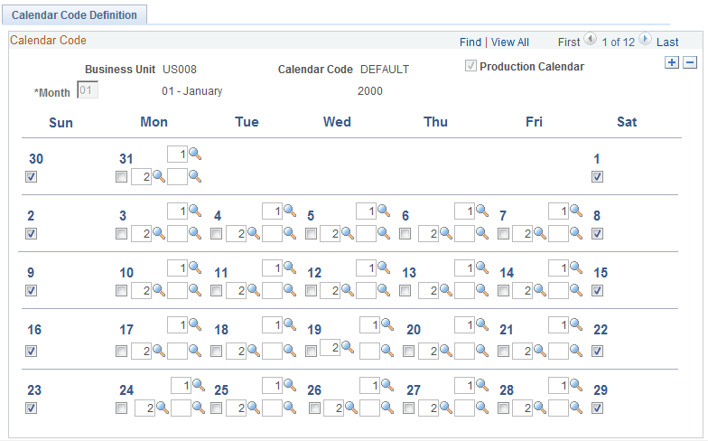

Calendar Code Definition Page
Use the Calendar Code Definition page (MG_CALENDAR) to define production calendar codes.

This example illustrates the fields and controls on the Calendar Code Definition page. You can find definitions for the fields and controls later on this page.
Production Calendar
If the calendar code is the default calendar code for the business unit, as defined on the Manufacturing Options page, this check box is selected.
Mo: (month)
Create a calendar code with one month, a partial set of months, or 12 months of the year. If you want to create a new monthly calendar, insert a new row, select the month that you want to maintain, and press TAB to move to the next field. The system automatically fills the month with the values previously entered for the default production week. You can then change individual days for the month without affecting the default weekly production calendar.
If you have already created the month and you want to change the calendar for an existing month, the Mo. field is unavailable for selection. Use the scroll bar to view the calendar for all existing months for the year.
For each day in the week, you can assign up to three shifts from among the shifts defined on the Shift Code Definition page. You cannot enter duplicate shifts for the same day, and the shifts that you select for any given day cannot overlap. The shift times must also be chronological, beginning with the earliest shift listed first and the latest shift listed last. The system does allow shift schedule gaps as long as the shift times remain chronological across all days of the production calendar. Additionally, a shift can begin on one day and end on the next.
Day Off Check Box
Select the Day Off check box in the day's lower left corner, if you want the day to be a non-manufacturing day.
