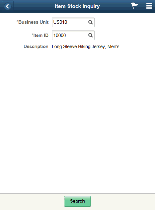

Item Stock Inquiry - Fluid Search Page
Use the Item Stock Inquiry - Fluid Search page to define Item Stock Inquiry search criteria.
Navigation:
Mobile Inventory, and then Item Stock Inquiry, and then and enter search criteria
This example illustrates the fields and controls on the Item Stock Inquiry - Search Page. You can find definitions for the fields and controls later on this page.
Field or Control Description
Business Unit
Select a PeopleSoft Inventory business unit where the item stock is located. A default value displays in this field based on your user login ID. This is a required field.
Item ID
Scan or enter the PeopleSoft inventory item ID for the stock you want to review.
Description
Displays the item description below the Item ID.

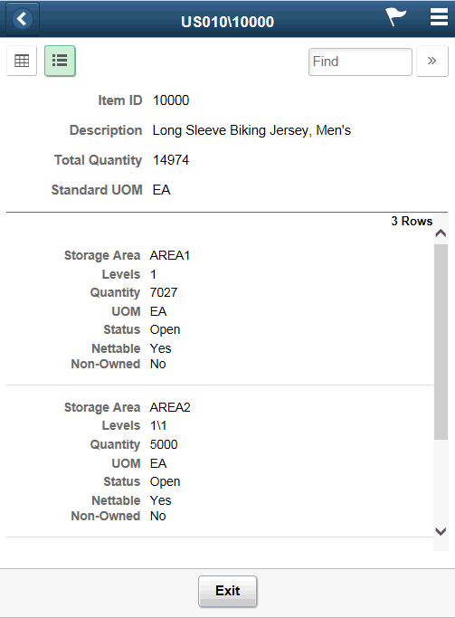

This example illustrates the fields and controls on the Item Stock Inquiry - Fluid List Mode Page. You can find definitions for the fields and controls later on this page.
Item Stock Inquiry - List View page

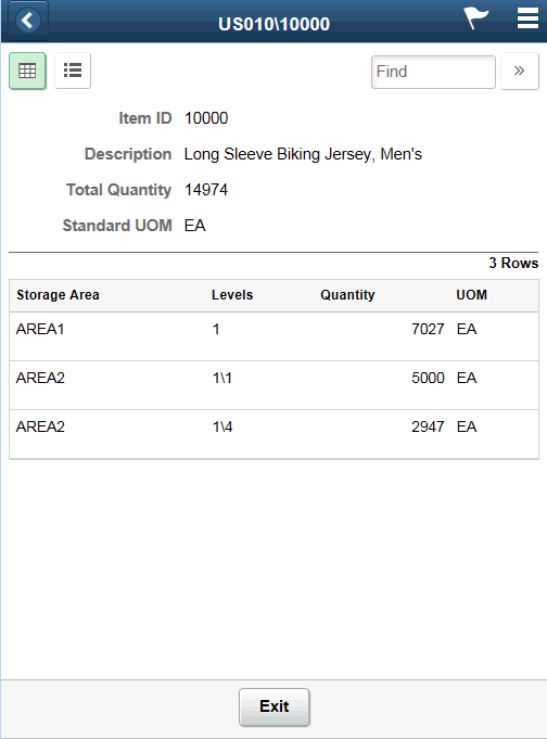

This example illustrates the fields and controls on the Item Stock Inquiry - Grid Mode Page. You can find definitions for the fields and controls later on this page.
Item Stock Inquiry - Grid View page
Grid View icon
Displays the item ID and storage areas in a grid.
List View icon
Displays the item ID and storage areas in a list.
Item ID
Displays the PeopleSoft Inventory item ID and item description. The Item Information table displays item stock information at the PeopleSoft Inventory business unit level.
Description
Displays a description of the item below the Item ID.
Total Quantity
Displays the total item quantity within the PeopleSoft Inventory business unit expressed in the standard unit of measure for the item. The total quantity will vary based on the filtered locations.

Storage Area
Displays the storage area containing the stock.
Levels
Displays the storage levels containing the stock. Item stock is stored in a material storage location that consists of a storage area and storage levels.
A storage area can be divided into a maximum of four storage levels, with each level representing a physical subdivision of the area. For example, you might have a three-level warehouse area consisting of 15 aisles, with 10 cabinets per aisle and 5 shelves per cabinet.
Quantity
Displays the item quantity currently in the material storage location. This quantity is the entire item quantity within the location regardless of the stock state; it includes stock that is in various fulfillment states as well as stock in all the item statuses (Open, Restricted, Hold, or Rejected).
UOM
Displays the unit of measure for the storage location.
Serial ID
Displays the serial identification numbers for the item stock in this location. This field only displays if the item is serial-controlled.
Lot ID
Displays the lot identification numbers for the item stock in this location. This field only displays if the item is lot-controlled.
Availability Date and Expiration Date
Displays the lot availability and expiration date.

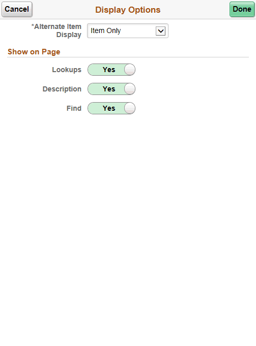

Item Stock Inquiries - Display Options Fluid Page
Use the Item Stock Inquiries- Display Options Fluid page to define page parameters.
Navigation:
Mobile Inventory, and then Item Stock Inquiries, and then Menu , and then Display Options
This example illustrates the fields and controls on the Item Stock Inquiry - Display Options Fluid page. You can find definitions for the fields and controls later on this page.
Use this page to change processing and display options for item stock inquiry. The settings on this page are provided by default from the Installation Options - Mobile Inventory or the User Preferences - Mobile Inventory—Fluid page for the task flow. Most fields can be changed for the session.
