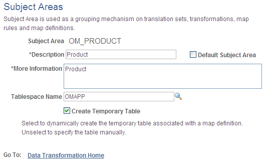

Subject Areas Page
Use the Subject Areas page (EOEW_OBJ_OWNER) to define subject areas, which are grouping mechanisms on translation sets, transformations, map rules, and map definitions.
Navigation:
Enterprise Components, and then Data Transformation, and then Setup Subject Areas, and then Subject Areas
This example illustrates the fields and controls on the Subject Areas page. You can find definitions for the fields and controls later on this page.
Subject Areas page
Field or Control Description
Subject Area
Displays the group translations sets, transformations, map rules, and map definitions.
Description
The description that you use to identify the specific source data object.
Default Subject Area
Select this option if you want this subject area to be a default subject area.
When this option is selected, the subject area will be given as default when you create the source data object. If no default subject area exists, then when you create the source data object you must select a subject area.
Tablespace Name
Select the tablespace name that is associated with this subject area.
Create Temporary Table
Select this option if you want a temporary table to be created during the index process.

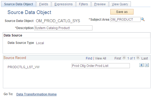

Source Data Object Page
Use the Source Data Object page (EOEW_SRCDO) to define a source data object.
Navigation:
Enterprise Components, and then Data Transformation, and then Define Source Data Objects, and then Source Data Object
This example illustrates the fields and controls on the Source Data Object page. You can find definitions for the fields and controls later on this page.
Source Data Object
Identify a grouping of source records.
Subject Area
Select the group translations sets, transformations, map rules, and map definitions.
Description
Displays the specific source data object.
Source Record
Tables where you store fields within the PeopleSoft system, and where you want to define a relationship. For example, you may want to identify a relationship between the ship-to customer and the sold-to customers.

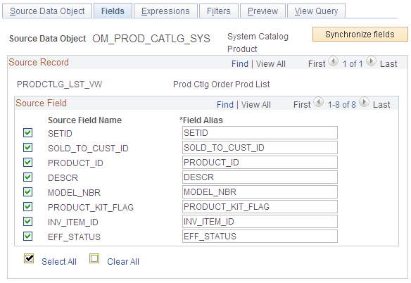

Fields Page
Use the Fields page (EOEW_SRCFIELD) to identify fields that are needed from the source record tables.
Navigation:
Enterprise Components, and then Data Transformation, and then Define Source Data Objects, and then Source Data Objects, and then Fields
This example illustrates the fields and controls on the Fields page. You can find definitions for the fields and controls later on this page.
Fields page
Source Data Object
Displays the internal ID for the source data object.
Source Record
Displays the source record for the source data object.
Source Fields
Displays the source fields for the source in the source record for the source data object.

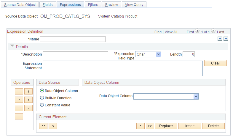

Expressions Page
Use the Expressions page (EOEW_SRCFIELDEXPR) to define custom expressions to run against the source record.
Navigation:
Enterprise Components, and then Data Transformation, and then Define Source Data Objects, and then Source Data Objects, and then Expressions
This example illustrates the fields and controls on the Expressions page. You can find definitions for the fields and controls later on this page.
Expressions page
Name
Displays the field name being referenced.
Field Type
Displays the type of field being referenced.
Length
Displays the length of the field being referenced.
Expression Statement
Enter the search expression that you want performed when this data object is referenced.
Clear
Click to clear the expression statement that is currently displayed in the Expression Statement field.
Operators
Select one or more operators to use to build your expression statement.
Data Source
Select a data source: Values are:
Data Object Column: If you select this value, you must also select a data object column from the menu provided. This column will be used as a building block for your query.
Built in Function: If you select this value, you must also select a built in function from the menu provided. This function will be used as a building block for your query.
Constant Value: If you select this value, you must also select a constant value from the menu provided. This value will be used as a building block for your query.
