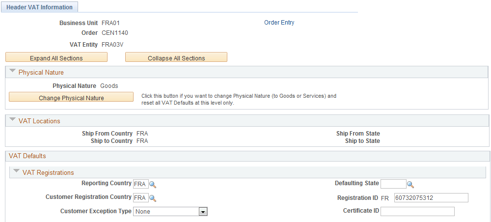

Header VAT Information Page
Use the Header VAT Information page (ORDENT_HDR_VAT) to modify header VAT data.
Override VAT header default values.
Navigation:
Order Management, and then Quotes and Orders, and then Create or Update Sales Order
Select VAT Information in the Header Menu field on the Order Entry Form page.
This example illustrates the fields and controls on the Header VAT Information page (1 of 2). You can find definitions for the fields and controls later on this page.
This example illustrates the fields and controls on the Header VAT Information page (2 of 2). You can find definitions for the fields and controls later on this page.
Expanding and Collapsing Sections
To manage the VAT data more efficiently, you can expand and collapse sections that are on this page.
Field or Control Description
Expand All Sections
Click the expand button to scroll to and access every section on the page. You can also expand one or more sections by clicking the arrow that is next to the section's name.
Collapse All Sections
Click to collapse all sections displaying only the header information. If you expand one or more sections, you can click the arrow that is next to the section's name to collapse the section.
Physical Nature
Change Physical Nature
Click the button to change to Goods or Services. When you click the button, the VAT defaults are reset for the new value.

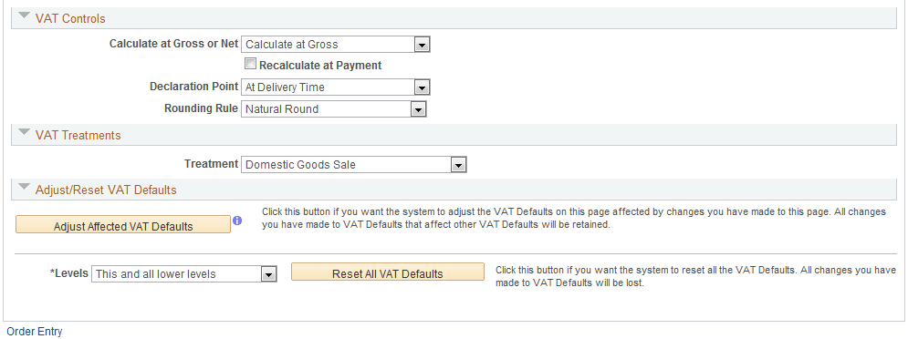

VAT Defaults
This group box contains the:
  • VAT service-specific defaults.
  • VAT registrations defaults.
  • VAT controls defaults.
  • VAT treatments.
  • Adjust/reset VAT defaults.
Service Type
If the transaction is for a service, it displays the VAT service type of Freight or Other. The value that is in this field determines whether the special rules for freight transport within the European Union (EU) apply.
Place of Supply Driver
If the transaction is for a service, displays the usual place of supply (the place where VAT is usually liable) for the service. This value is used to help determine the place of supply country and the VAT treatment. Values are Buyer's Countries, Supplier's Countries, and Where Physically Performed.
Reporting Country
Displays the country for which VAT is reported. This is the VAT Entity VAT registration country and determines many of the VAT defaults.
Defaulting State
If the reporting country requires that VAT be tracked by state or province, this field displays the state that is within the reporting country that is used to retrieve values from the VAT Defaults table.
Customer Registration Country and Customer Registration ID
Displays the registration country and ID of the bill-to customer.
Customer Exception Type
Displays the exception that is granted to the customer. Values are None, Exonerated, and Suspended. This value is specified on the bill-to customer.
Certificate ID
If applicable, displays the ID of the VAT exception certificate that may have been issued to the customer.
Calculate at Gross or Net
Indicates how VAT is calculated. Values are:
Gross: The system calculates VAT before it applies any early-payment discounts.
Net: The system calculates VAT after it deducts early-payment discounts. If two percentage discounts exist, the system uses the larger of the two when it calculates VAT. The system does not use discount amounts, only discount percentages.
The default value comes from the VAT entity driver.
Recalculate at Payment
Select to enable the recalculation of VAT at payment time to allow for any early payment discounts if you are calculating VAT at gross. This causes the system to adjust the VAT amount at the time of payment if the discount is taken. This is set on the VAT entity driver.
Declaration Point
Determines when the VAT transaction information will be recognized for reporting purposes. Values are:
Invoice: VAT is recognized at the time of invoice.
Payment: VAT is recognized at the time of payment.
Delivery: VAT is recognized on delivery.
Accounting: VAT is recognized on the date of accounting.
This value can be set at any level in the VAT hierarchy: VAT entity registration, business unit options, customer, or customer location.
Rounding Rule
Displays the VAT rounding rule. The value comes from the VAT country driver or VAT entity driver definition. Values are:
Nat Rnd (natural round): Amounts are rounded normally (up or down) to the precision that is specified for the currency code. For example, for a currency that is defined with two decimal places, 157.4659 is rounded up to 157.47, but 157.4649 is rounded down to 157.46.
Down: Amounts are rounded down. For example, for a currency that is defined with two decimal places, 157.4699 is rounded down to 157.46.
Up: Amounts are rounded up with a rounding precision to one additional decimal place. For example, for a currency that is defined with two decimal places, 157.4659 is rounded up to 157.47, but 157.4609 is rounded to 157.46.
Place of Supply Country
For services, displays the country in which the VAT is liable.
Treatment
Displays the VAT treatment. Values are:
Deemed Service Export: Services that are provided in the supplier's country to a foreign buyer, where the supply of these services must be zero-rated (that is, the place of supply is the country in which the supplier is located and registered for VAT, but the customer is located in another country).
Domestic Goods Sale: Sale of goods where the supplier and customer are located in the same country.
EU Goods Distance Sale: Sale of goods between EU countries in which the supplier is registered in an EU country and the purchaser is not registered in an EU country. The VAT rate that is charged is the rate that is applicable in the supplier's country.
EU Goods Sale: Sale of goods between VAT-registered traders in different EU countries.
EU Sale (Simplification): Used for a transaction between an intermediary and the purchaser in cases in which a sale of goods between EU countries involves three parties: the purchaser, an intermediary (bill-from) supplier, and the actual goods supplier. Each party is located in a different EU country and registered in their own country, and not in either of the other two countries. The only difference between this VAT treatment and that which is applied to normal EU sales is that the supplier is required to print a different message on the invoice referencing the statute that applies to triangulation, rather than the one that references the statute for normal EU sales.
No VAT Processing: No VAT processing is required.
Out of Scope EU Service Sale: EU services are outside of the scope of VAT.
Outside of Scope Service Export: Export services are outside of the scope of VAT.
Outside of Scope: Outside of the scope of VAT.
Zero-rated EU Service Sale: Sale of services that are within the EU are subject to zero-rated VAT.
Zero-rated Goods Export: Export of goods are subject to zero-rated VAT.
Zero-rated Services Export: Export of services are subject to zero-rated VAT.
Within PeopleSoft detail VAT treatment values that are on the transaction lines are used for applying the precise defaults that are applicable to the transaction lines. The treatment is determined based on the rules that apply to the transaction.
Adjust/Reset VAT Defaults
Any changes that you make to fields on this page may affect VAT defaults on this page. Adjusting or resetting VAT defaults will affect only fields that are within the VAT Defaults group box.
Adjust Affected VAT Defaults
Click to have the system adjust the VAT defaults that are affected by your changes. All changes that you have made to VAT defaults on this page that affect other VAT defaults on this page will be retained. Oracle recommends that you always click the Adjust Affected VAT Defaults button after changing any defaults on the VAT page. Because values that appear lower down on the page might depend on values that appear higher up on the page, you should work from top to bottom and click the Adjust Affected VAT Defaults button in the Adjust/Reset VAT Defaults collapsible region as needed. This prevents updating values that you have already overridden.
Click the i button to list the fields that are to be adjusted.
Levels
Before you click the Reset All VAT Defaults button, select the levels to which you want the action to apply:
  • All lower levels: Select to reset all VAT defaults at lower levels for this page. From the sales order header, selecting this value resets all VAT defaults on all the sales order lines and all the sales order schedule lines. From the sales order line, selecting this value resets all VAT defaults on all of the schedule lines associated with the current sales order line.
  • This and all lower levels: Select to reset all VAT defaults that are on this VAT page and at any lower levels of this page. From the sales order header, selecting this value resets all VAT defaults on the header plus all the sales order lines and all the sales order schedule lines. From the sales order line, selecting this value resets all VAT defaults on the sales order line plus all of the schedule lines associated with the current sales order line.
  • This level only: Select to reset all VAT defaults that are on this VAT page.
Click to reset any fields that you may have overridden on this page (including those that you changed by clicking the Adjust Affected VAT Defaults button) back to the original defaults before you save the page. Depending on your selection in the Levels field, the VAT default values will be reset for the sales order header, the sales order line, the sales order schedule line, or all three.
Note: Resetting completely redetermines the VAT defaults. If you have changed a VAT driver field, resetting VAT defaults does not necessarily return the original default values. Rather, it resets all of the default values based on the new driver value.
