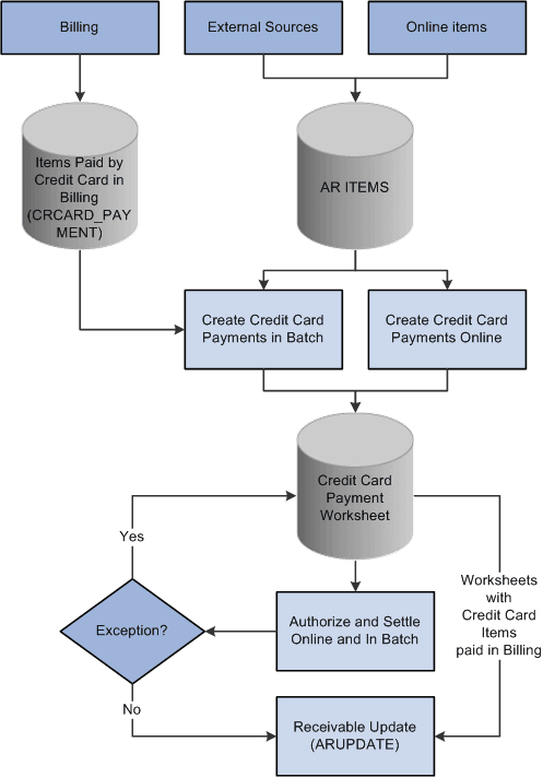

PeopleSoft Receivables Credit Card Process Flow
The following diagram illustrates how the PeopleSoft Credit Card process works in PeopleSoft Receivables:
PeopleSoft Receivables credit card process flow

You enter the same basic data for credit card payments, regardless of which PeopleSoft application you are using; the difference is where you enter it.
You can create credit card payments in several different ways:
  • Use the self-service eBill Payment component.
  • Use the Credit Card worksheet component.
    Click the Pay by Credit Card link on a Receivables inquiry page.
  • Use credit card batch processing.

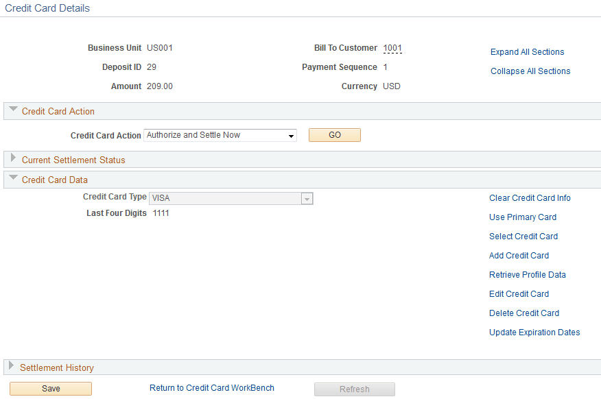

This example illustrates the fields and controls on the Credit Card Details page in Receivables (traditional credit card model), accessed through the Credit Card Workbench.
Credit Card Details page in Receivables, using the traditional credit card model
You can maintain credit card information on the Credit Card Details page in a system using the traditional credit card model and settle the payment immediately or settle the payment in a batch process.

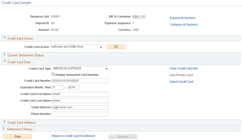

This example illustrates the fields and controls on the Credit Card Details page in Receivables (hosted credit card model), accessed through the Credit Card Workbench.
Credit Card Details page in Receivables, using the hosted credit card model
For the credit card data to be authorized in the hosted credit card model, you must enter data in all the fields required by the third-party authorizing authority.
If you access this page from a Receivables inquiry page, the system displays a warning at the top of the page. If you want to leave the Credit Card Detail page without saving or processing the credit card transaction, you must use the indicated link to cancel the transaction. Leaving the page using another method, such as clicking the back button on your browser, creates a credit card worksheet based on the items you indicated on the inquiry page.
Upon returning to the PeopleSoft application from the hosted credit card website, you must use menu navigation to return to the Finalize Worksheet page.
Field or Control Description
Credit Card Action
Select the settlement action for this credit card transaction. The values are:
No Action: The system does not perform any settlement action on this transaction.
Authorize and Settle Now: The system obtains an approval for the credit card transaction from the third-party authorizing authority and charges the amount of this transaction to the specified credit card.
Authorize and Settle Later: The system processes the credit card transaction the next time the Credit Card Processor multiprocess job (ARCRCARD) is run.
Manually Approved/Settled: The credit card payment has been processed outside of the PeopleSoft system. You can optionally enter the authorization code. This option is called a Manual Charge in Billing.
Cancel Settlement Request: The settlement request is canceled. The history is retained for this transaction, but the status of the transaction is set to No Action.
Authorization Code
Displays the authorization code for the transaction.
You can enter an authorization code if the Credit Card Action is Manually Approved and Settled. If the transaction has been settled through a third-party authorizing authority, the system populates the Authorization Code field.
Credit Card Message 1, Credit Card Message 2, and Credit Card Message 3
Displays any processing messages. A message with a prefix of ICS indicates that the message is from a third-party credit card authorization and payment application.
Clear Credit Card Data
Click to clear the credit card information on the page.
For more information about the credit card action links, see Managing Credit Card Data Using Action Links.
