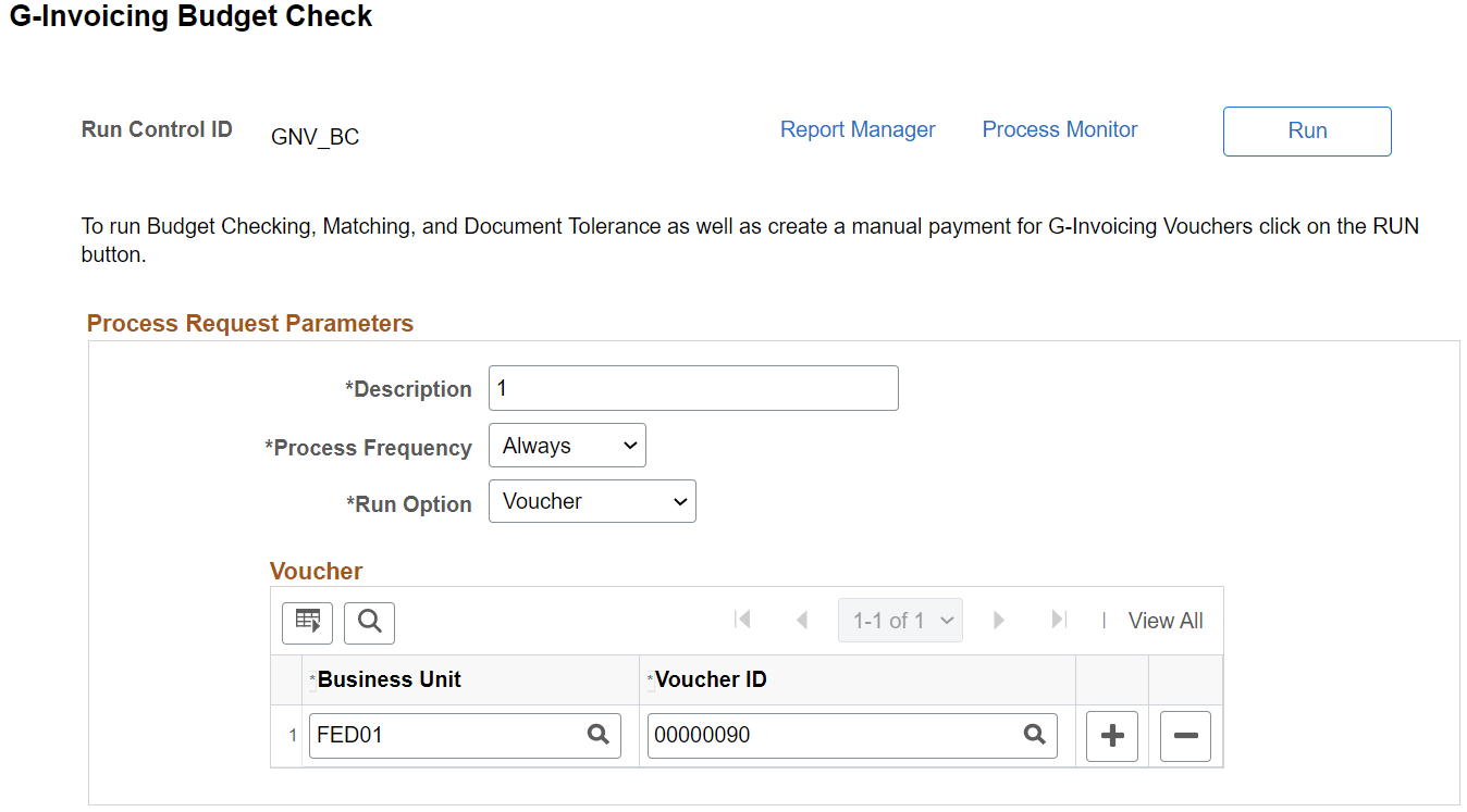

Recording G-Invoicing Payments
Use the G-Invoicing Budget Check page (AP_GINV_KK_CHK_MAN) to create manual payments for G-Invoicing vouchers. Since all G-Invoicing payments are made through the U.S. Federal Intra-Governmental Payment and Collection (IPAC), all payments in PeopleSoft are recorded as manual payments. Manual payments do not issue a payment in any form.
Navigation:
Accounts Payable, and then Batch Processes, and then Vouchers, and then G-Invoicing Budget Check
This example illustrates the fields and controls on the G-Invoicing Budget Check page.
This process runs Budget Checking, Matching (if applicable), Document Tolerance (if applicable), and creates manual payments for all eligible G-Invoicing vouchers.
Since G-Invoicing transfers funds for payment through IPAC, PeopleSoft records the payment using a manual payment. On the Voucher Payment page, Action is set to record a payment, Payment Date is set to current date, and Reference is populated using automatic numbering for the bank account.

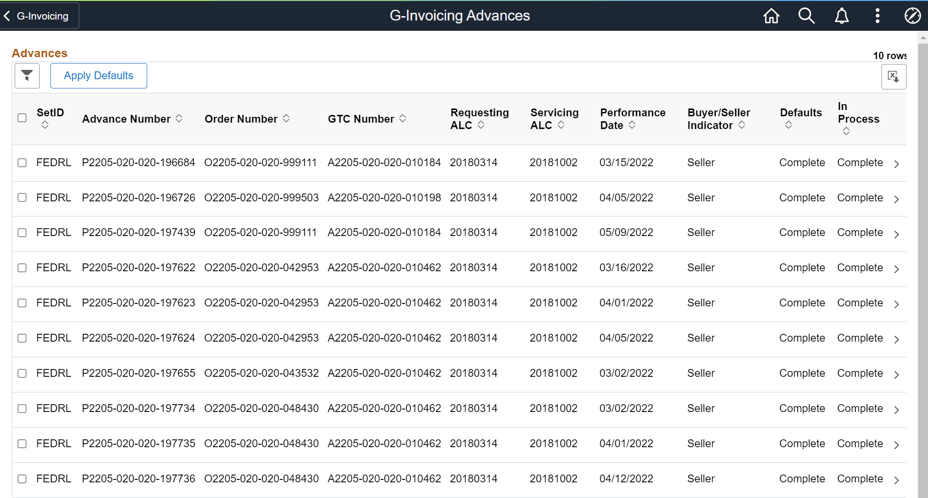

G-Invoicing Advances Page
Use the G-Invoicing Update Advances page (AP_GNV_ADV_WB_FL) to default Account and Entry Event values to multiple advances prior to creating a prepaid voucher.
G-Invoicing Advances are initiated by the seller and sent to PeopleSoft as a ‘548’ performance transaction. G-Invoicing Advances can have multiple schedules but only one distribution per schedule. Each G-Invoicing advance schedule is equivalent to one prepaid voucher in PeopleSoft. In order to record a G-Invoicing advance values must be provided for Account and Entry Event, if enabled.
It is possible to enter G-Invoicing Advances manually. However, a decision must be made to either enter Advances manually or to create them using Voucher Build. Using both entry methods will cause errors and reconciliation issues.
Navigation:
G-Invoicing, and then Update Advances
This example illustrates the fields and controls on the Advances page. You can find definitions for the fields and controls later on this page.
Advances Page
Click the check box next to the transactions for update. Then click Apply Defaults to enter an Account and Entry Event to apply to all selected transactions.

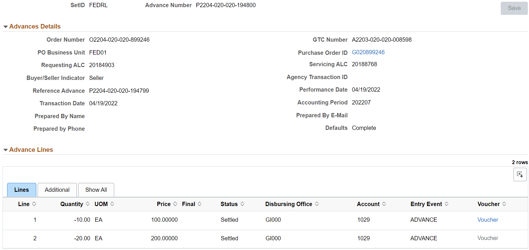

Click the chevron at the end of the Advance row on the grid to view the Advances Detail page.
This example illustrates the fields and controls on the Advances Detail page. You can find definitions for the fields and controls later on this page.
Advance Detail Page
Account and Entry Event can be updated for a single advance on this page.

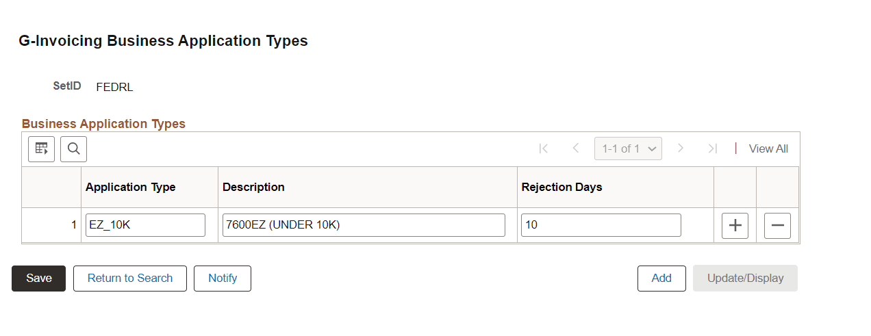

G-Invoicing Business Application Types Page
Use G-Invoicing Business Application Types page (AP_GINV_BIZAPP_PNL) to define the business application type and the number of rejection days for the EZ invoices.
These need to be defined to match what is in the G-Invoicing system.
Navigation:
Set Up Financials/Supply Chain, and then Product Related, and then Procurement Options, and then Payments, and then G-Invoicing Business App Types
This example illustrates the fields and controls on the G-Invoicing Business Application Types page. You can find definitions for the fields and controls later on this page.
Field or Control Description
Application Type
Enter the G-Invoicing type name.
This application type also appears on the General Terms and Conditions Page as Feature Code.
Description
Enter a description for the G-Invoicing type.
Rejection Days
Enter the number of days within which the sellers are allowed to reject the invoice.

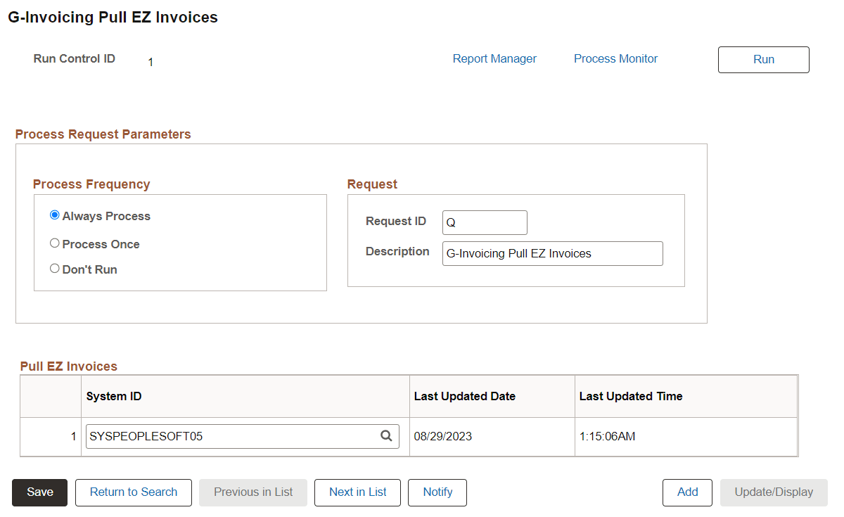

G-Invoicing Pull EZ Invoices Page
Use G-Invoicing Pull EZ Invoices page (AP_GINV_PEZ_PULL) to run the Pull 7600EZ API, which populates the EZ Invoices grid. EZ invoices with statuses of Settled (STL) and Informational (INF) are pulled.
This is a two-part request. PeopleSoft will first request the list of 7600EZ transactions and then separately request the corresponding detail by EZ Invoice Number.
Navigation:
Accounts Payable, and then Batch Processes, and then Vouchers, and then G-Invoicing Pull EZ Invoices
This example illustrates the fields and controls on the G-Invoicing Pull EZ Invoices page. You can find definitions for the fields and controls later on this page.
Process Frequency
Select how often the process should run. The available options are:
  • Always Process.
  • Process Once.
  • Don’t Run.
System ID
Enter the System ID to use for G-Invoicing transactions.
Last Updated Date and Last Updated Time
Displays the last run date and time for the API.

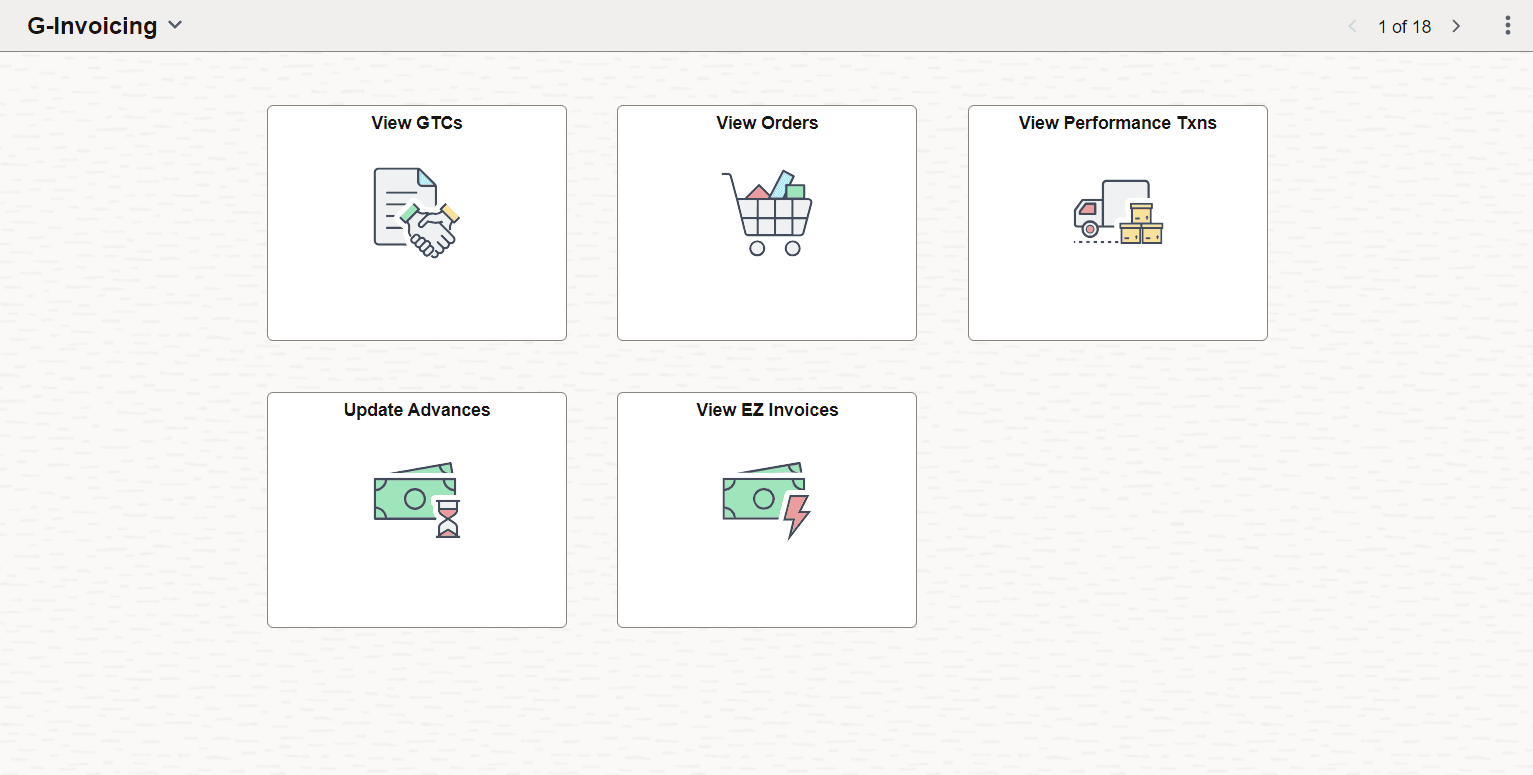

The EZ transactions are available on the View EZ Invoices Page.
This example illustrates the fields and controls on the G-Invoicing Home page.

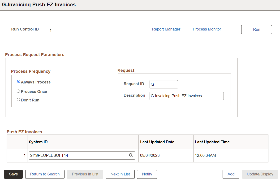

G-Invoicing Push EZ Invoices Page
Use G-Invoicing Push EZ Invoices page (AP_GINV_PEZ_PUSH) to run the Push 7600EZ API for pushing 598 rejection transactions to the G-Invoicing system.
To reject the EZ invoice from PeopleSoft, first create a regular voucher and then create a reversal voucher without Reversed EZ Number. For more details, see Creating Reversal Vouchers.
This example illustrates the fields and controls on the G-Invoicing Push EZ Invoices page.
For the definitions of fields and controls, see G-Invoicing Pull EZ Invoices Page.

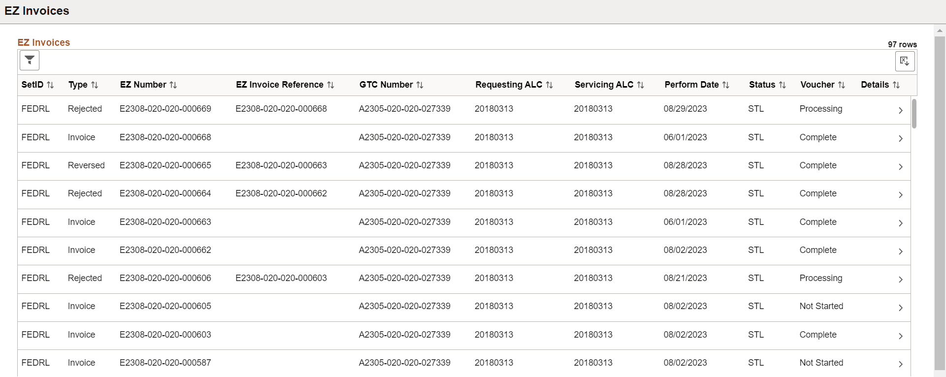

Use EZ Invoices page (AP_GINV_EZ_WB_FL) to view EZ transactions from 7600EZ API.
Navigation:
G-Invoicing, and then View EZ Invoices
This example illustrates the fields and controls on the EZ Invoices page. You can find definitions for the fields and controls later on this page.
EZ Invoices page
SetID
Displays the derived set ID associated with the G-Invoicing System ID on the G-Invoicing Definition page.
Type
Displays the EZ invoice type received from G-Invoicing.
  • Accepted
  • Invoice
  • Rejected
  • Reversed
EZ Number
Displays the EZ Number assigned at the time of the creation of G-Invoicing.
EZ Invoice Reference
Displays the reference number that links the new EZ to an existing one.
GTC Number
Displays the GT&C number assigned in G-Invoicing.
Requesting ALC and Servicing ALC
Displays the requesting and servicing agency location code.
Perform Date
Displays the Perform Date entered while creating the transaction. This is received from G-Invoicing.
Status
Displays the status of the document.
  • INF (Informational): Settlement is not complete for the EZ transaction.
  • STL (Settled): Settlement is complete.
Voucher
Displays the voucher stratus for the EZ invoice.
  • Complete: Voucher is created and fully processed.
  • Hold: Voucher is on hold.
  • Processing: Voucher is created but is not fully processed.
  • Not Started: A voucher does not exist that references the EZ Number
Filters
(Filter Items)
Click to enter the filter criteria and search the specific EZ invoices.
Download to excel
(Download to Excel)
Click to download the EZ Invoices grid data to an excel sheet.

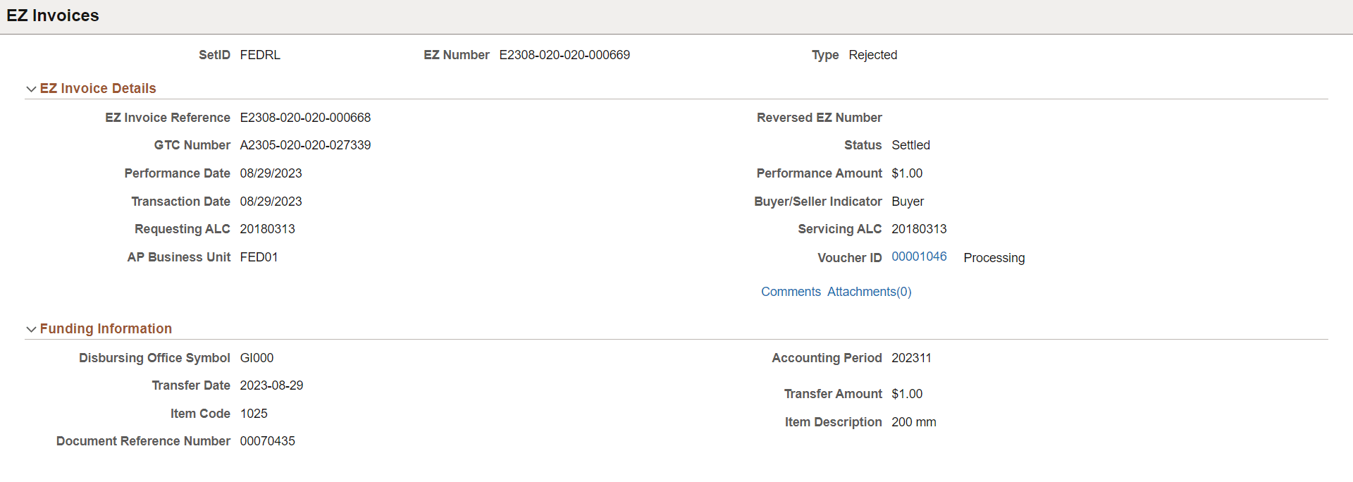

Details
Click to view the EZ invoice details.
This example illustrates the fields and controls on the EZ Invoices - Details page. You can find definitions for the fields and controls later on this page.
EZ Invoices Details page
If a voucher is created for the EZ invoice, the Voucher ID link appears. Click the link to open the Voucher Summary page.
Click the Comments and Attachments link to view the comments and attachments received from G-Invoicing.
