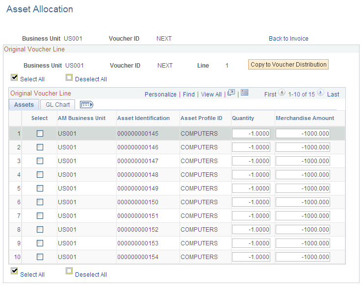

Allocate Asset Page
When unitization of assets occurs and an adjustment voucher created (credit or debit memo) for the original invoice containing the asset, the adjustment cost needs to be reflected across all applicable assets; otherwise, only the first asset created during unitization receives the adjustment cost.  You can either choose to manually allocate the adjustment costs to the applicable assets or you can use the Allocate Asset page to spread the adjustment cost across all applicable assets from the original voucher. SeeAsset Lifecycle Management Fundamentals: Consolidating and Unitizing Assets
Use the Allocate Asset page (VCHR_ASSET_WRK) to allocate the voucher line adjustment cost equally to previously unitized assets across all returned asset rows.
Navigation:
Click the Allocate Asset link from the Invoice Information page.
This example illustrates the fields and controls on the Allocate Asset page.
Allocate Asset
Enter the Payables Business Unit, Voucher ID, and Voucher Line Number for selecting related assets to populate the Allocate Asset work page. This page recovers all related assets of the original voucher from the Asset Acquisition Detail (ASSET_ACQ_DET) table to the page grid.
AM Business Unit, Asset ID, and ChartFields (on the GL Chart tab) are display-only fields.
You can then allocate the adjustment cost of the voucher line equally across all returned asset rows.
You can modify the Quantity and Merchandise Amount fields. To complete the change, you can use the Copy to Voucher Distribution button to copy the adjustment back to the voucher distribution lines; the modified data will overlay any defaulted distribution information that is present.
When you click this button, selected rows on the grid will be copied back to the voucher distribution lines and you are returned to the Voucher Information page. If no rows have been selected before clicking the button, you receive the following warning message: No row copied to Voucher Distribution.
Back to Invoice
Click to return to the Voucher Information page only. No data will be copied back to the voucher distribution line.
