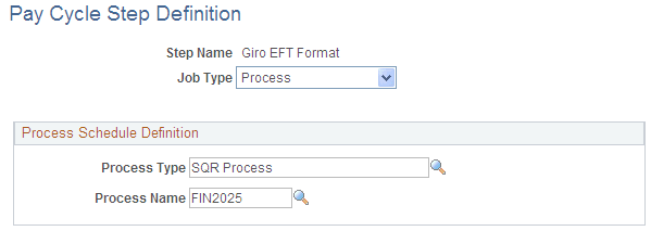

Pay Cycle Step Definition Page
Use the Pay Cycle Step Definition page (PYCYCL_STEP_DFN) to update or add process steps to a pay cycle.
Navigation:
Accounts Payable, and then Payments, and then Pay Cycle Definition, and then Pay Cycle Steps, and then Pay Cycle Step Definition
This example illustrates the fields and controls on the Pay Cycle Step Definition page. You can find definitions for the fields and controls later on this page.
Field or Control Description
Step Name
Describes what the process performs during this stage of the pay cycle. For example, the Payment Selection and Creation step runs both the Payment Selection and Payment Creation processes. When a process is eligible or required to run, the step name appears in the Pay Cycle Manager. Associate step names with pay cycle status on the Pay Cycle Step Table page to define the order in which each process runs.
Job Type
Select from the following options:
Info (information): Defines the step as an informational type of process that links the Pay Cycle Manager to other pay cycle components for additional processing. For example, Payment Reference Confirmation is a required pay-cycle step, but not an actual Process Scheduler-defined process, that links the Pay Cycle Manager to the Payment Reference Confirmation component.
Process: Defines the step as a Process Scheduler-defined process.
Process Schedule Definition
Process Type
Enter the type of process. The delivered pay cycle steps use PeopleSoft Application Engine and Structured Query Reports (SQR) processes. You must define this information in the Process Scheduler Manager tables before creating a pay cycle step process.
Process Name
Enter a description of the process type. You must define this information in the Process Scheduler tables before creating a pay cycle step process.

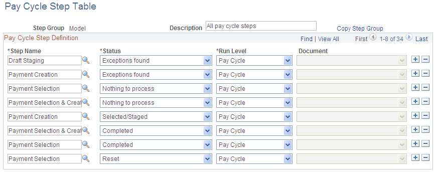

Pay Cycle Step Table Page
Use the Pay Cycle Step Table page (PYCYCL_STEP_TBL) to define step groups.
A step group contains all the possible steps that might be run during Pay Cycle processing. Each step is associated with a pay cycle status that indicates the order in which the steps are run.
Navigation:
Accounts Payable, and then Payments, and then Pay Cycle Definition, and then Pay Cycle Step Table
This example illustrates the fields and controls on the Pay Cycle Step Table page. You can find definitions for the fields and controls later on this page.
A step group contains all the possible steps that might occur during processing. Each step is associated with a pay cycle status that indicates the order in which the steps are run.
Copy Step Group
Click to copy another step group. Copying step groups deletes the current step group and replaces all existing steps.
Step Name
Enter the step name defined on the Pay Cycle Step Definition page.
Status
Represents each possible state of the pay cycle. The statuses are provided with the system. A typical check-only pay cycle follows this sequence of statuses: Completed, New, Selected, Created, Confirmed, Completed.
Run Level
Determines whether the job affects the entire pay cycle or just an output process (specific bank, account, and payment method combination). For instance, Payment Creation affects the entire pay cycle, but Print Checks affects only one bank, account, and payment method combination at a time. These are the available options:
Pay Cycle: Processes all transactions associated with the pay cycle, depending on the date selection criteria, payment source, business unit, bank account, and payment method. The Pay Cycle Manager processes the pay cycle-level processes until the payments are created and approved. Then the user can choose the output processes to create all files and documents for the pay cycle. If you select the pay cycle run level, the Document field does not apply and is unavailable.
Bank: Processes the created payments for a specific bank account only. This process creates negotiable documents and payment files for bank processing.
Note: Customization: Any changes made to the above field values account to customization. You may customize the Pay Cycle Step Table by copying a step group to a new one, changing the step name, status, or run level.
Document
This option is applicable only for step names defined with a run level of Bank. This option identifies specifically what payment method and document type combination is processed. Available options are a combination of all the document types for all payment methods defined in the system, such as Check, EFT Advice (electronic funds transfer advice), Draft, ACH (automated clearing house), and Letter of Credit advices.
